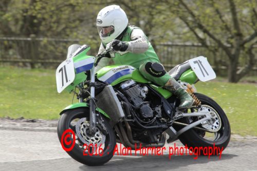

I'll try to dig out a photo of my chum Dave's hillclimb ZRX11. It chucks out a true 147bhp at the rear wheel. He held a number of course records on it and probably still does. He's entered the odd open-class circuit race on it, normally coming in the top ten against R1s, Fireblades etc... :)

#3 PostAuthor: Coose » Wed Feb 28, 2018 8:36 pm
