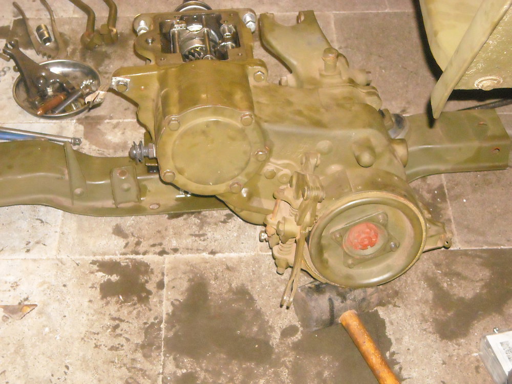

Hello guys
an update of the adventures with the jeep.
The first big bug appeared!
When I parked the jeep in the garage after a 40 miles ride, the next morning there was a puddle of thick gear oil under it.
At the beginning I didn't worry about it and thought that it was normal, these jeeps are known for loosing a bit of oil.
The next day I took her out for another ride and there was again a puddle of oil under it.
I started to get worried about it and began to read more about loosing gear oil.
The manual advised to look at the oil level in the gear box. I removed the filler plug and the oil leaked out, there was too much oil in the gearbox. OK, problem solved...NO, the next time there was again a puddle of oil underneath.
After a bit more reading and searching on the internet I found out that sometimes the oil of the transfer case leaks into the gearbox...
bad, very bad!

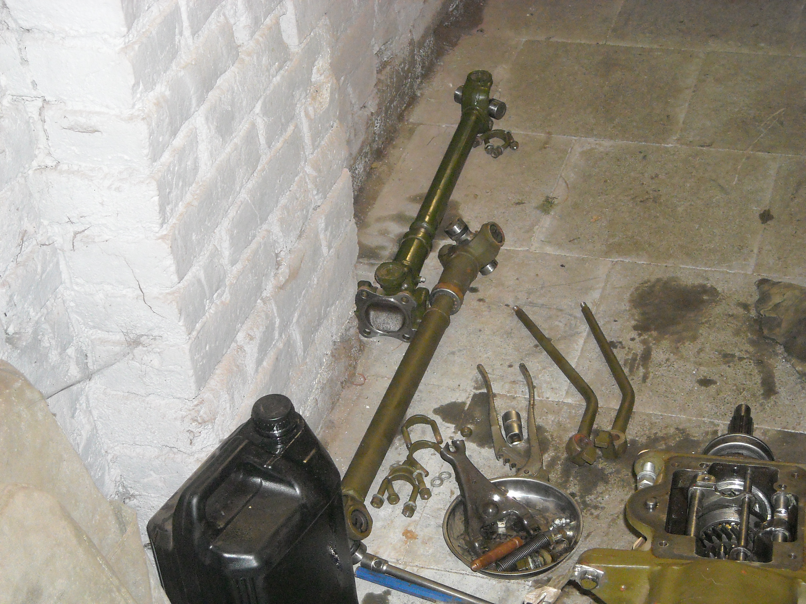

In order to solve this the gearbox and the transfer case needed to be removed, opened and checked...easier said than done.
The cooling fluid must be removed from the engine because you have to lower the rear of the engine in order to remove the gearbox and transfer case. If you don't take the rubber tubes of the radiator the radiator can crack when lowering the engine.
A lot of parts need to be removed: the propshafts, the gear levers, the muffler, the skid plate,...
But OK, on monday I started to dismantle the jeep and in the evening the gearbox and transfer case were ready to be removed.
The next day they were taken from under the jeep and I separated them.
I mounted a new bearing and a new cork seal, filled the transfer case with new oil and prepared the unit to get back under the jeep.
It took me half a day to get it back under the jeep and I needed to use the litlle workshop crane and a few jacks to get it in place.
Today I'm going to continue the work and I hope to get it done. Let's hope that the problem is solved.
The gearbox and the transfer case were the only parts I didn't refurbish myself. They were both done by a friend of the seller who knew how it should be done.
I think he needs to learn more about how it should be done because the castellated nut that secures the gear on the secondary shaft of the gearbox wasn't tight enough . The washer wasn't thick enough to put the correct amount of pressure on the oil slinger in order to prevent the tranfercase oil from flowing into the gear box.
More news to come within a few days.

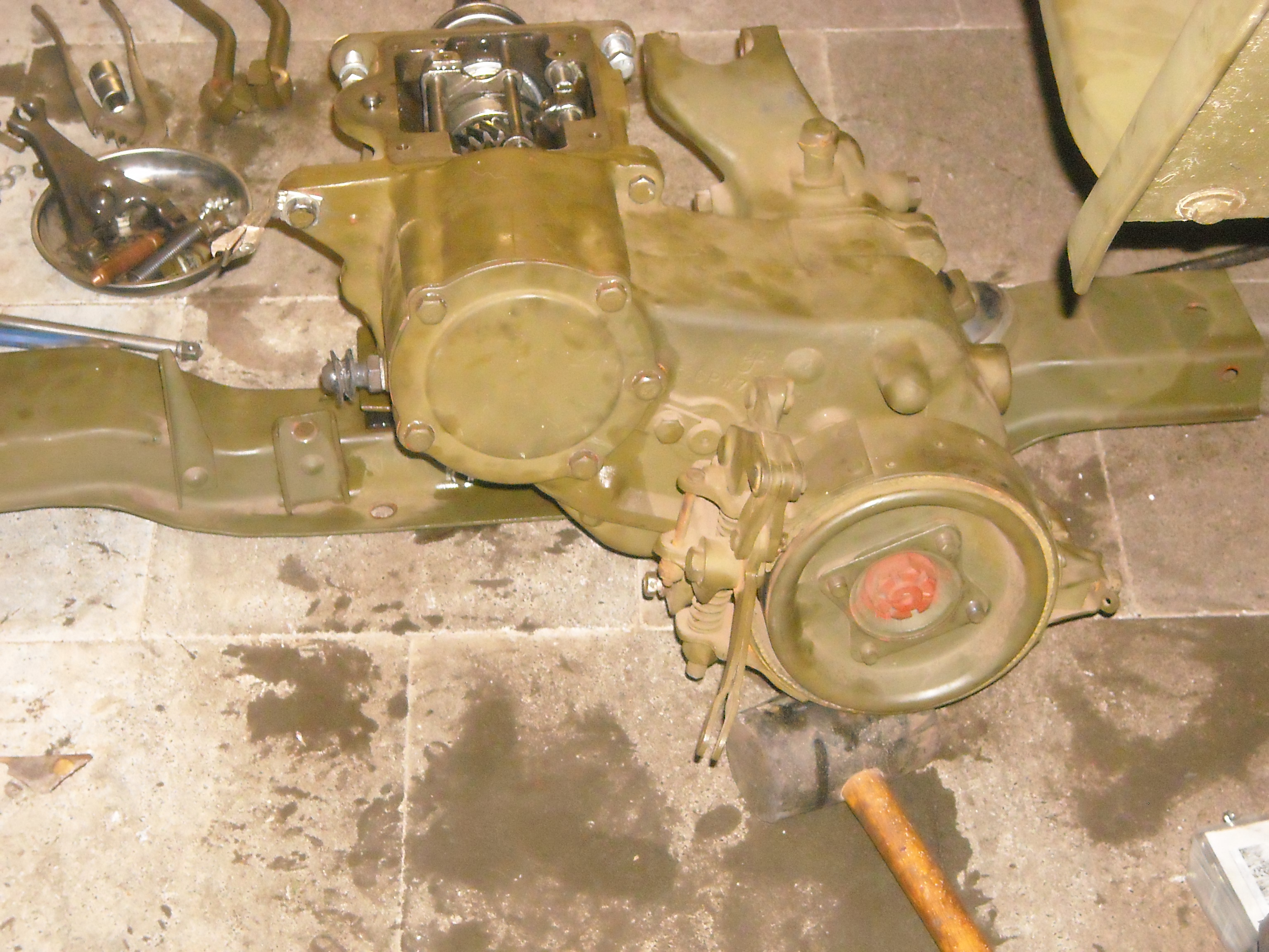

bad, very bad!
