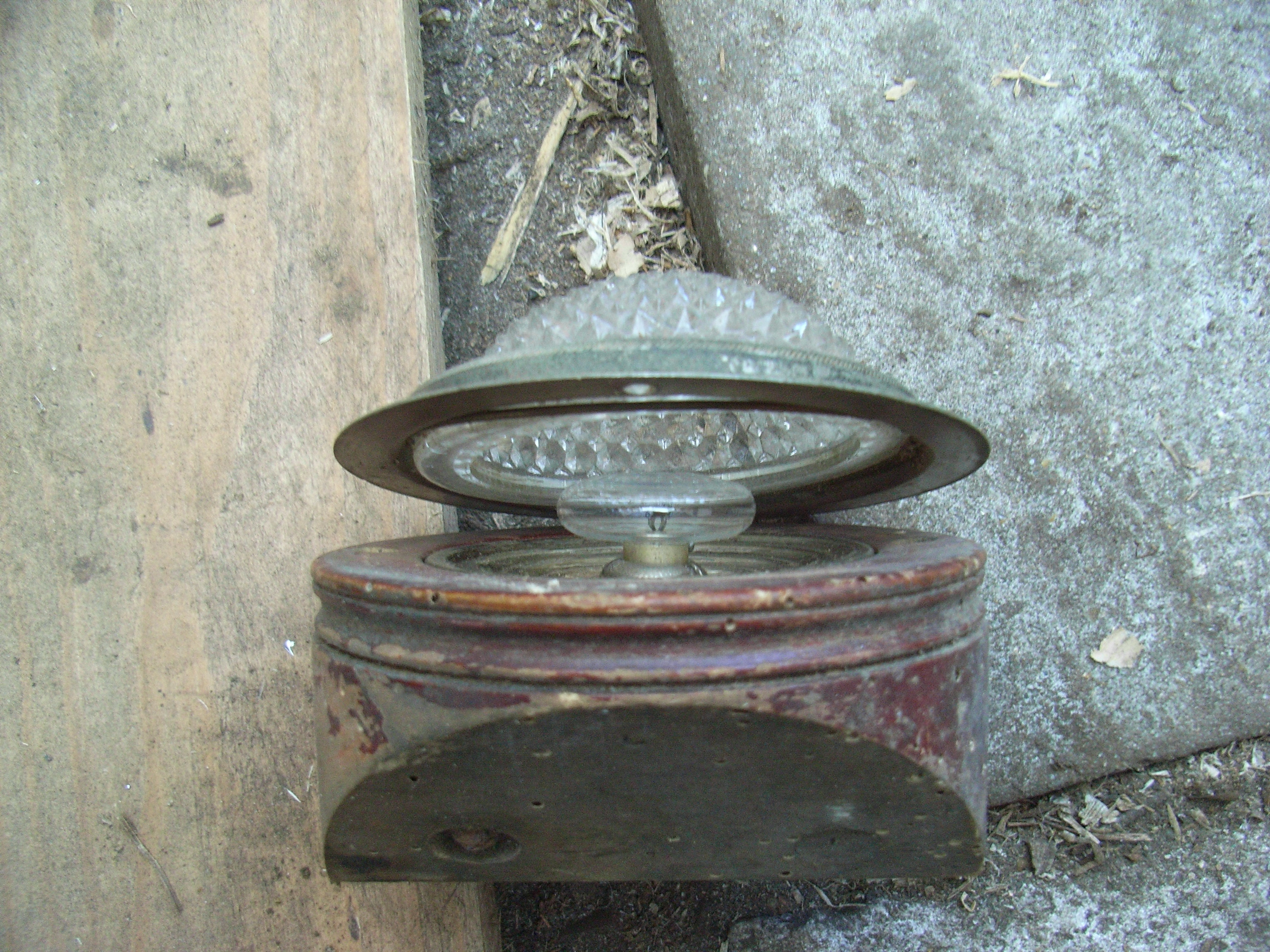

The head of the robot from Lost in space perhaps?
Special low profile bulbs for narrow spaces.

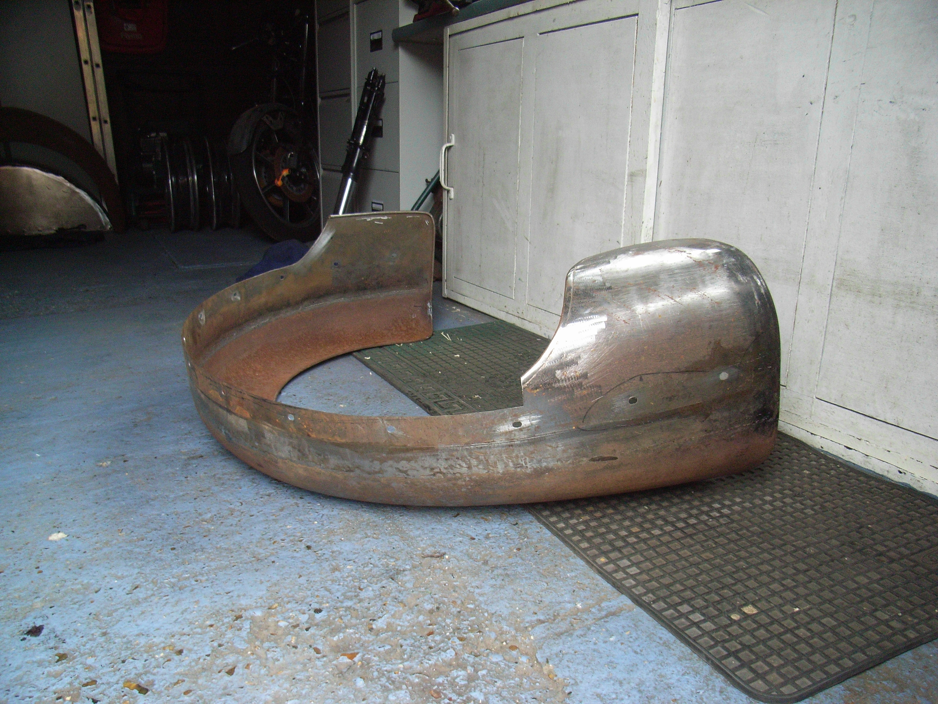

Inner rears were shot so... you get the drill;

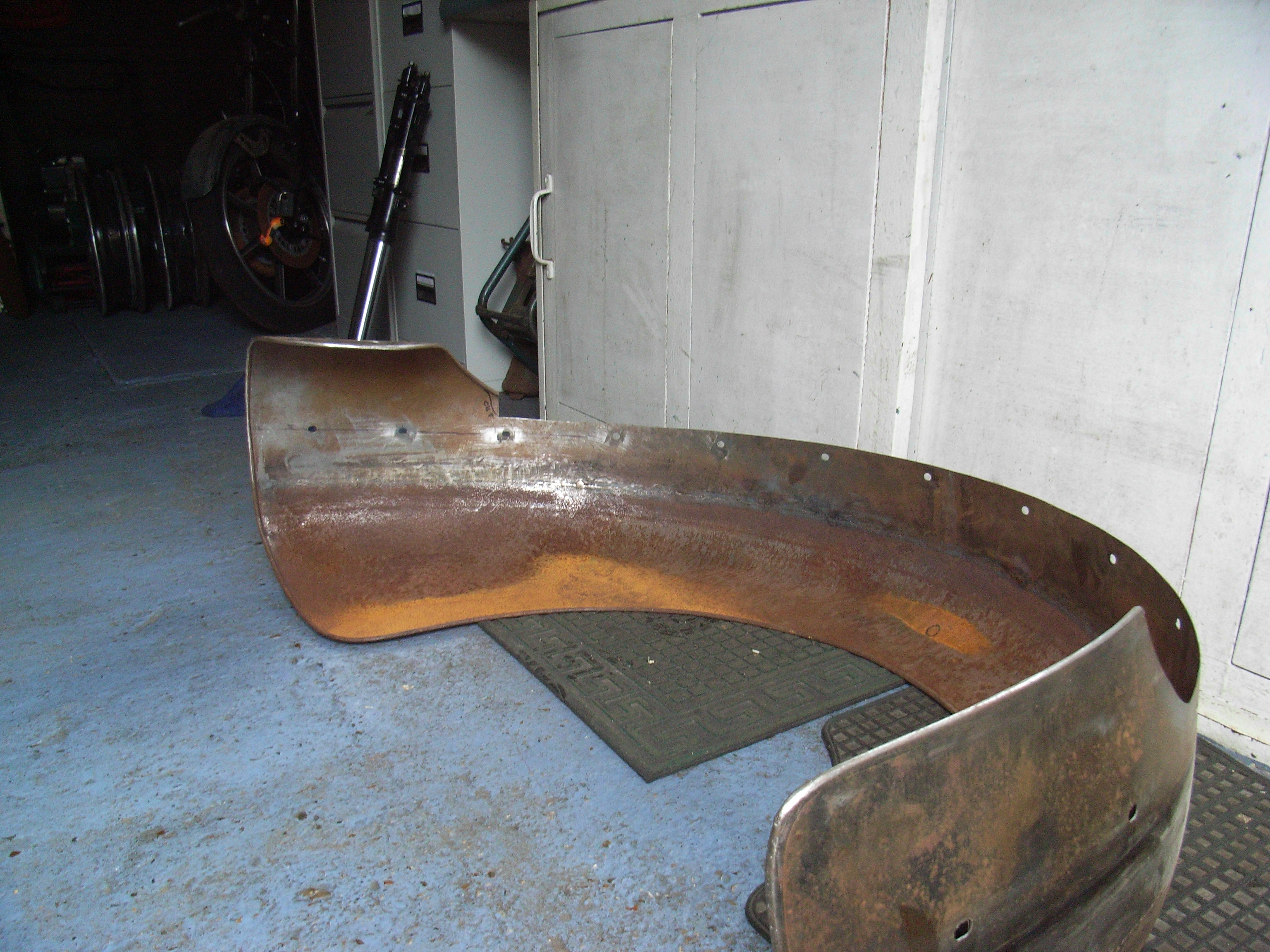

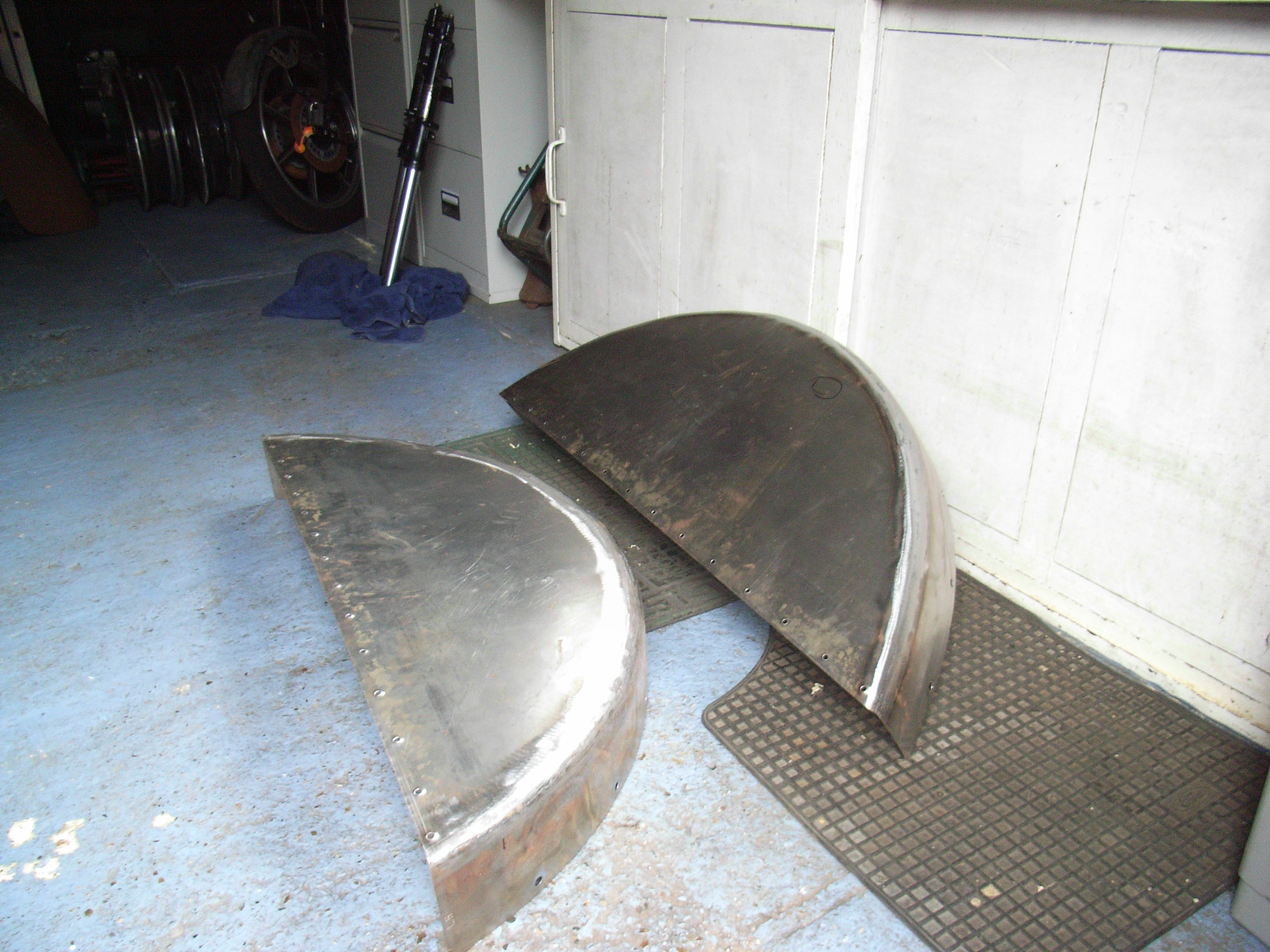

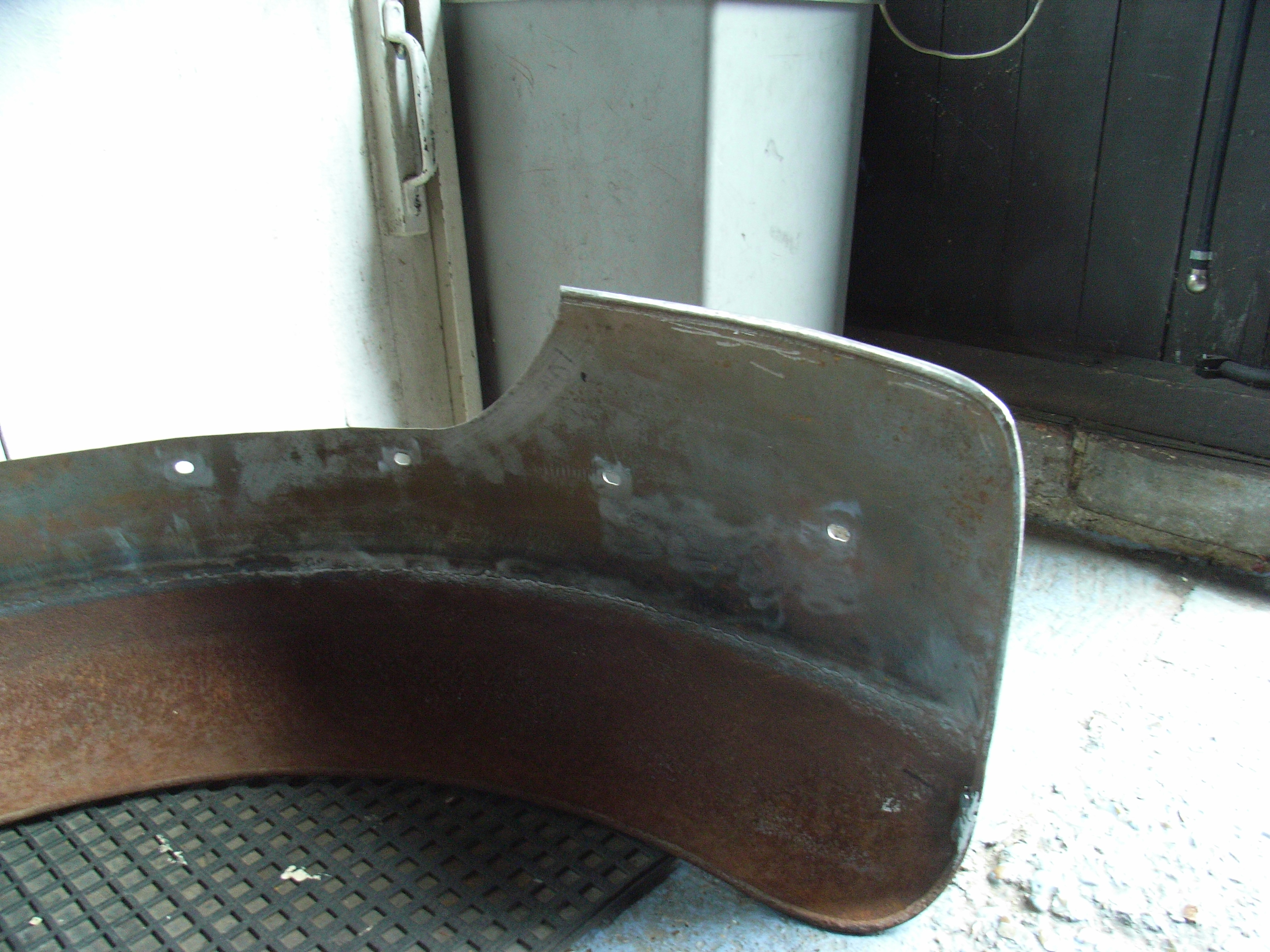

Rear outers after major surgery.

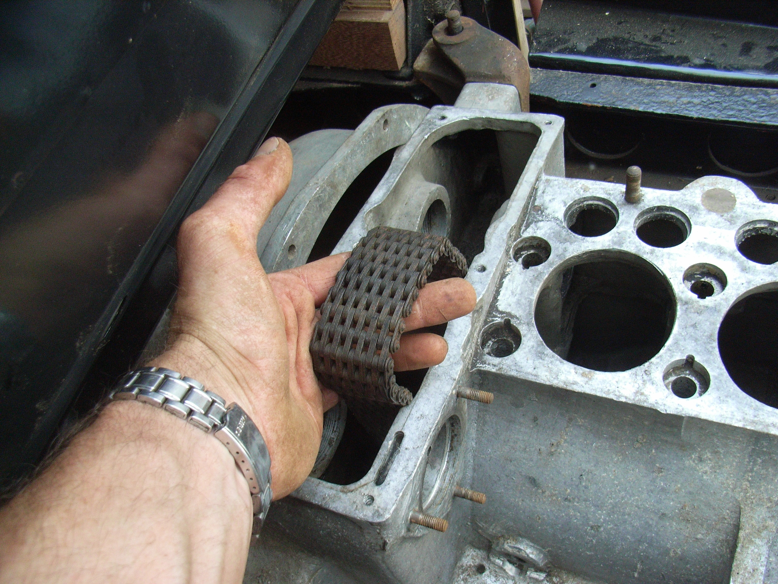

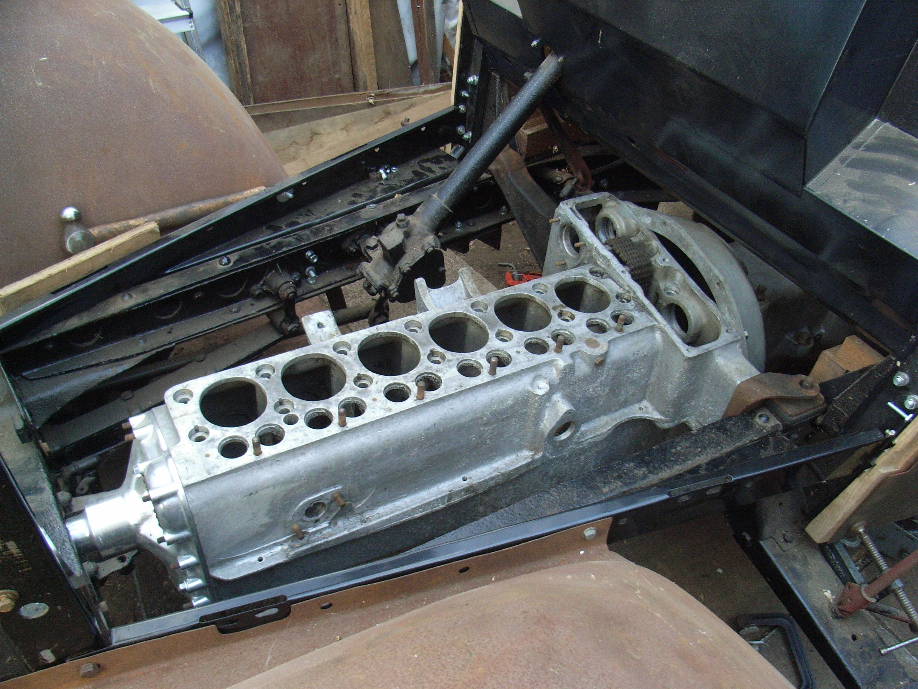

The engine is arranged from centre front to left rear. An angle of about 15 degrees. Absolutely no idea why and cant see the justification for it because it brings with it a whole host of problems.
In order to build the weight of the body and panels onto the chassis is needs to be deflected down to at least simulate the load.
So i placed the crankcase and box in and re-arranged the jacking points. If you dont, the progressive adding of weight will give false body lines and shuts when the car goes on the floor.
Yes that is correct crankcases. Its a lower and upper half bolted together with the crank somewhere in between.
The crank is not on the same centre line as the drive train and i think its driving the clutch through a pair of gears with this the mother of all HYVO's
:shock: :shock:

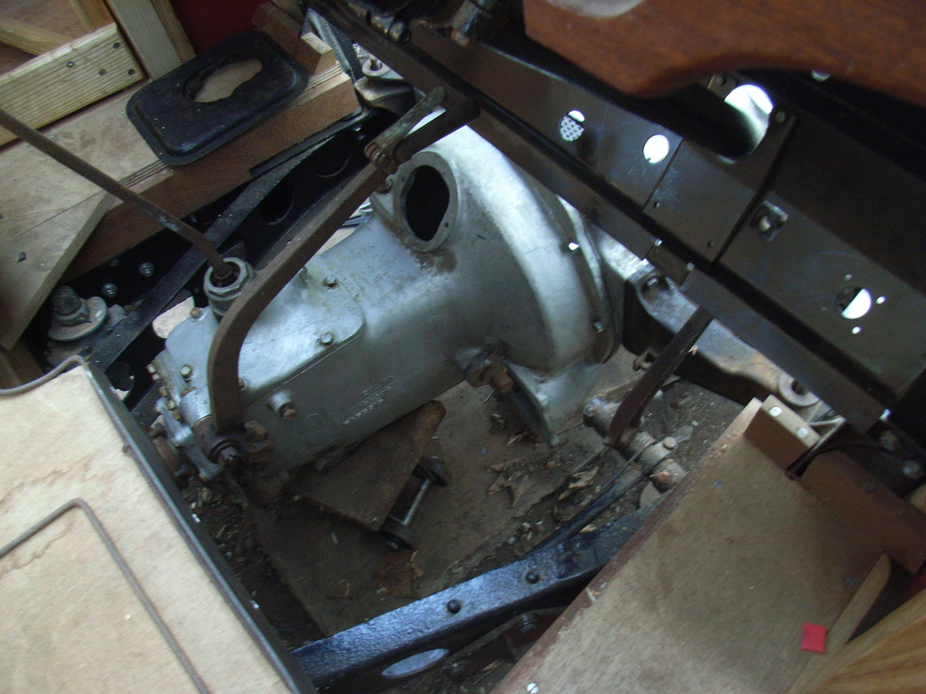

In case you wondered the cut out in the front seats is for the gear lever and for the handbrake which is bolted to a pivot mounted on the side of the gearbox.

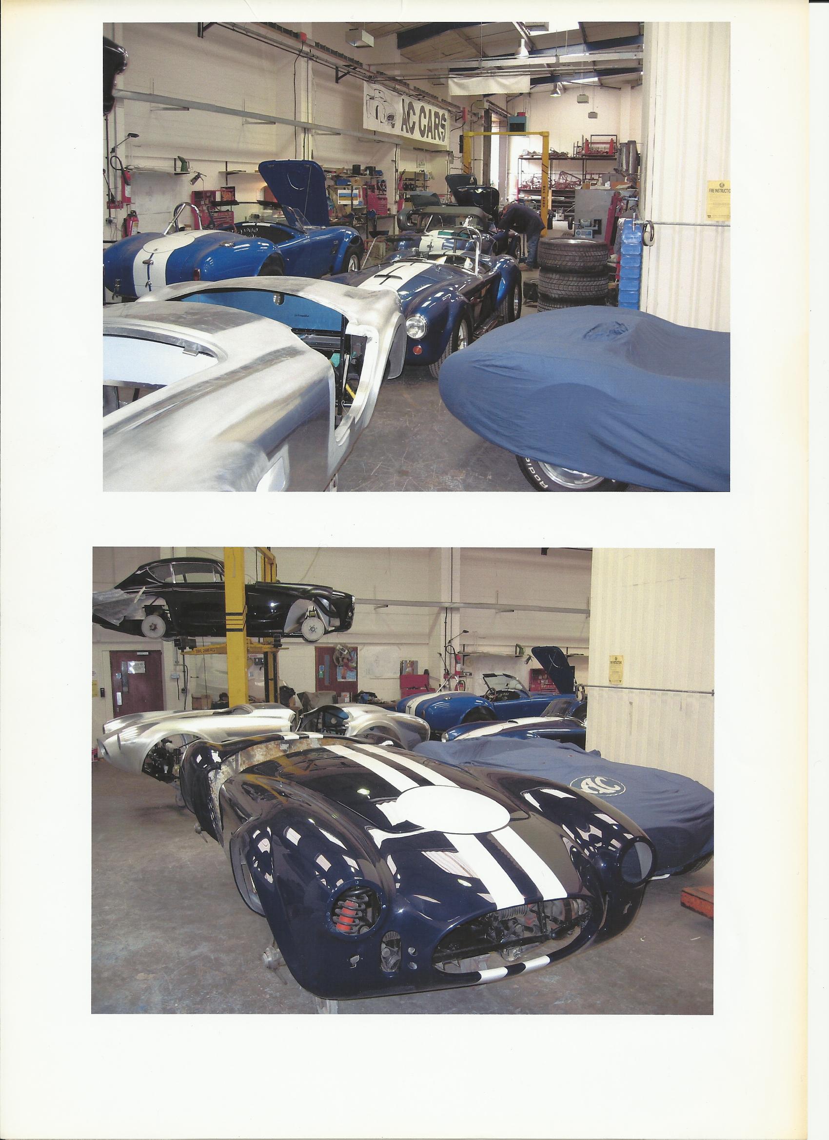

One place i used to work at for a bit.

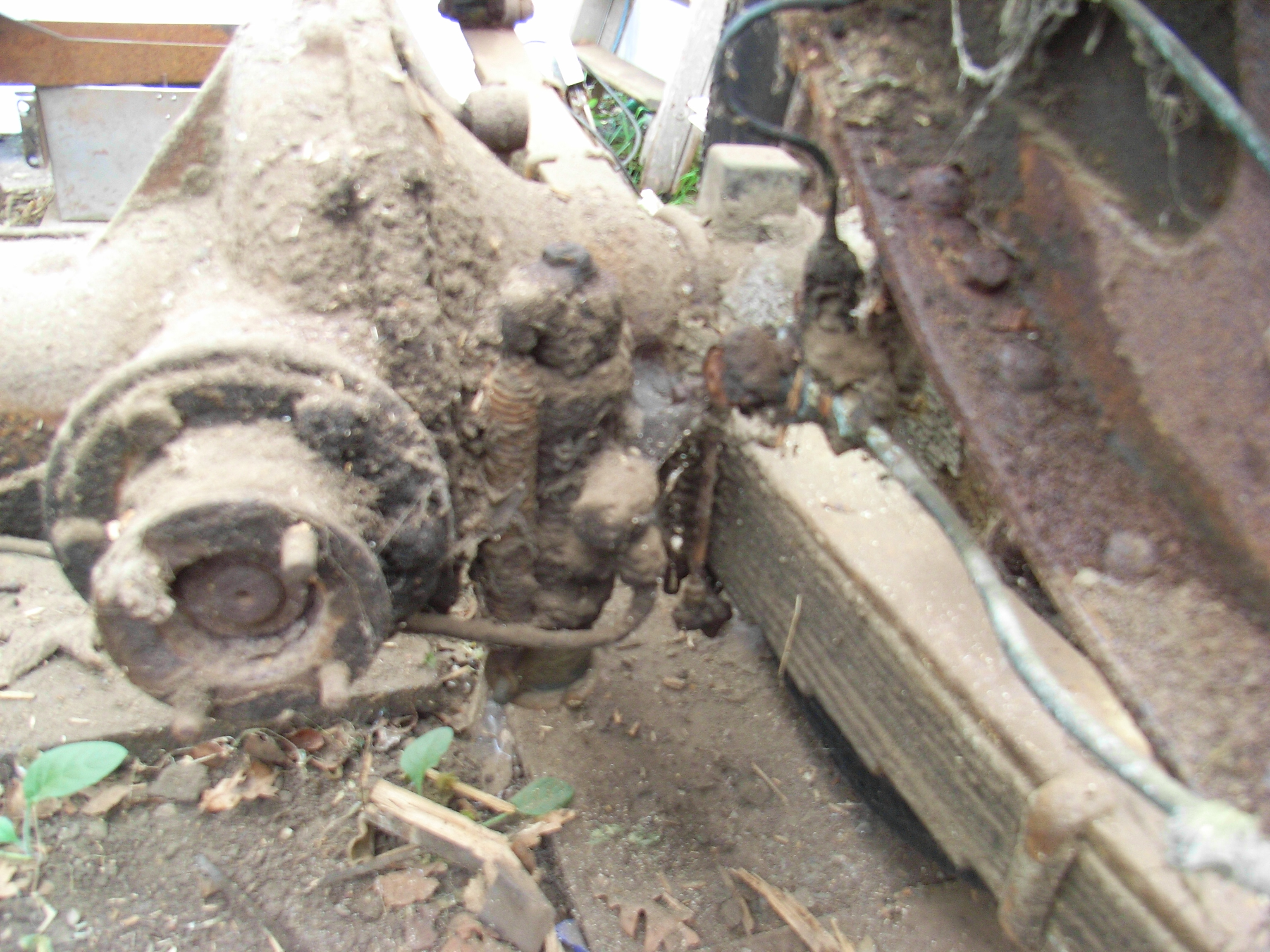

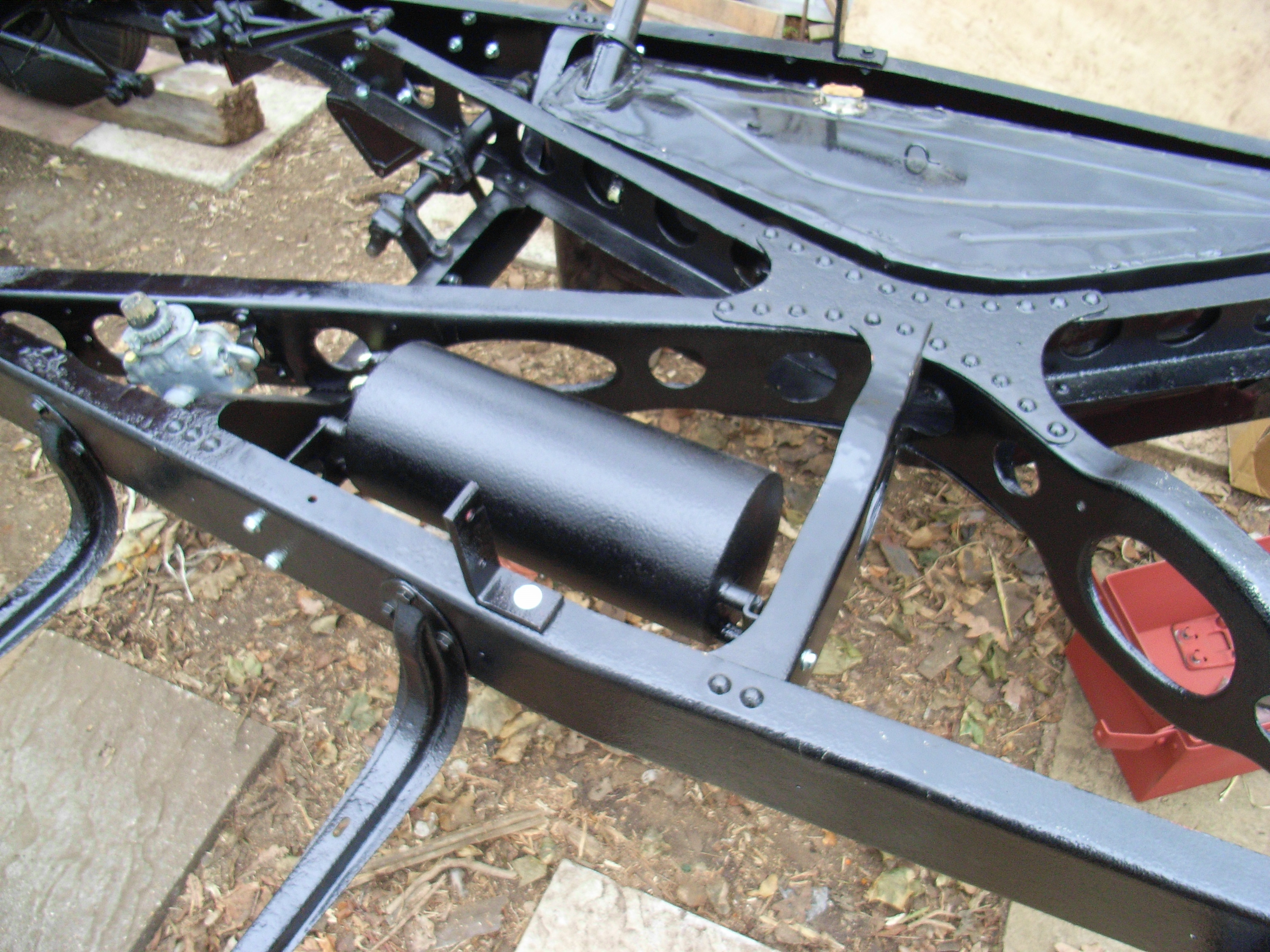

Next job is to remove the jacks to get them refurbed.
There is one here from an early picture to the right of the diff.
There is one on each corner and they are hydraulic and controlled by a manual pump below the floor which you access by removing a small triangular panel and inserting a handle.
Normally people take them off because they have a reputation for dropping down when youre going along the road but they would be a real benefit if you get a puncture.
The cylinder in the middle that looks like a silencer is the hydraulic tank i think. Just in front of it is the manual pump.
