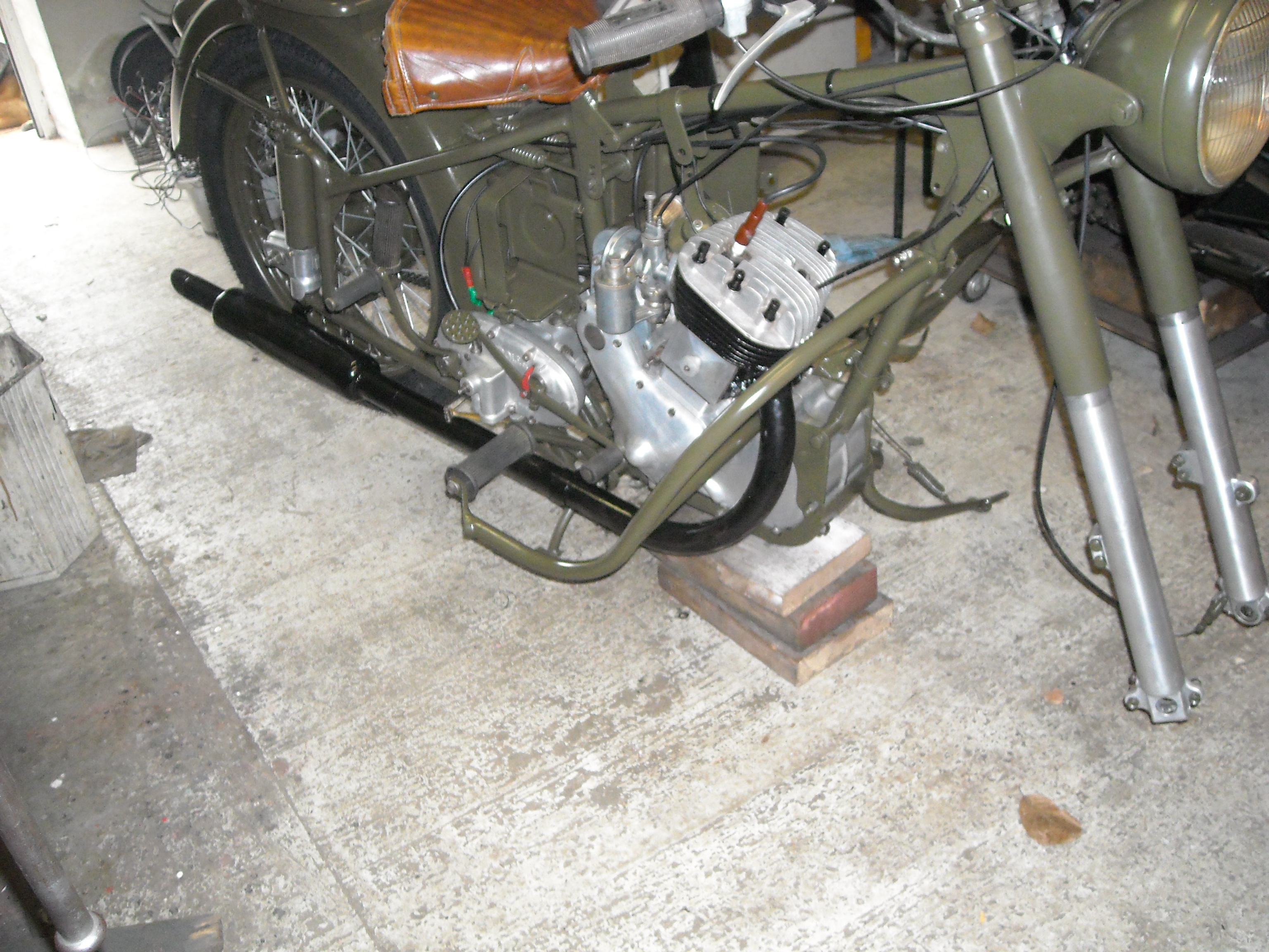

the rear wheel turned out to be OK after some gentle blows with a rubber hammer. The spokes run straight to the rim and I was able to get the wheel almost straight. There's a little bump of about 1 mm. I guess it was worse before .
The tyre is on and the wheel is in the frame, the brake works, the drive chain is back on.

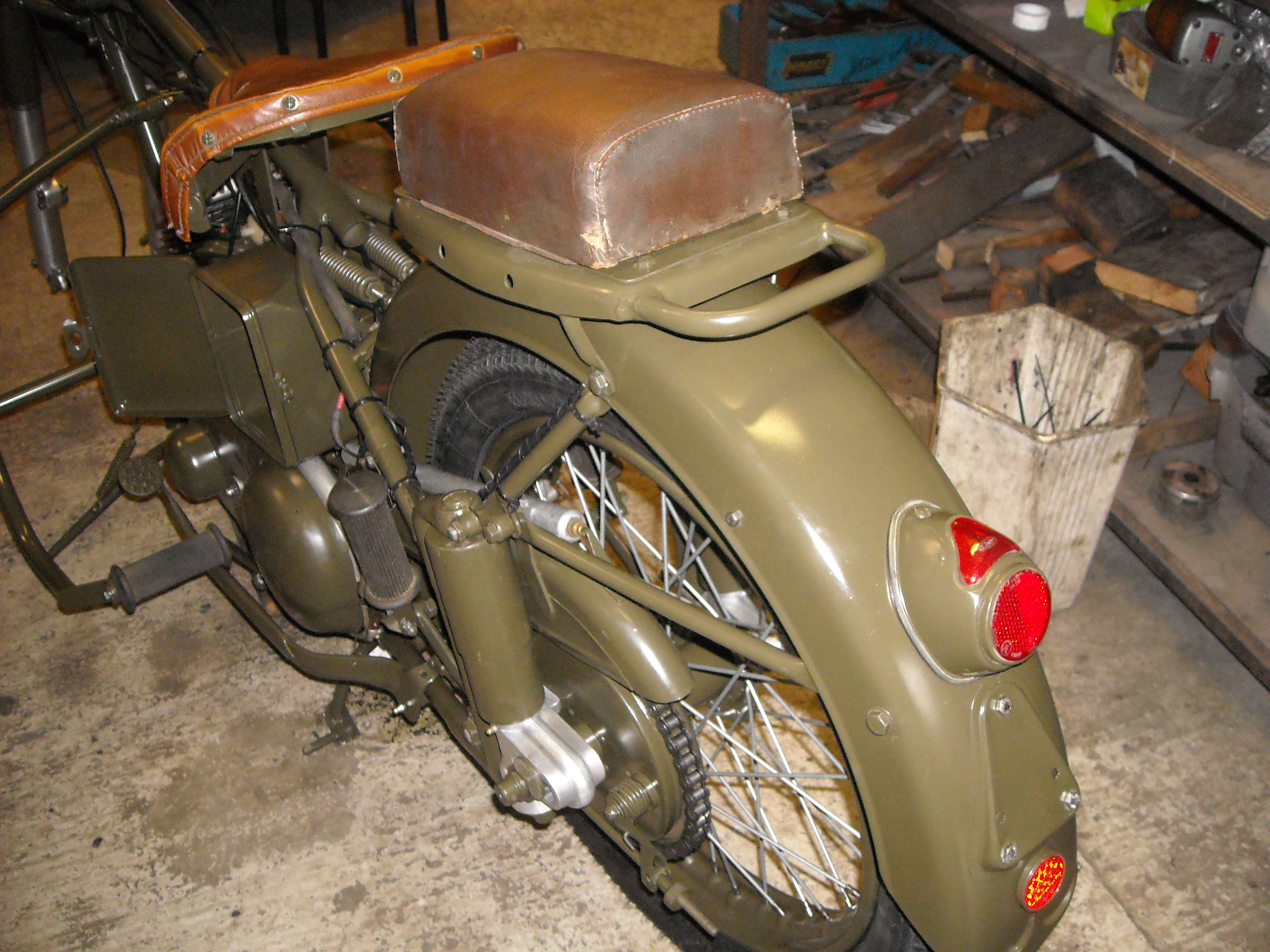

The rear mudguard is mounted... now it's obvious that the frame is bent, it took me several hours to mount it because I had to use force to get it in its correct place. Anyway, it starts to look a lot like a bike.
The electricity (or what should be electric wires) is connected to the different switches and lights.
I also managed to mount the exhaust.

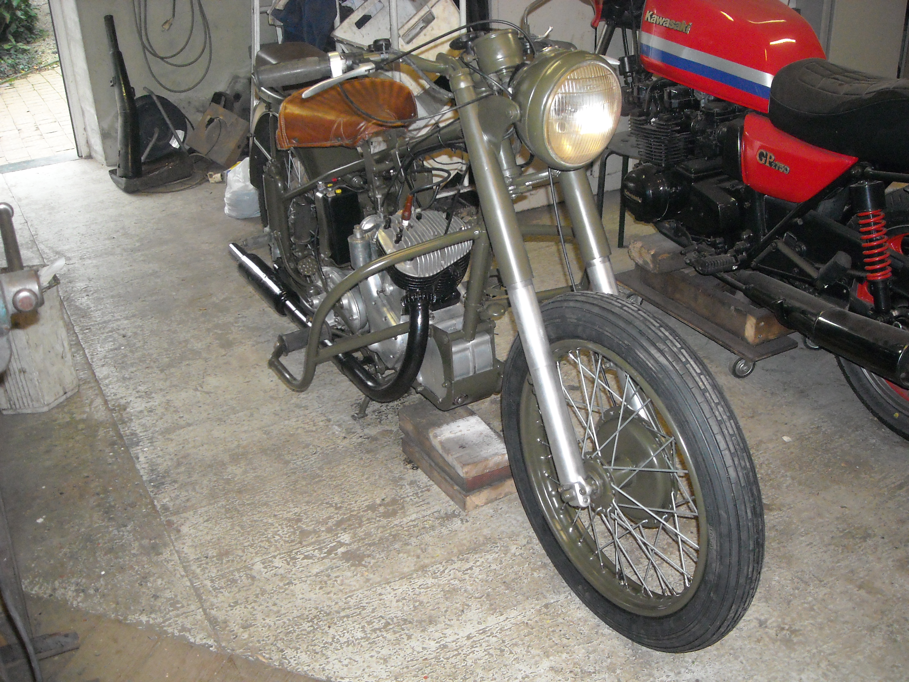

this morning the spokes for the front wheel arrived, finally !
They were mounted and afterwards, this afternoon, I mounted the tyre.
Finally I could put her back on her wheels. Now it's only a matter of time before the second tin of paint is available.
If the temperatures stay the way they are I'll be able to end this project very soon.

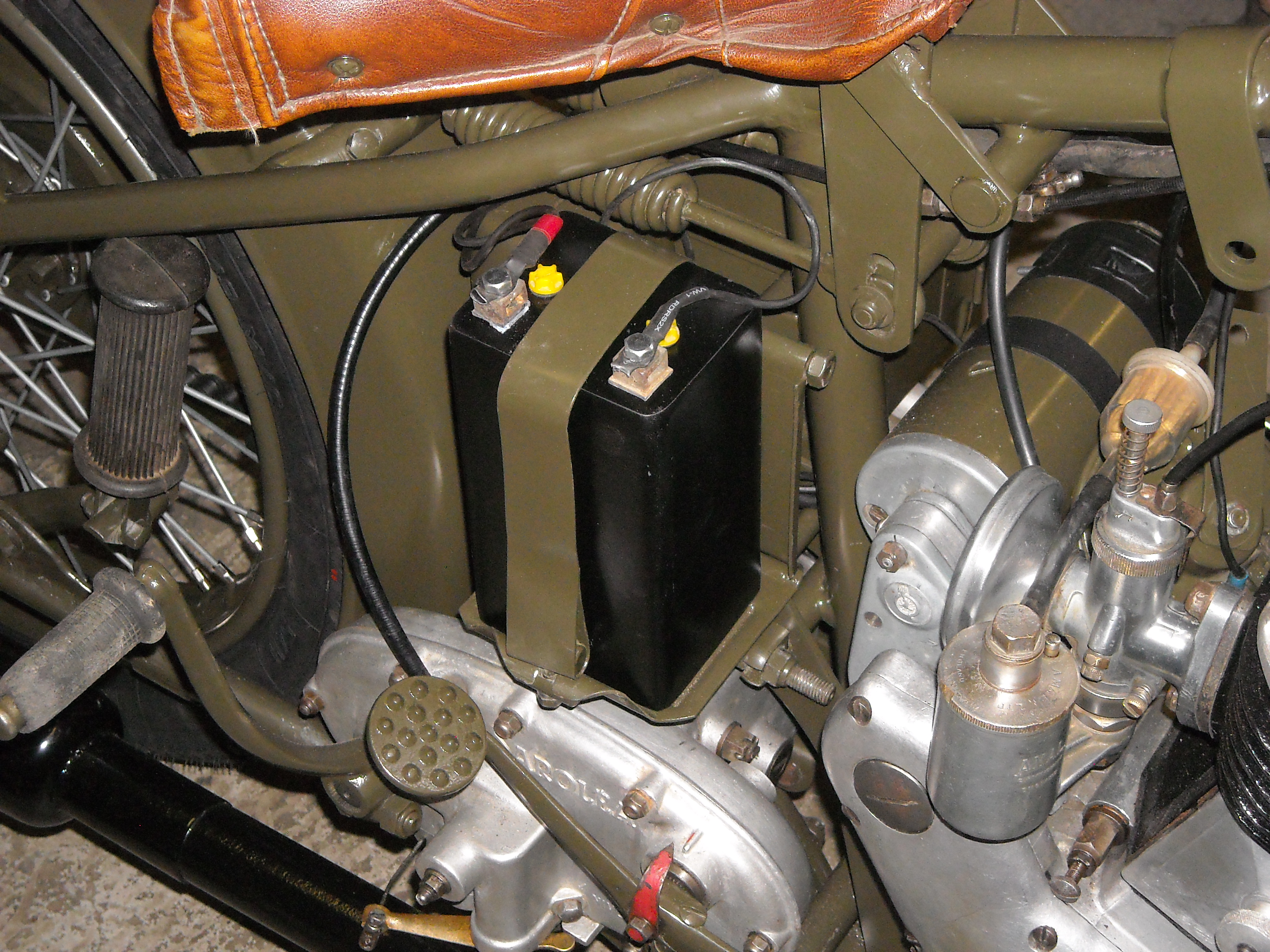

The engine doesn't need a battery to function and my friend doesn't want to buy one, it would only deteriorate by standing unused.
So I asked him if I could make a fake battery and mount it to the bike.
He agreed and this is the result.
It's made of wood and painted satin black and I used some parts of an old battery to make it look a bit like a real one.
The wood came from an old wine crate...guess what happened to the 6 bottles of wine that were inside.

Hi Philippe, looking good! I can’t see the fuse holder from the battery though!

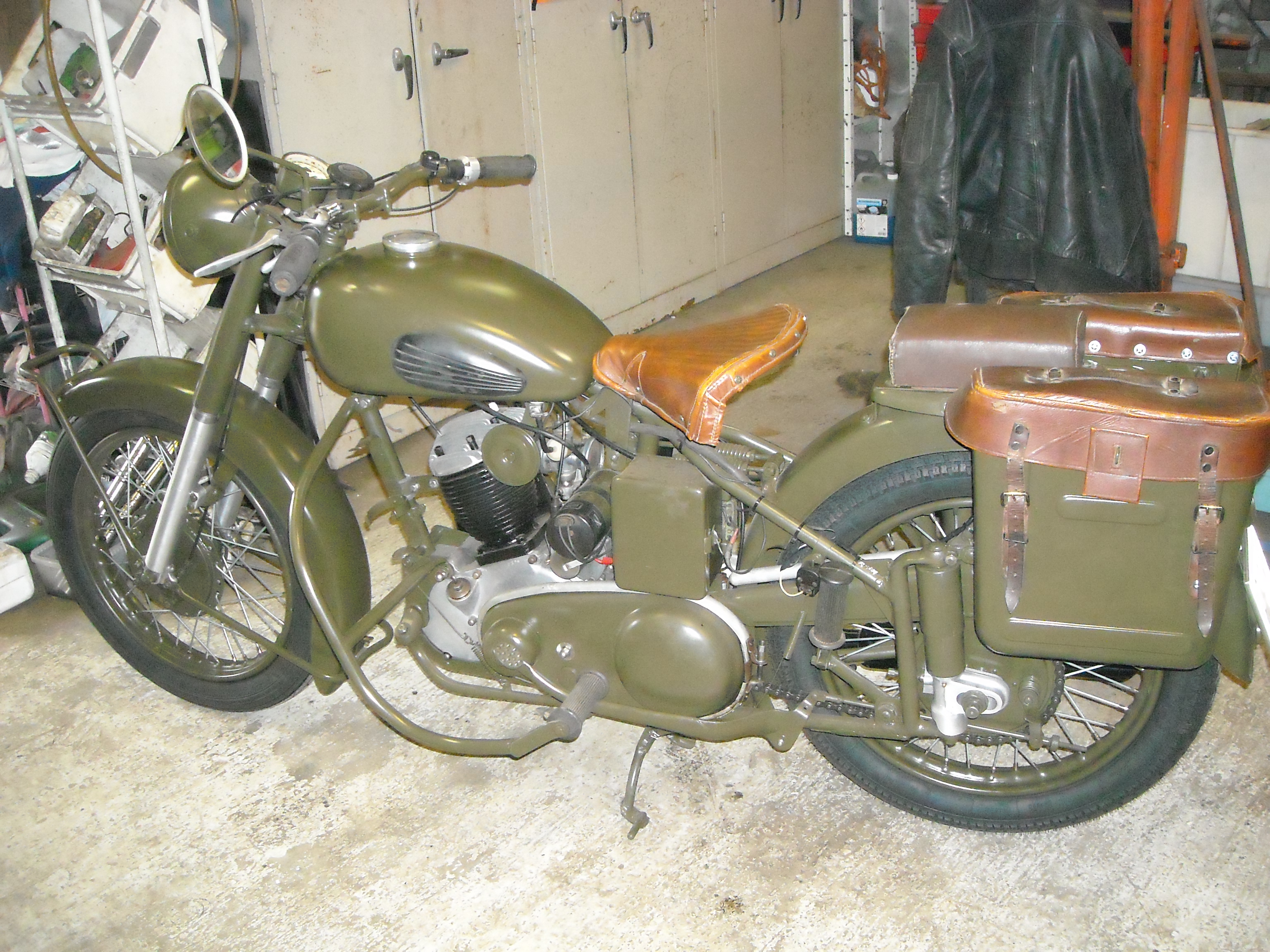

This is how the Saroléa looks now.
The bike is now back to my friends place. A more knowledgable man will do the fine tuning (ignition, clutch, ...) so she can be used on the road once again.
Another mission completed!
