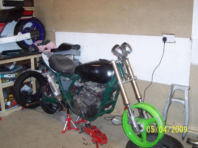

At some point in the long and distant past, from my "shed".
I have a memory like a thing. You know, a whatsit. A, oh you know an erm...oh man, you must know, a thingy jig...
I have no idea what happened to these? But oil cooled engines do go easily. For me, a marriage made in heaven.
I'll get me coat.
