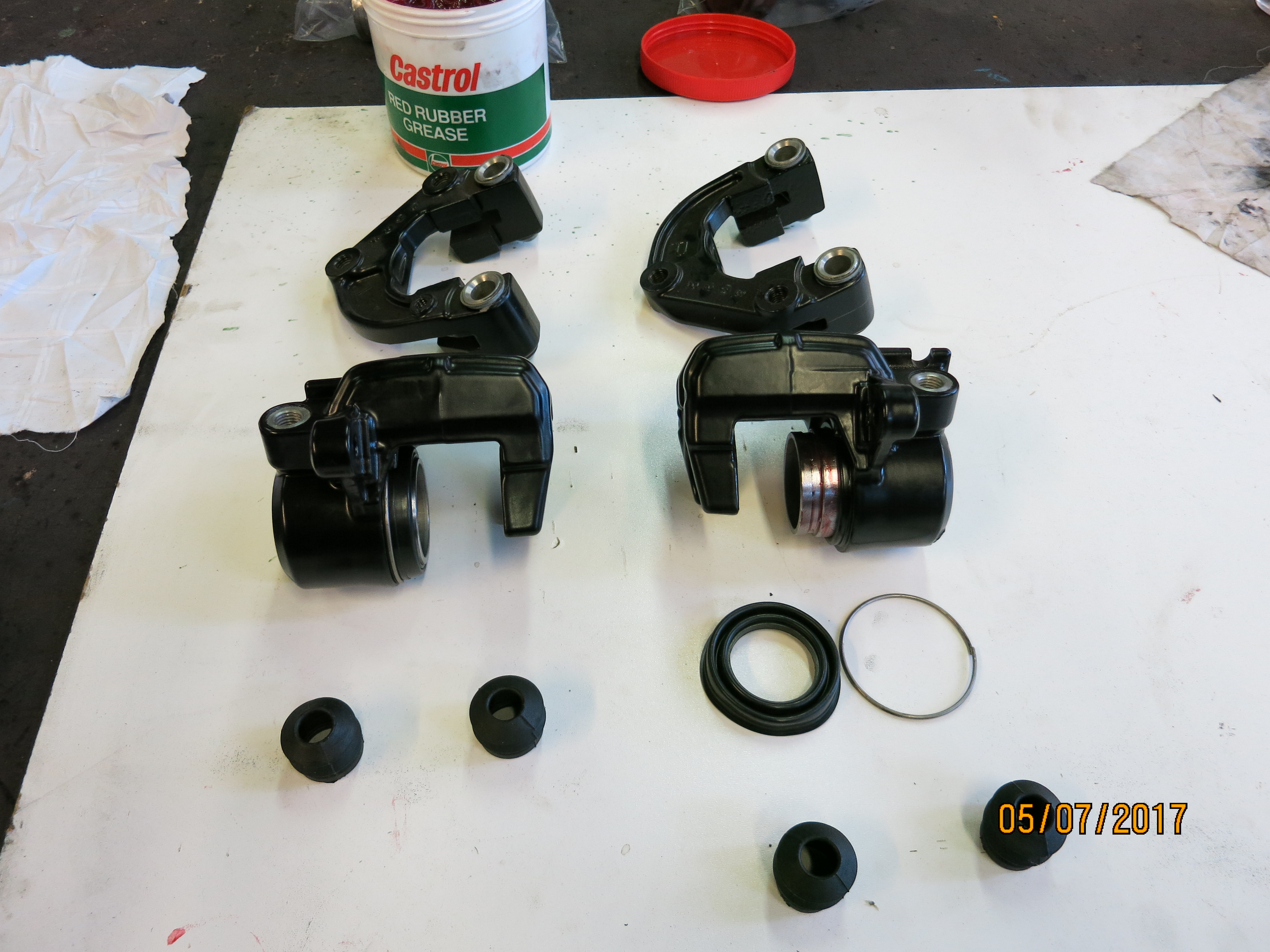

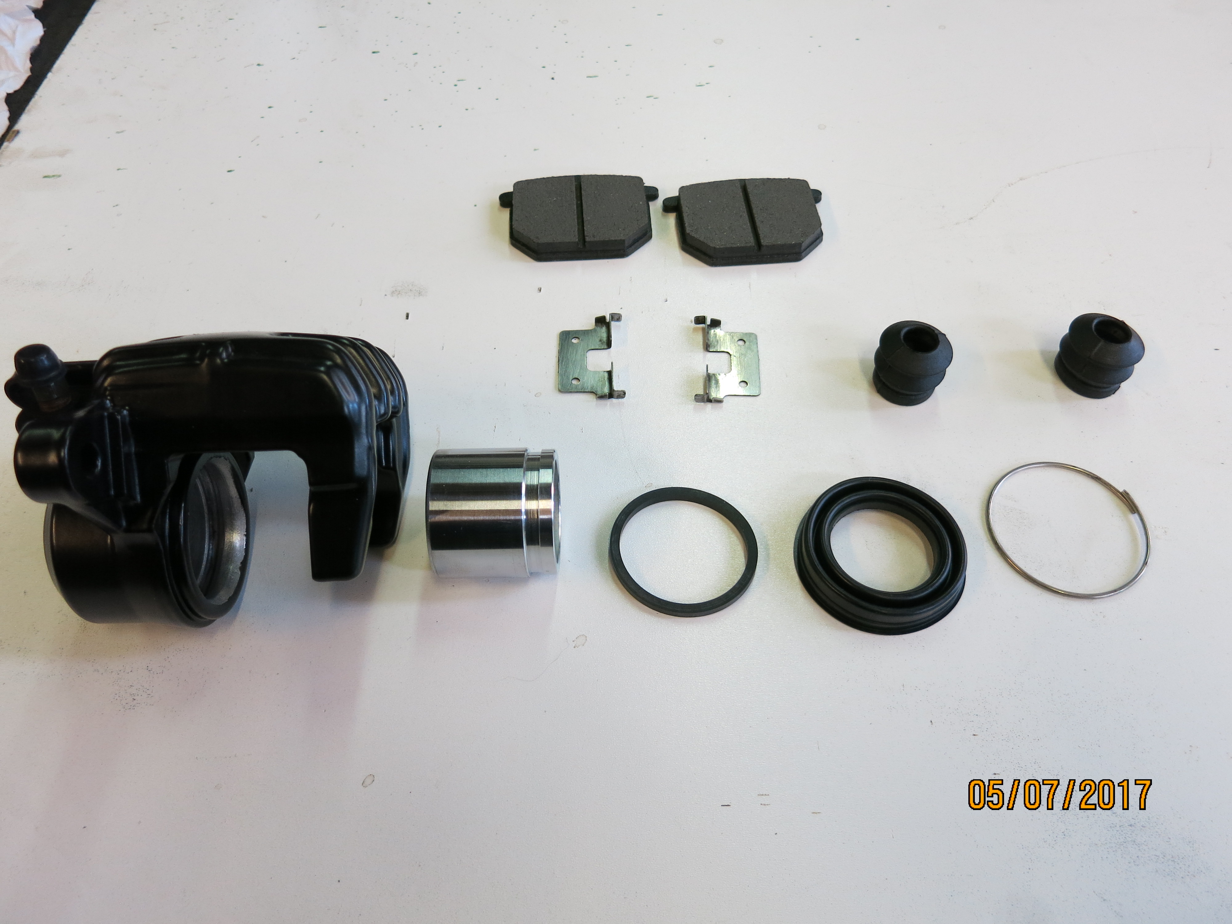

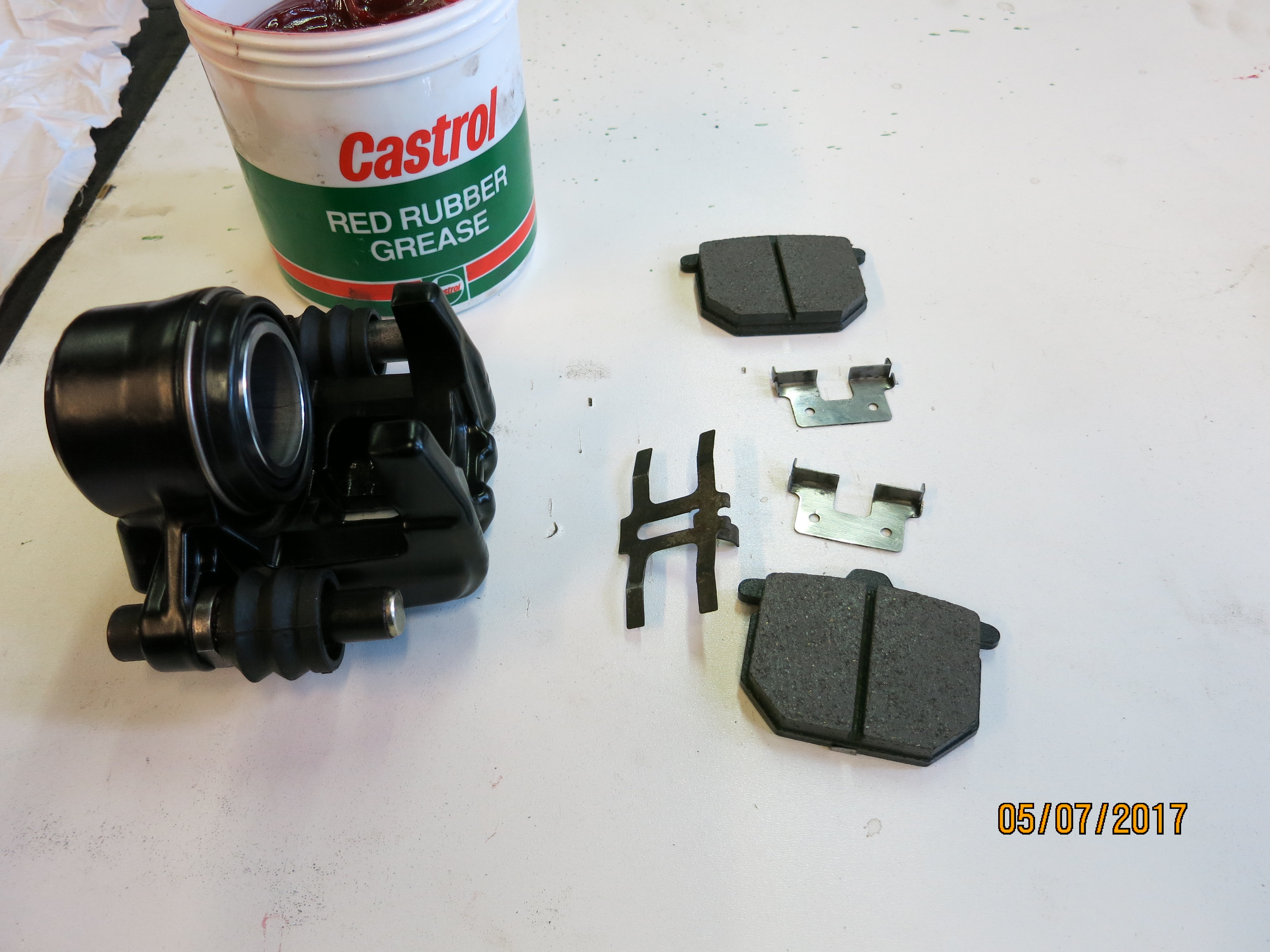

Got front and rear bake master cylinder seal kits, new pads all round and new caliper seal kits, also put new pistons in while they were stripped down. These are some of the few things that are readily available, I think these were from Tourmax.
Some of the most primitive brakes there are..............

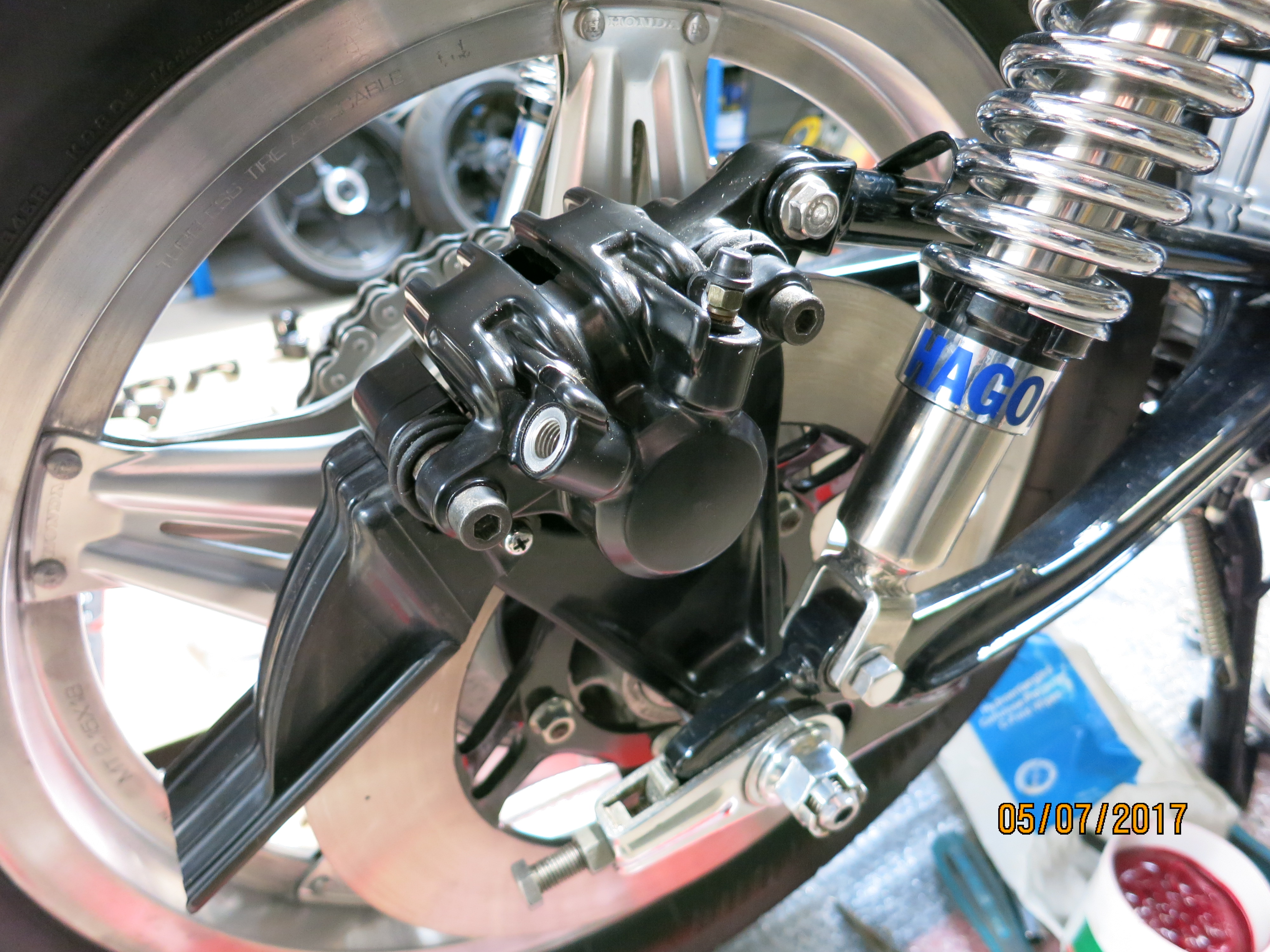

Rear caliper assembly in, the period "Hagon" shockers are only on temporarily and will be removed when some original CBX ones I found are refurbished. The CBX ones will probably cost more than Ohlins for the bike by the time they are done.
Front calipers almost done.

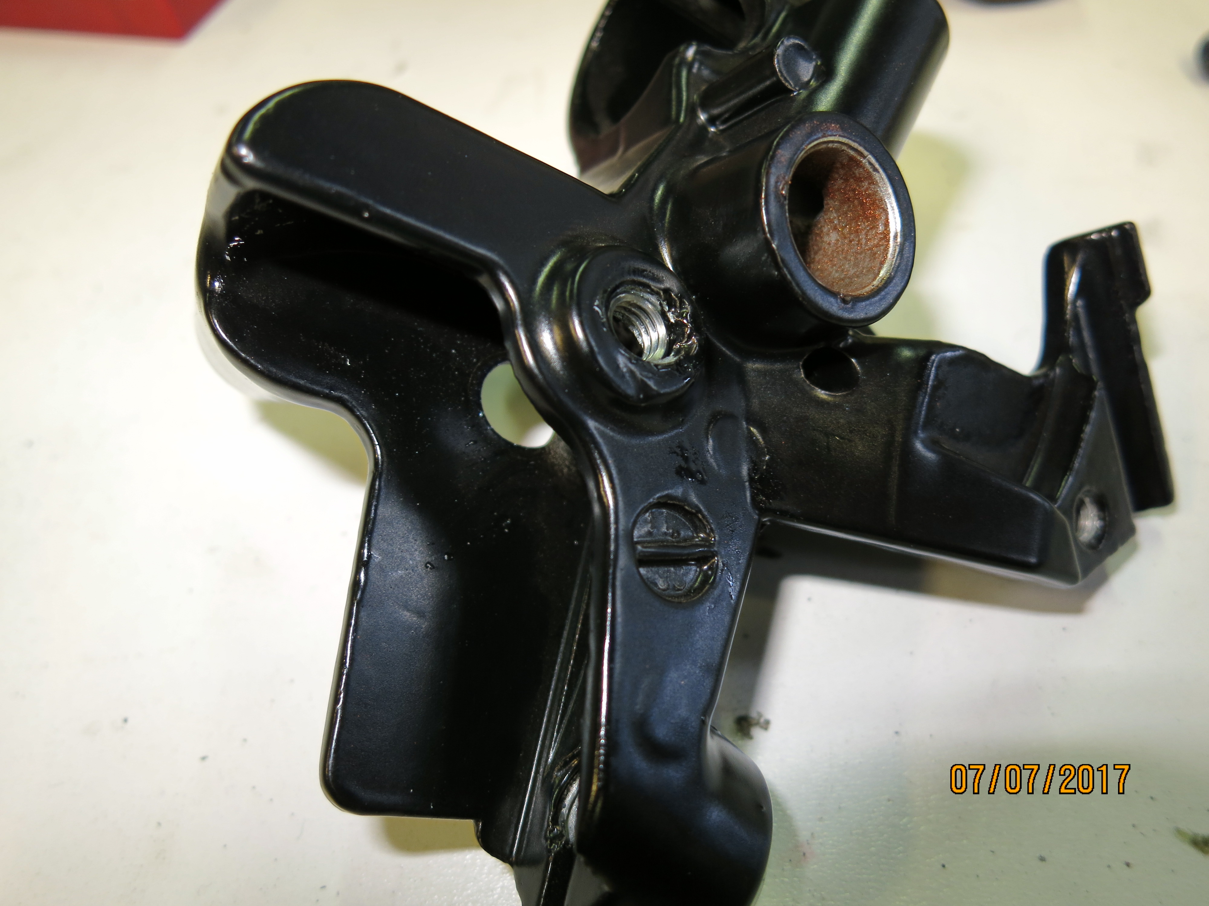

Even at this stage there are surprises. This is the clutch lever pivot assembly off the bars, the 6mm pivot thread was knackered. I think sometime in the past the bolt had backed off and the action of the clutch lever had worn the threads off one side of the hole - you can still see the witness marks at about 2 o'clock above the helicoil. A drill jig was made to drill the rest of the threads out keeping the centre of the threaded hole concentric with the main pivot hole in the top of the assembly. Then a helicoil was modified and inserted into the larger thread, it is only three threads deep but I'm sure the repair is good. A new pivot bolt was sourced NOS from Poland.

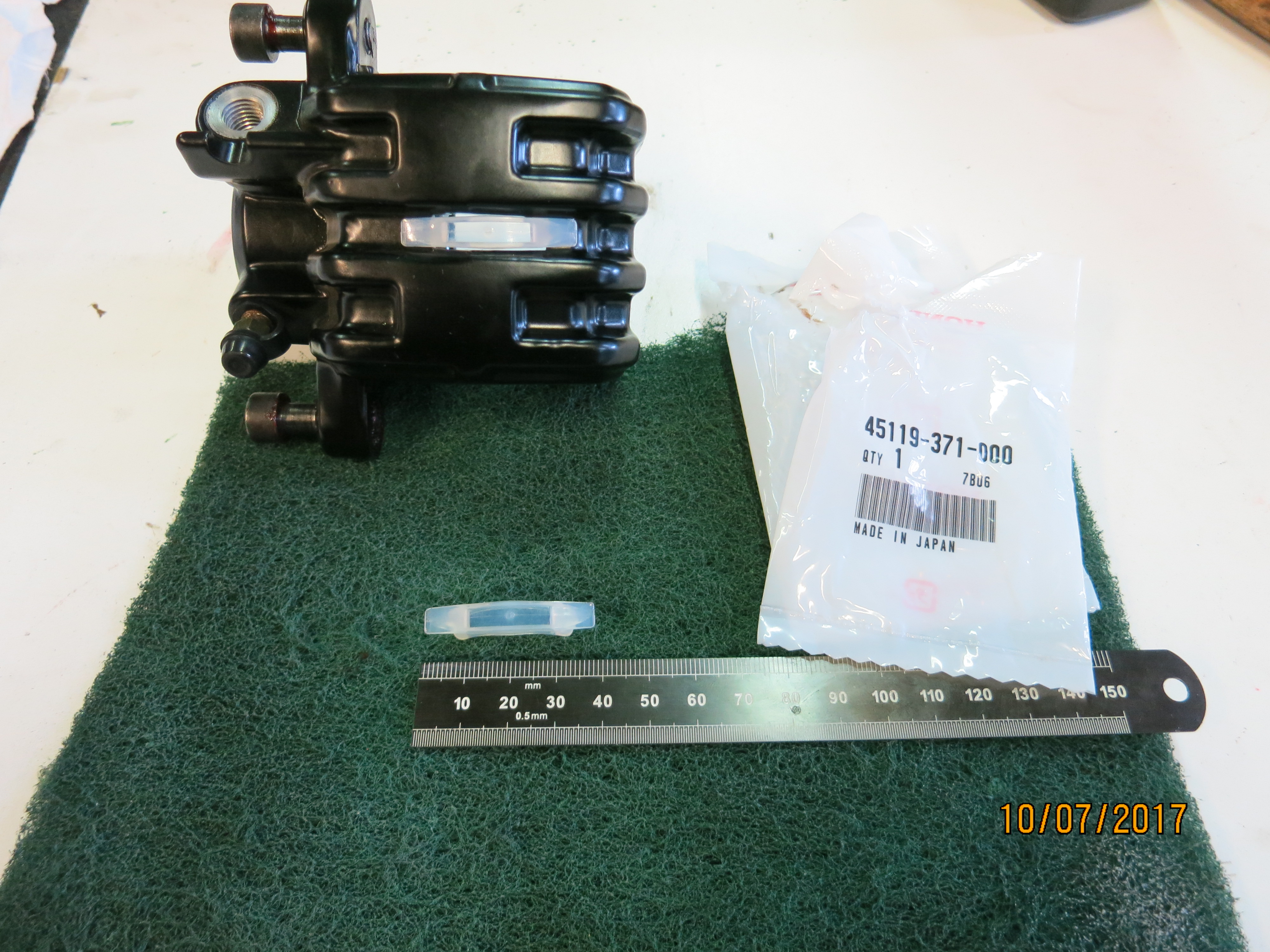

These tiny opaque plastic bits are always missing, this bike had one left out of three. They are just a cover for a little viewing window above the brake pads for wear, another thing NLA and these were from Poland or Germany I think.........£26 FFS!

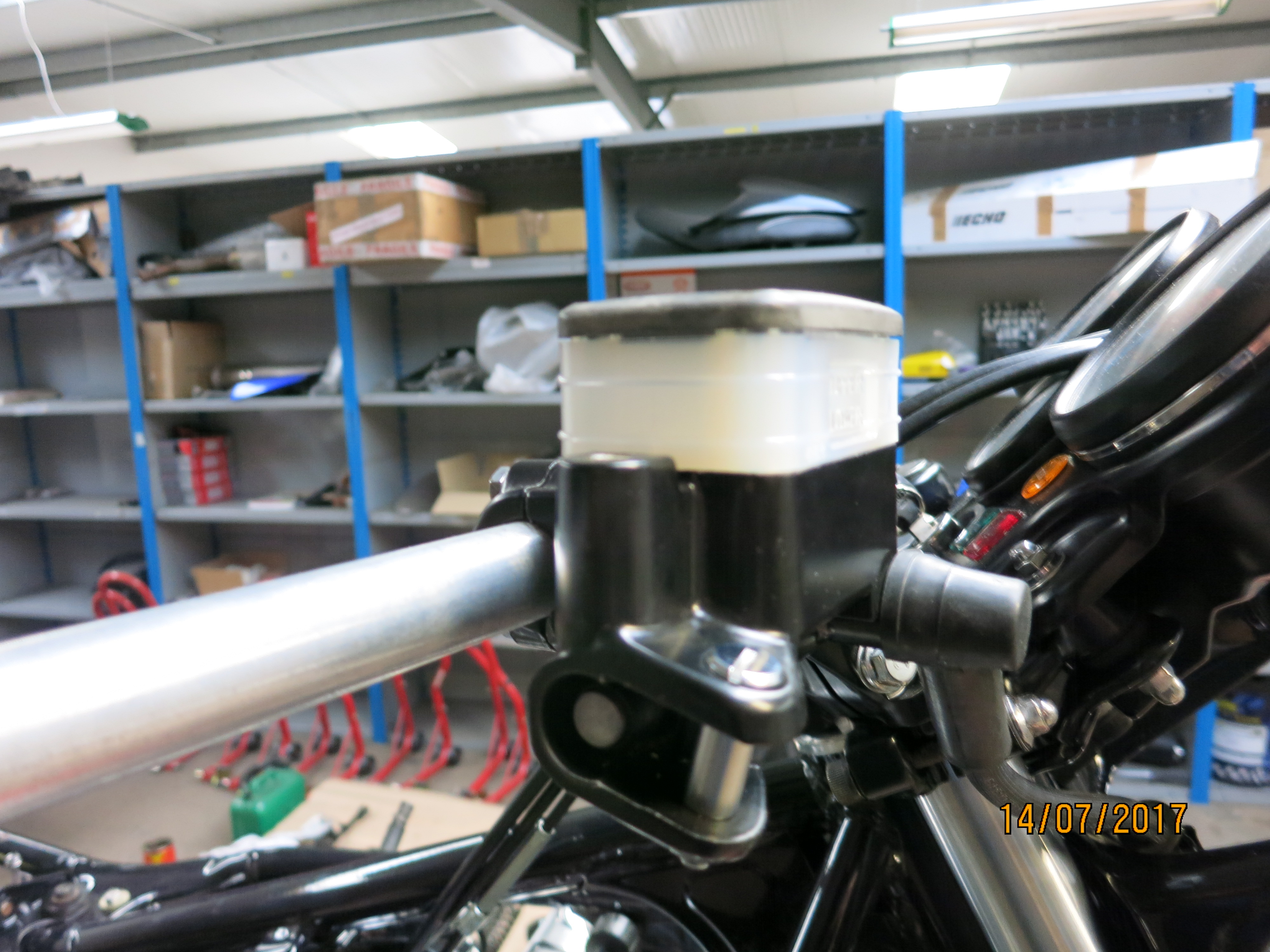

New front brake fluid reservoir, old one was manky and couldn't get it clear again despite several times through the dishwasher. Rear resevior is protected a bit by the side panel so I reused it.

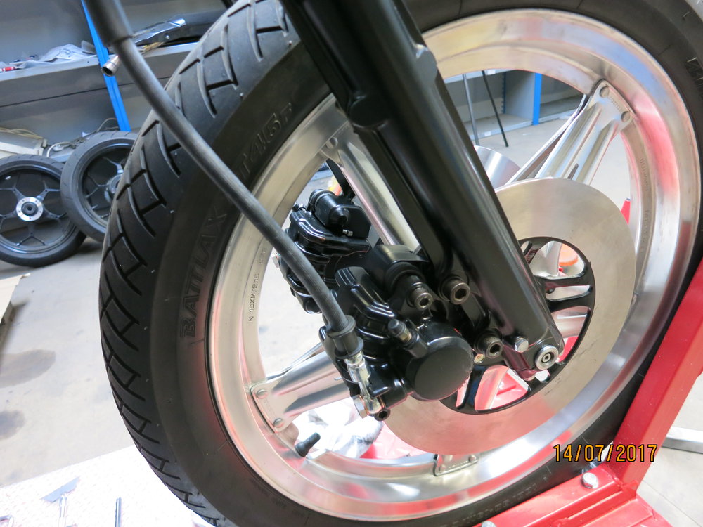

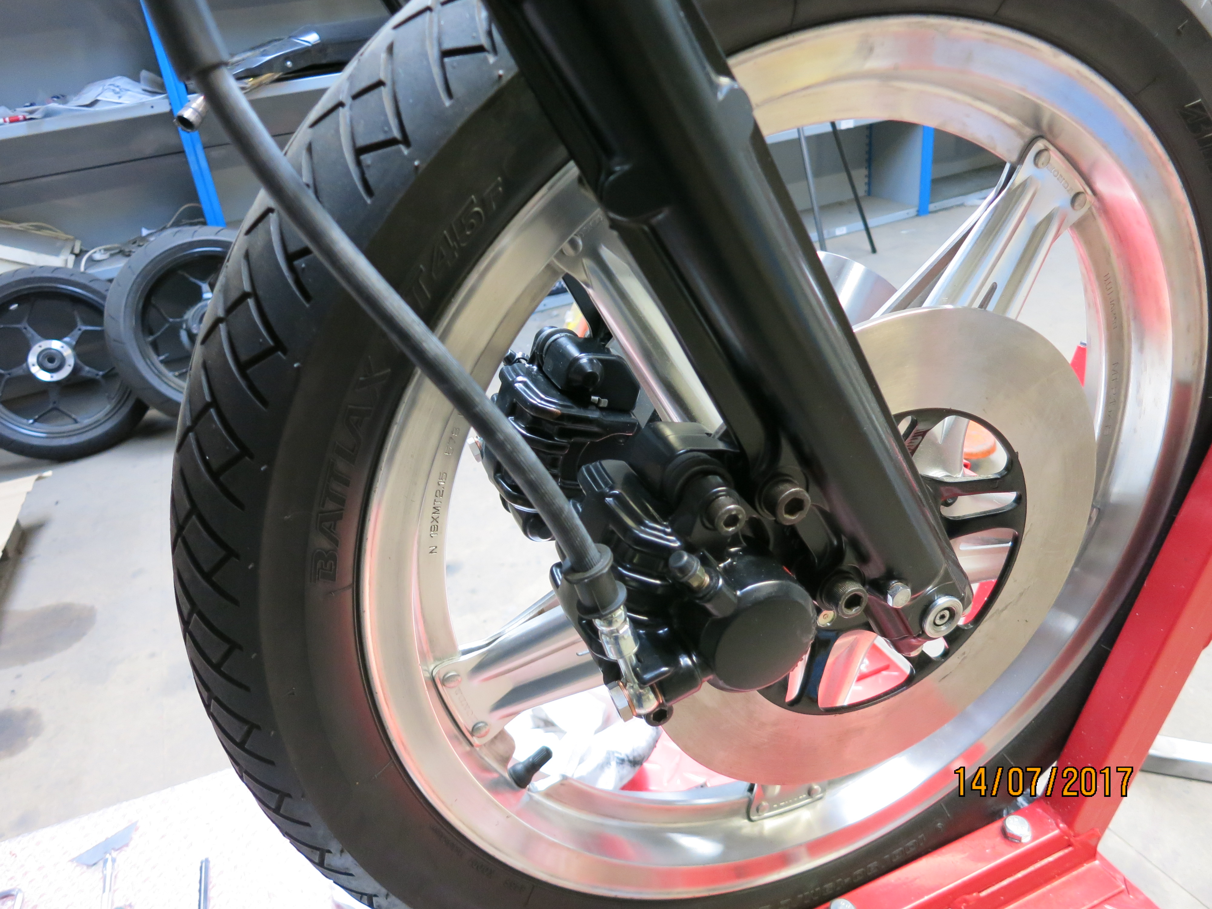

Front calipers on with new set of hoses from Japan (copies, but very good ones). New HEL copper washers fitted. Discs were set up on a mandrel in the lathe and just a few thou removed with a sharp carbide, came up like new and nowhere near bottom limit.
I won't put any fluid in the brakes as it will be stood there for ages, I'm sure everything will be good with hopefully no leaks. All seals, pistons, master cylinder kits and hoses are new so everything should work...........

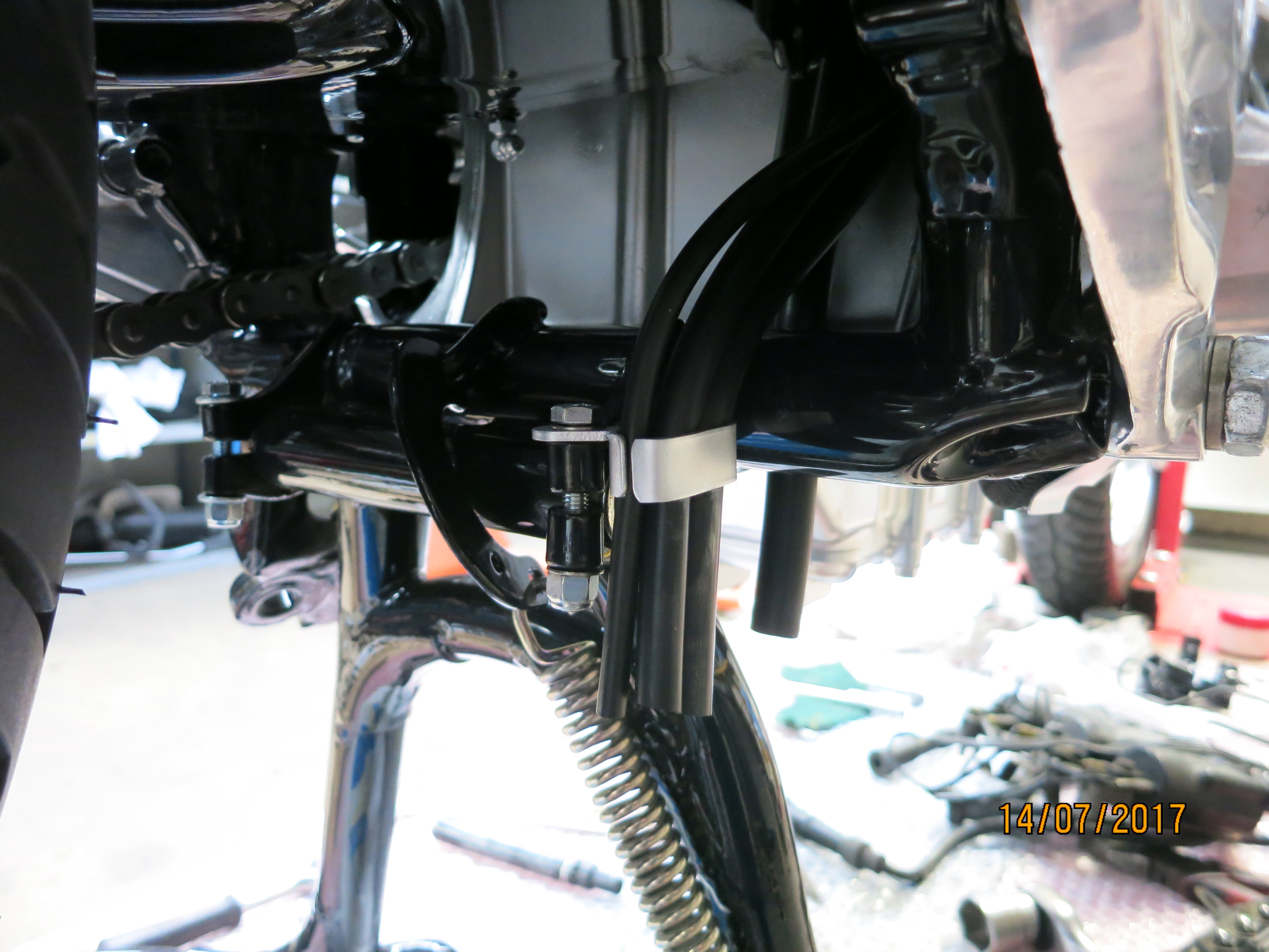

The silver overflow hose tidy off the stand bolt is always missing for some reason, even on a quite un-messed with bike like this. I never found one in 3 years, I did find a couple of 3D drawings and fabricated this one which does the job. I'm sure I could make close copies if I could get a sample.
