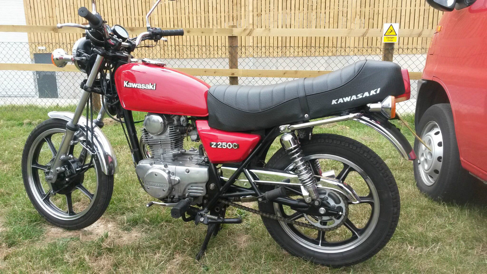

#1 PostAuthor: Pigford » Sat Jun 03, 2017 1:02 pm
Following on from a recent "W650 project" viewtopic.php?f=12&t=39203&start=15 which after a good inspection I sent on for a tidy profit, although that was not the initial plan, but it was too far gone!
With that profit I decided to "re-invest" rather than let Mrs P get hold of it all......
It was local and running nicely, all 19bhp of it :shock:
Not bad and with the deal for selling the W650, I still have £130 left to spend on this one :beer

She looks nice tidy, that's one helluva seat, in some parts of the world you can carry the whole family including the mother in law :mad :mad

Love the little ones, great fun

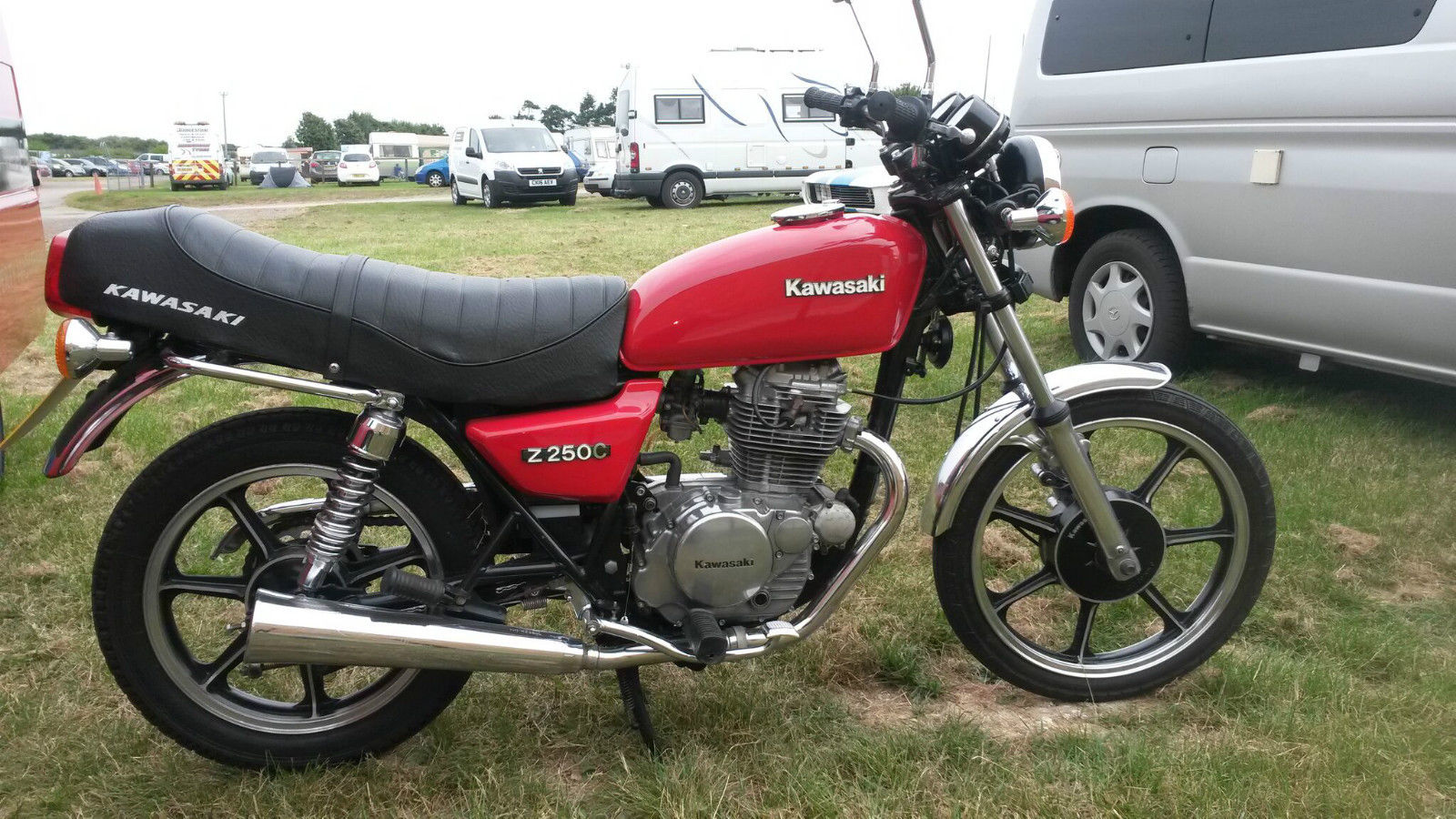

Spent the last couple of evenings "settling" the little bike into its new home..... new plug, new HT cap, fresh plug & oil, pumped up tyres and general check over.
One reason the bike came cheap was it had a tendency to cut-out at high revs, so I stripped the carb, checked float levels, jets, needle setting, points, timing, etc. Bike starts and idles nicely.
Went out for a longer run today (now insured) and it started cutting out after a mile or so :shock: It recovered if you went careful (40mph) on slight throttle.
Soon as opened throttle started kangarooing - stopped as it stalled and it started up a few seconds later so I got back home slowly.
Off with carb again and also check flow from tank - no shit and fuel cap breathing okay.... has to be fuel starvation?
This time also checked valve clearances and they were both a shade TIGHT :twisted: Set them to 0.1mm and 0.2mm (in - ex) and off for another test ride.
Result... sorted :clap Gonna enjoy riding this thing to work in the sunshine.
