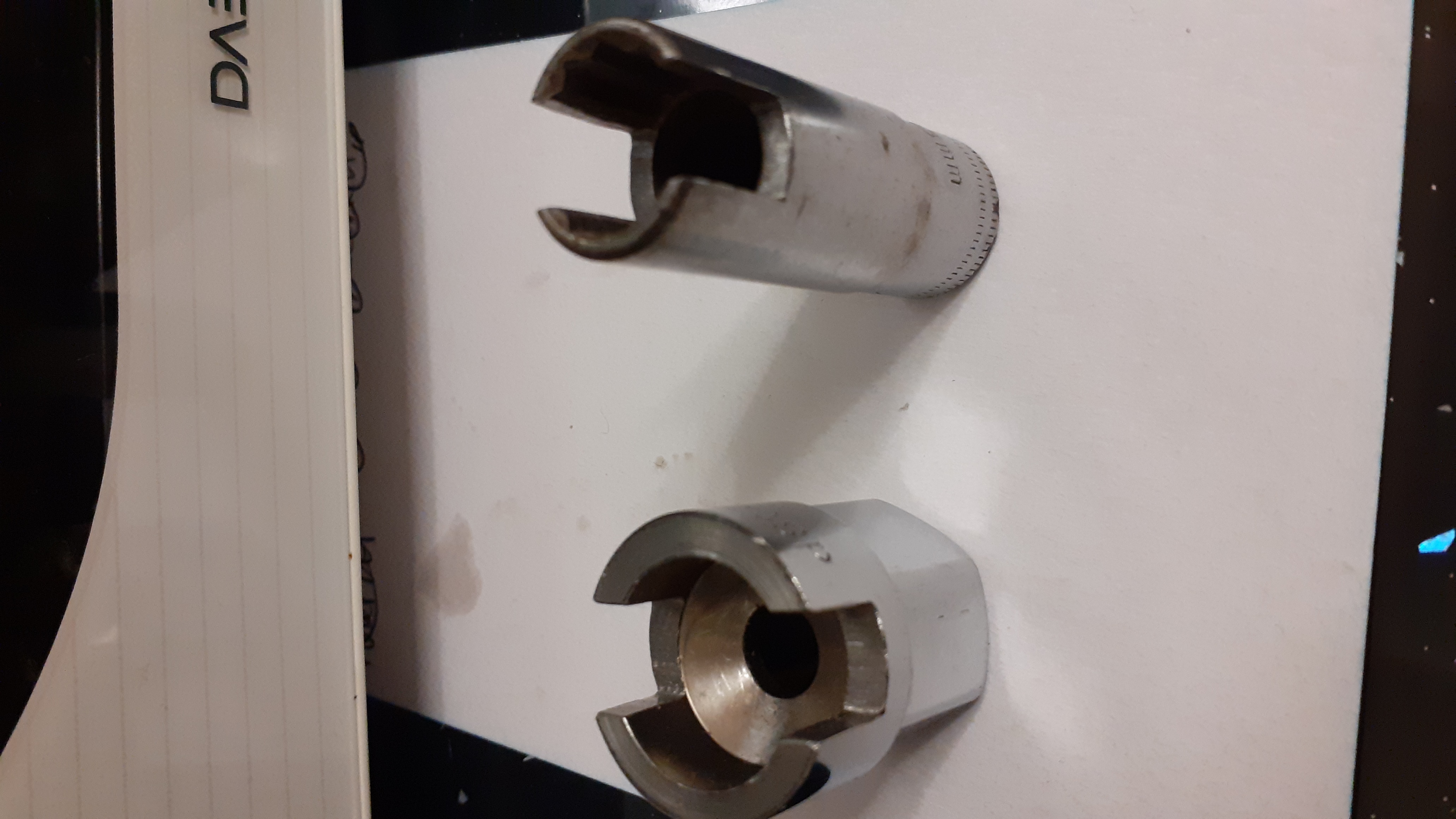

Boyer Jim, easy to fit, only thing i changed is the blue box location, i extended the wiring and located it in the tool box under the seat, i also may have a pair of modified sockets if you wish to borrow them it makes it easier to time up.

What are the "modified sockets" ??

Yep direct from Boyer in Maidstone Kent, I noticed a marked improvement on starting and running, the sockets are modified so you can tighten up the rotor with the pick up plate in situ. Will look for them tomorrow and put a picture up.

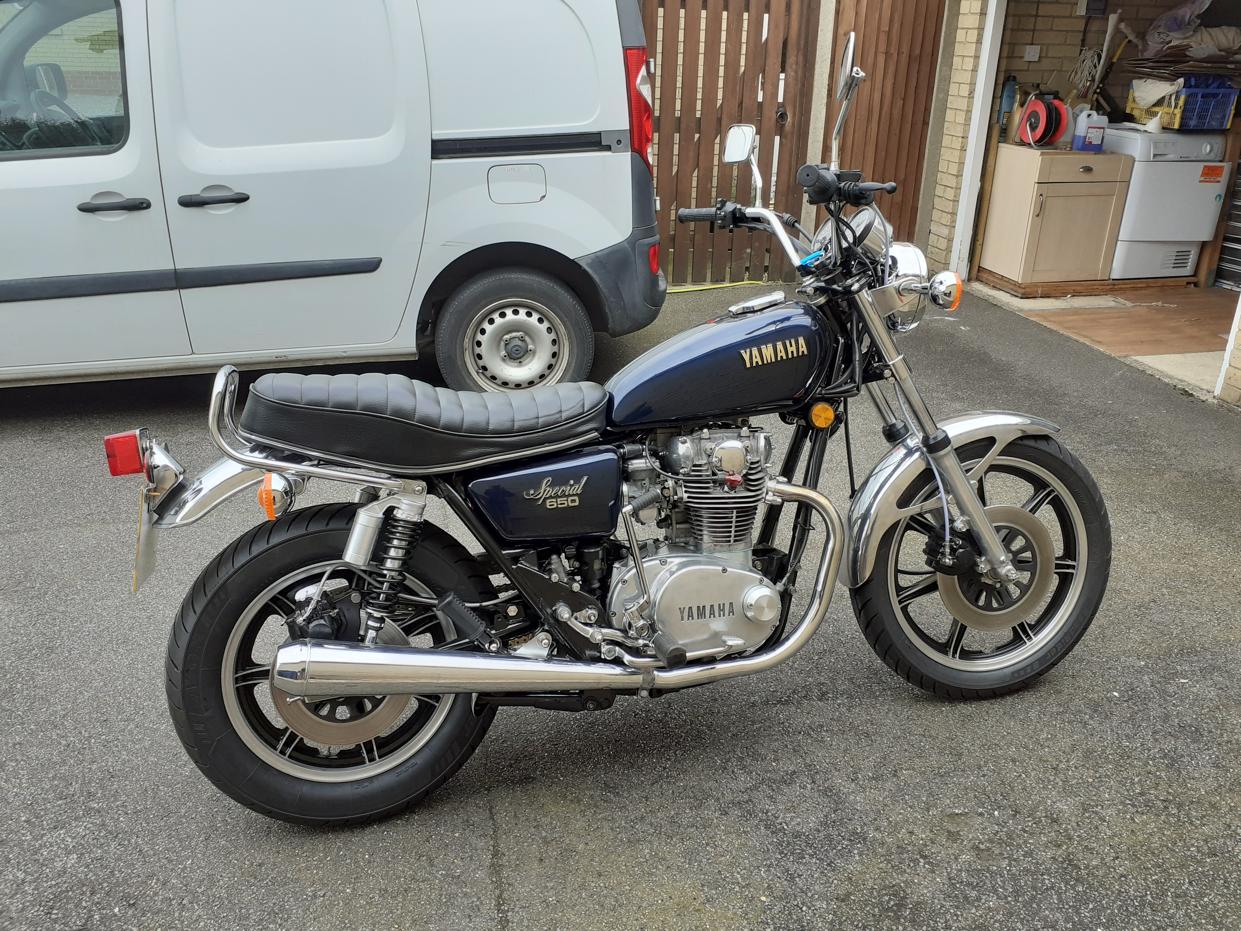

Any photos of your XS's?
I have a UK 79 V reg Special and an import 80 W reg Special.
The W reg has wire wheels, the main reason I bought it.
