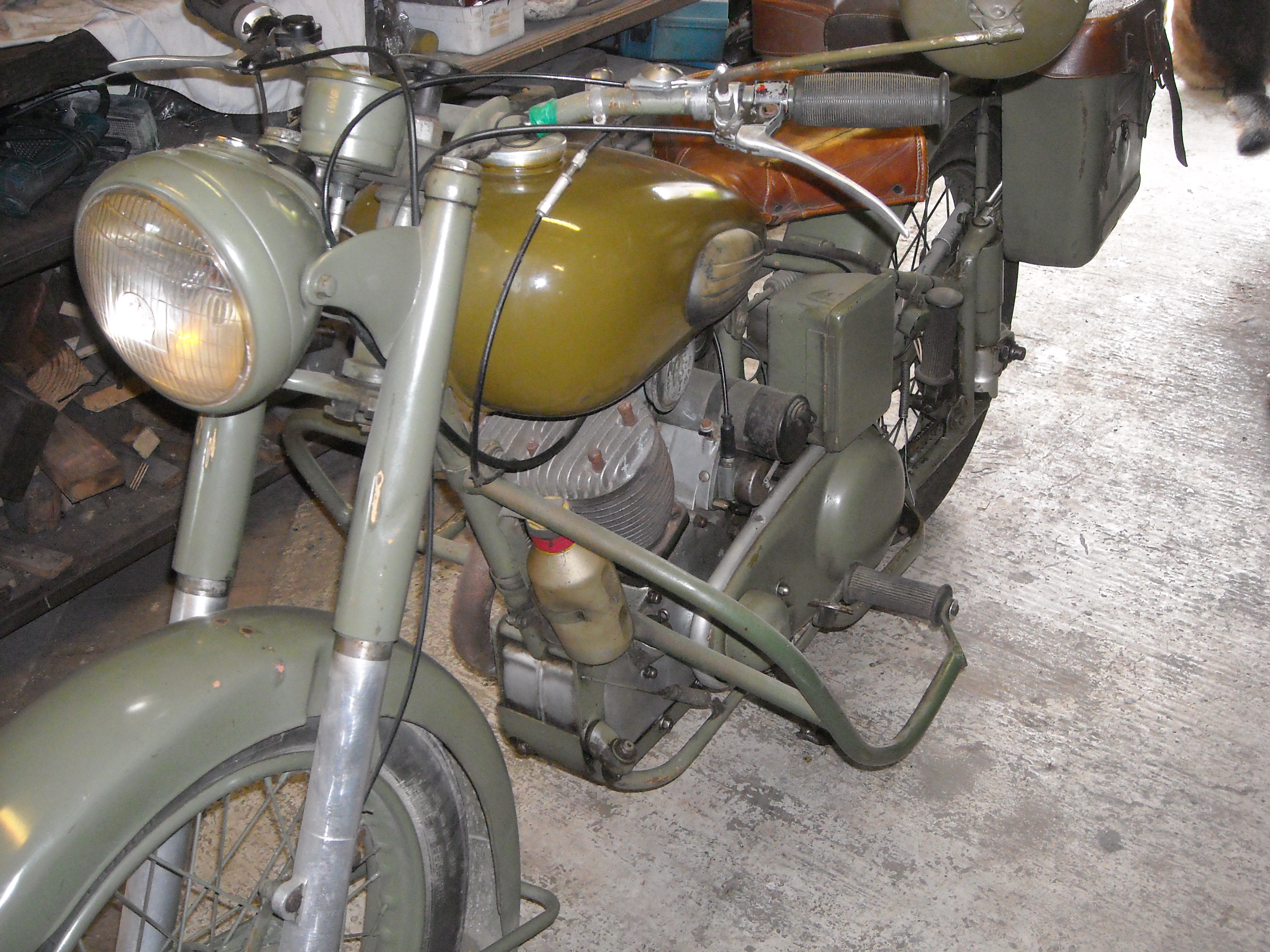

last year my friend Bart bought an old bike, a military version of the belgian made Sarolea Estafette.
He asked me if I would repaint it and I couldn't resist the challenge.
The bike is more or less complete and runs and rides.
It's insured, immatriculated as an oldtimer and he already used it on the road.
A few weeks ago he brought it over to my place.
So today, I started the dismantling of the old lady.
It's quite a different thing to do, and it's so complicated to take it apart.
We'll manage it (I do hope so).
A few pictures. Enjoy them.
The bike before the work started.
The current status.

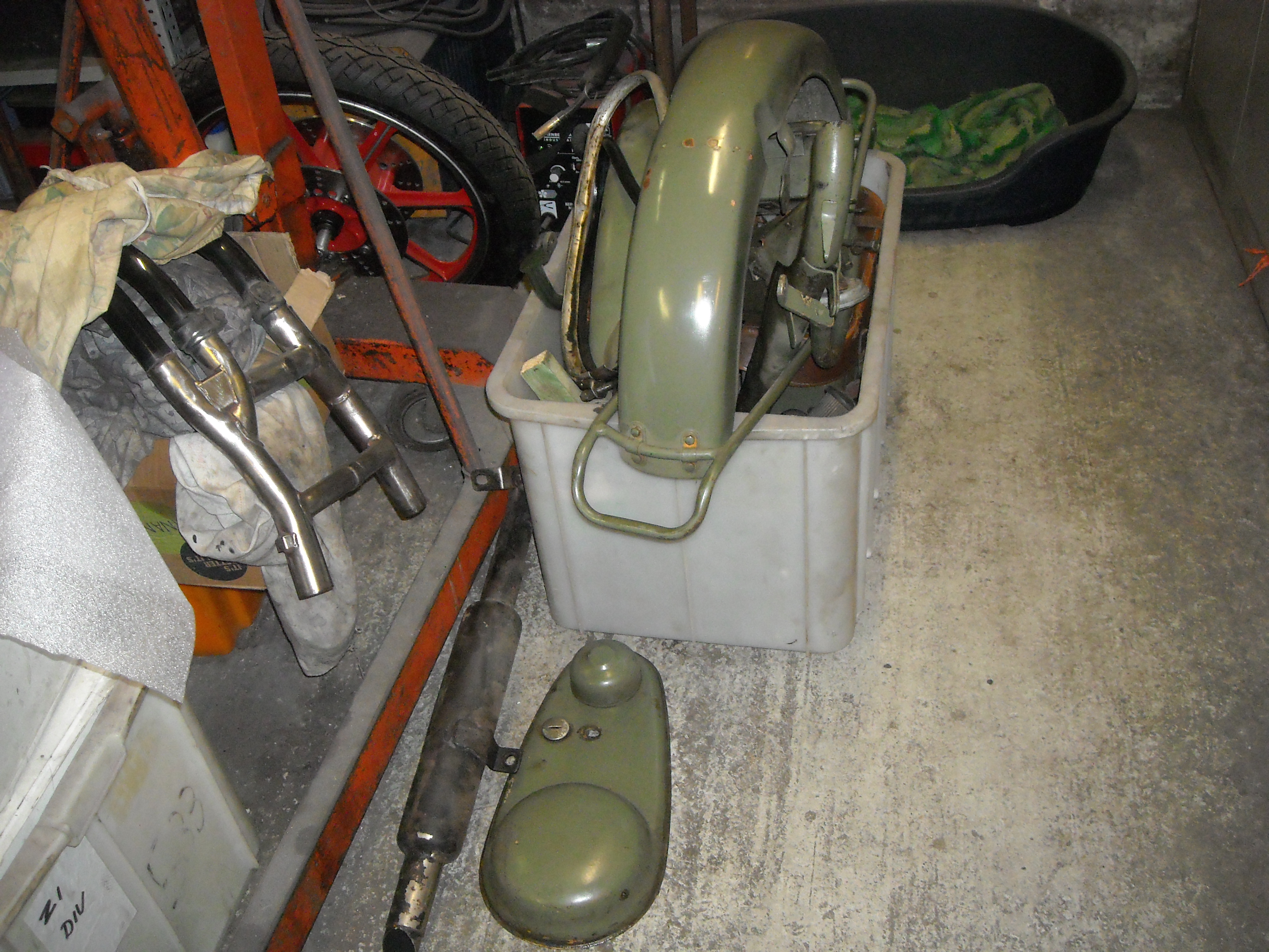

A box of parts.
Perhaps more tomorrow.

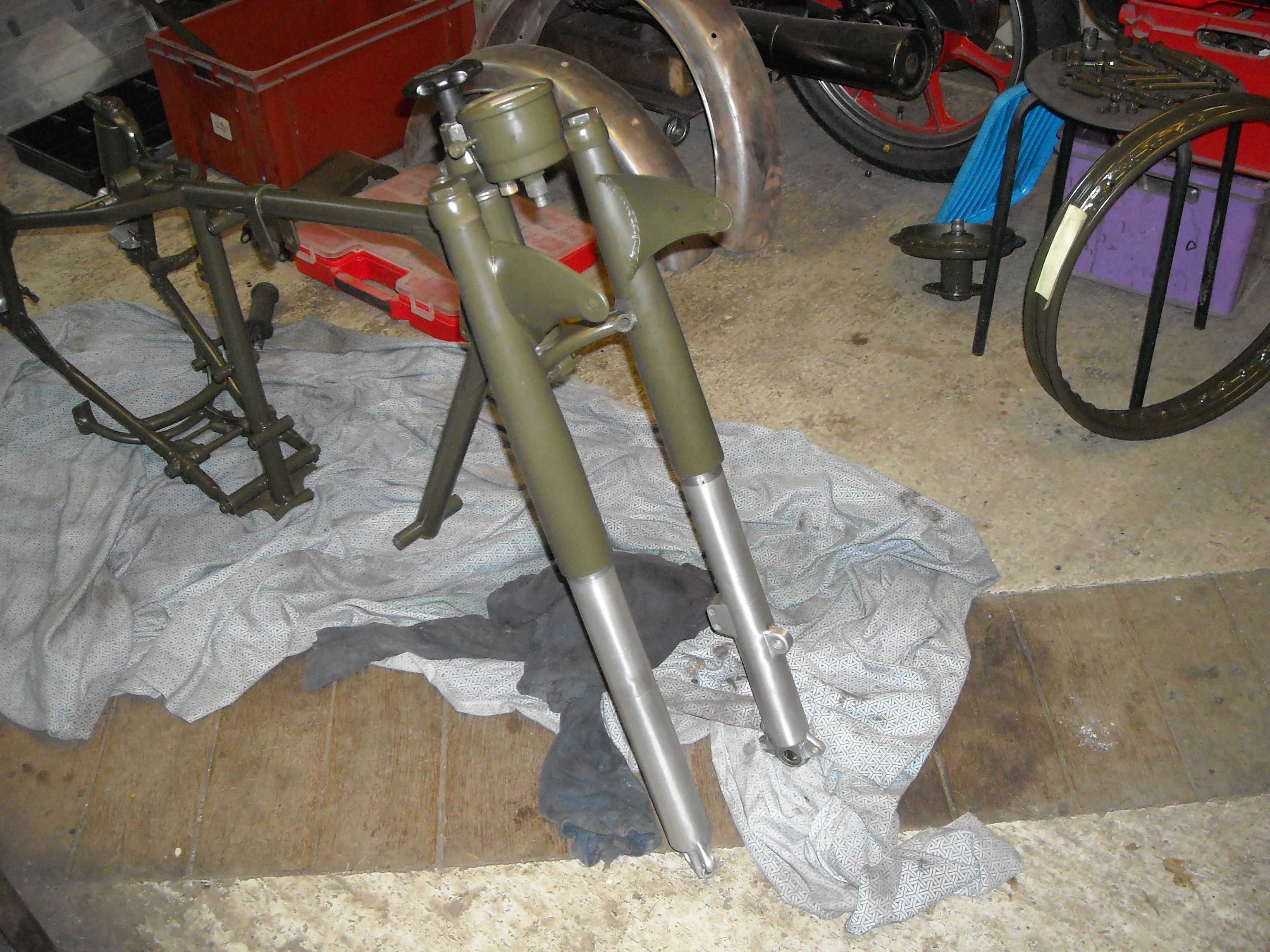

another day went by, some more work done.

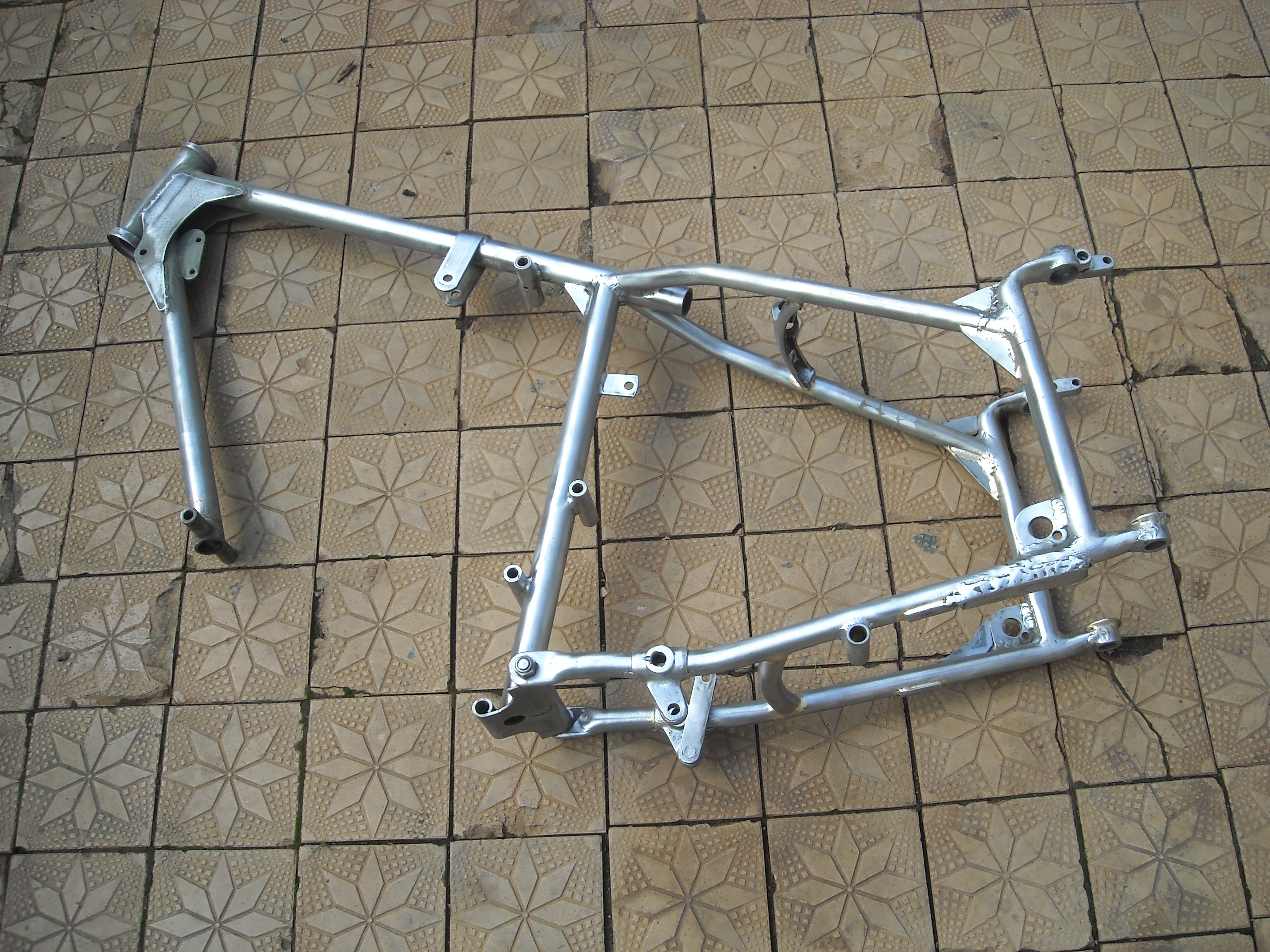

The frame is 99,5 % free of paint,
several frame parts are stripped,
a few stripped frame parts

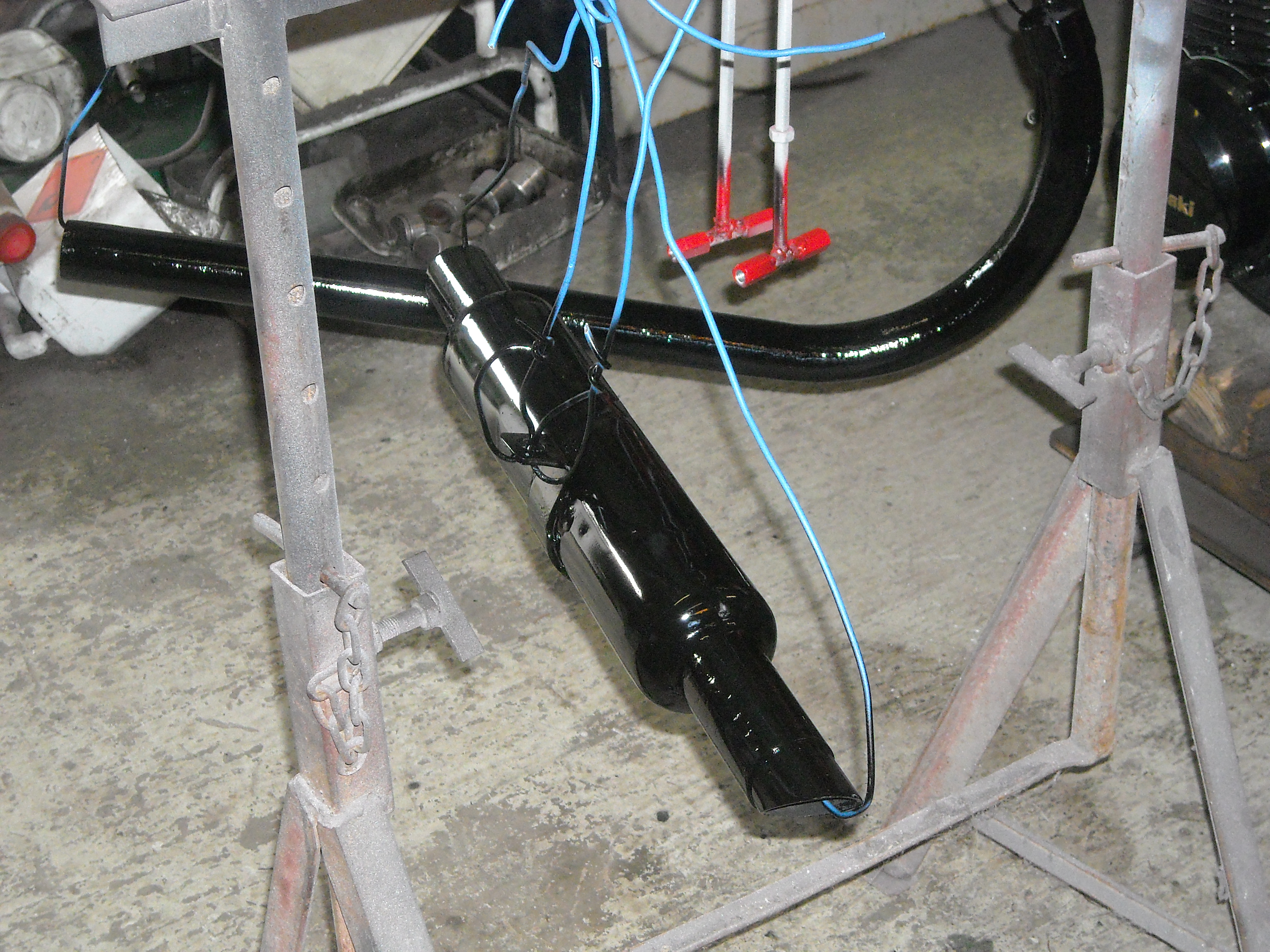

the exhaust is painted,
a few parts which needed welding are OK.
A lot more of frame parts must be stripped but I have the time to do it.

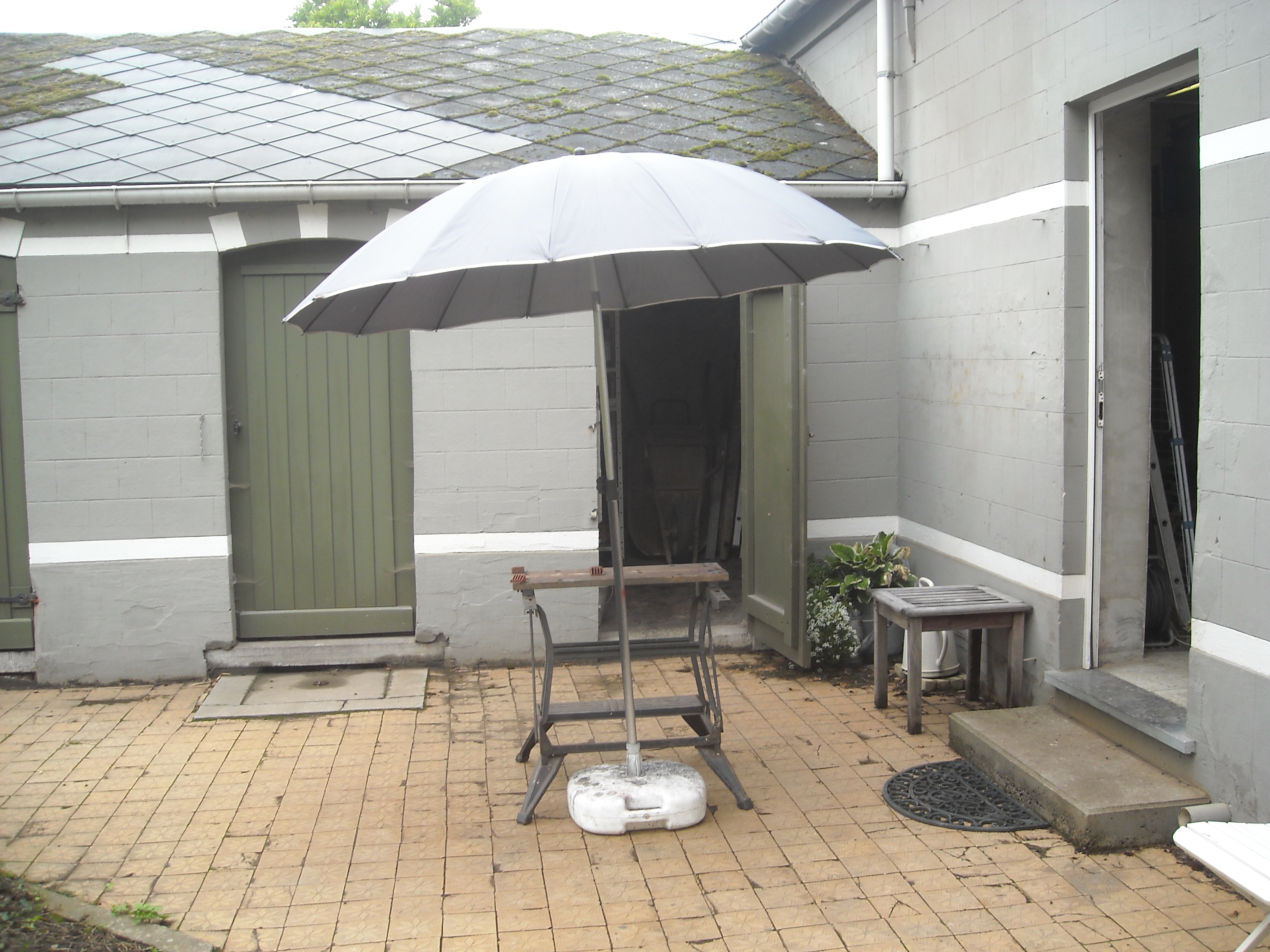

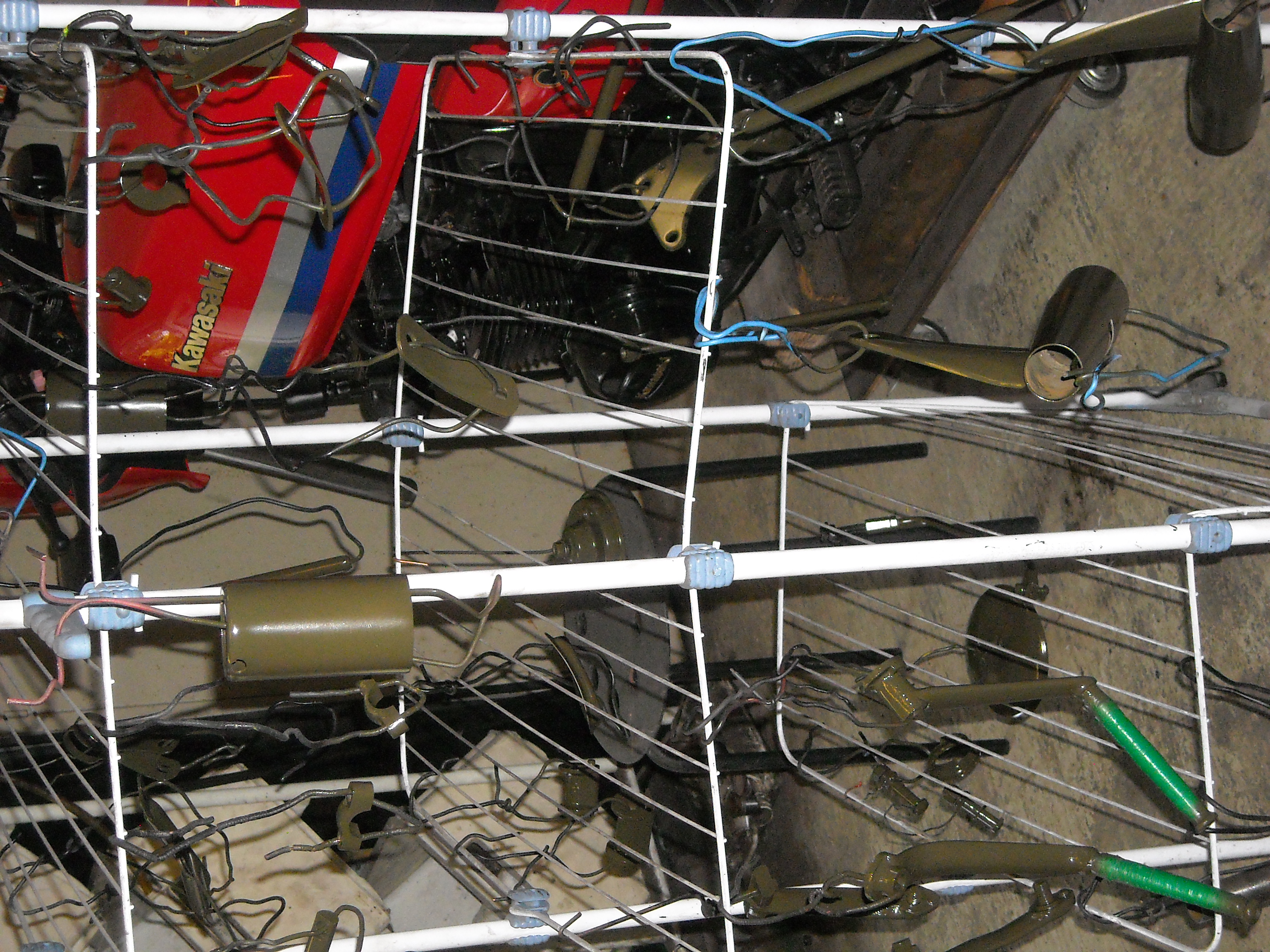

despite the rain of today I managed to strip the paint off from a lot of parts.
My wife came up with the idea of using a big umbrella to work under.
The thing did what it's supposed to do, it prevented me and the parts to get wet.
This is the result of a few days work.
Hopefully the weather is better tomorrow to continue stripping paint.
I noticed that the original paint is very hard. Even after two days soaking in thinner it doesn't come off, it's as hard as a rock.
Who knows what kind of paint they used in the fifties...

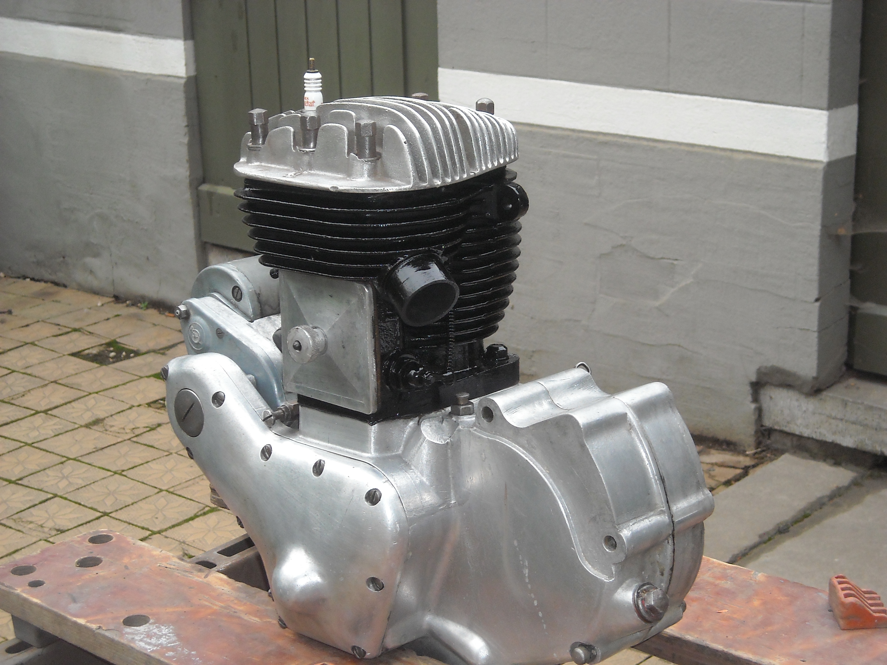

This afternoon the weather was fine, no rain, high temperature so the engine was cleaned, derusted, taped off and painted.

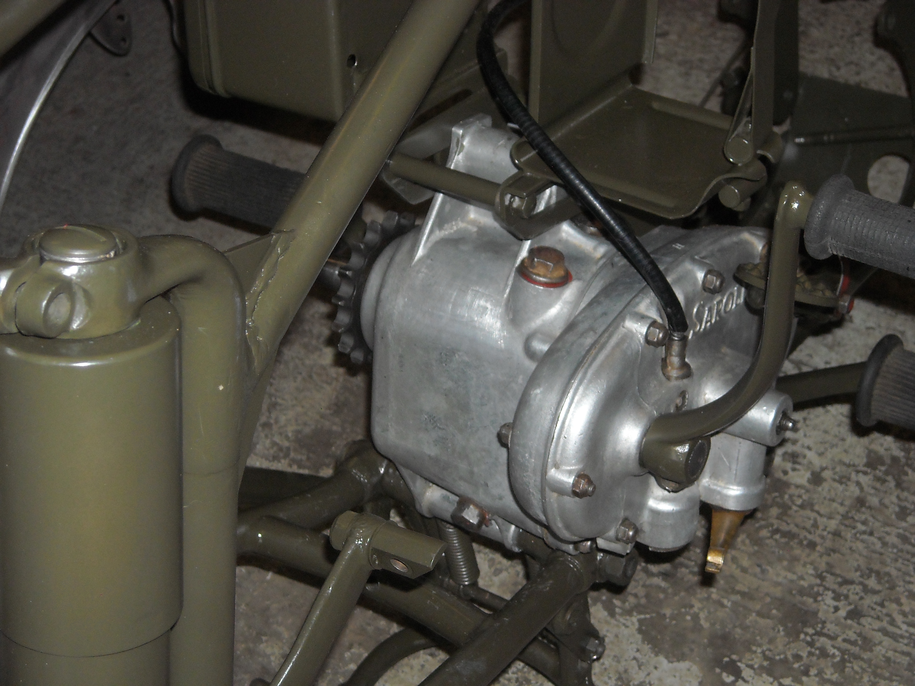

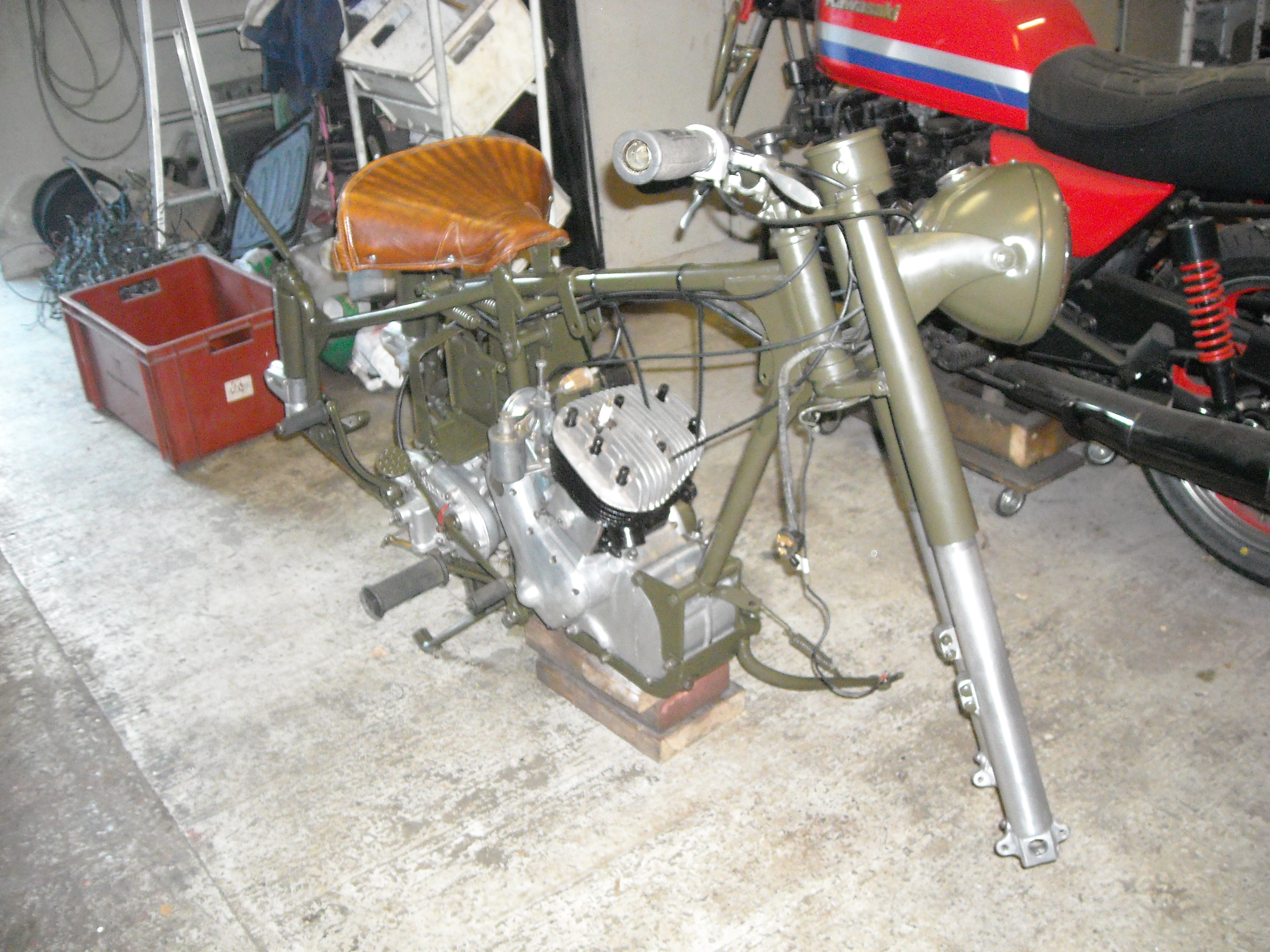

The engine was cleaned, painted and I mounted it in the frame on saturday.
On sunday, I had a closer look at the bike and I noticed that I couldn't reach the bolt to change the position of the gearbox once the protection of the primary chain was on...
I had a closer look in the parts manual and discovered that a thick plate with a rectangular hole in it, destined to receive the bolt of the gearbox, was pointed as belonging to the LEFT hand side of the frame... it had to be on the RIGHT hand side.
I think that the man who made the parts manual back in the fifties did that on a monday after a heavy weekend... :shock:
I had to dismantle half of the bike in order to change the two plates from left to right and vice versa.
But OK, a few hours and a lot of curses later, the plates were on the correct side and the assembly could continue.
Once again I found out that I should have taken more pictures before dismantling the bike. I'm learning from my mistakes, oh yes I am !
This is how the bike looks now
