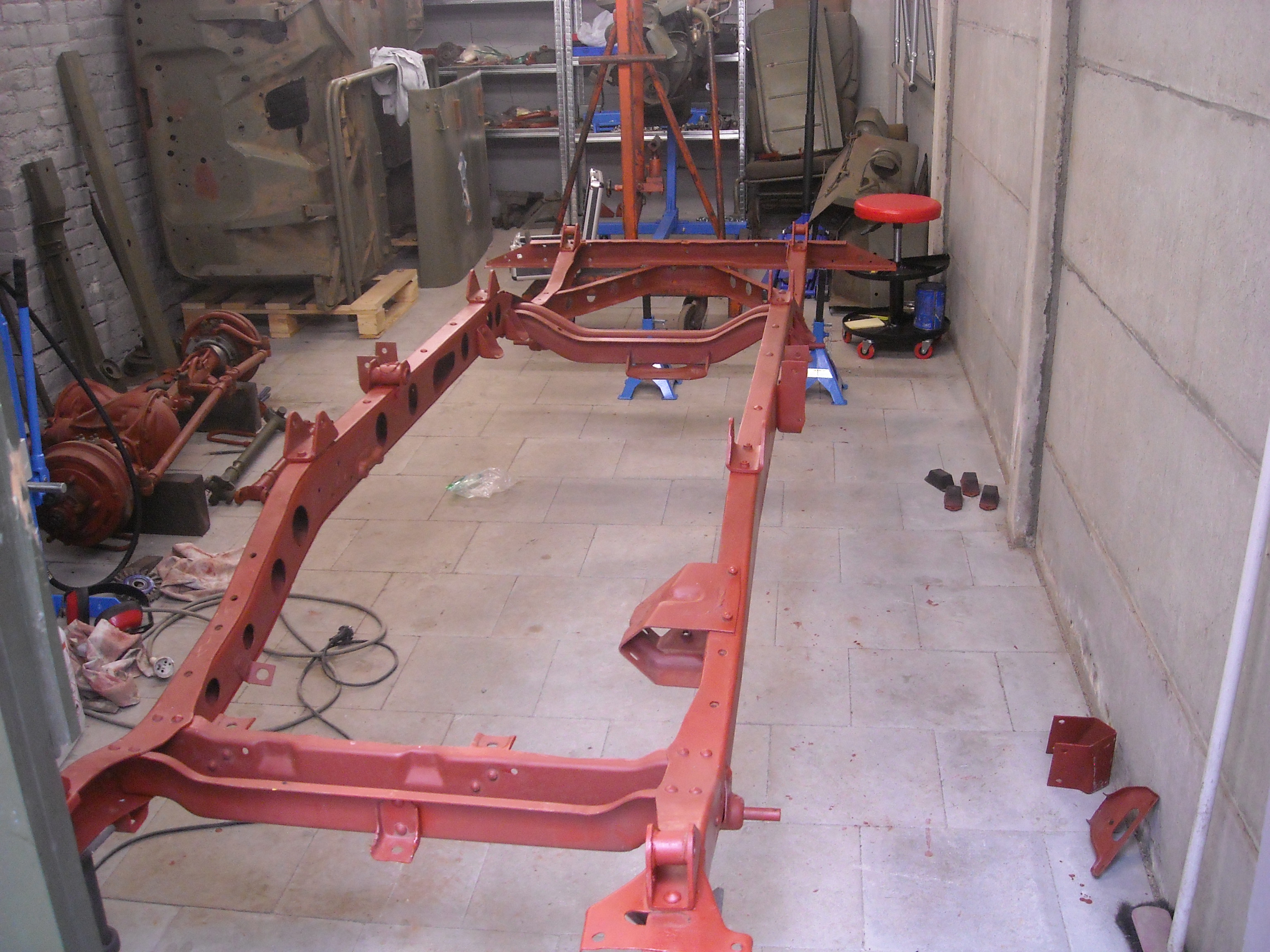

the chassis
The chassis, painted in red oxide primer

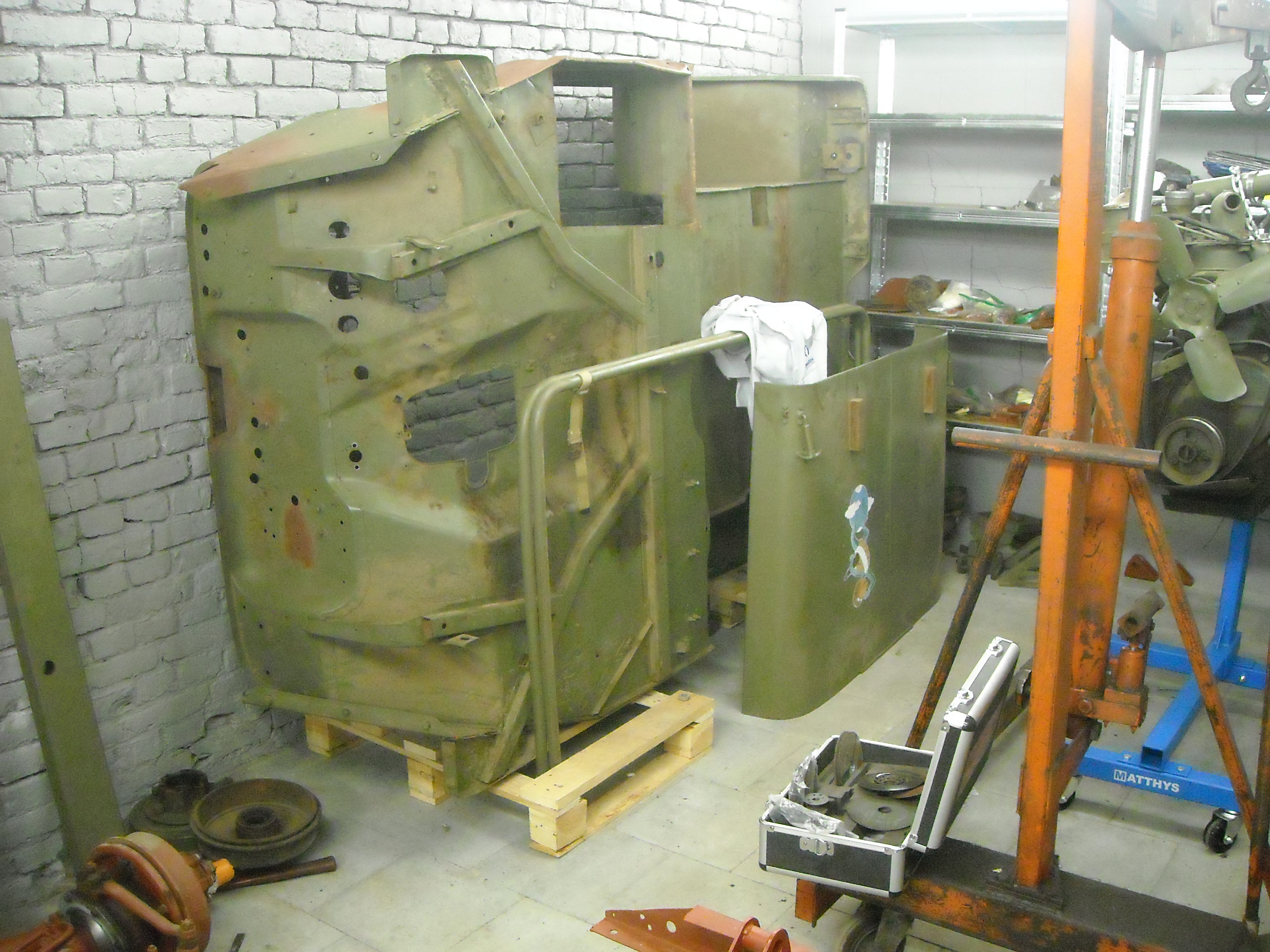

The tub and a few body parts

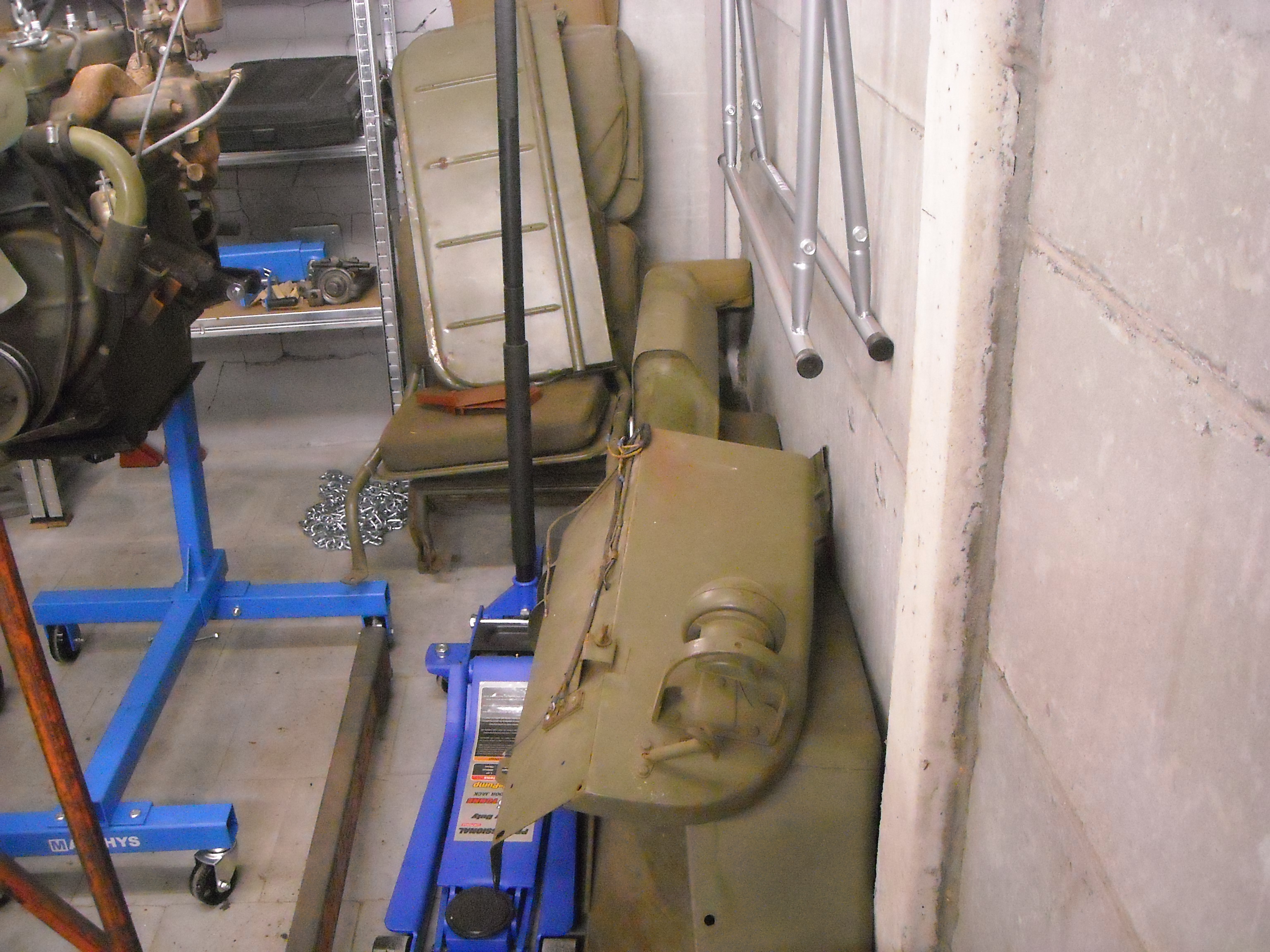

the fenders, seats,...
Fenders, seats, fuel tank,...

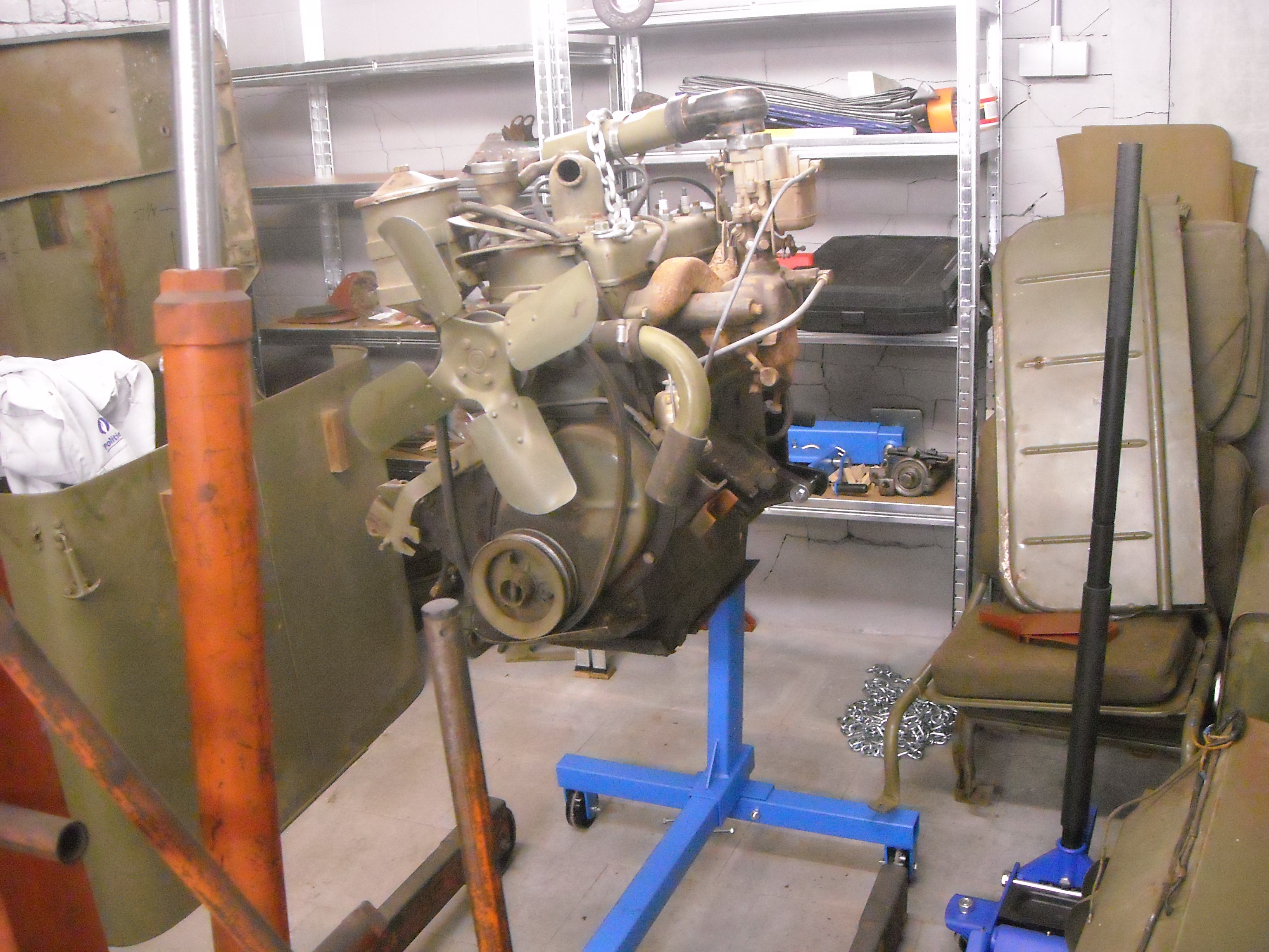

The GO DEVIL engine

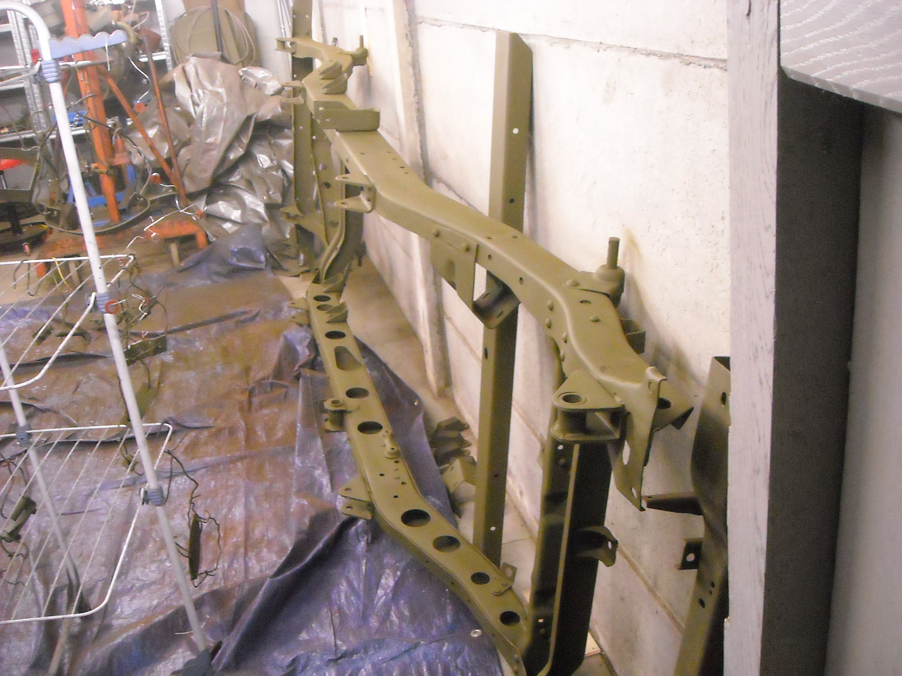

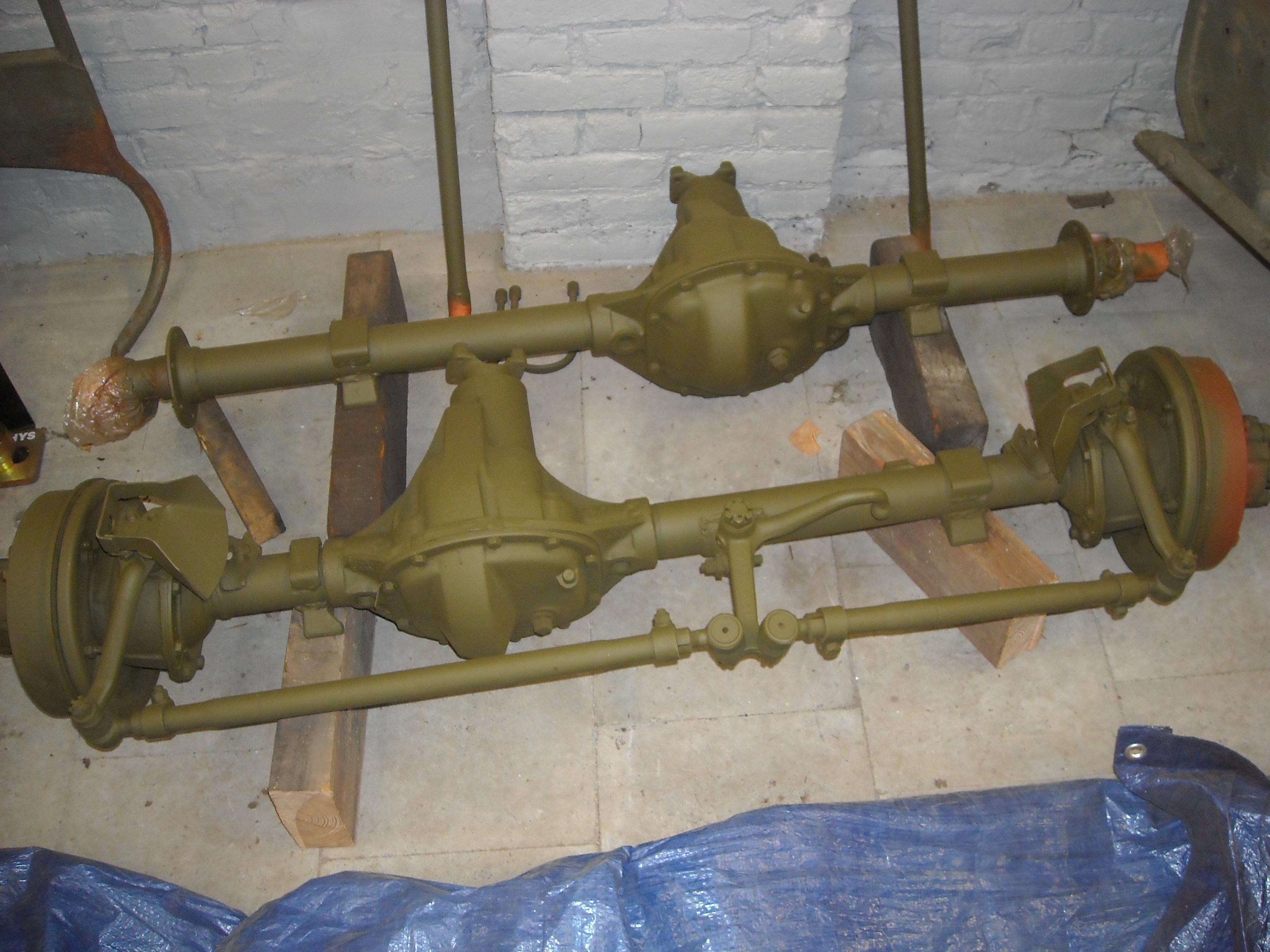

The frame is painted in olive drab, my wife helped me to turn it over several times in between the different coats of paint.

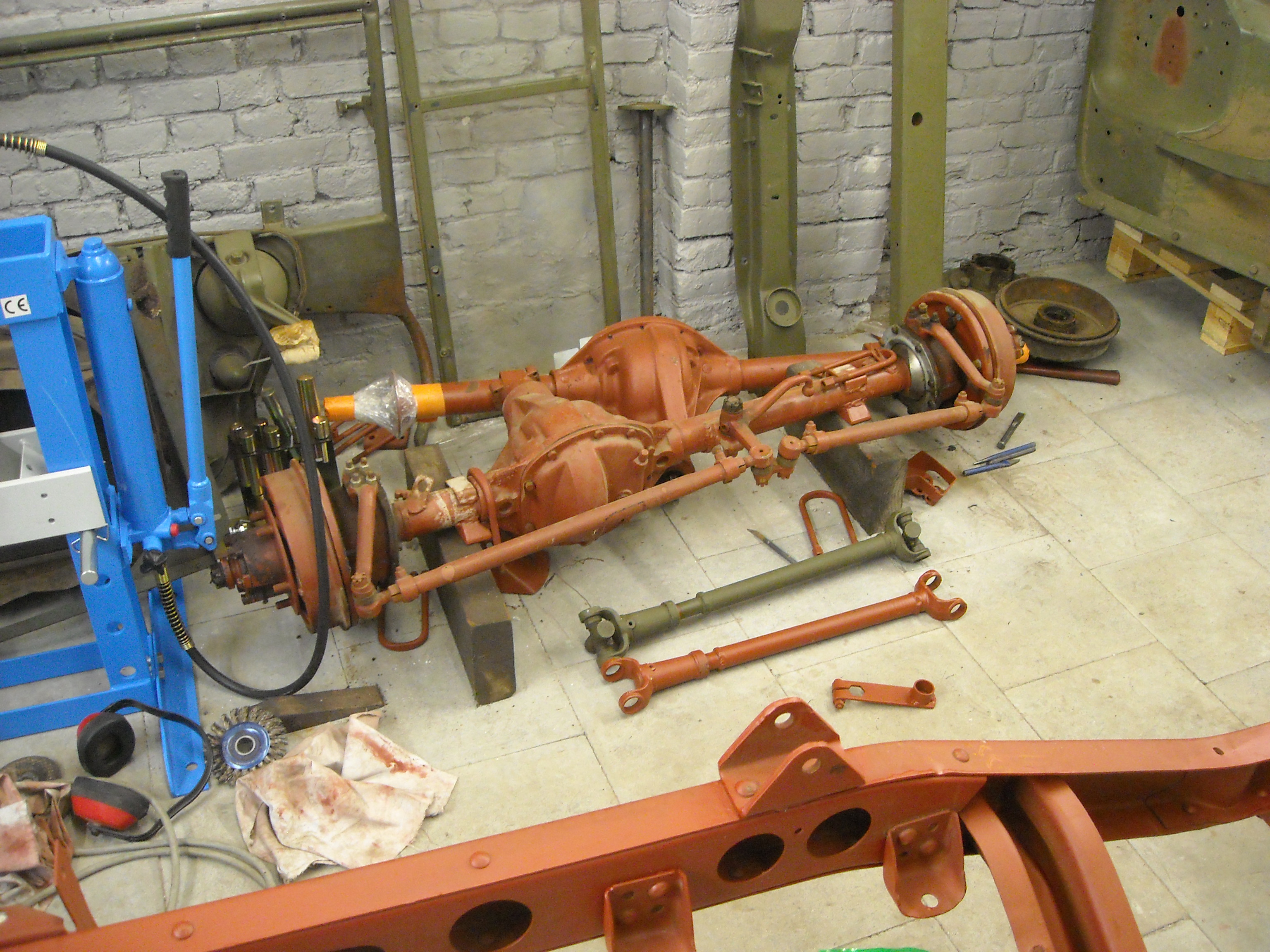

The front and the rear axle are opened, the bearings were OK, they look like new!
Unfortunately one of the brake drums is cracked, it will be replaced. Safety first!
These are allso painted in olive drab.

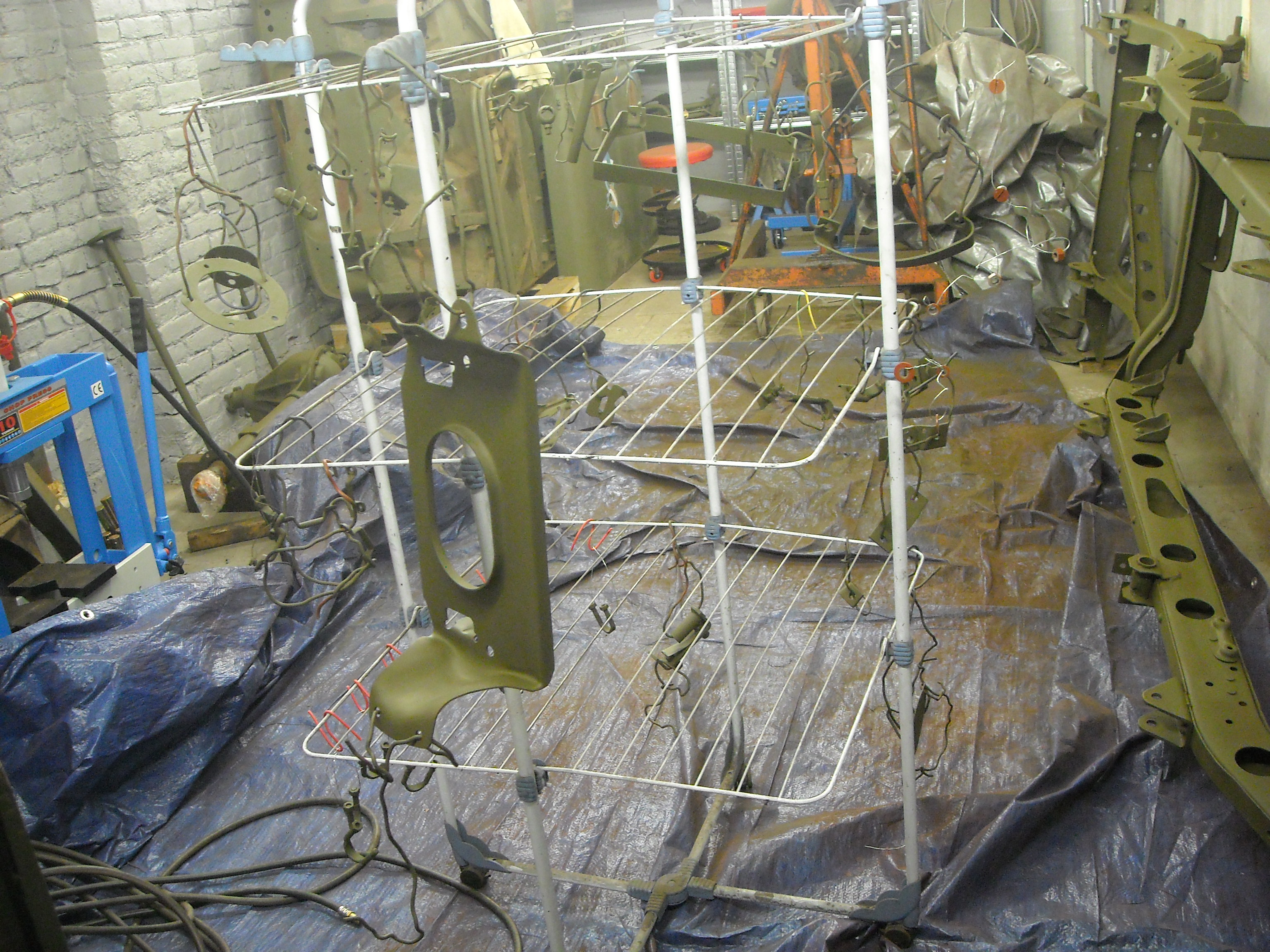

A lot of small parts are allso painted. I think some of you will recognize the way of storing them in order for the paint to dry...

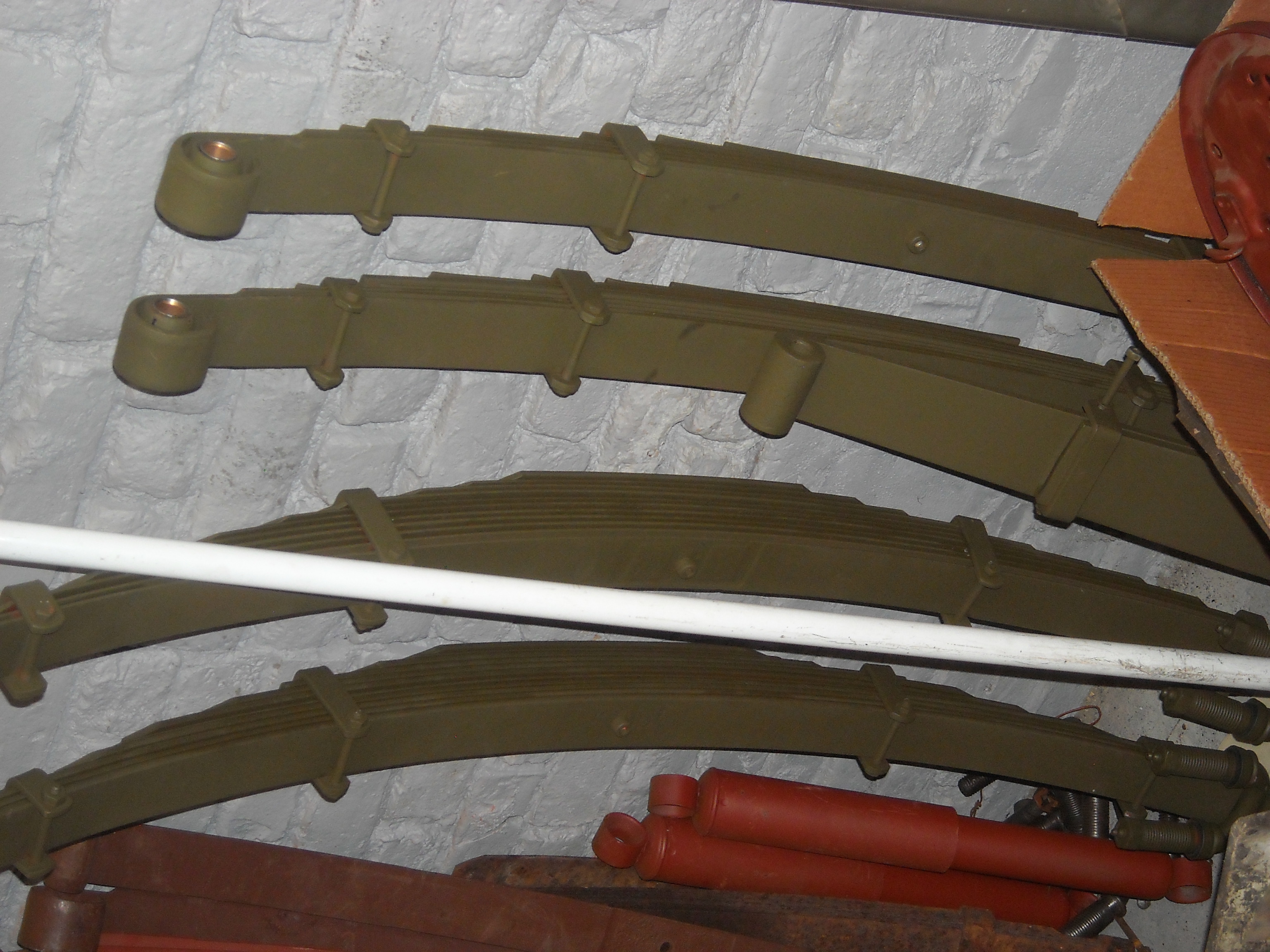

The leaf springs are ready to be mounted, once again painted in olive drab.

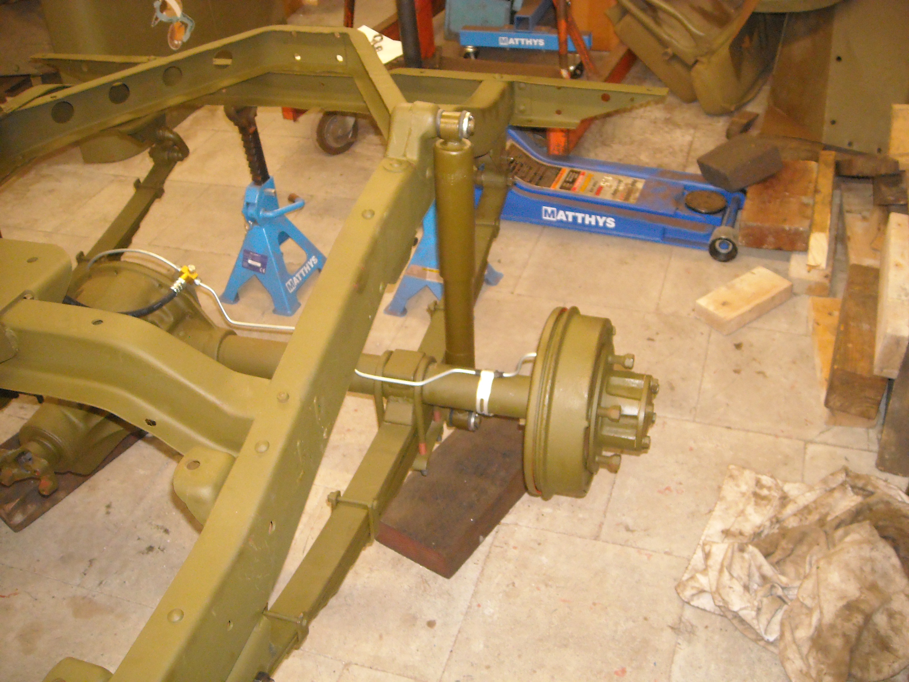

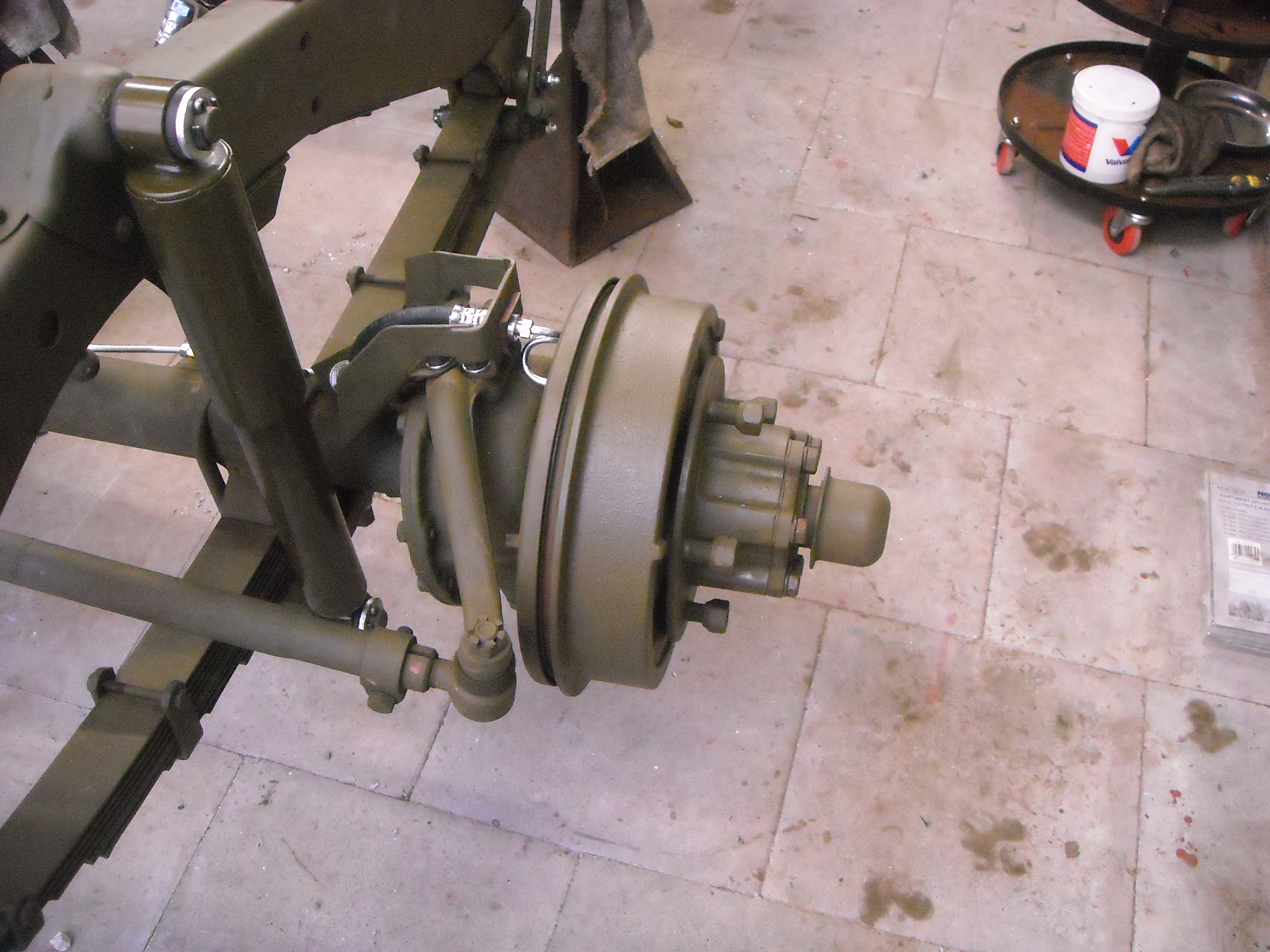

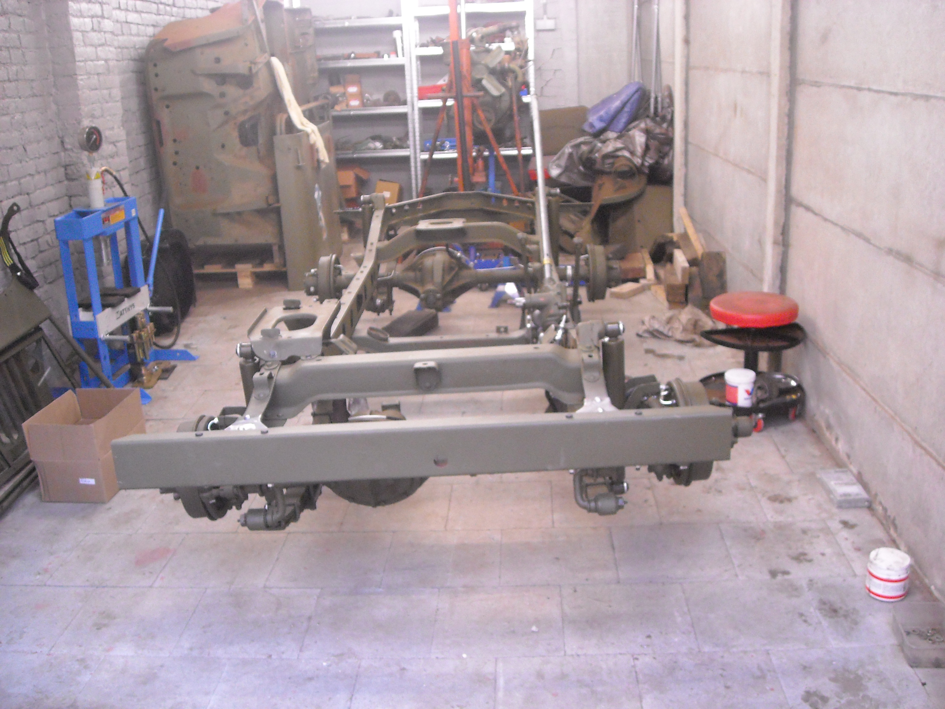

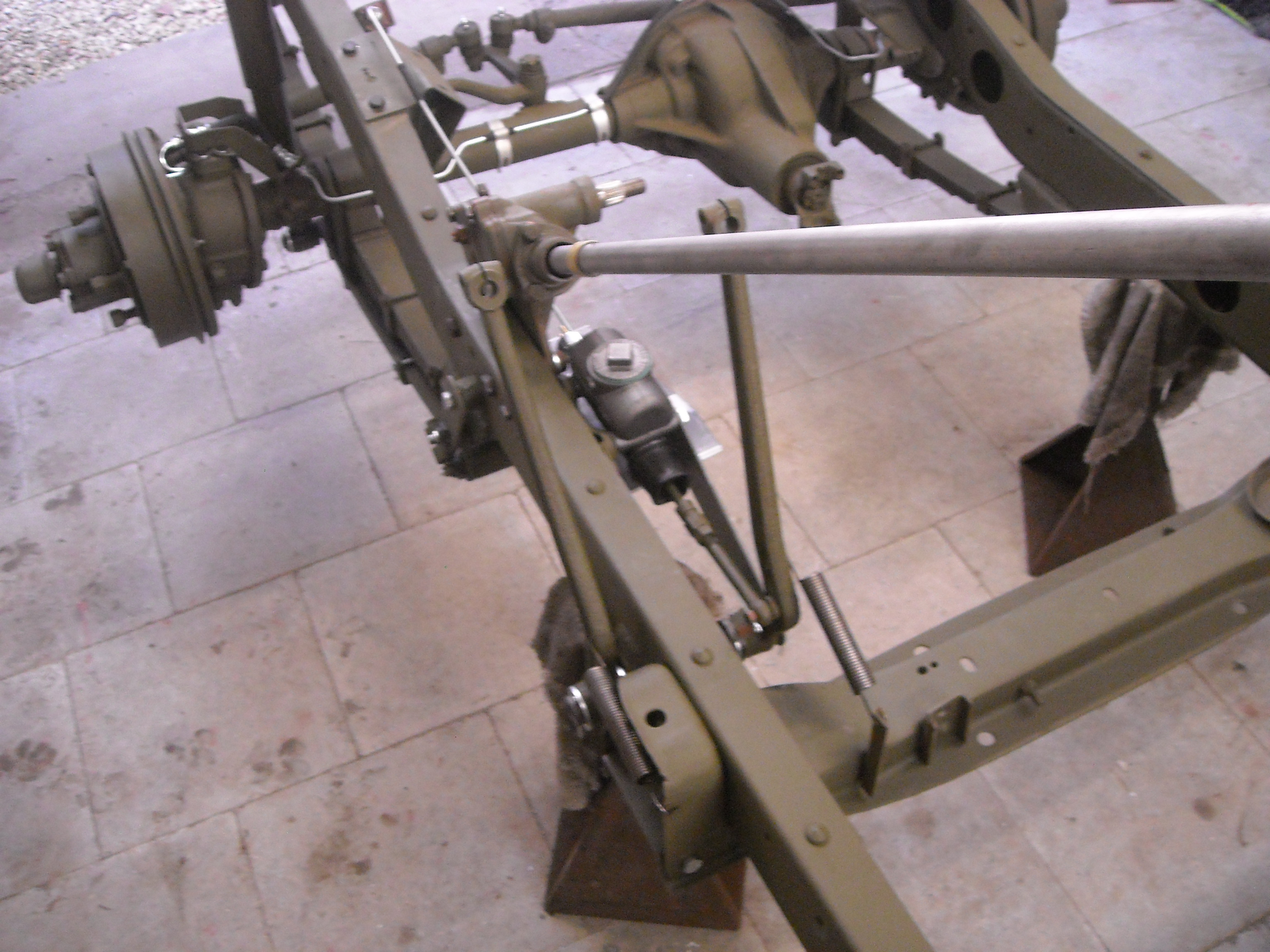

The axles, springs, pedal levers are mounted on the chassis.

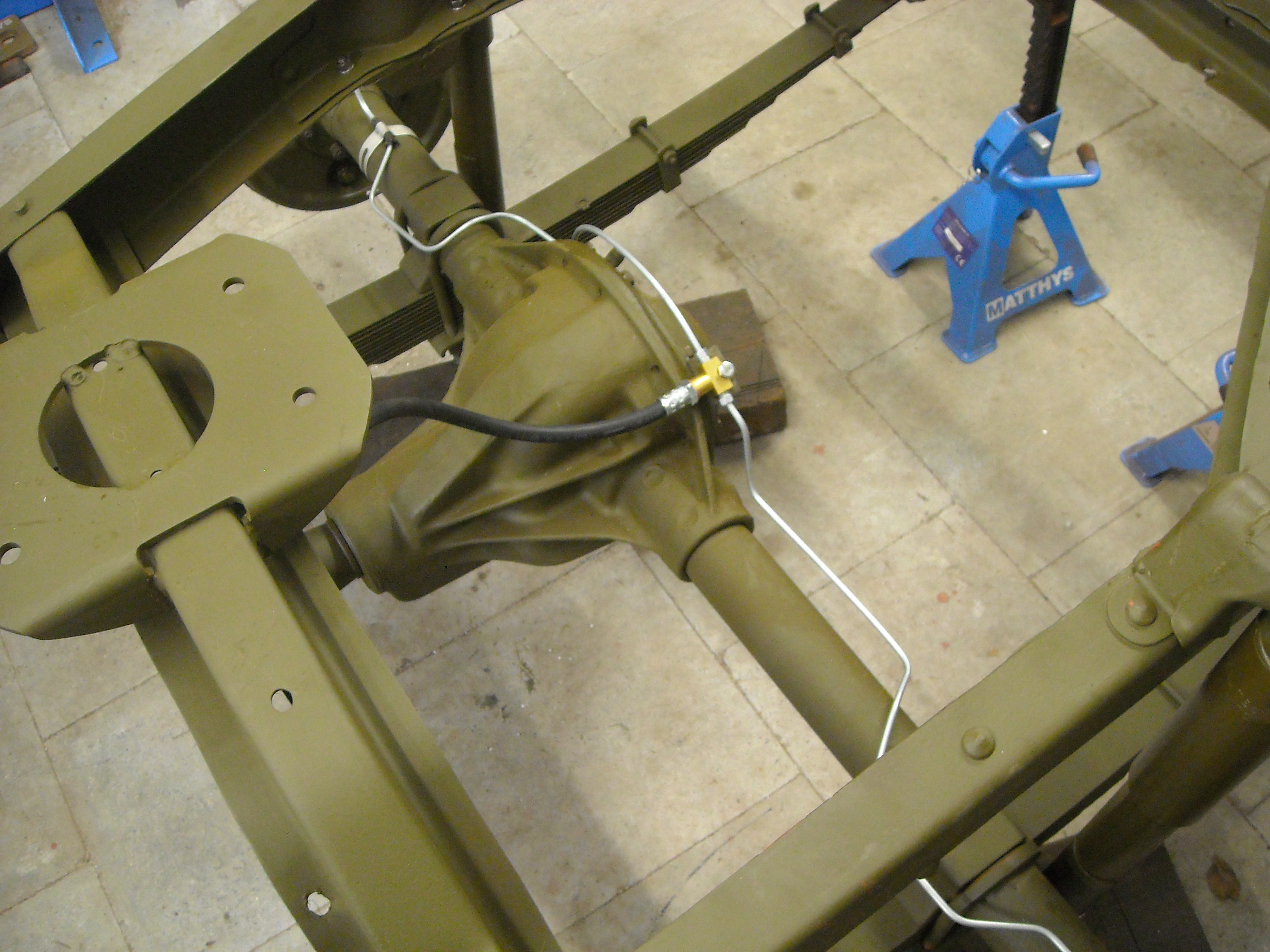

The master brake cylinder and the steering box are mounted

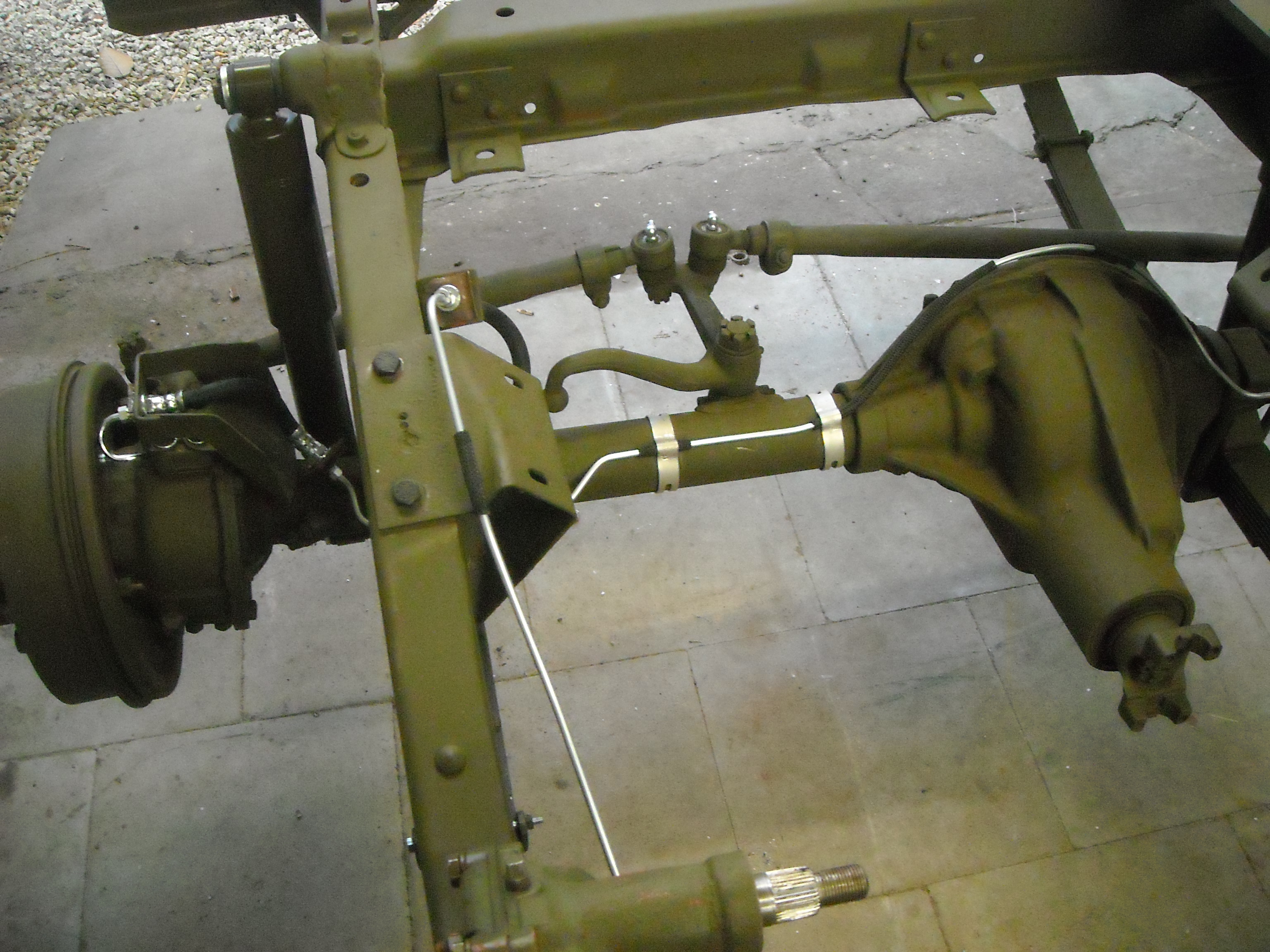

New brake lines at the rear and...
at the front of the vehicle.
New shock absorbers at the rear and at the front.

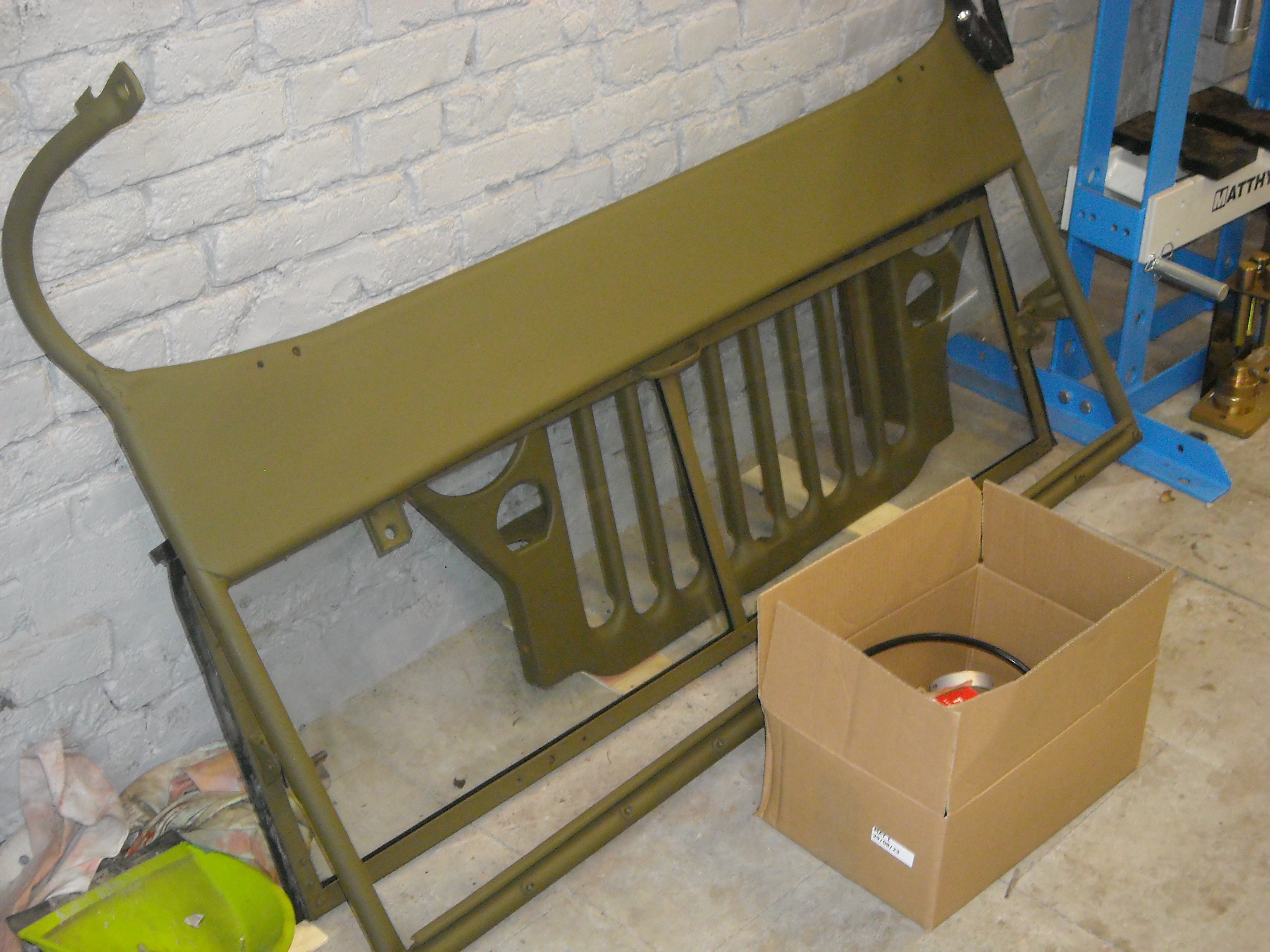

The radiator grille and the windshield are sprayed, the windshield received new safety glass

The next step is to tackle the engine, taking it apart, checking the parts, replacing if neccessary and painting .
