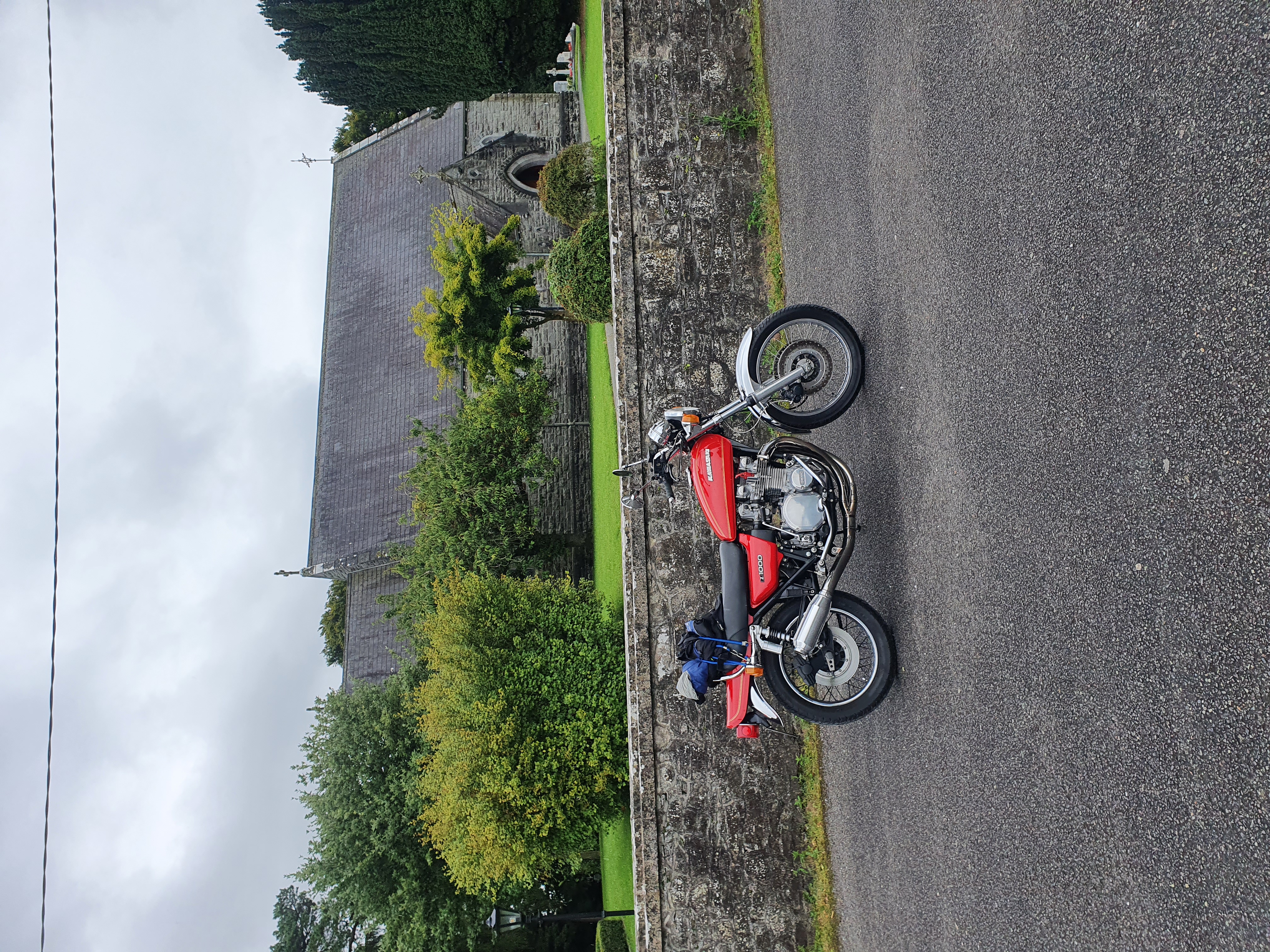

#1 PostAuthor: paul doran » Sun Jul 30, 2023 1:18 pm
Some lovely by roads

#2 PostAuthor: Z1streetfighter71 » Sun Jul 30, 2023 1:38 pm
Looking good Paul, is that a MORIWAKI Exhaust?

#3 PostAuthor: paul doran » Sun Jul 30, 2023 3:43 pm
Yes I beleive it is
Got home before the heavy rain started thankfully

#4 PostAuthor: Philippe » Sun Jul 30, 2023 3:58 pm
Hi Paul
nice Z1000A2 you have there, congratulations!
Let's hope the summer becomes a summer instead of an autumn...

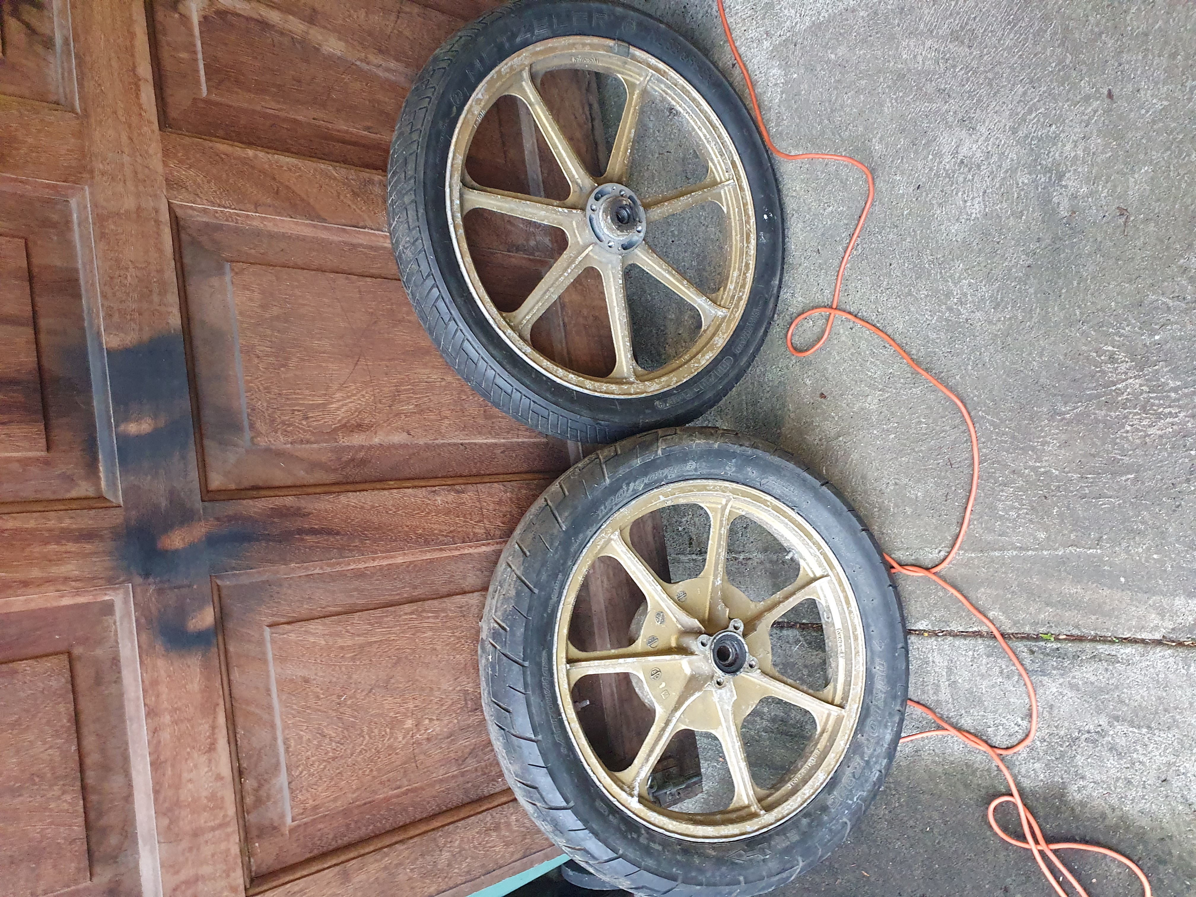

#5 PostAuthor: paul doran » Sun Jul 30, 2023 5:33 pm
Thanks Philippe
I hope to modify it a bit I have these I might fit or a set of genuine 1000H wheels

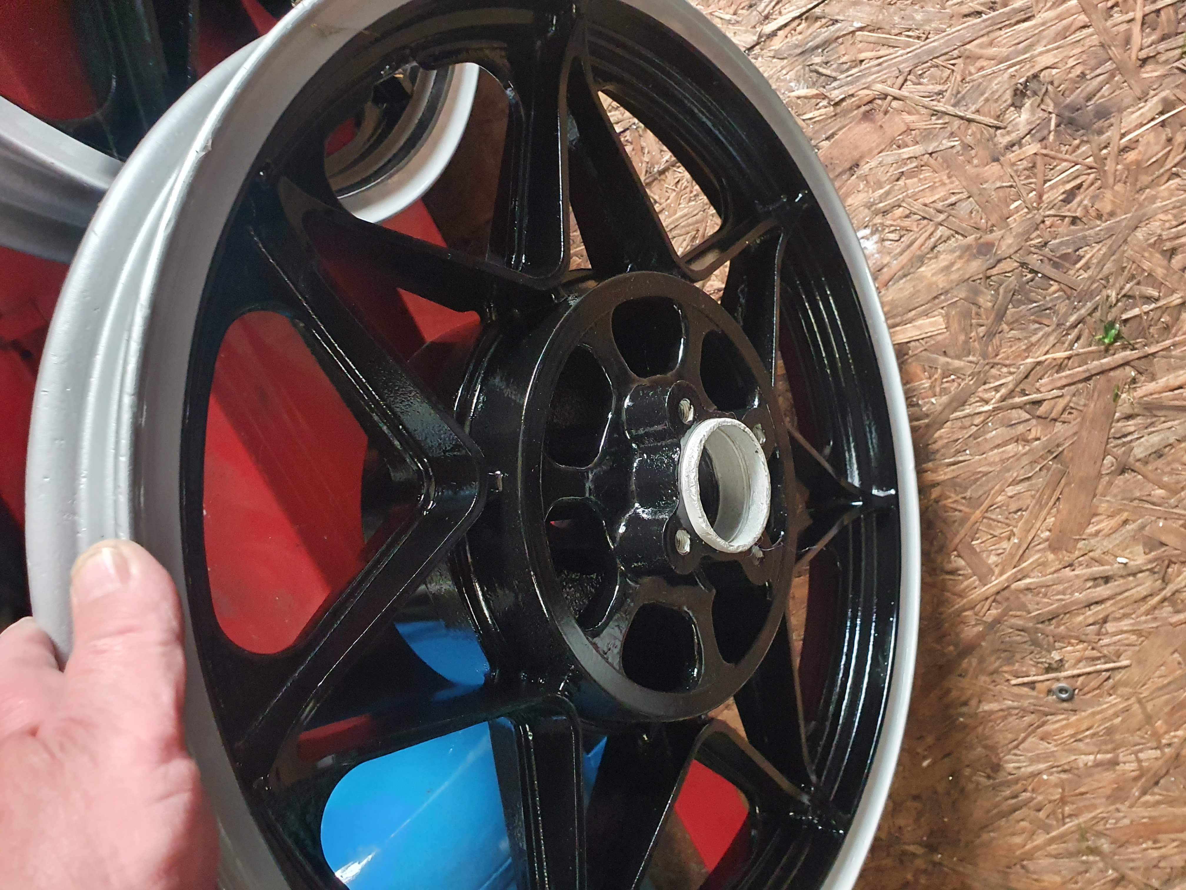

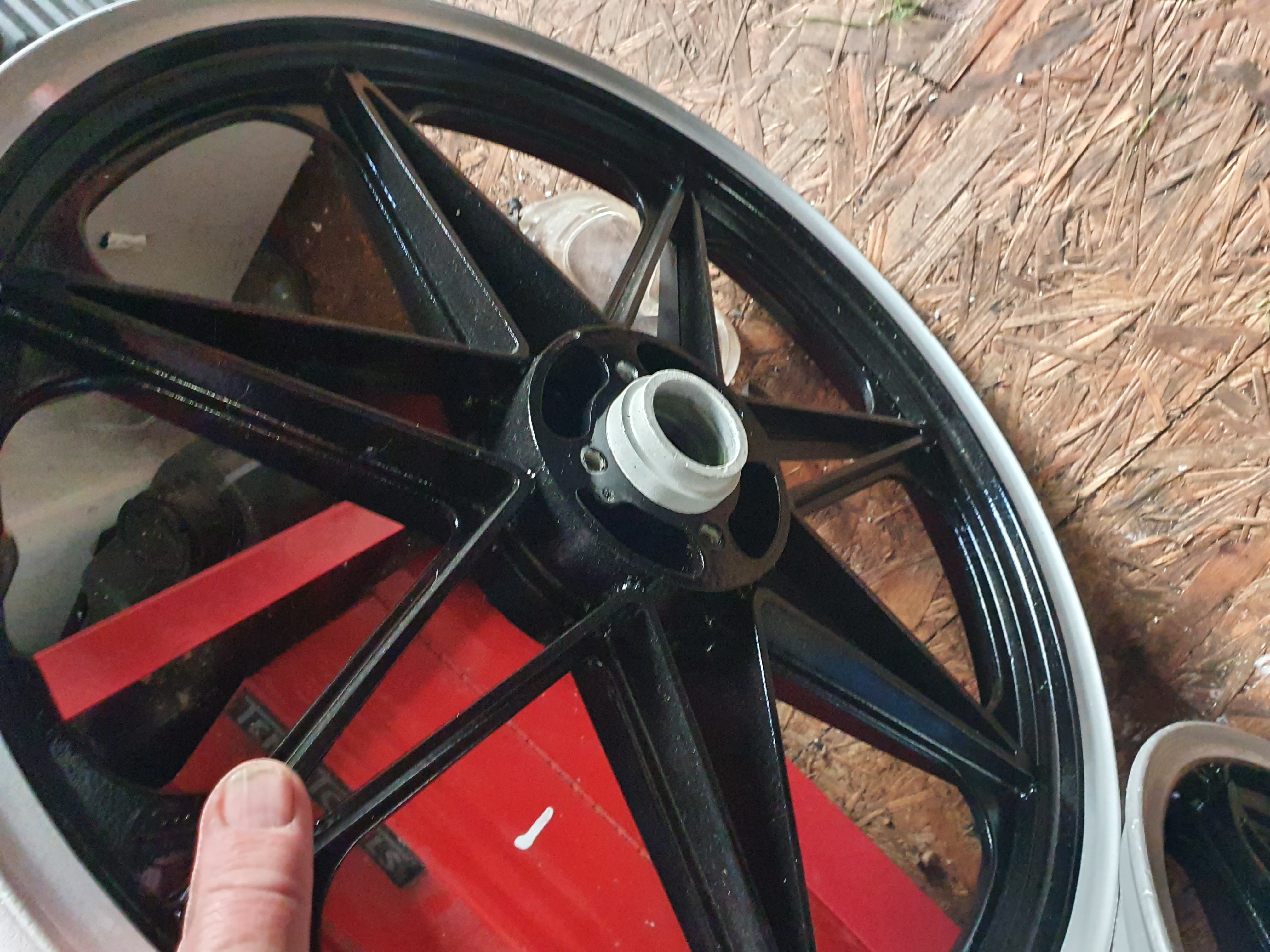

#6 PostAuthor: paul doran » Sun Jul 30, 2023 5:35 pm
The 1000H wheels need a refurb

#7 PostAuthor: Philippe » Mon Jul 31, 2023 2:51 am
Hi Paul
I would advise you to take the H wheels. They're original Kawasaki although they need a refurb. Just keep in mind that you'll need another spacer for the rear wheel.

#8 PostAuthor: paul doran » Mon Jul 31, 2023 12:50 pm
Philippe do You have the dimensions of that spacer please
Re: Out for a run before the rain came
#9 PostAuthor: Philippe » Mon Jul 31, 2023 3:54 pm
Hi Paul
the spacer between the hub and the rear brake caliper must be 31 mm long if you use the alloy wheel.
The spacer of the spoke wheel (original) is shorter.
