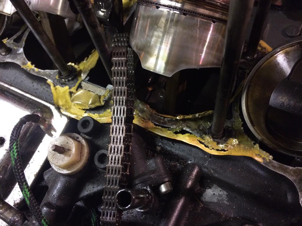

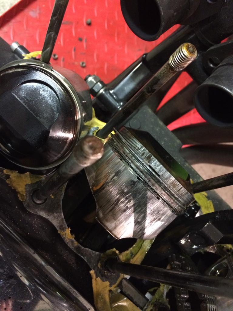

Guys,
Long Shot I know, but does anyone out there have a spare 75mm piston 1170cc ( 18mm wrist pin) for my sick 1100r ?
Base gasket has turned to basically mush, & block has dropped, causing a partial seizure.

Sorry can't help, but all of that has been caused by a dodgy base gasket?
What does the cylinder bore look like?

Base gasket has dissolved for want of a better word, causing the block to drop, I was luck it didnt cause any more damage as it was around 110mph :shock:
