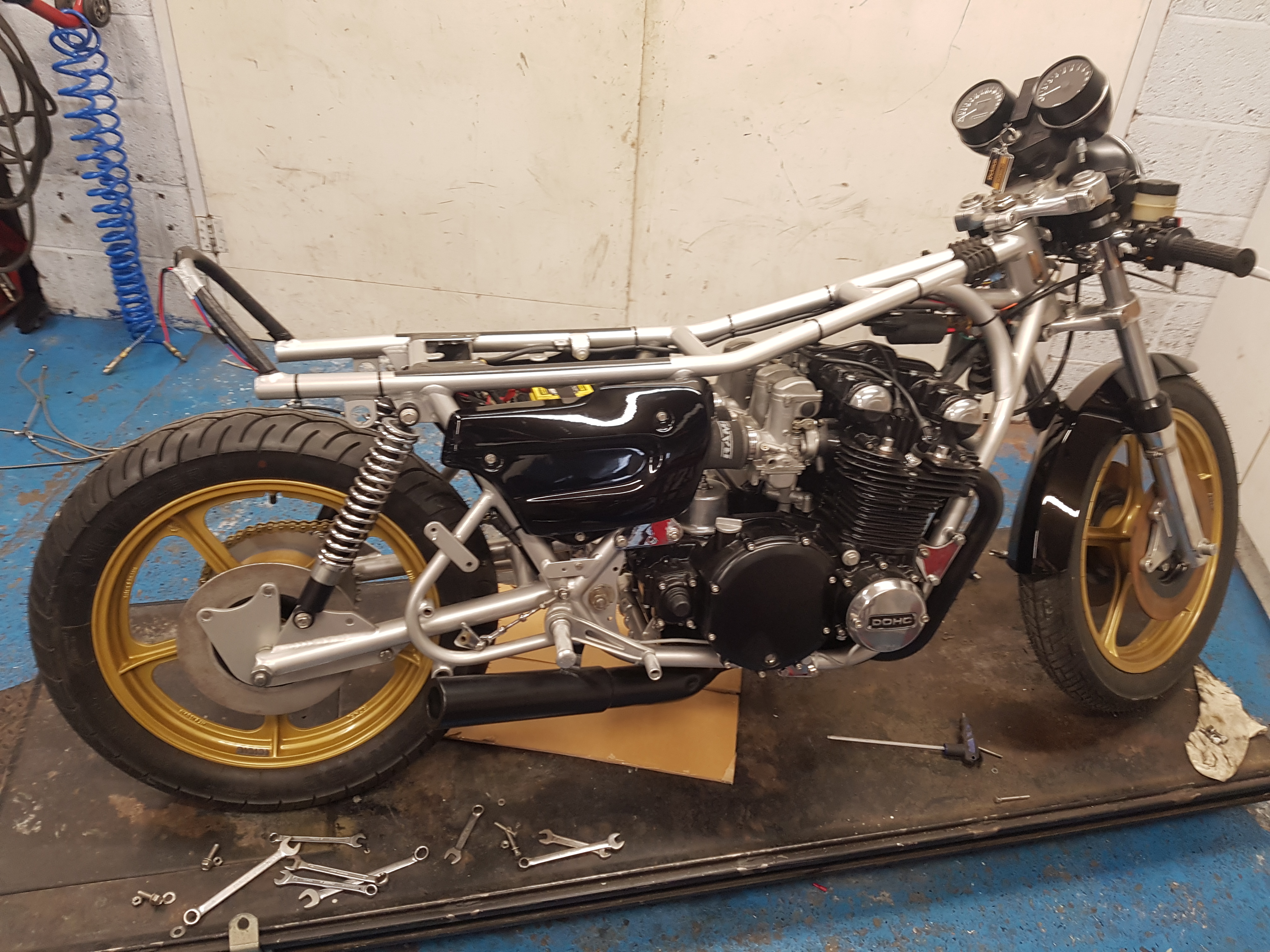

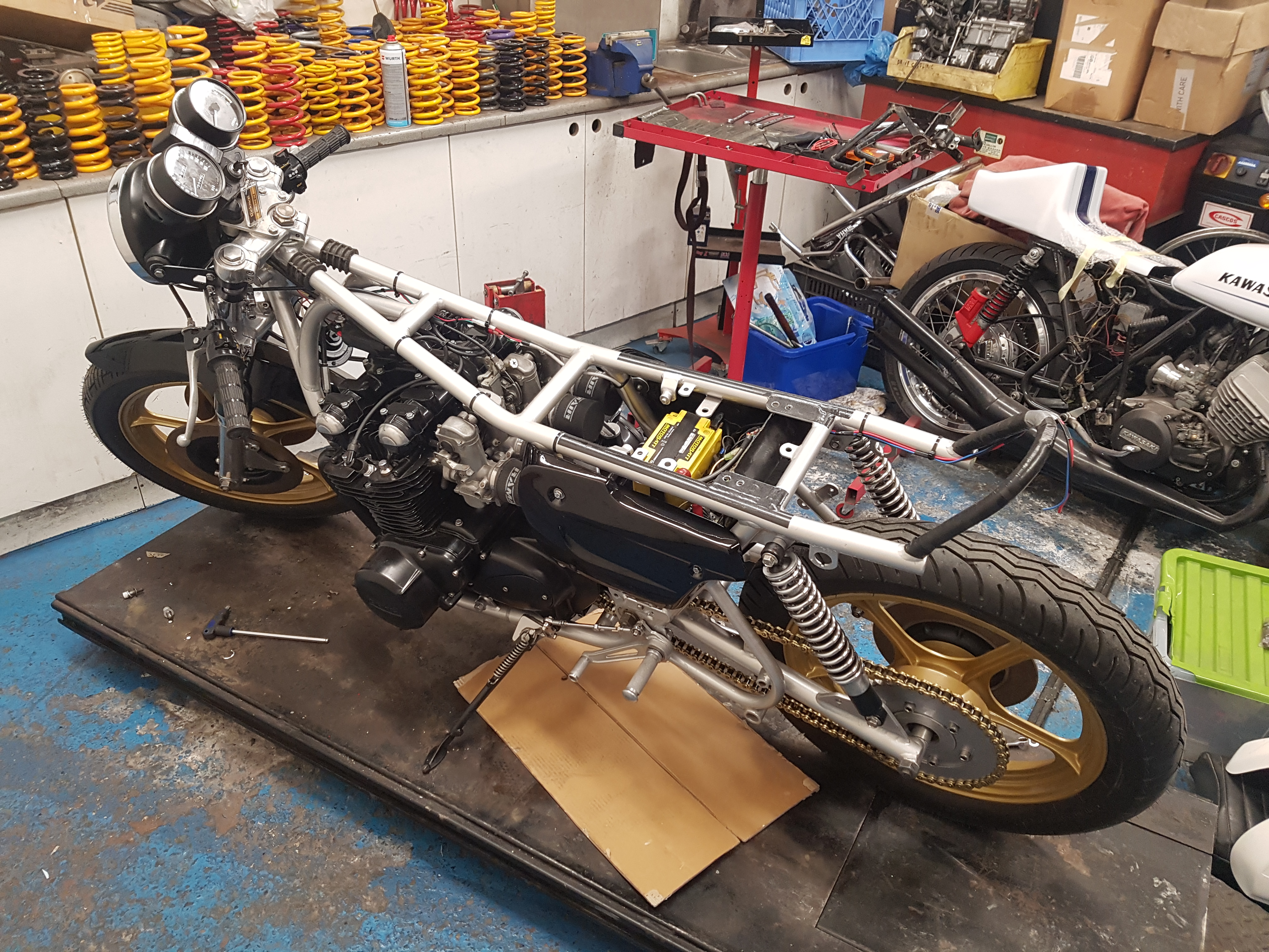

Here we go...........
Brakes are being sorted as putting new lines on.

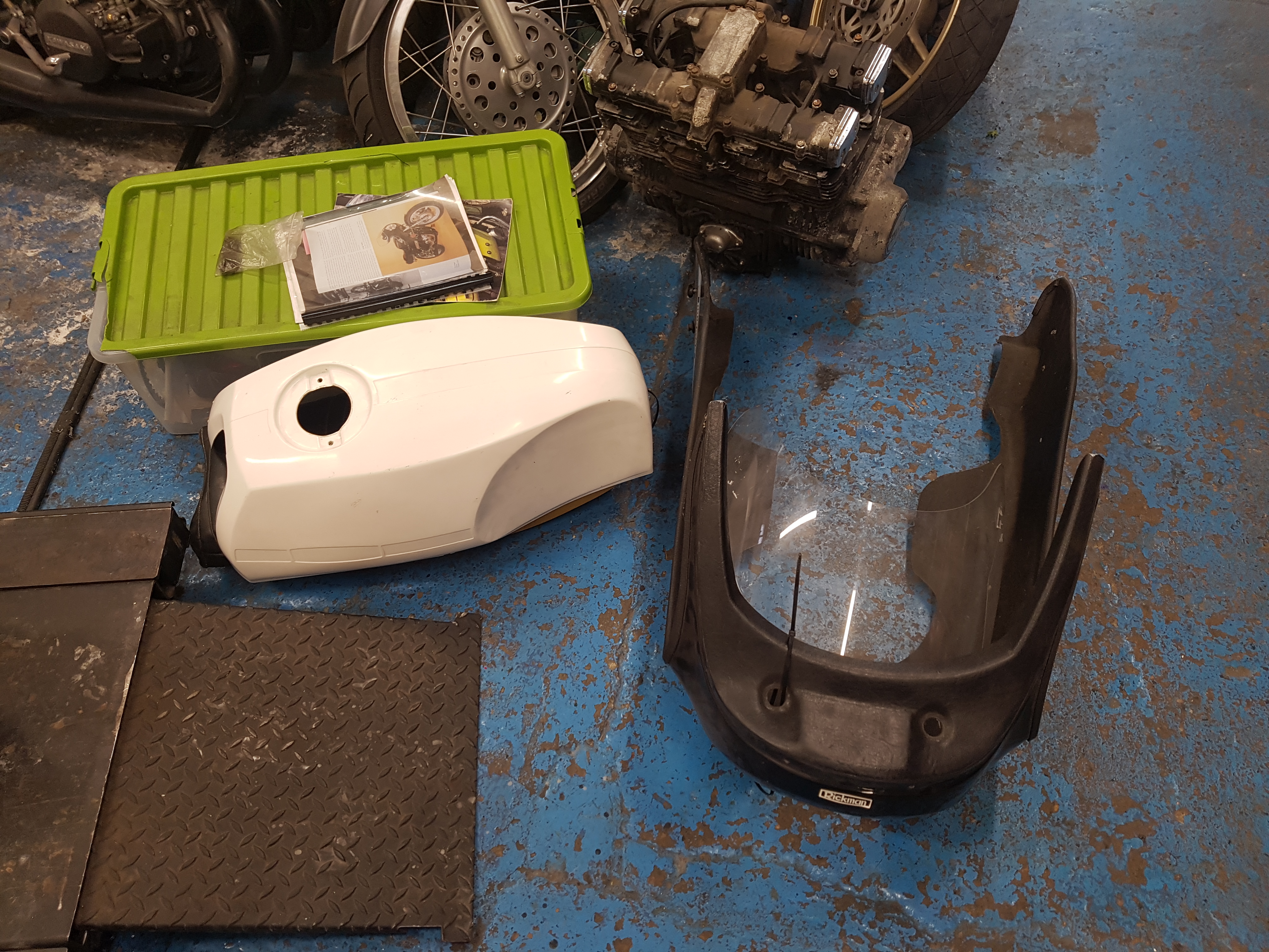

2 tank covers, one normal length and a twin seat and the other tank cover is longer with a single seat

Bike is looking good has the frame been painted. Is that your frame number mine is 5579.
Just to keep Hobbo happy the pictures.
viewtopic.php?f=47&t=26377

Jumbo wrote:Bike is looking good has the frame been painted. Is that your frame number mine is 5579.
Nice bike

If you are going to fit the long tank cover, have you also got the long steel tank?
If not then although you would be able to mount it, you would have to secure it at the rear with a long threaded spacer arrangement, but be warned that the rear of the tank cover can mover around a lot mounted like that and may crack the paint around the mounting.
Long steel (or short for that matter) tanks very rarely come up for sale unfortunately.
