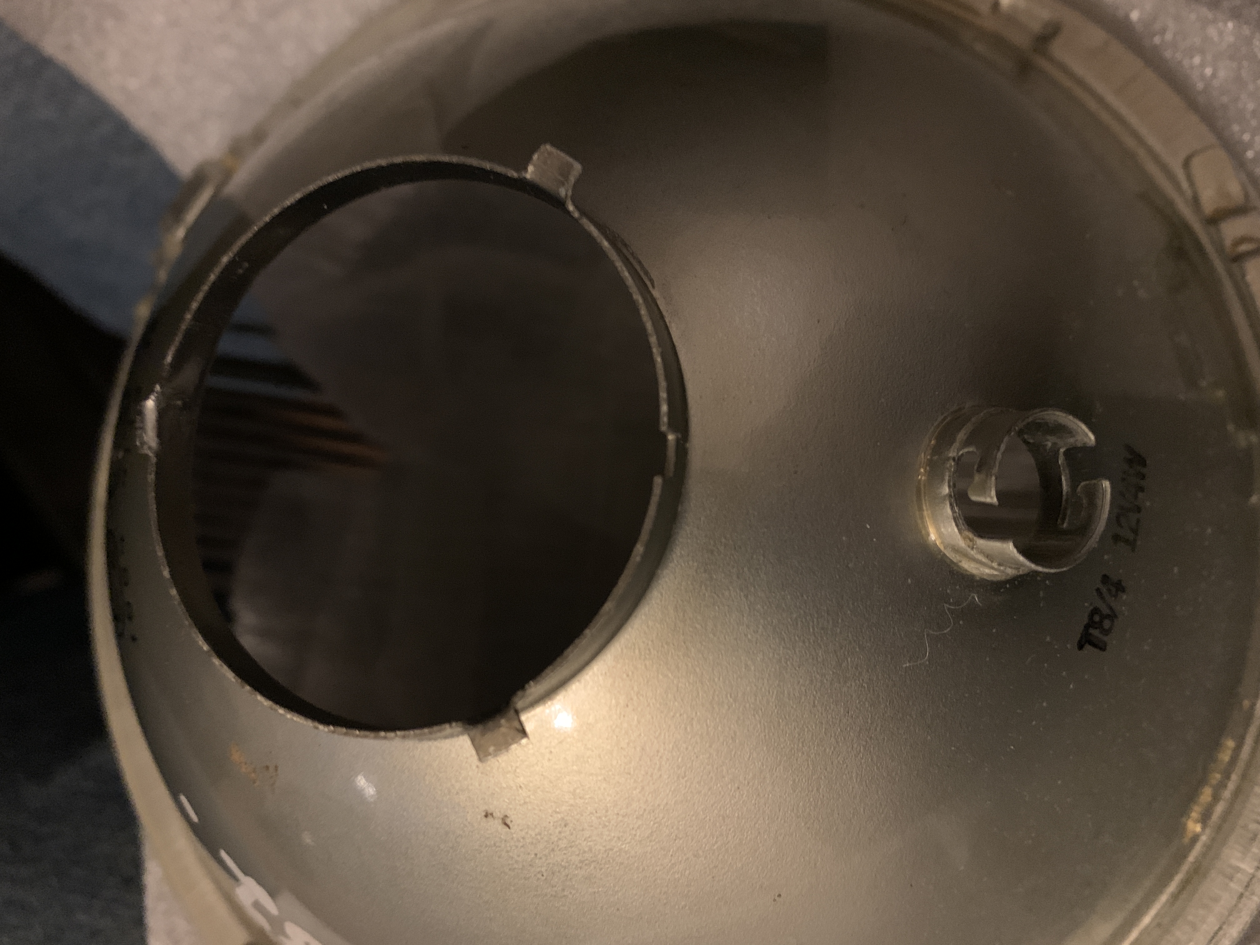

Hi ive got the koito headlamp shown here but i need the pilot and main bulb holder connectors/fittings can anyone help not even sure what they look like?, thanks

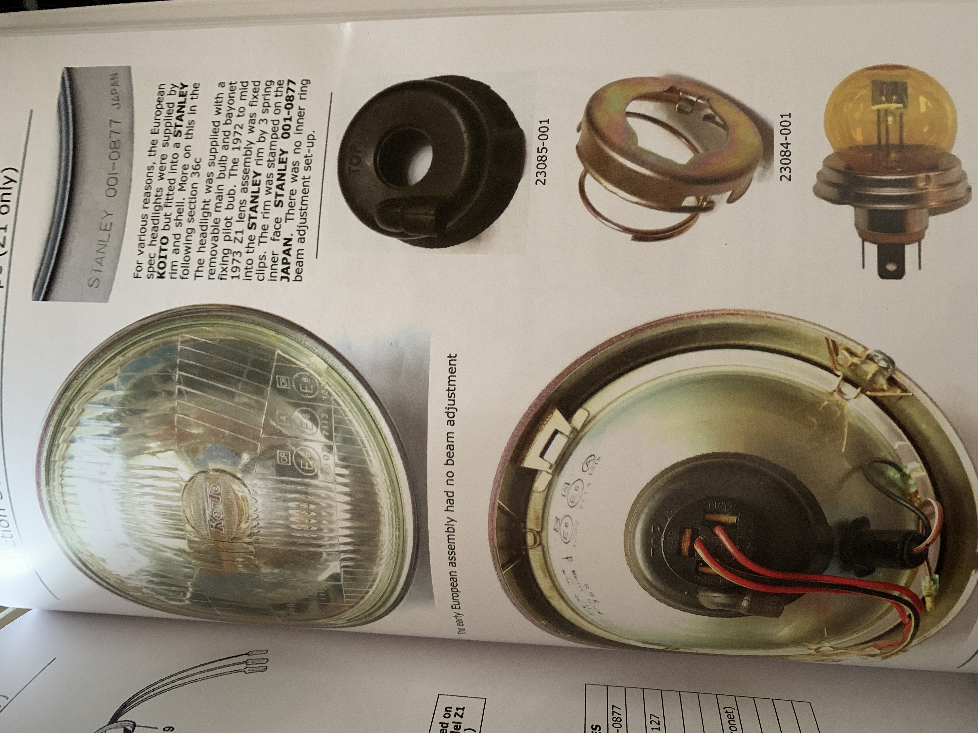

Thanks for that John did see the pics in your book but didn’t know if they were for my headlight. So wondering if any one has these bits for sale? Thanks

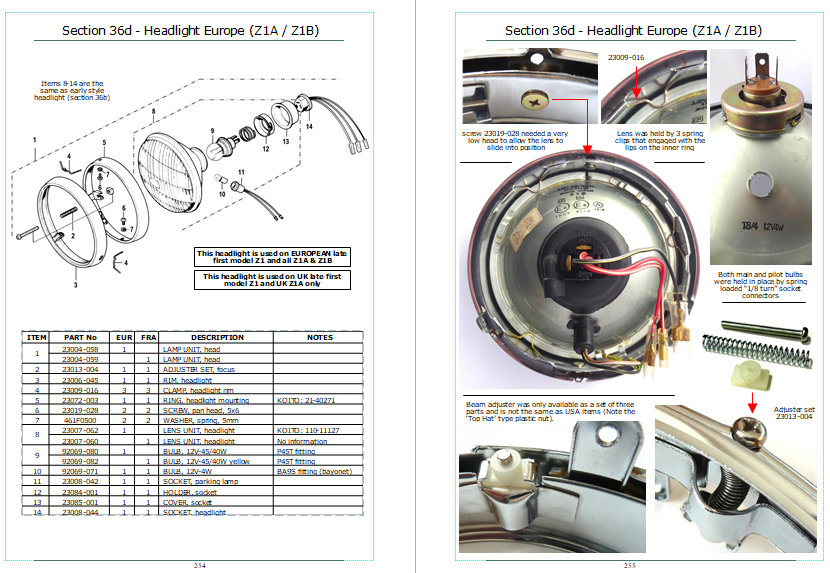

Thank you gentlemen for the information i think then page number 251 in johns latest book shows items i need except bulb needs to be clear.

Correct. The lens assembly is the same in both sections 36b and 36d. If this is for your 72 model, you need the rim from section 36b. From around spring 73 you need the rim arrangement in 36d

Thanks guys have now ordered a clear P45T bulb and a pilot bulb holder from z power but still trying to source the main bulb holder 23084001 and its rubber cover avoiding Europe and possible customs duties

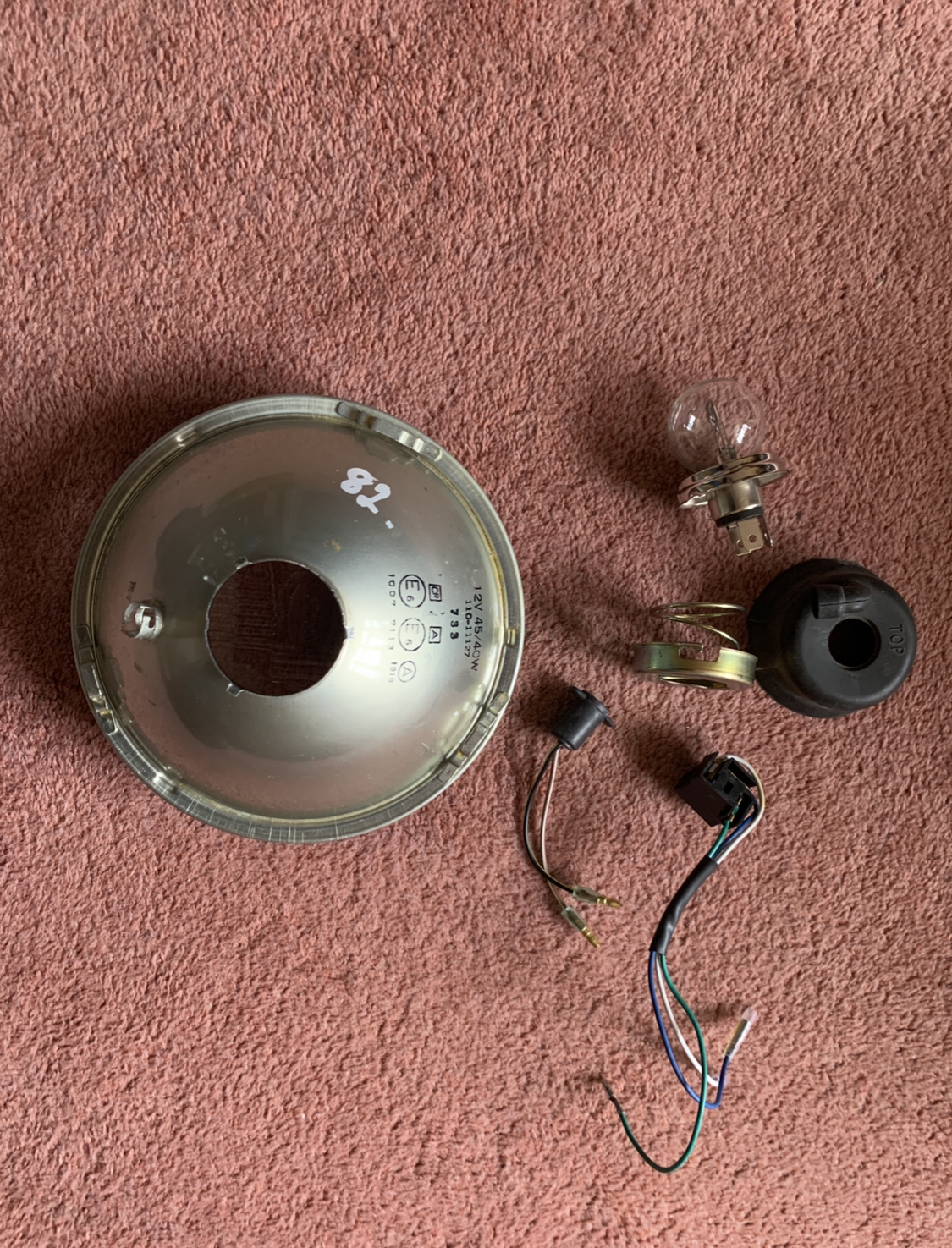

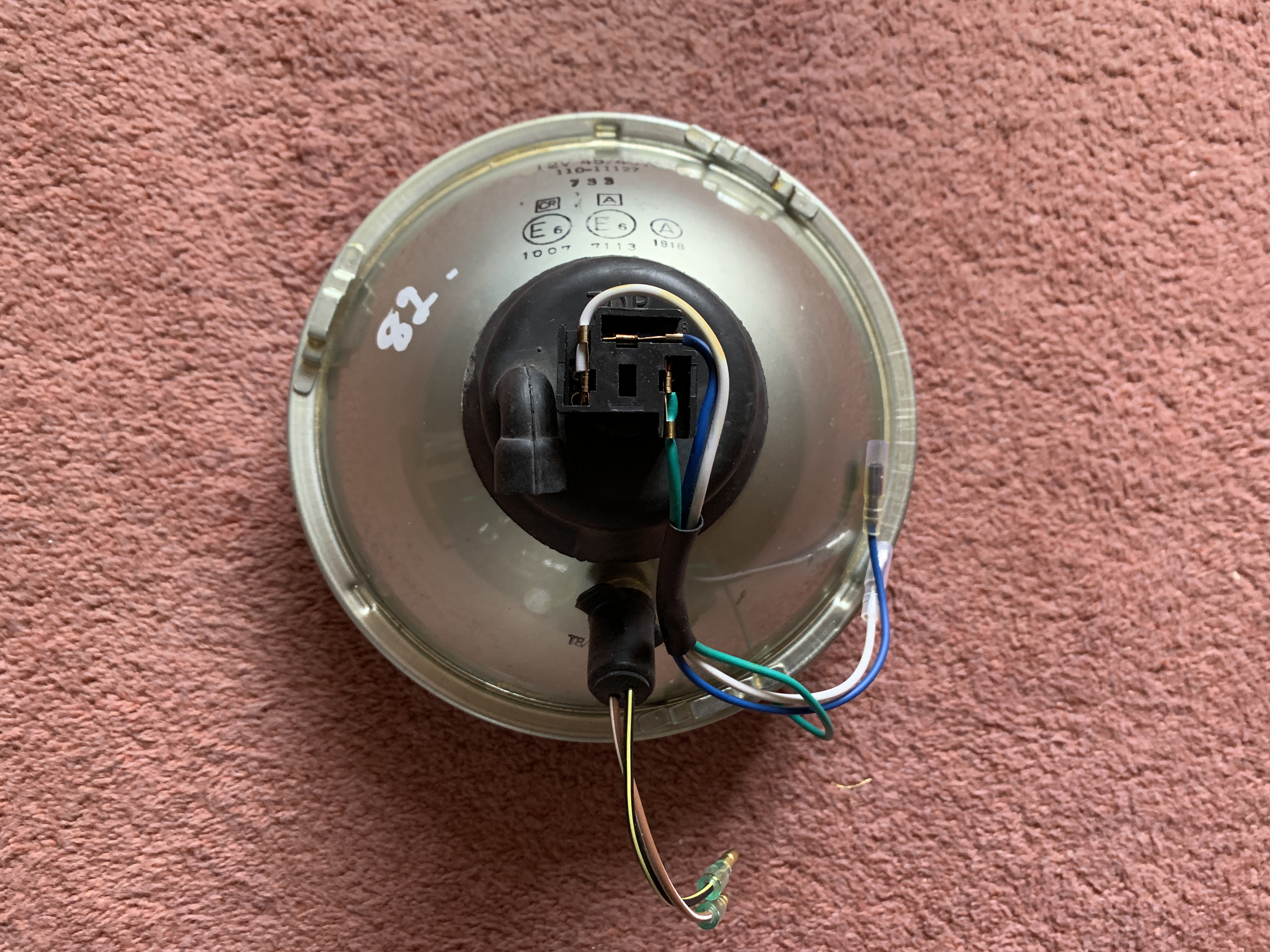

Thanks guys for your help finally got the bits i needed. now have light by candle compared to modern LEDs :biggrin
