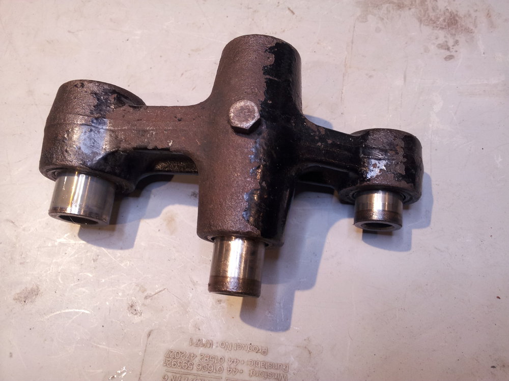

I'm looking for two of the bearing sleeves for the rear suspension rocker arm.They're nla , i could get steel ones made but the originals are case hardened. Cheers.

I know what you're saying. I encountered the same issue. If you have a lathe yourself or if you know someone who has a lathe you can use a rod of "cemented" steel of 20 mm diameter. The outside of that rod is hardened but the inside of rod can be machined, drilled out in order to make a replacement part.
If you google "cemented steel" you can find a supplier in the UK I guess ...

Thanks Philippe, can't find anything like that in the UK though.
