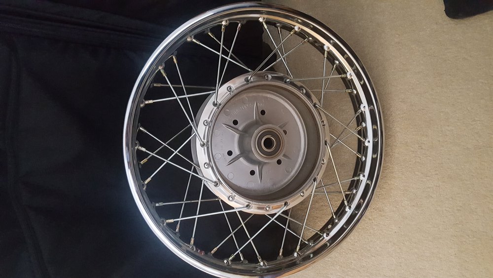

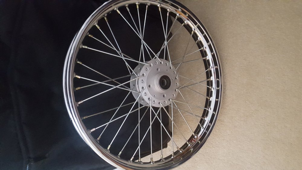

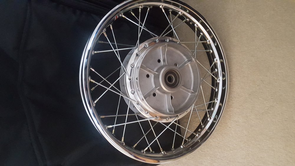

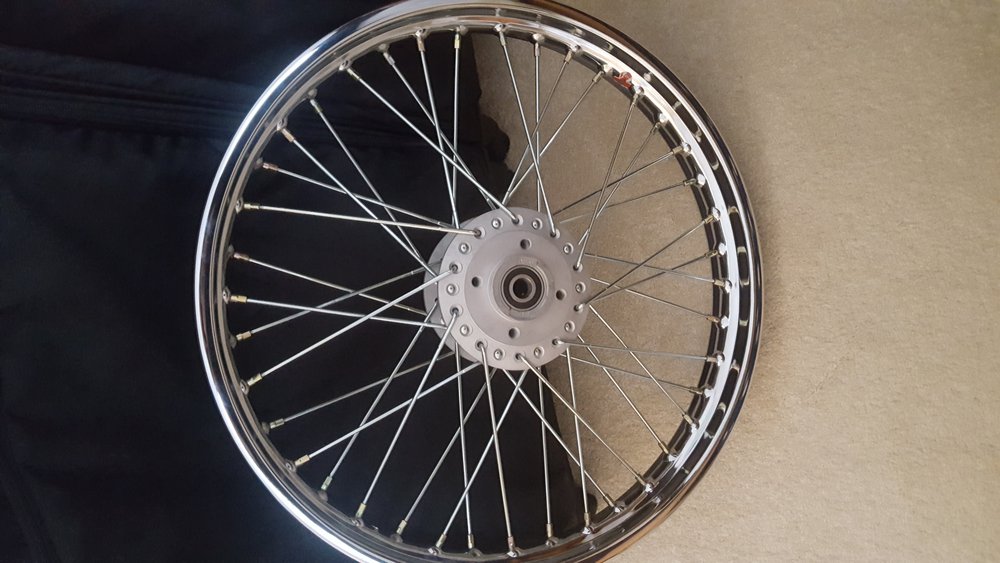

I to have an a4 project and have these spoked wheels. New chrome rims and spokes from zpower, vapour blasted and new bearings.
They have NOT been trued up!.
My bike lends it self more to lesters if you are interested in some deal if no hubs come up?.

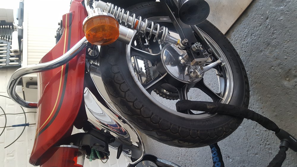

I have done just that, had to make up some spacers for rear wheel.
I will be selling the lot when I get my spokes finished.
I've attached a pic, dresda z900 swinger fitted but spacing is the same.
Z900a4, BMW 1200GS, H-D 1200, KTBFFH

Front bolts straight on no probs.
Rear you will need spindle, brake plate assy, sprocket carrier, cush drives and some z650 chain adjusters. Remember also Z650 sprockets, I bought chain seperatly, a longer one and cut it to length, z650 has a shorter swing arm so a set won't fit I think. These are all 530 so readily available.
I have the dimensions for outer spacers written down, I will dig them out for you and send more pics if it helps.
