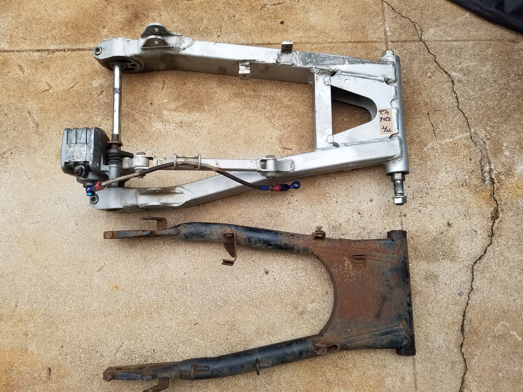

This crusty example from a Z550 is available :roll:
https://www.ebay.co.uk/itm/152675229685 ... ondition=4

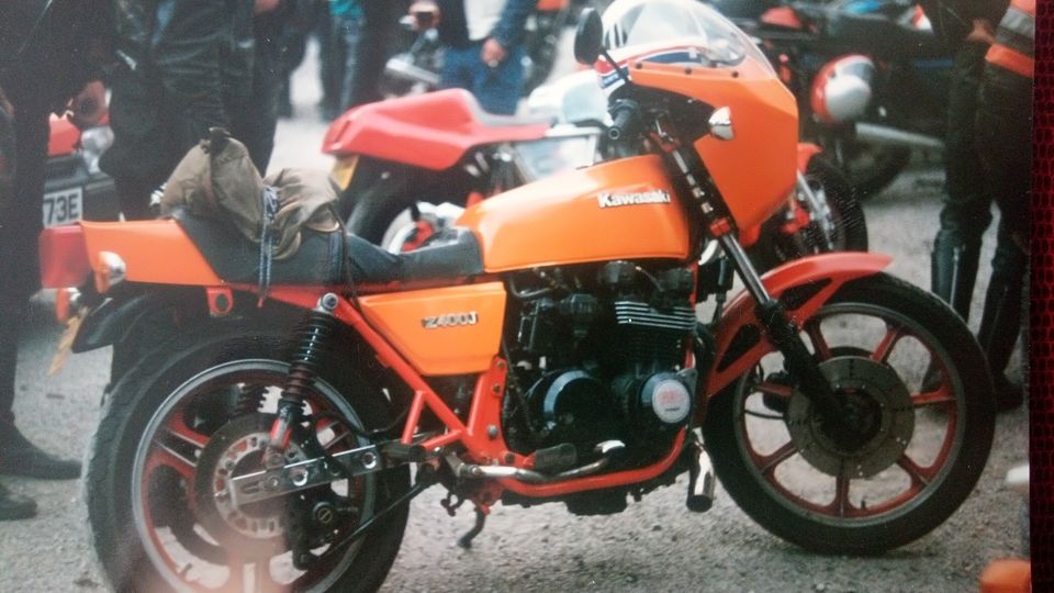

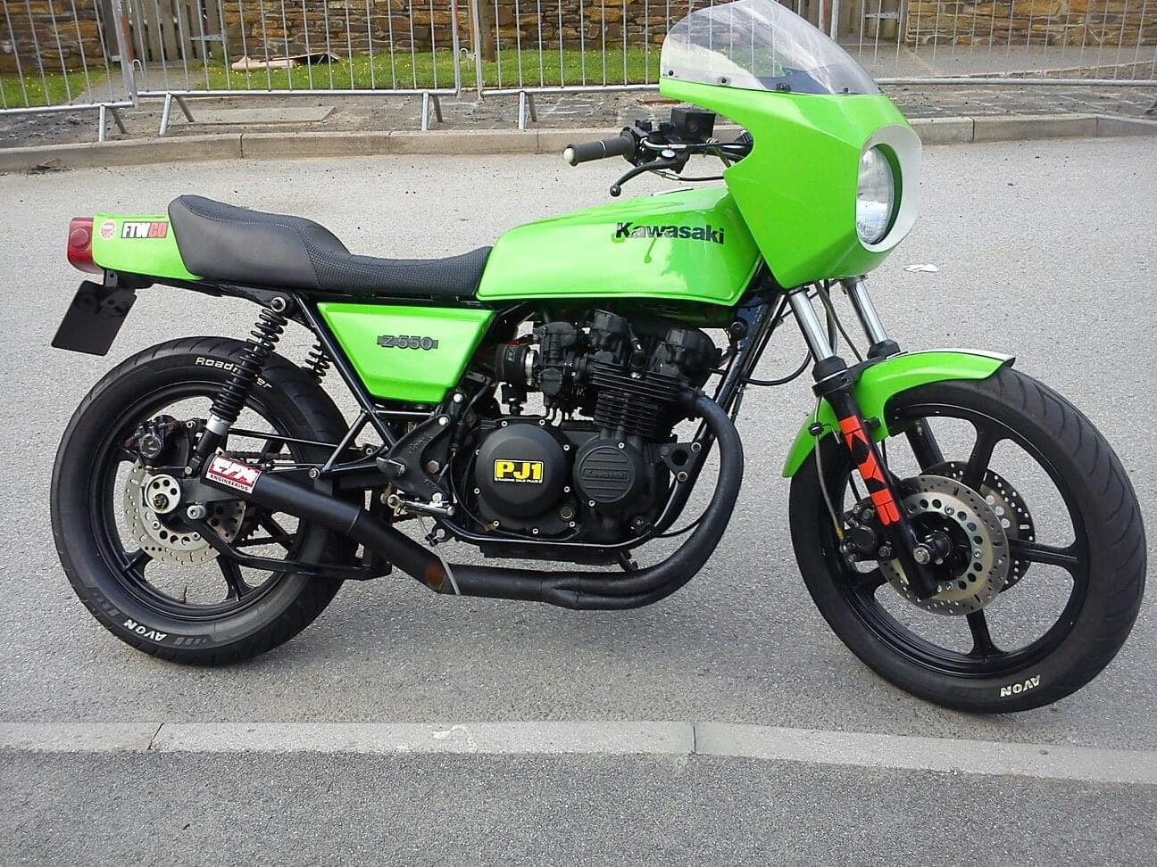

It might fit, maybe with mods. Might be the only way. looks like wheelbase would be extended a few cm. They have been done - here's a underbraced z550 one (maybe based on the zepher) and a z400 turbo
400 Turbo
z550 racer
