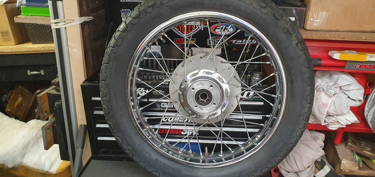

Now the sprocket carrier is sorted (it IS definitely the correct one), I'm going to guess you'll plan to use the Ltd. disc / calliper with the 1000A wire spoked wheel ? Just a heads up - the disc offset / distance from wheel centreline is not the same for the 1000A - the Ltd has the disc mounted further out.
Recollection is maybe 3mm or so but the calliper needs to be centralised on the disc so some "adjustment" of the brake side spindle spacers will be needed - an extra one out board of the calliper bracket and a reduced length between the bracket and wheel bearing... Checking out your pics. of previous bikes, I don't think your a stranger to making mismatched parts fit together so I doubt you'll have any problems with this !
To ask a favour however, when you get to swapping the wheels, could you please measure / post details of the length dimensions for the Ltd. spindle spacers - these questions come up regularly .... Thanks !

the rear wheel turned up today and its pretty good, i think both wheels are a matched pair ???? both from DK.
but their is a few tyre lever scratches on the edge of the rim and 2 spokes missing !!!! but i do have a set of chrome Harley spokes that are the same length that'll do for now

Nice wheel.... can't spot the Harley spokes either. A few tyre lever marks are expected on a 45 year old wheel - especially with those damn security bolts ! Good match for the front - a pair of 1000A wheels is hard to come by these days. Tyre choice is not my special subject but I'll be interested to see what size you go for. 120 is accepted as "standard". We used to squeeze 130's on when we could get them back in the day. Some argue the 130 gets pulled out of profile on the 2.15 rim but close comparison between two wheels side be side with 120 vs. 130 showed virtually no difference. I'm not going to say the 130 gave any advantage - it just looked better to my own eye. (lots of variation between brands in any case) This probably belongs back on the "Project" post now ... I'm interested to see the new paint job !!

I'll take the tyre off the front mag as its new, the back will get a cheap 400x18 for now as i still plan for wider 17 inch rims and stainless spokes sometime next year,

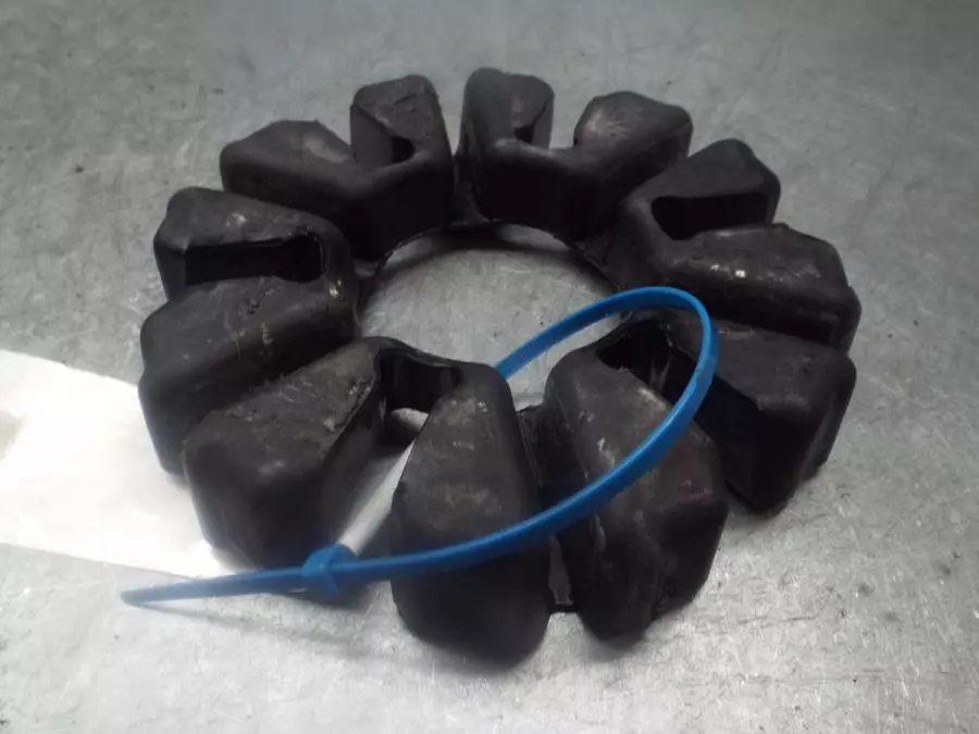

I know I can get new ore used cush drive rubbers easy enough but come across a set that are all separate, normally they are one piece, do you think they will fit ? it does say Z750B
https://www.ebay.co.uk/itm/335483245652

The cush drive should be in one piece as you know. Its a tough call to judge just by looking at the pics. D&K are pretty good in my own experience and if they say it came out of a 750B it should be ok. At the price its maybe worth a punt but if it doesn't fit then they might argue about you putting it in a 1000A wheel - even though WE know its the same thing. You could perhaps see if they're up for sending an EXTRA pic. with the rubbers sitting in the hub of the other 1000A wheel they have for sale.... a picture tells a thousand words - and costs nothing ?

I must admit ive heard a few zeds pop on start up and idle !!! I'll email DK and see what they say about the rubbers.

Good call on the cush drive I think - not worth messing about for the sake of an extra fiver !
