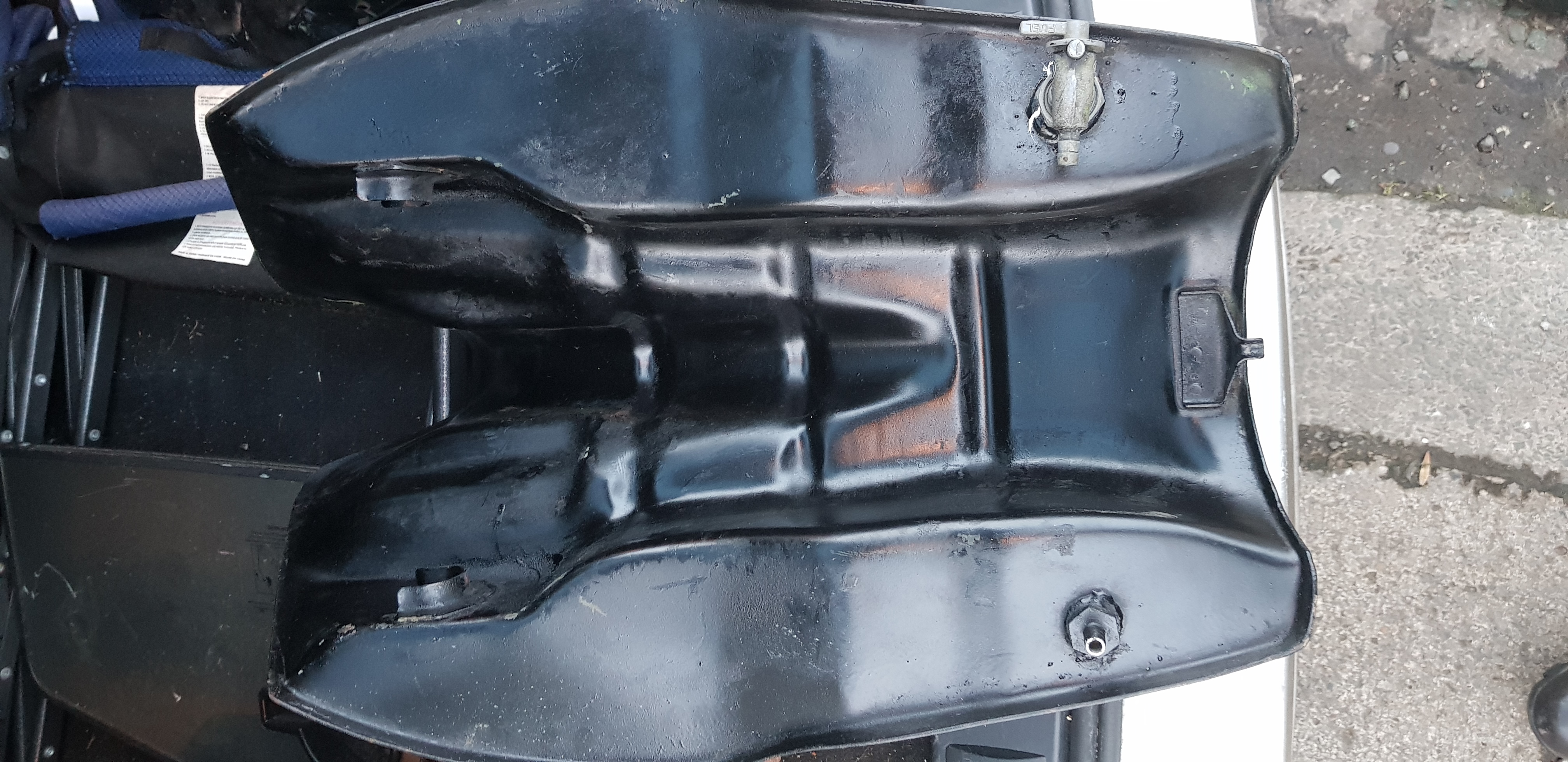

rpeters wrote:That tank looks like an ST tank?
I'll take pic of underneath, I presume the H tank would have a return for the fuel injection
it does - at the back opposite side to the fuel tap.

#25 PostAuthor: Swirl » Wed Feb 06, 2019 5:05 pm
H ?
Posts: 4586
Re: What seats fit this Z1000h
#26 PostAuthor: chrisu » Wed Feb 06, 2019 6:47 pm
i'd say yes
#27 PostAuthor: Philippe » Thu Feb 07, 2019 3:12 am
certainly yes!, an H fuel tank.
