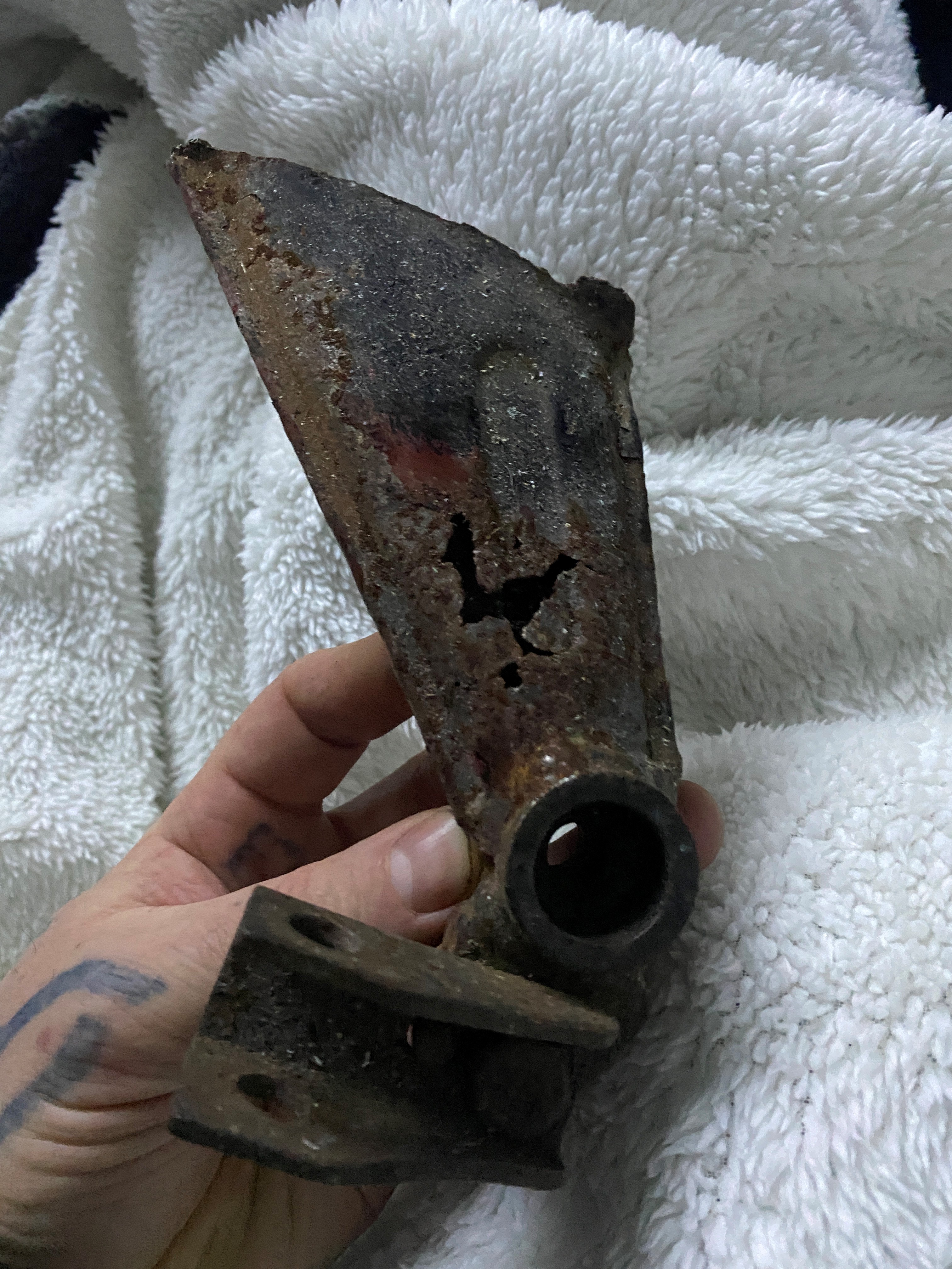

Iv got a pair if you want them, they were rotten on my z1000 and were fairly carefully cut off, shipping will be from Ireland
if you want to cover it.

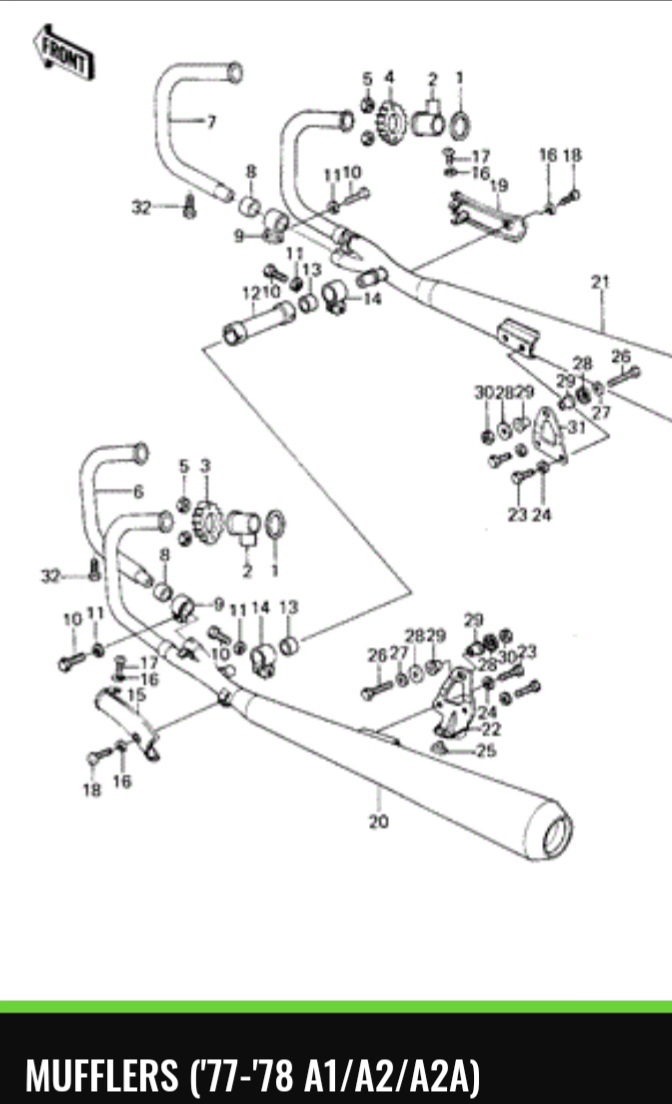

Exhaust hangers are part 22 & 31 or did I miss something?

The original post was for the part numbers detailed by Warren and these allow mounting of the Busso system to the existing A1 frame mounted hangers!
I’m with Warren and I’m not sure what’s being searched for!

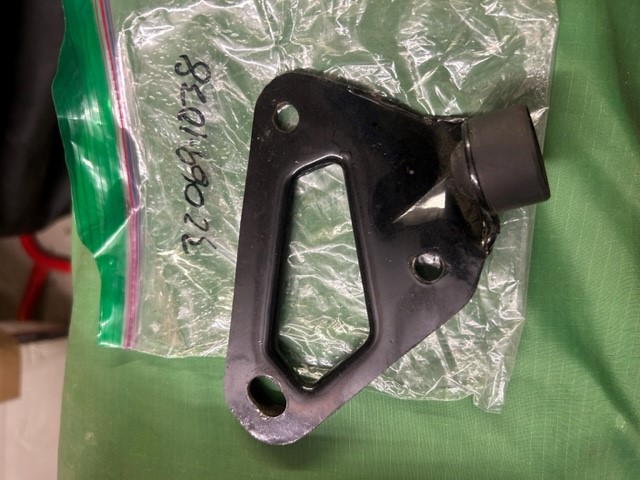

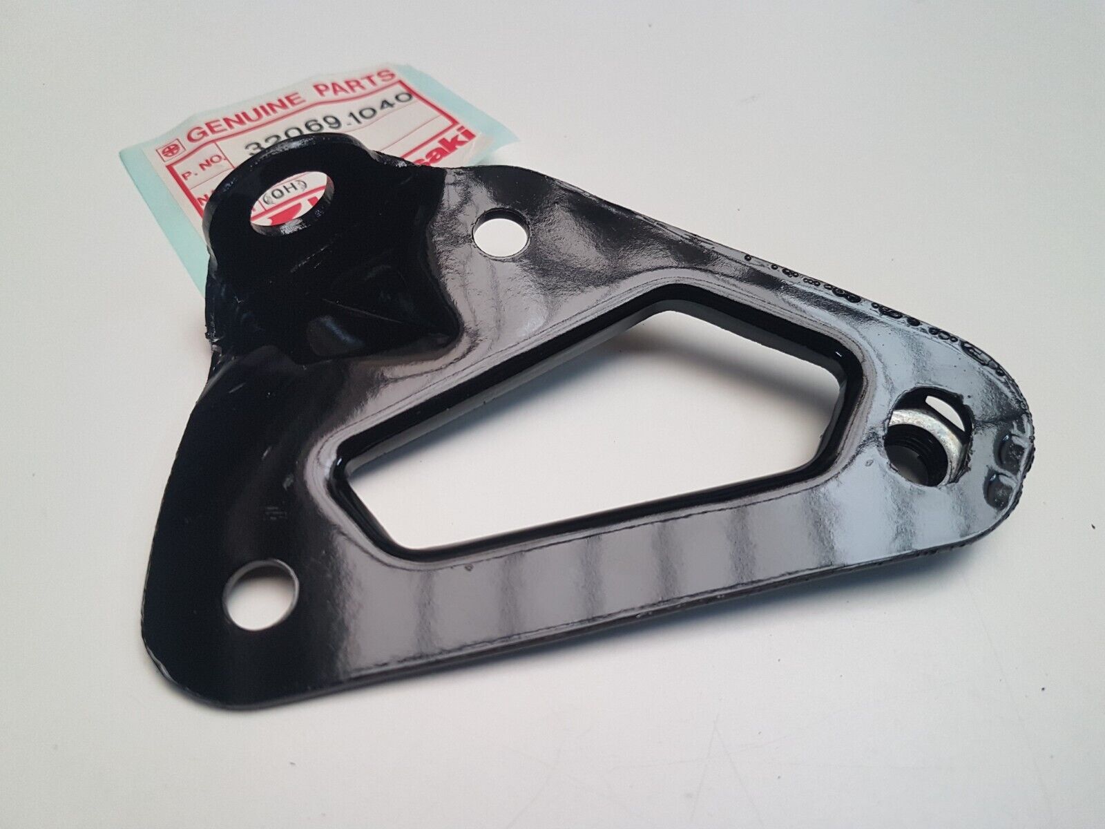

got the same question going on on FB with the z1r d3 exhaust hanger !!! with a bit of digging turns out its the same bracket as a z650/B deffo different part No's but same ?
1037 left z1r d3
d2 1038.jpg (88.61 KiB) Viewed 4644 times
650 b 1040

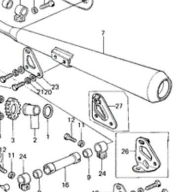

Well I've got a pair of 650 ones. Not sure the offside one has the extra hole on the 650 one though. I'll have to dig em out and post a pic. Part 23 & 26
Screenshot_20230417_200026_Samsung Internet.jpg (38.6 KiB) Viewed 4638 times
