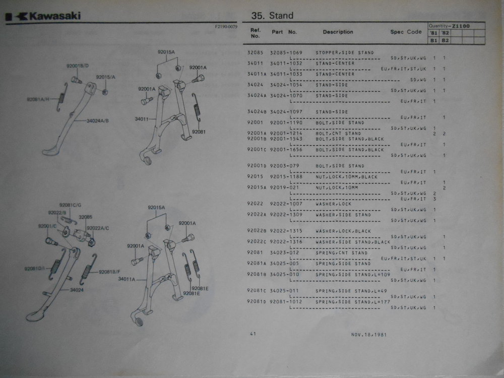

The page from the parts manual is from a European part catalog also covering UK versions. My B2 is an imported German model fitted with the red side stand overide switch. Came with a MPH speedo ?? which documentation shows was original.

I searched hi n lo to find a diagram with the override switch plate and switch. No diagram I found showed it. I only ever found diagrams as shown below without the switch.
I spent several hours fitting and refitting the additional plate and spring before I finally sorted it to work as I described previously.
The additional plate is the bit that's got the third spring attached with the other end attached to the switch.

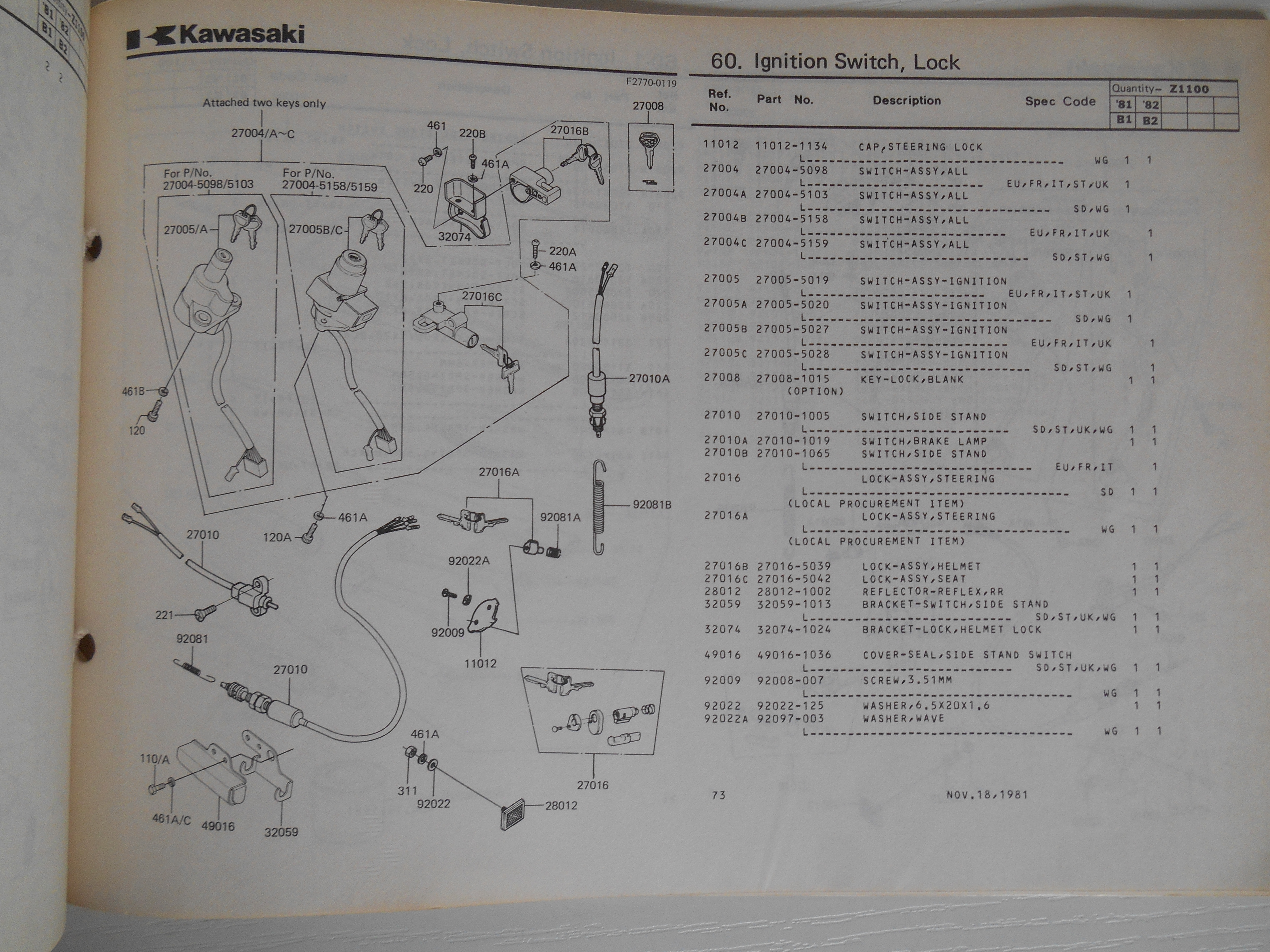

Hi.
Maybe not relevant on an R but my parts catalog shows also shows the later ( simple reliable set up ) plunger type stand switch. My B2 has unused wires for it behind the sprocket cover. Cant see how it was originally mounted though without frame adaption.

BAFF1960 wrote:Hi.
Have you got the diagram of the side stand from the same source?
The switch mounts to the ally footrest hanger plate.

Both pics came from from the same parts catalog , Pt No.99910-1184-02, very hard to find. You can never better original manuals. Had myself issues when originally putting this together due to a bodge. See my original post at GPz1100B2 Side stand/Cut out switch mounting.

Do you know, if this small red knob with function?

It's sprung loaded and allows you to lift the bike off the side stand with the engine continuing to run. If you don't press and hold it as soon as you take the Wight off the side stand the ignition will cut out.
