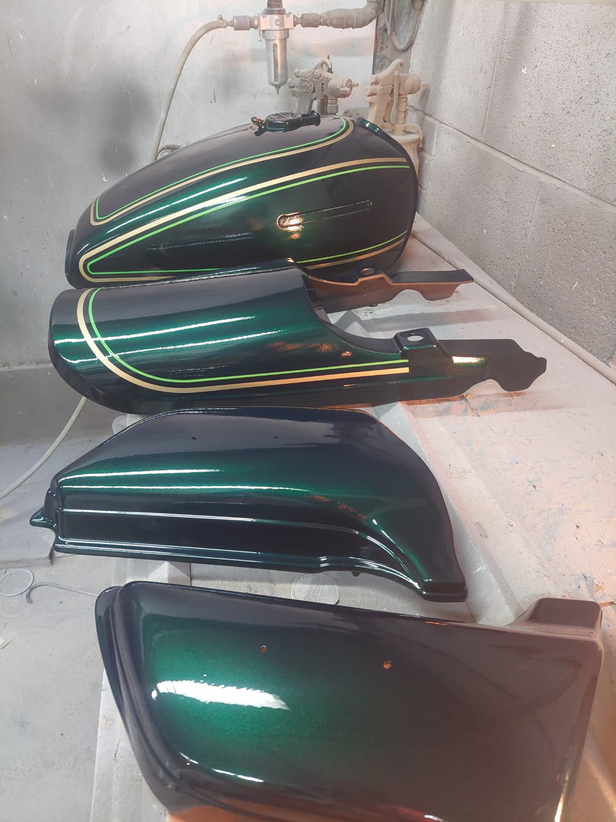

Hi Guys as requested here is a photo of my bike parts after re paint inc queried tailpiece
perhaps someone can identify which model its from.

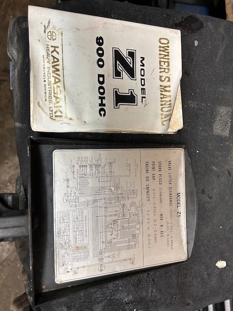

I have this if your interested but i woul drather sell the manual with the tray

The Z1 through Z1B all had the original styling with the flicked up tailpiece and under tank seams. The A4 and Z10000A1/2 had the edge seam tank and the flatter tailpiece. There were some detail differences between models but this was the basic style.
The early tailpiece was much better looking and was the designer’s original vision. They look similar but if compared side by side the flatter one completely changes the stance of the bike - for the worse in my opinion - why Kawasaki messed with the original lines which were bang on is anybody’s guess. That’s a reason why someone might fit an early tailpiece to a later bike it’s a far better line, although if painted in the correct colours most people won’t even notice.

To be honest i couldnt tell the difference myself, but now youve said mine is the more curved version, when i got the bike prev owner i think had tried to convert it to a Z1 lookalike, blacked engine, wheels etc and changed clocks and idiot panel etc, i have sytematically tried to put it back to the A4 model it should be, however its easy to miss parts like the tailpiece. Im not going to replace it now as stated its all painted up and yes i do think it looks sleeker then the correct one.

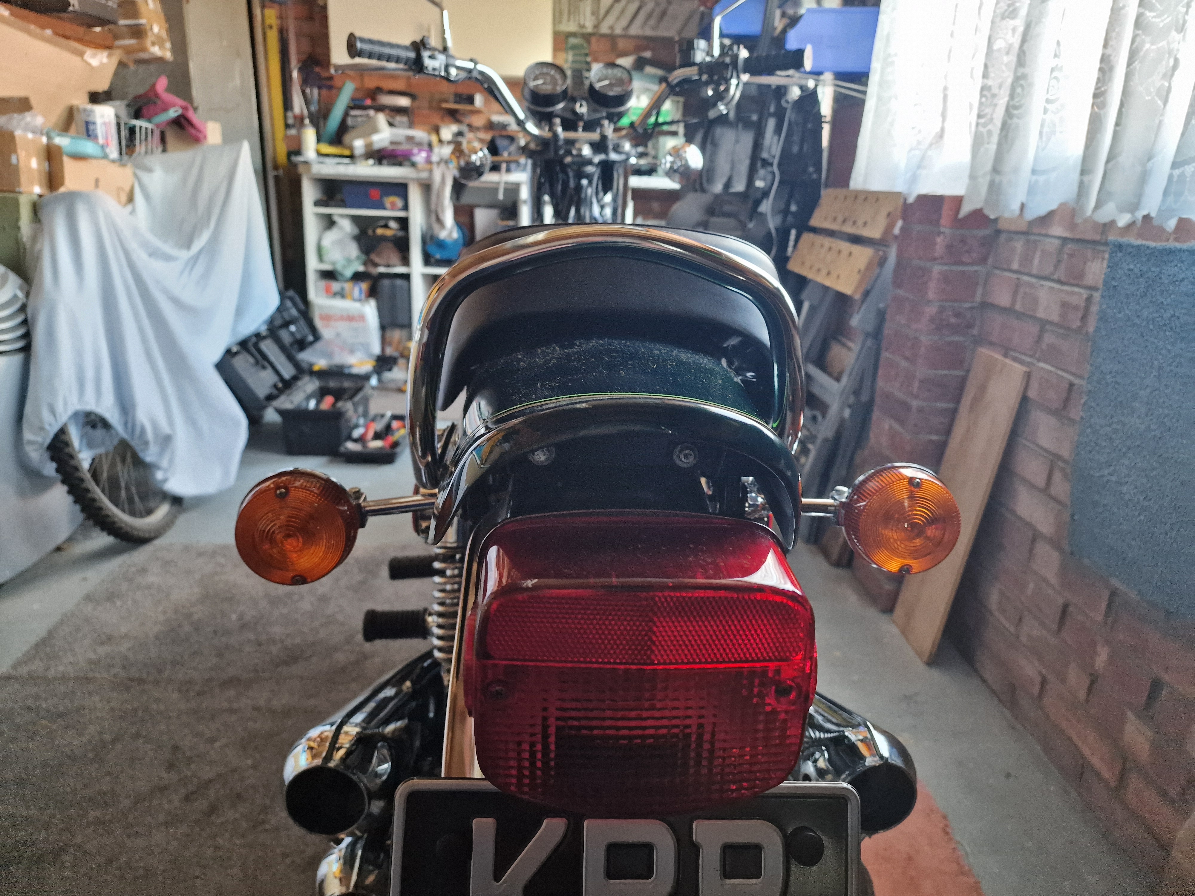

There you go rear view of tailpiece.

That's an earlier oval tail light version.

Cheers Warren, yes thats what i thought and explains why the A4 tray wont fit. As for PMs thought they showed up in outbox until opened, (least all my others have) by recipient, in this case they just dissapear dont show in outbox or sent box? Tried 3 times same result.

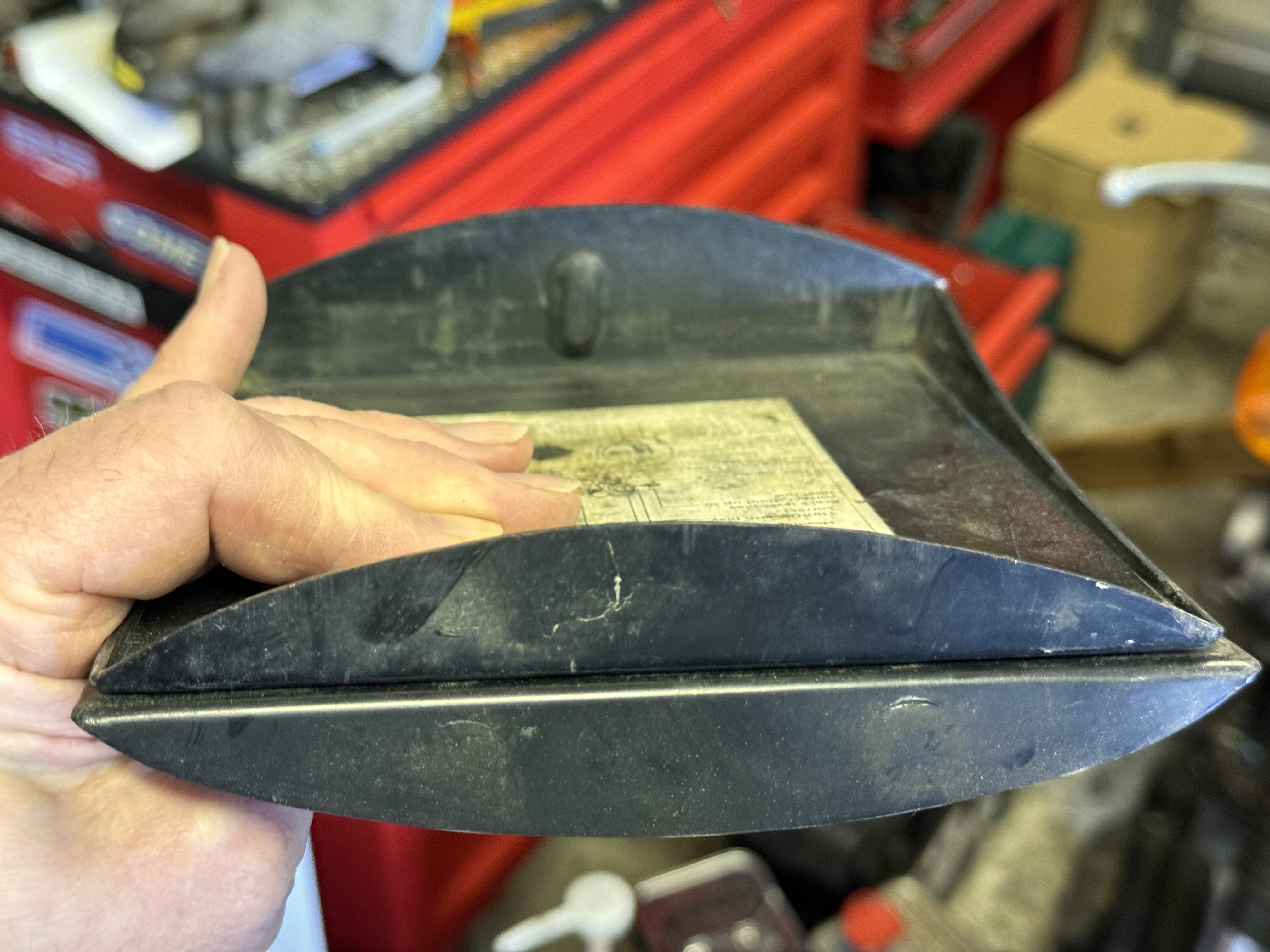

The A4/Z1000 tray is about 5mm wider at the back, the original tailpiece is tapered slightly, the later one is more parallel - another reason early looks more elegant.
I'd stick an earlier tailight on there too it's nicer than the square one as well.
