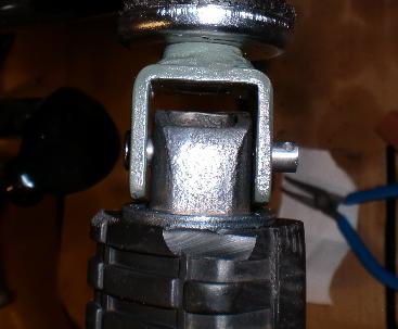

Some time in the dim and distant past, the footrest bracket had got broken and someone had used a bolt to attach the bracket to the frame. I've repaired the bracket by welding in a new M10 bolt without a head but they also filed down the footrest bar to clear the bolt head and now it's not long enough to catch on the bracket; so the footrest flops around and is useless :( )

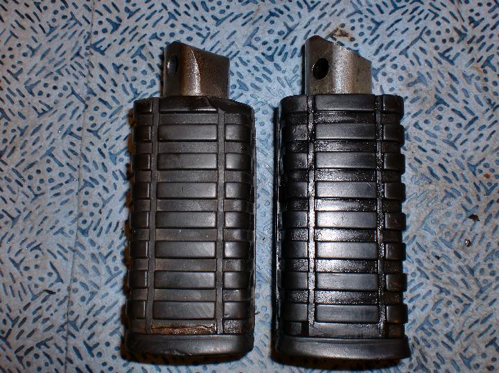

Just as a followup to this...... the Z750 pegs arrived and they are identical to the Z1R pegs. I too had heard a rumour that the Z1R rubbers were unique but this seems not to be the case.
Spot the difference:

result :D

They look identical to the later Z650 pillion footrests too, at least on my F1.
