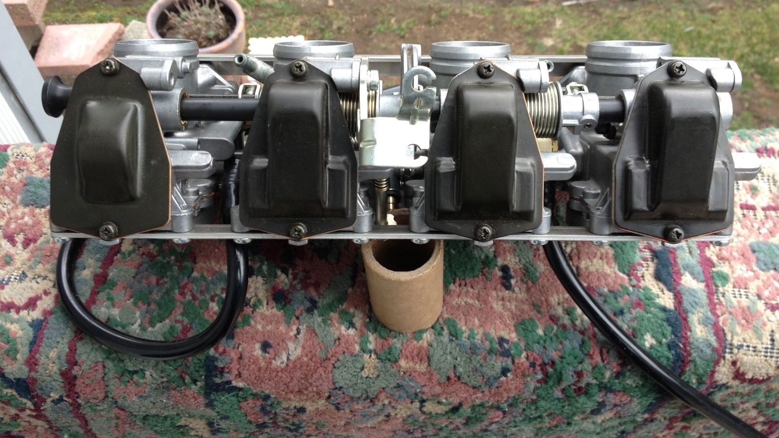

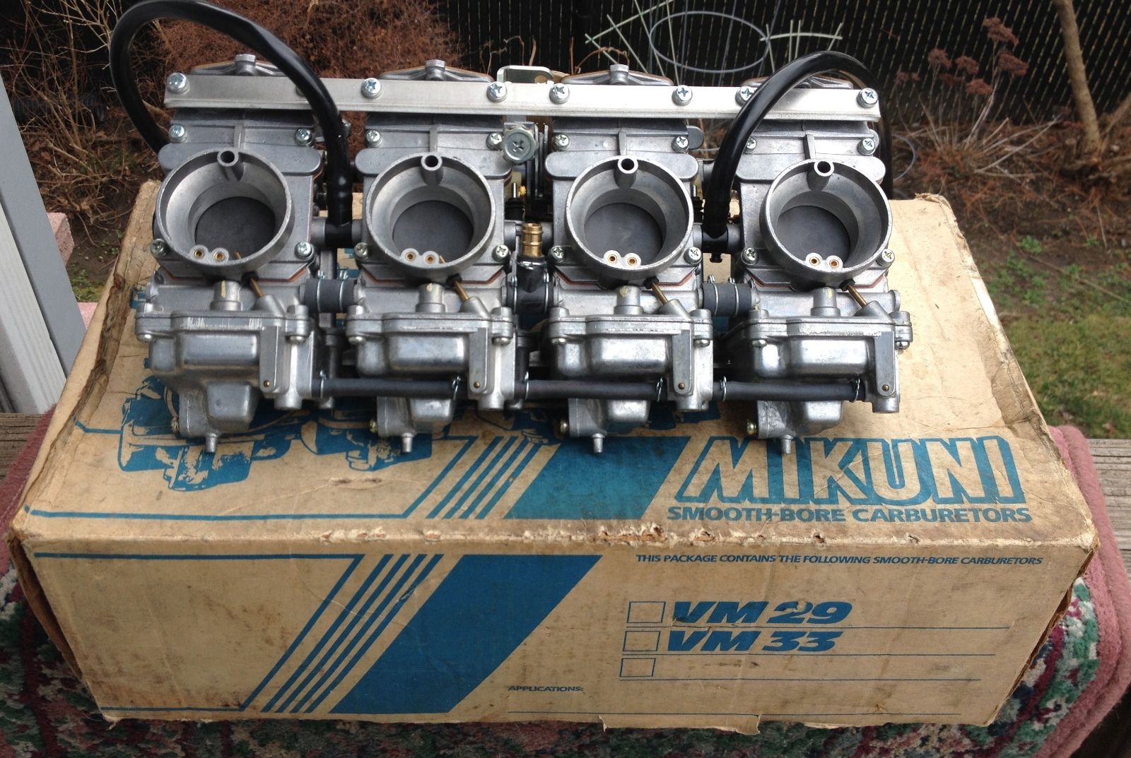

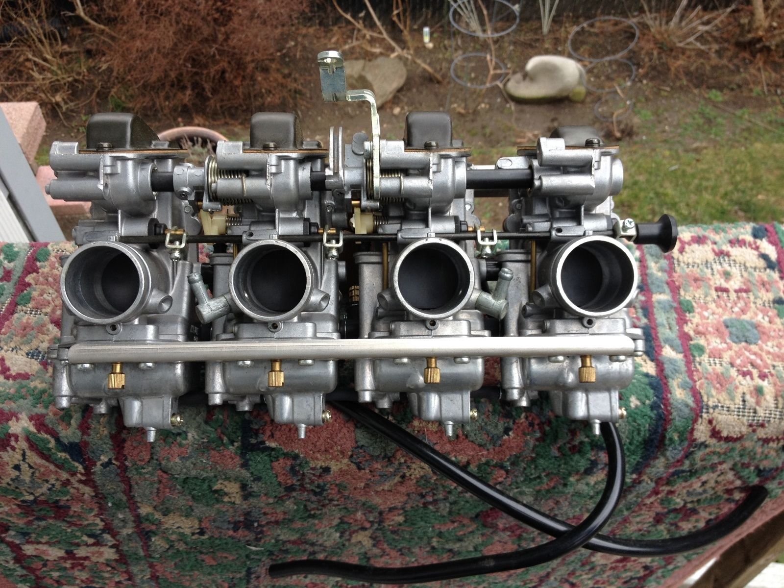

#11 PostAuthor: chrisw1 » Sun May 21, 2017 7:04 pm
I have just bought these Tm33s to fit on my 1000r .........I'm watching this thread with interest

#15 PostAuthor: chrisw1 » Wed May 24, 2017 7:39 pm
they would be more suitable for mine Swampy than the one I have ........im interested
