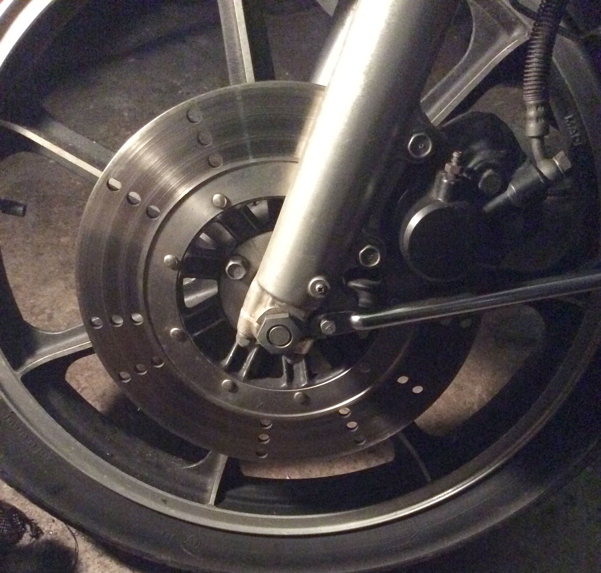

The one on the other side looks like this. Cheers, Ralph

The one I have is un-drilled, and ive no idea what i want for it, make me an offer whats the going rate for a used Zed disc?
