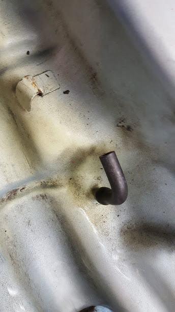

Bit of a long shot, but has anyone got one of these elbows (Part No. 52014-1001) ?
If not, has anyone found a suitable replacement to do the job ?

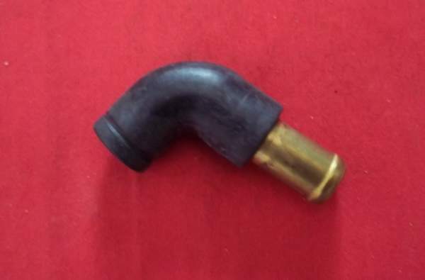

this is similar but one side is about 6mm the other between 8mm & 10mm
https://www.ebay.ie/itm/Kawasaki-39062- ... 2032446630

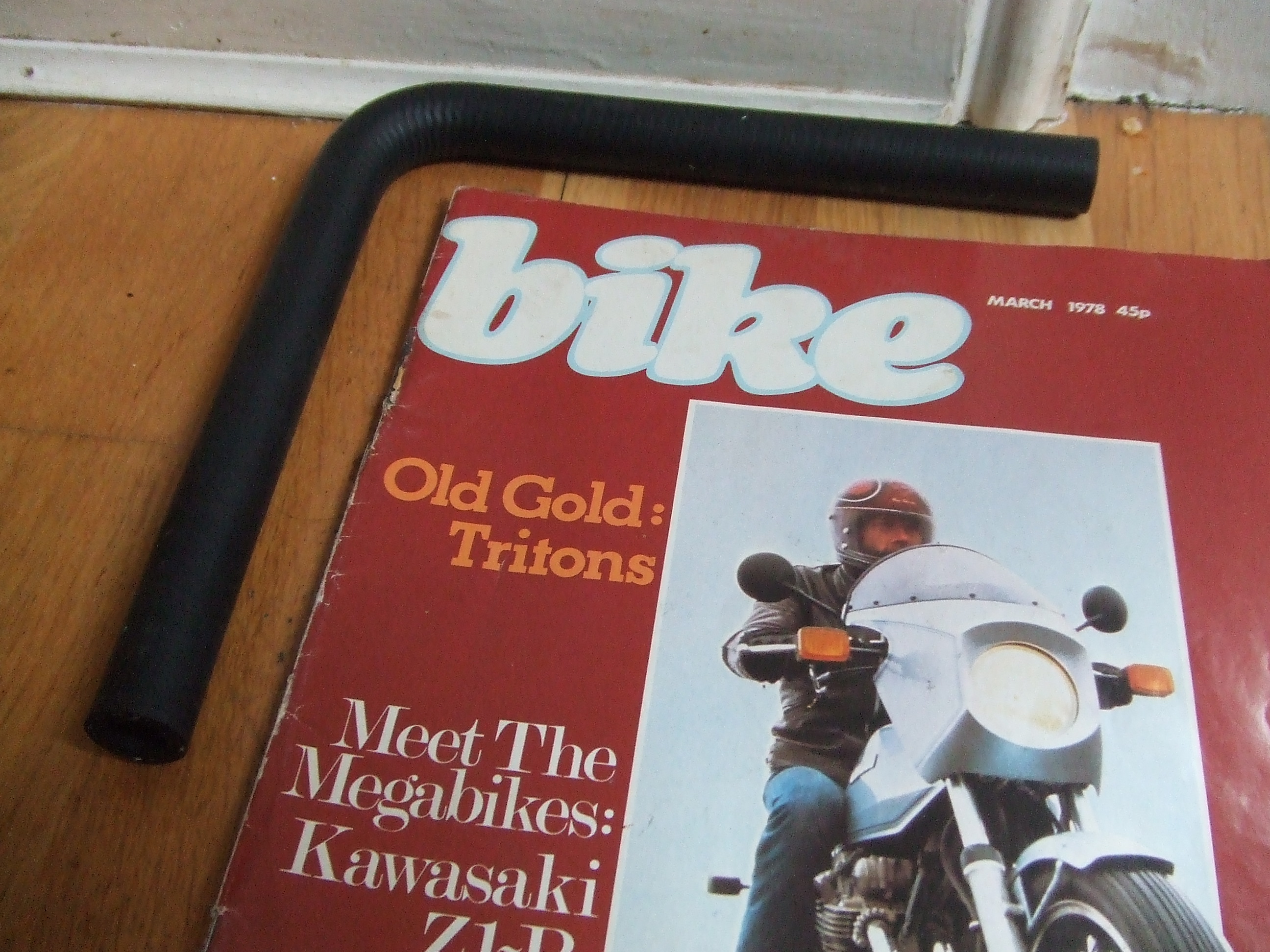

I replaced mine about 5 years ago but could not find an original for sale.
The problem with the original is It is made in 2 halves (lengthwise) and over time it literally falls apart.
So I bought a couple of these off ebay & cut the one I have in use down to size
It is basically a right angle fuel line with reinforcing cords running down the length.
I put an old magazine I had lying around, in the picture - to give an idea of size / scale.
I can't remember the supplier name now but a bit of searching should bring up similar items.
if you are not worried about 100% originality, something like this is a practical alternative.

I ordered 1 of these on the off chance it might fit......which it does perfectly. It's a fuel pipe elbow for a Fiesta Mk3 diesel.
nice but do you have the rest of it ?

I'll fit an 8mm push fit straight connector to the other end and then it's a length of fuel hose .
