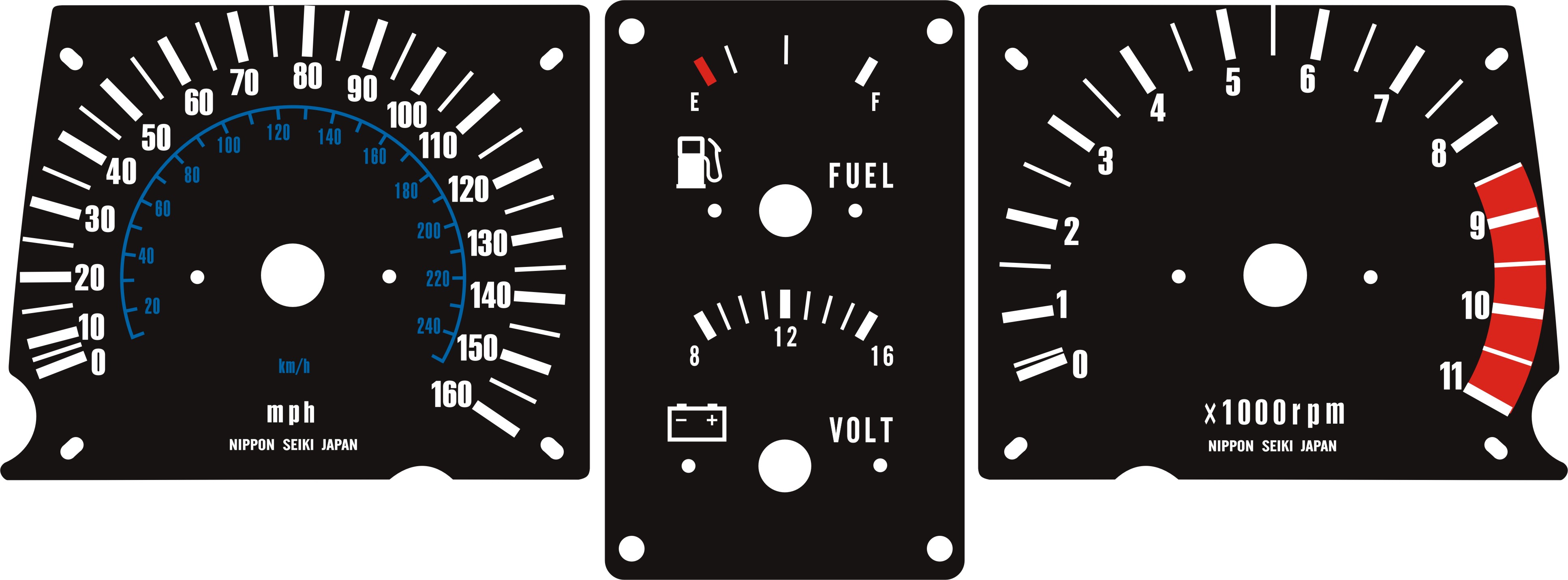

I'd say 'grab the 80 mph' jobs if poss rob. that way you have summit to work with.they can be re-calibrated with a new back plate to uk/euro spec.
Re: Gpz1100 b1 clocks
Have to agree with Mark, grab the 80mph ones NOW!
You could easily fit the head unit from the Z1100A or early Z1000J to replace the 80mph one.
An examples on offer... https://picclick.co.uk/Kawasaki-Speedo- ... 49602.html
The range has the same degrees sweep so should be perfect. I can then supply you (or fit) with a 160mph gauge face kit.

Will, if he bought a kmh euro clock and he put one of your mph overlays on would it read correct they look very close when you look at the degrees . Also do you repair these clocks and know how too test them.
Cheers for all the responses. I have bought the 80 mph from Germany. So i will be after getting them sorted after Christmas.

samspoons wrote:Will, if he bought a kmh euro clock and he put one of your mph overlays on would it read correct they look very close when you look at the degrees . Also do you repair these clocks and know how too test them.
Correct Sam, yes it read perfect if fitted with one of my MPH overlays on too.
Only way I can think to test one is to apply 12v, connect the hall sender and spinning it.
