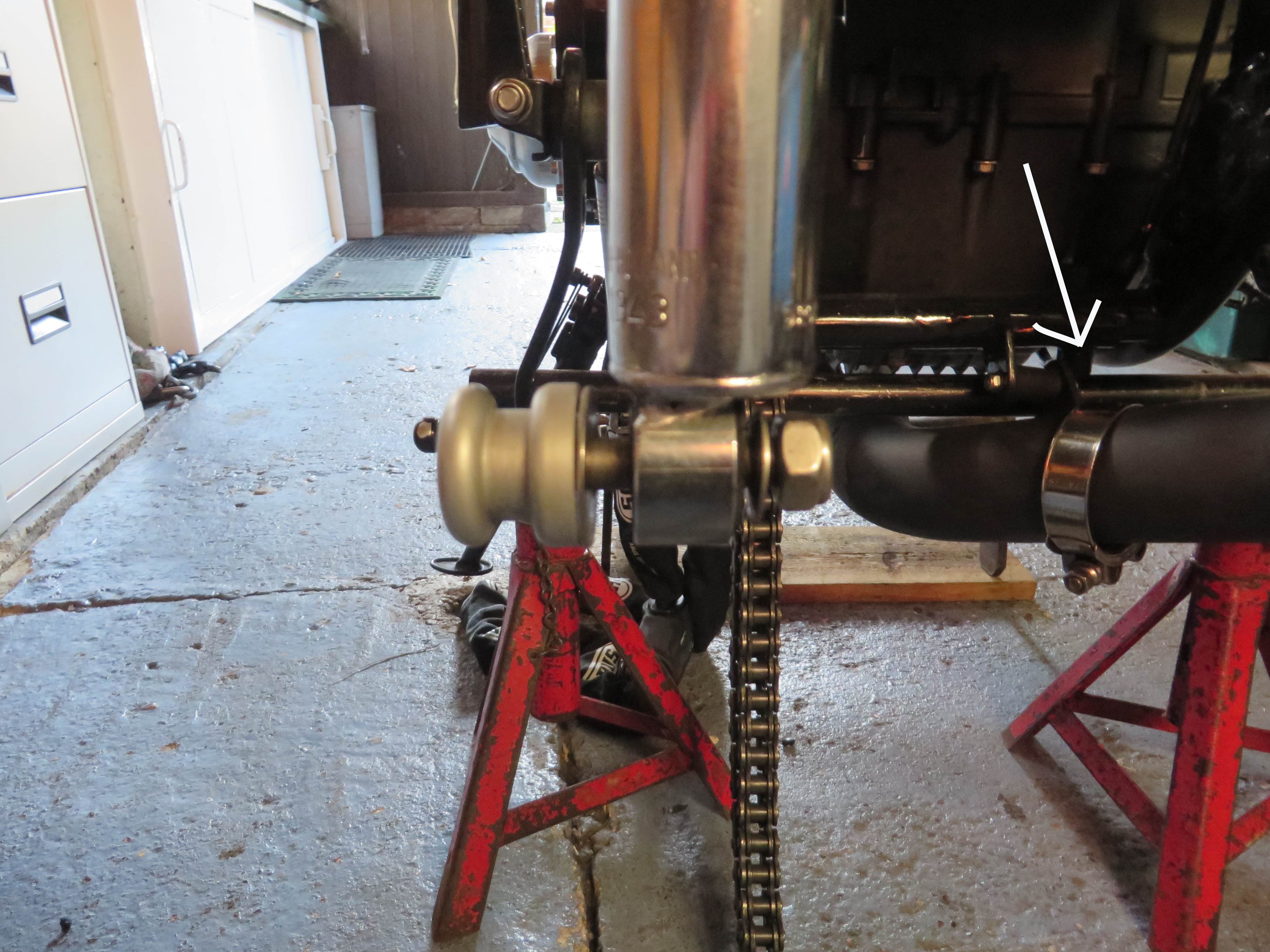

I dont have one anymore but thought i would mention an alternative. I use an 18 inch long piece of 1 inch OD, thick walled, steel tube with two holes drilled in it. It clears my exhaust and when bolted onto the two spigots on the bottom of the frame, provides a very quick and easy method of lifting the bikes rear wheel clear of the floor in the same way the centre stand did. I just put an axle stand on either side. One side first and then sort of hinge it up and push the other in with my foot. The two spigots have a standard 8mm metric thread. Quick, cheap, basic.

The arrow shows the RHS spigot and there is an identical co-responding one to the left.
It may or not clear youre exhaust. I took a gamble since the majority of J's dont have standard exhausts!!

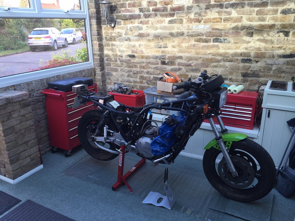

I use an ABBA stand on my Gpz - works well in the workshop. I’m not sure if the J is as easy but I imagine it can be made to work.

OK, so having looked under the bike I can see the spigots now (presumably held the original exhaust in place?). My Delkevic doesn't leave enough clearance for a one inch tube, so I've ordered some flat steel bar 50mm x 10mm which should be thin enough to squeeze through and sit nicely on my axle stands.
AL - using the "measure twice, cut (drill) once" advice, I don't suppose you could tell me the centre to centre distance between the two spigots? (or the holes in your tube)

180mm holes centres but that's measuring upside down as its on there with wheels out. Do yourself a favour and drill 12mm holes for the 8mm bolts and allow a little wiggle room. Should also point out that the location mentioned is not the balance point and to work on the front end you would still need to support that independently.
