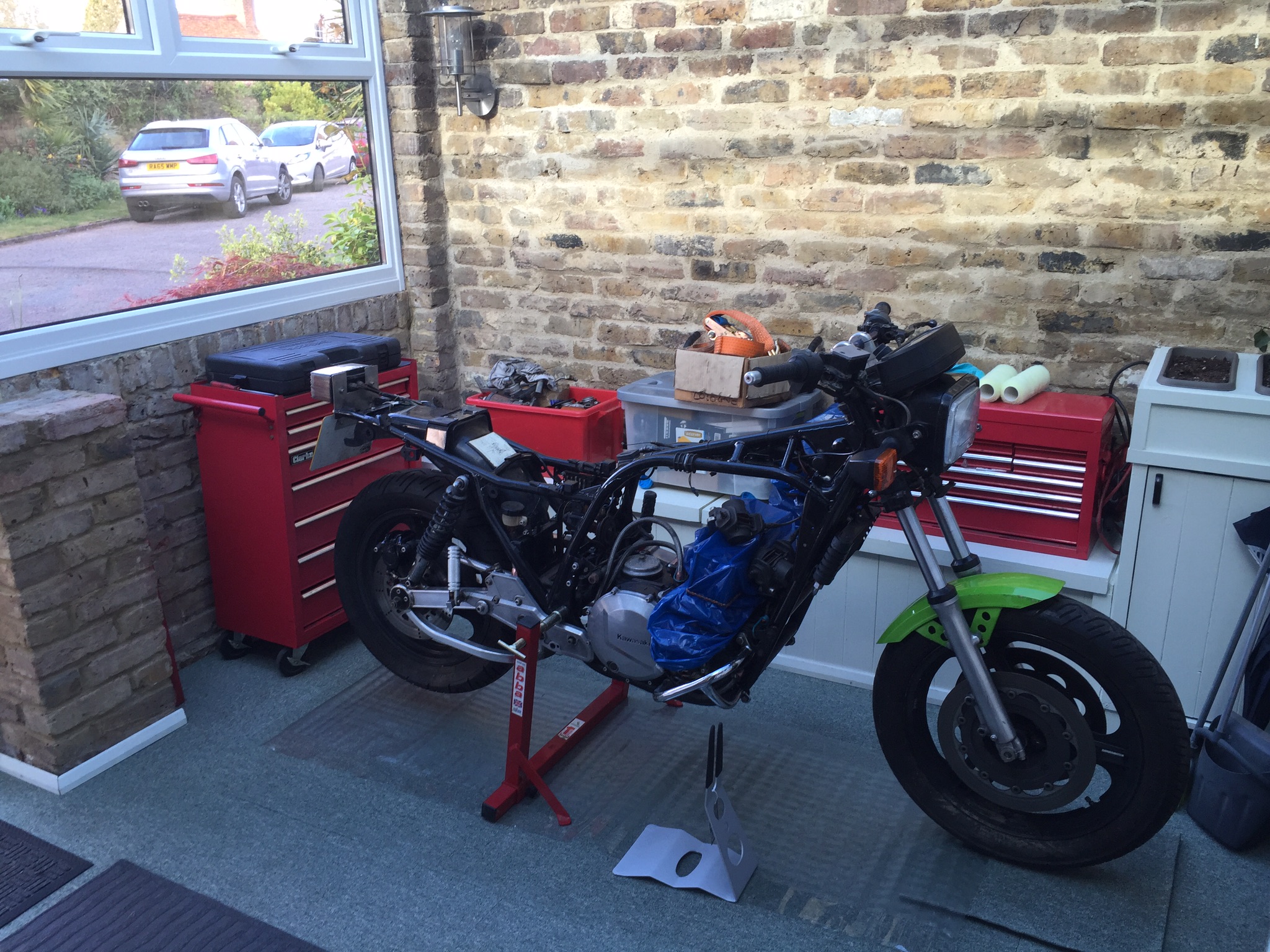

Re: Centre stand for Z1000J
Posted: Sat Mar 02, 2019 10:18 am
Author: rickm
OK, so having looked under the bike I can see the spigots now (presumably held the original exhaust in place?). My Delkevic doesn't leave enough clearance for a one inch tube, so I've ordered some flat steel bar 50mm x 10mm which should be thin enough to squeeze through and sit nicely on my axle stands.
AL - using the "measure twice, cut (drill) once" advice, I don't suppose you could tell me the centre to centre distance between the two spigots? (or the holes in your tube)
I'll measure them anyway, but always good to have a second opinion !
Ta
Rick
Posted: Sat Mar 02, 2019 2:28 pm
Author: Al
180mm holes centres but that's measuring upside down as its on there with wheels out. Do yourself a favour and drill 12mm holes for the 8mm bolts and allow a little wiggle room. Should also point out that the location mentioned is not the balance point and to work on the front end you would still need to support that independently.
