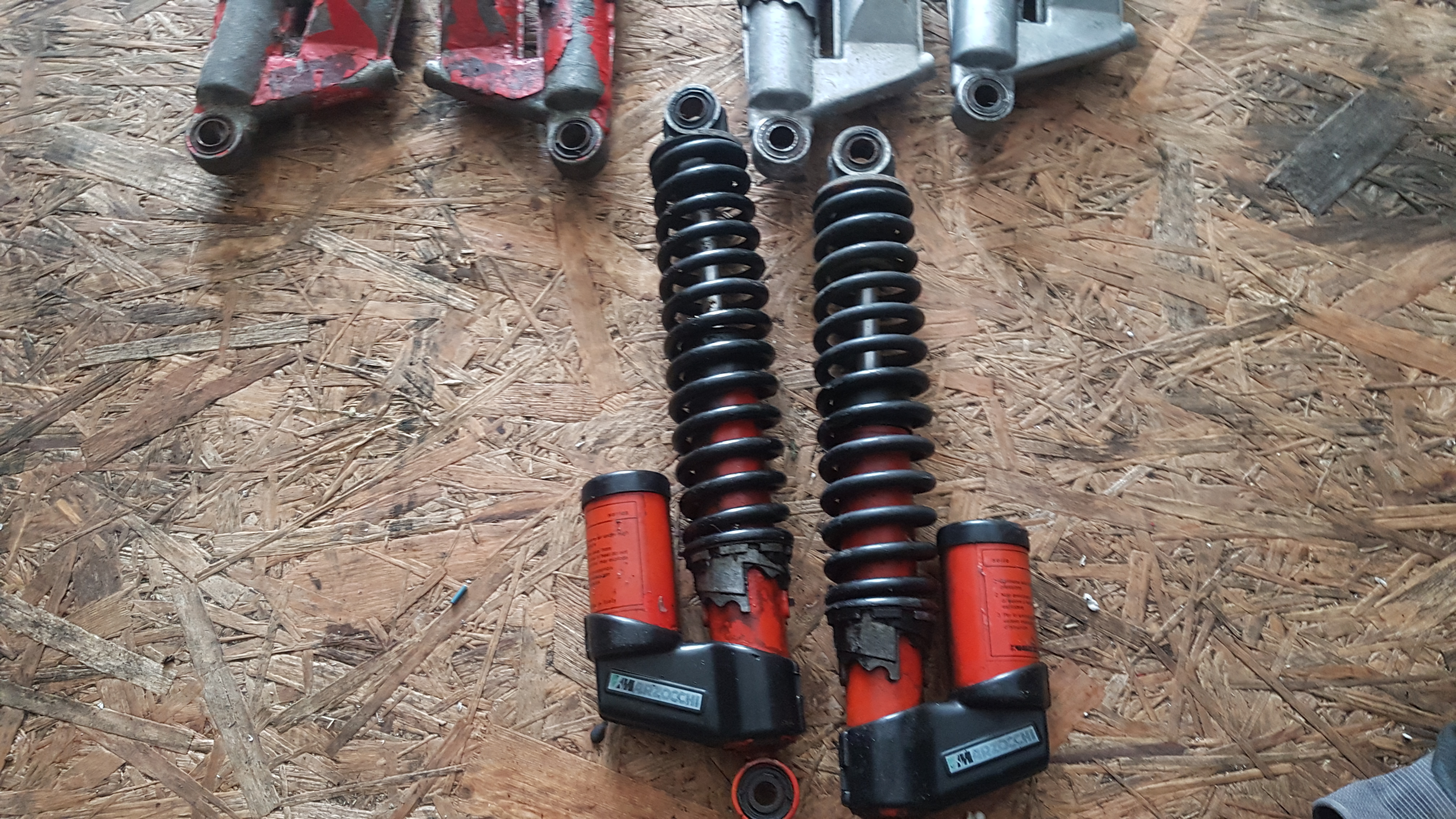

Trying to refurb these from my Z900A4. Does anyone have or know anywhere with a rebuild kit.

The rebuild kits dried up a few years ago now. They do appear on Ebay occasionally but at comedy money. I have seen em advertised at well over 150 quid !!
You could get in touch with THIS COMPANY and see whats available from them, they dont look as comprehensive as the older kits, but it looks like the seals are there. Check your piston rod diameter as there are different sizes.

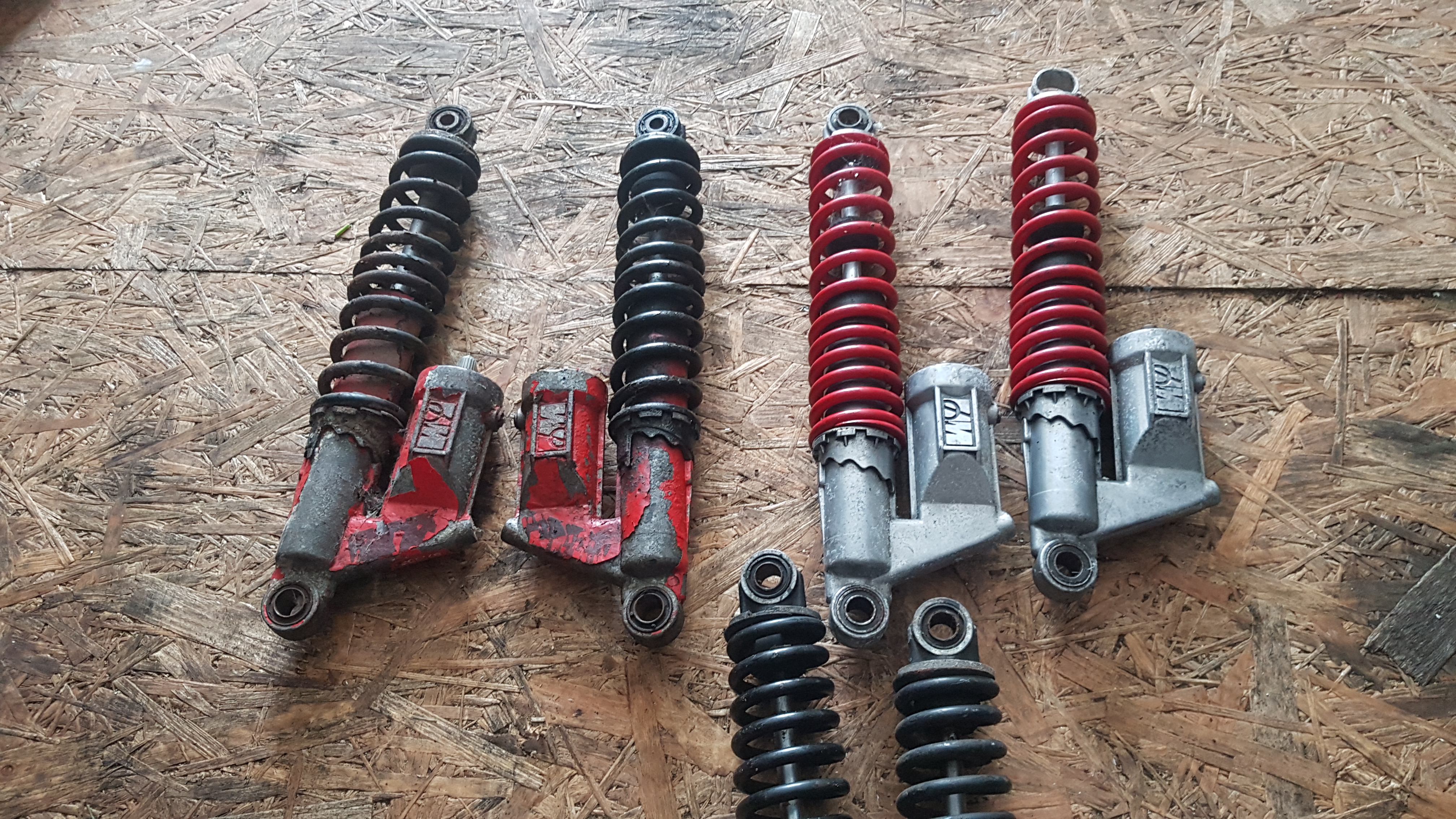

I have a few decent sets of marzochis

I tried to put an order thro on the Italian 'THE COMPANY' but no response and didn't take my paypal.
Thanks anyway.

Give these guys a ring.
They may be able to do them for you
Super helpful
http://www.tillitsuspension.com/

Have you just tried any bearing specialist as they tend to have a massive range of seals, you might be lucky, I was with clutch push rod seals

I have 3 sets two are pretty good one set needs a repaint

Turns out 'the Company' in the second post came through and kit arrived yesterday.
