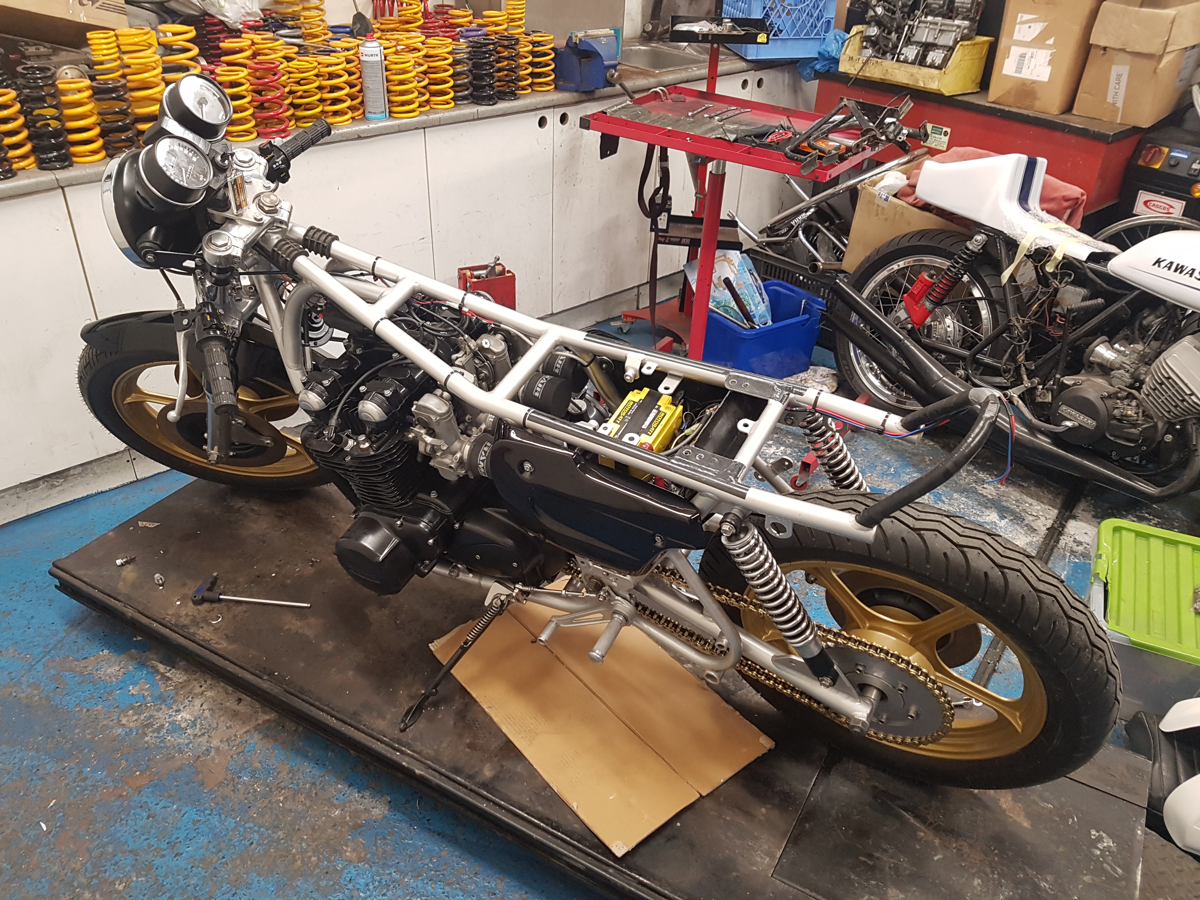

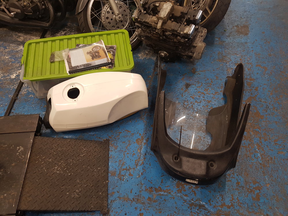

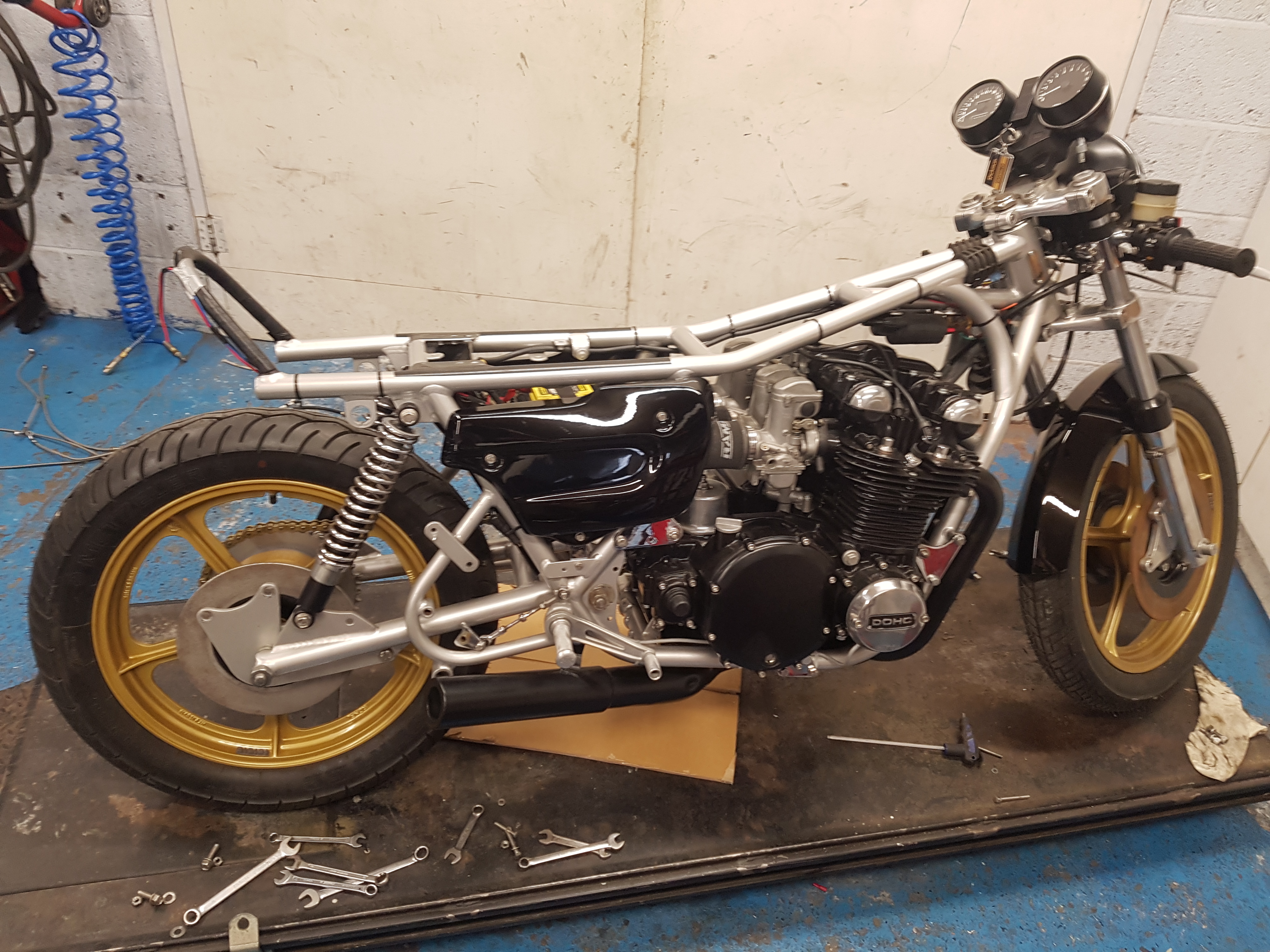

Here we go...........
Brakes are being sorted as putting new lines on.
2 tank covers, one normal length and a twin seat and the other tank cover is longer with a single seat

#11 PostAuthor: Jumbo » Tue May 19, 2020 8:58 am
Bike is looking good has the frame been painted. Is that your frame number mine is 5579.

#13 PostAuthor: Gizburn » Tue May 19, 2020 8:15 pm
Hi,
I believe that's the frame number and meant to check when I was with the bike (as its not at my house at the moment).
I'm going to put the longer tank cover on with the single seat and colour will be black.
I have new decals and all the front fairing bits and pieces to sort!!

#15 PostAuthor: Big Fluff » Wed May 20, 2020 5:00 pm
If you are going to fit the long tank cover, have you also got the long steel tank?
If not then although you would be able to mount it, you would have to secure it at the rear with a long threaded spacer arrangement, but be warned that the rear of the tank cover can mover around a lot mounted like that and may crack the paint around the mounting.
Long steel (or short for that matter) tanks very rarely come up for sale unfortunately.
Nice bike and stick at it, you're nearly there by the looks of it.
