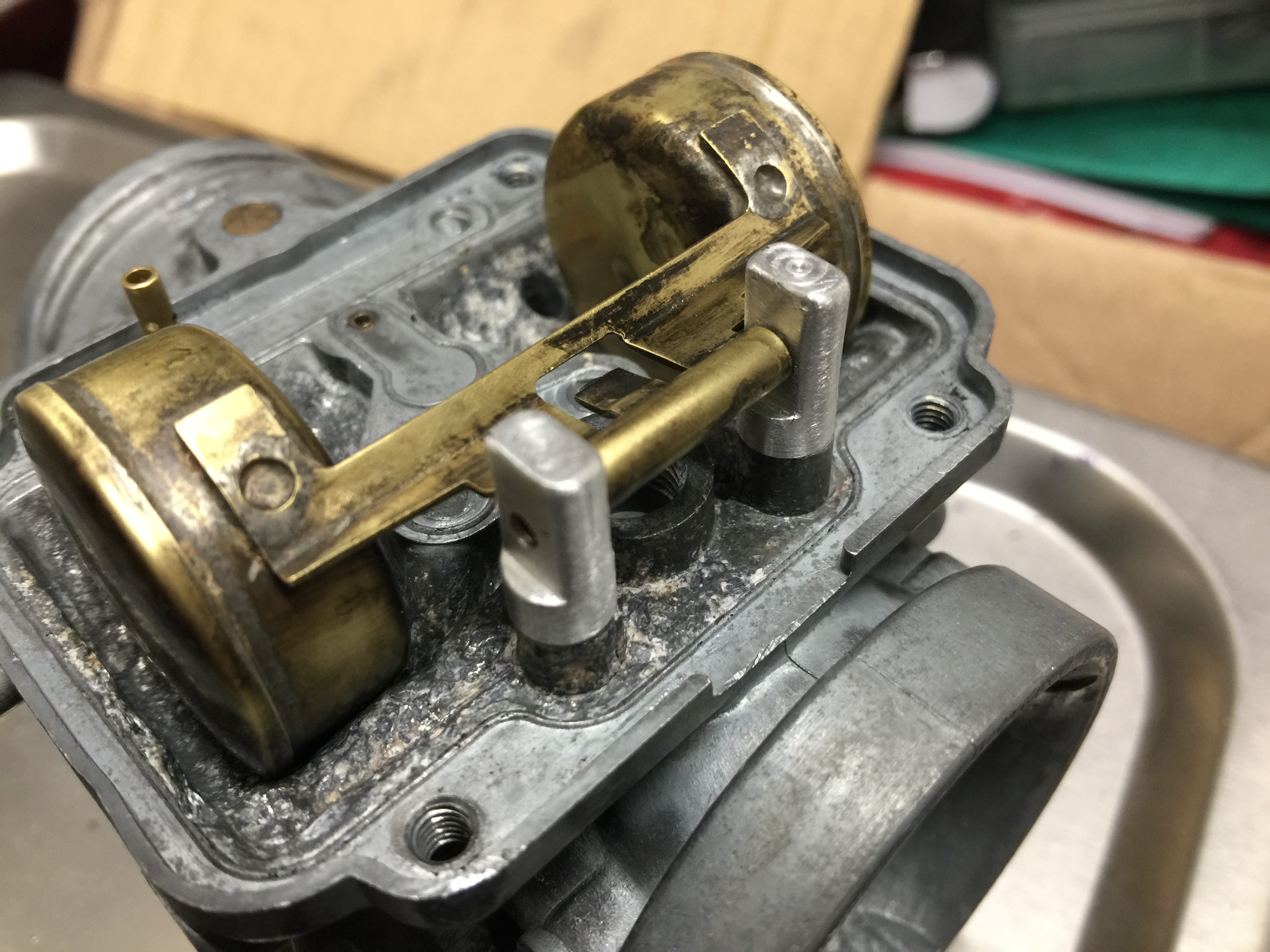

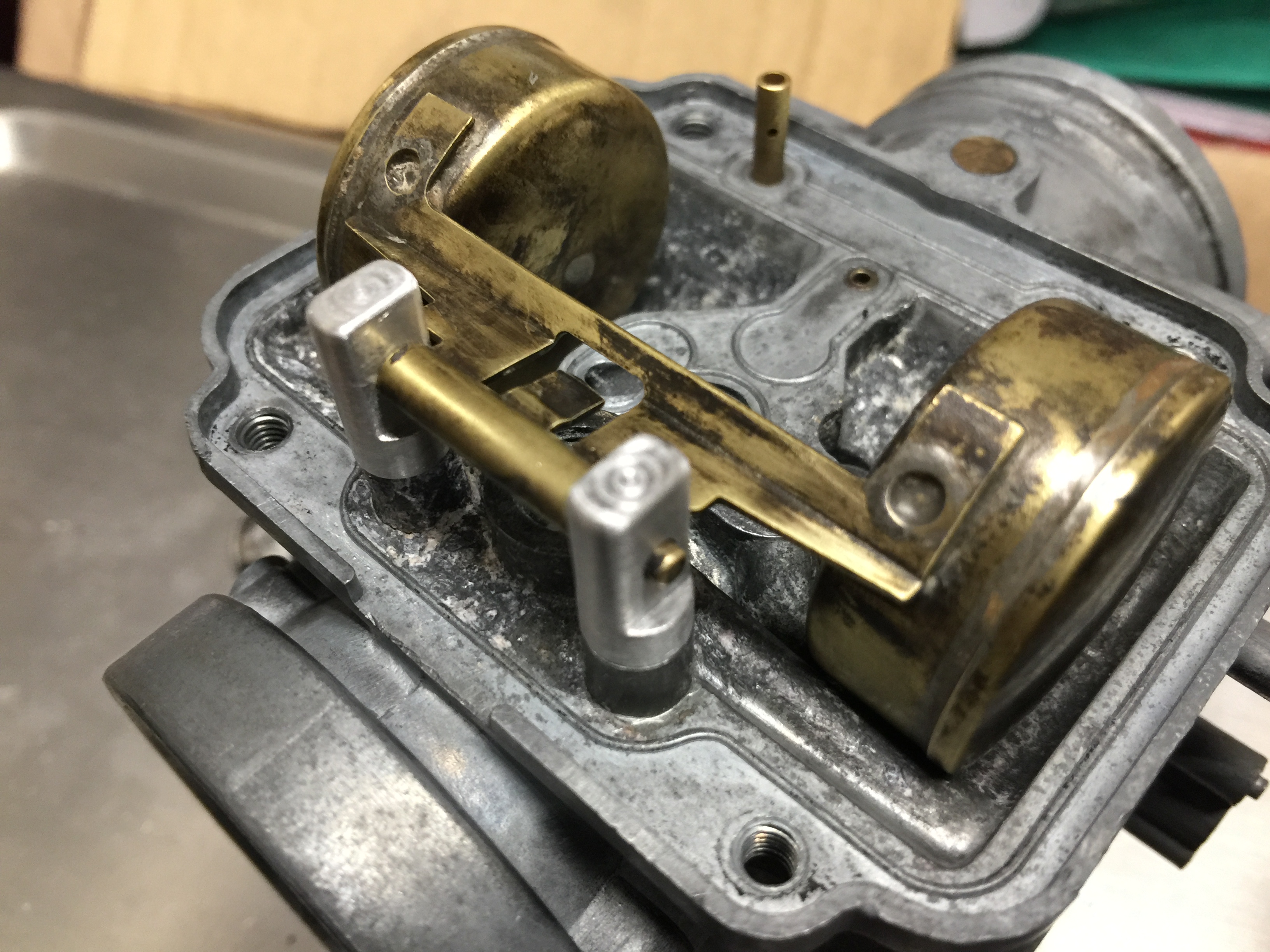

It is possible to mechanically repair carb posts in certain circumstances.
I’ve just repaired a hard to find body from a TX650 where both posts had simply corroded away.
I machined off the rotten stumps, turned 2 new posts and then drilled and tapped both M4 and fitted a high tensile M4 stud held in permenantly with JB Weld which is fuel resistant.
I’ve done this on a number of occasions with a successful outcome every time.
It does however depend on the condition and the design of the body and what previous attempts have been made to effect a repair.

Posts: 1406
Re: Z900 A4 carburettor body wanted
#13 PostAuthor: Bill P » Fri Sep 25, 2020 8:19 am
Crackin job you did there r3sc :)
Posts: 757
#14 PostAuthor: r3sc » Fri Sep 25, 2020 8:35 am
Cheers Bill!
I had to go that extra mile as the carb body was very year specific and difficult to find so had to repair it and it’s always nice for me to keep the original equipment on a bike!

#15 PostAuthor: Paulb » Sat Sep 26, 2020 8:02 am
The repair is brilliant.
I have the same problem on a set of A4 carbs, one post snapped, I'm going to give it a go!
