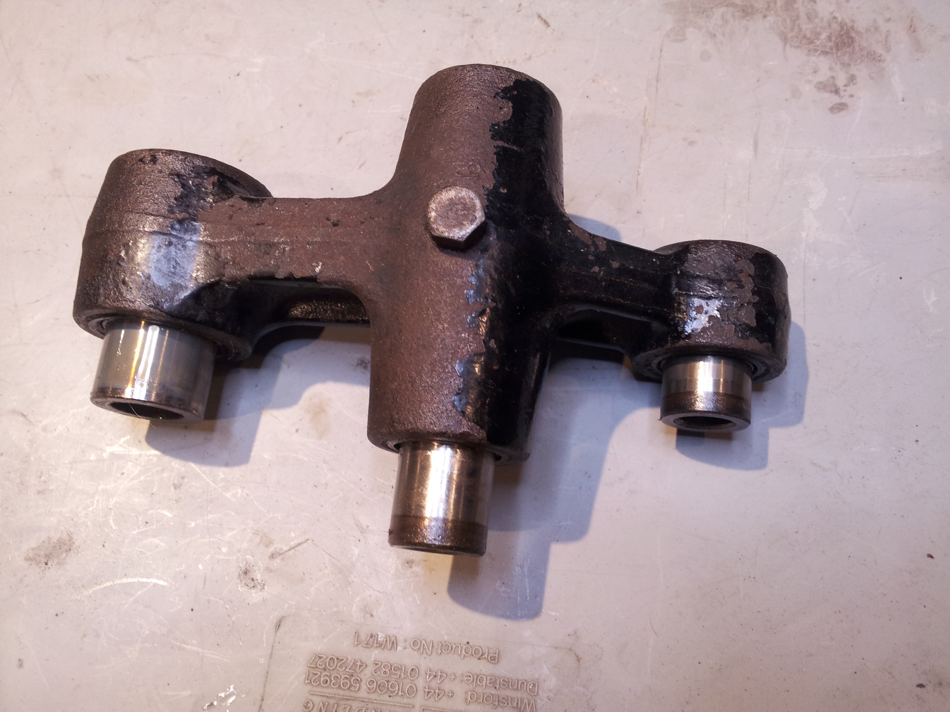

I'm looking for two of the bearing sleeves for the rear suspension rocker arm.They're nla , i could get steel ones made but the originals are case hardened. Cheers.

I know what you're saying. I encountered the same issue. If you have a lathe yourself or if you know someone who has a lathe you can use a rod of "cemented" steel of 20 mm diameter. The outside of that rod is hardened but the inside of rod can be machined, drilled out in order to make a replacement part.
If you google "cemented steel" you can find a supplier in the UK I guess ...
Good luck

Thanks Philippe, can't find anything like that in the UK though.

Is this what you're after Zippy?
No good to me anymore.

Think i'm sorted now Gus. Thanks for the offer mate.
