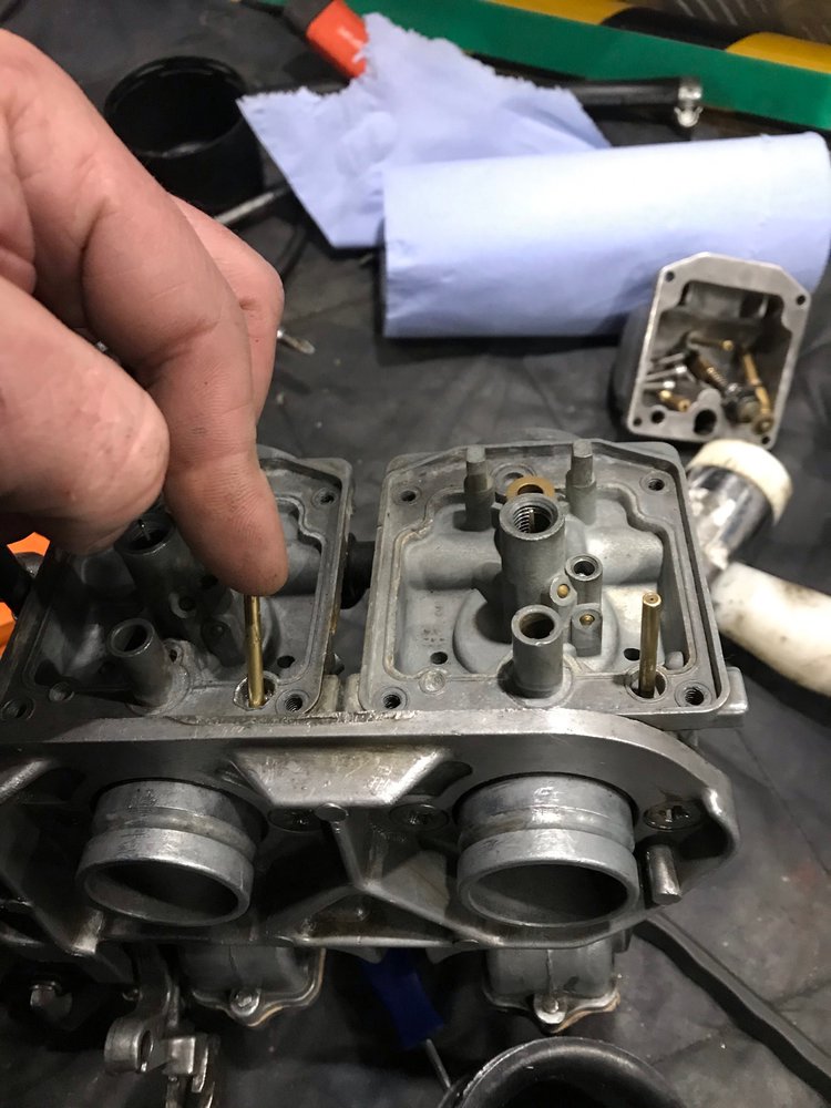

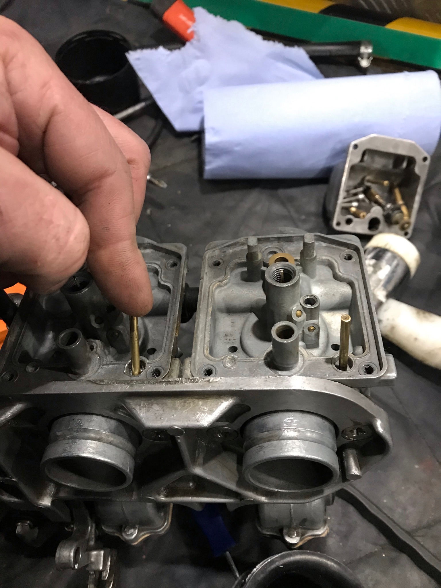

Hello Chaps
Does any body have a choke pick up tube, I manage to break one! I have been reliably informed that these are not available as a spare part if any one has one that they would like to sale, let me know. Many thanks.

Never had to do one of these, but you maybe better off sourcing some tube to sleeve what you have or make up another tube utilizing the jet in the existing one.

Hello Kev, I may have to do something like that, only issue is where it snapped off is where there is a tiny pair of holes that I assume are important, I can’t believe I done it, drop the carbs when I was turning them over and bent the tube and as I tried to bend it back I broke it leaving part of it in the body of the carb. Hopefully some one will have one.
