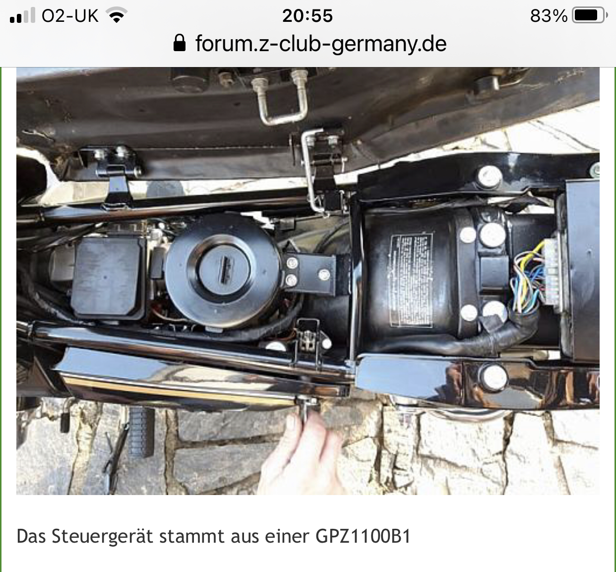

Another possibility I’ve seen on the forum is grafting a GPz1100B1 ECU onto the H. But I’d need to do a fair bit of homework before attempting that…
I’m pretty sure it is the ECU. The plug and wiring are in good order and check put reliably with a DVM. Swapping ECU’s on and off confirms that.

...Think the B1 has a different plug?...pm me I have some spare ECU's if it help get the H back on the road

Thanks a lot Rob. Yes - the wiring/plug on the B1 is different. I guess you’d need to buy a B1 loom and hack the plug off, then wire that into the H loom. One of the German guys showed an image of this on the forum. Not sure about compatibility of sensors and the B1 map, but I guess it worked.

i've got a spare B1 ECU and loom.
As you say it apparently works but i've never tried it. I think Peter Krauss knows someone who has made it works but that could be a false memory (I'm old...)
Hopefully Rob can sort you out.
