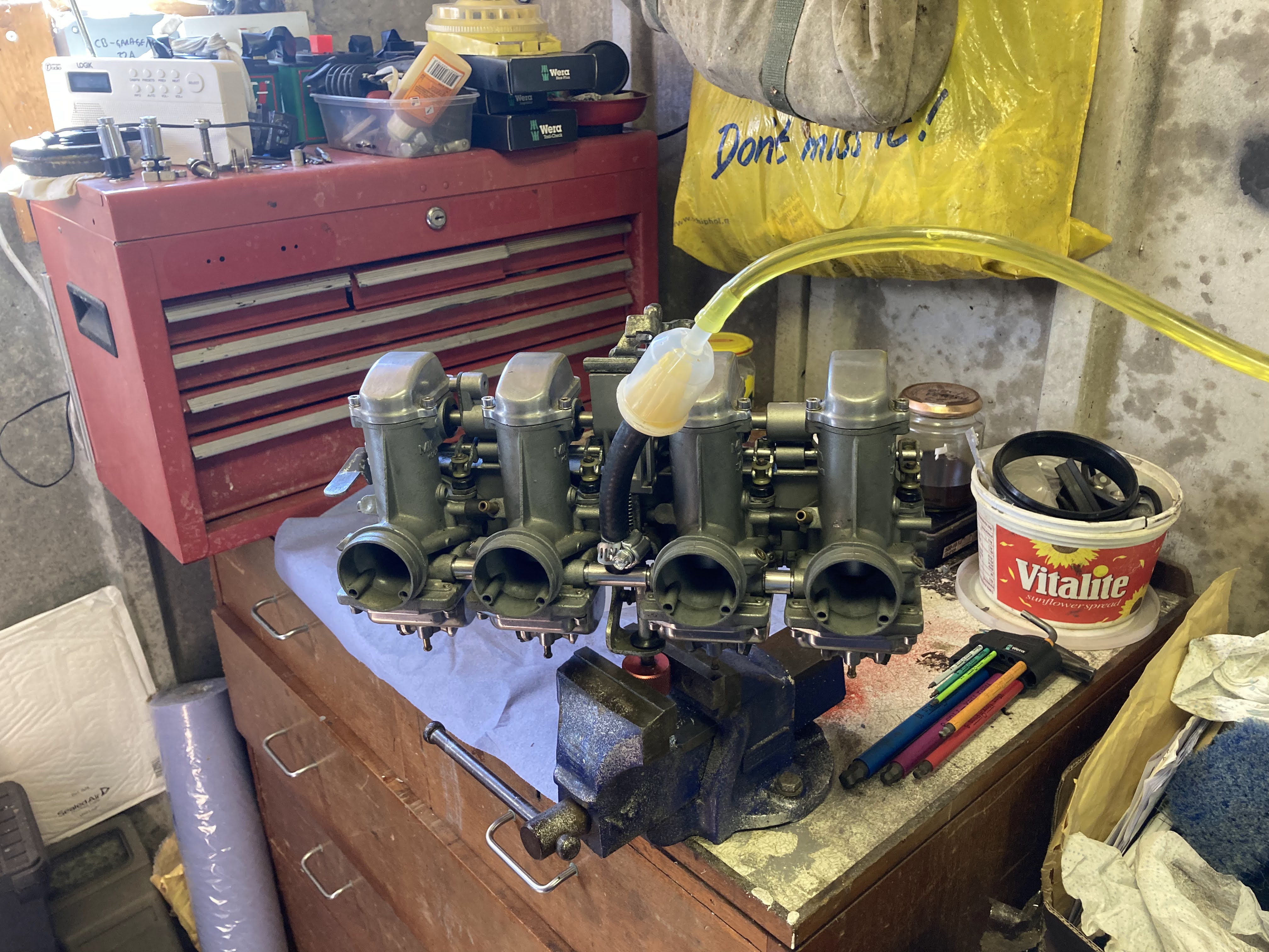

Hi Zed Heads,
Has anyone got a ratty old set of inlet rubbers going spare?
I'm going to build a jig to hold my bank of MKII carbs whilst off the bike for setting service fuel levels etc.

If you can't get hold of any Rubbers, have you thought of a small but of wood and a hole saw ?
I just grab mine (carefully) in a vice on the beefed up idle adjuster

I made a bracket up from an old fridge. Bolt it to the holes in the cable pulley block. then the other end of the bracket is clamped in the vice.That way you're not clamping the carbs at all, Keep it all together with the fuel levels tool.
