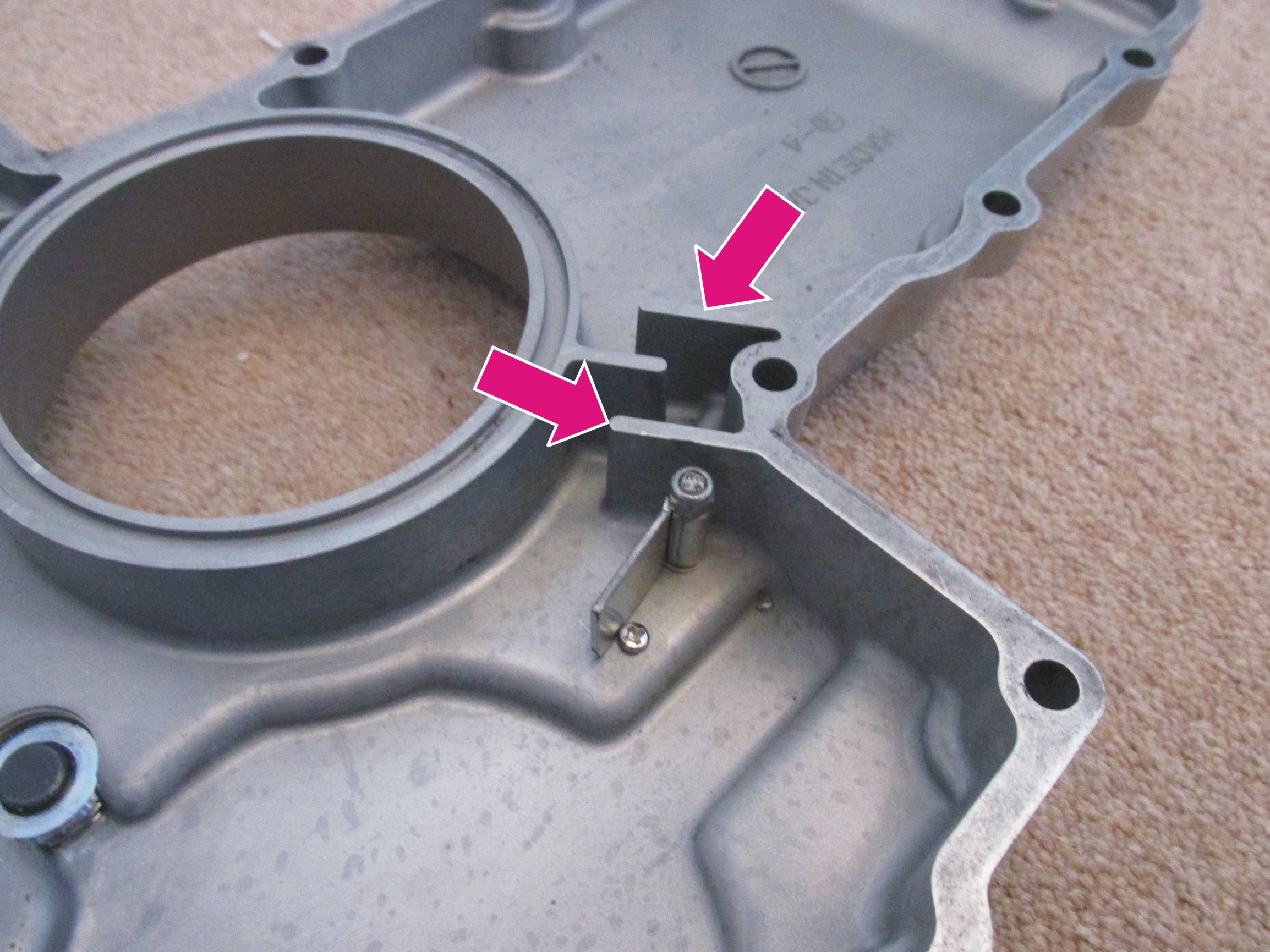

As the subject says, has anyone within the club got a Z1 sump plate preferably without oil gate.
Regards
Steve

Has yours got the oil waste gate in ? ....Ill swap you ?

Mine is a 73 Z1 item so should be no waste gate but the sump plug area has been damaged whilst trying to remove a tight plug I assume and the plug O ring won’t seal so it drips slightly.
Regards
Steve

Chris - I think what Steve is saying is that the early Z1 sumps had no 'fixed' baffles castings as standard (red arrows).

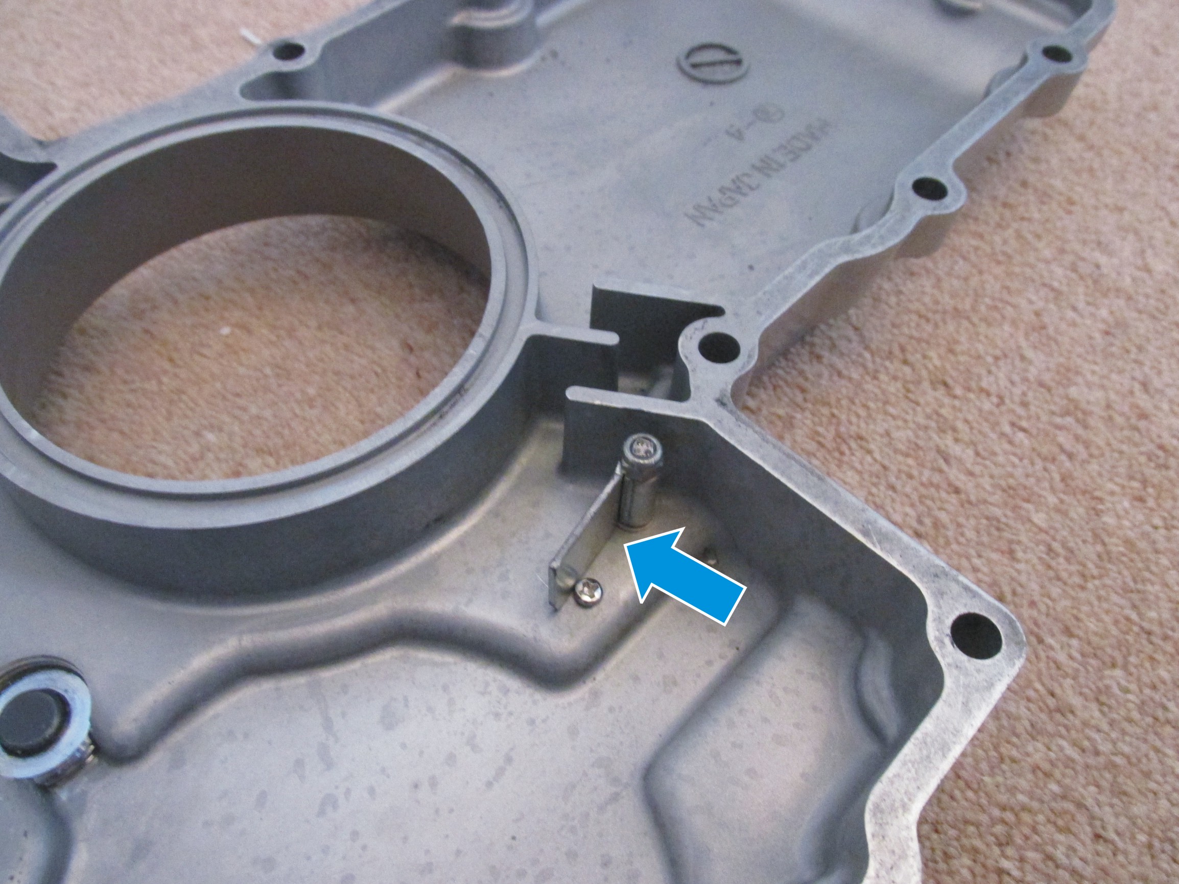

All you need to do is the swinging baffle gate mod (blue arrow).
