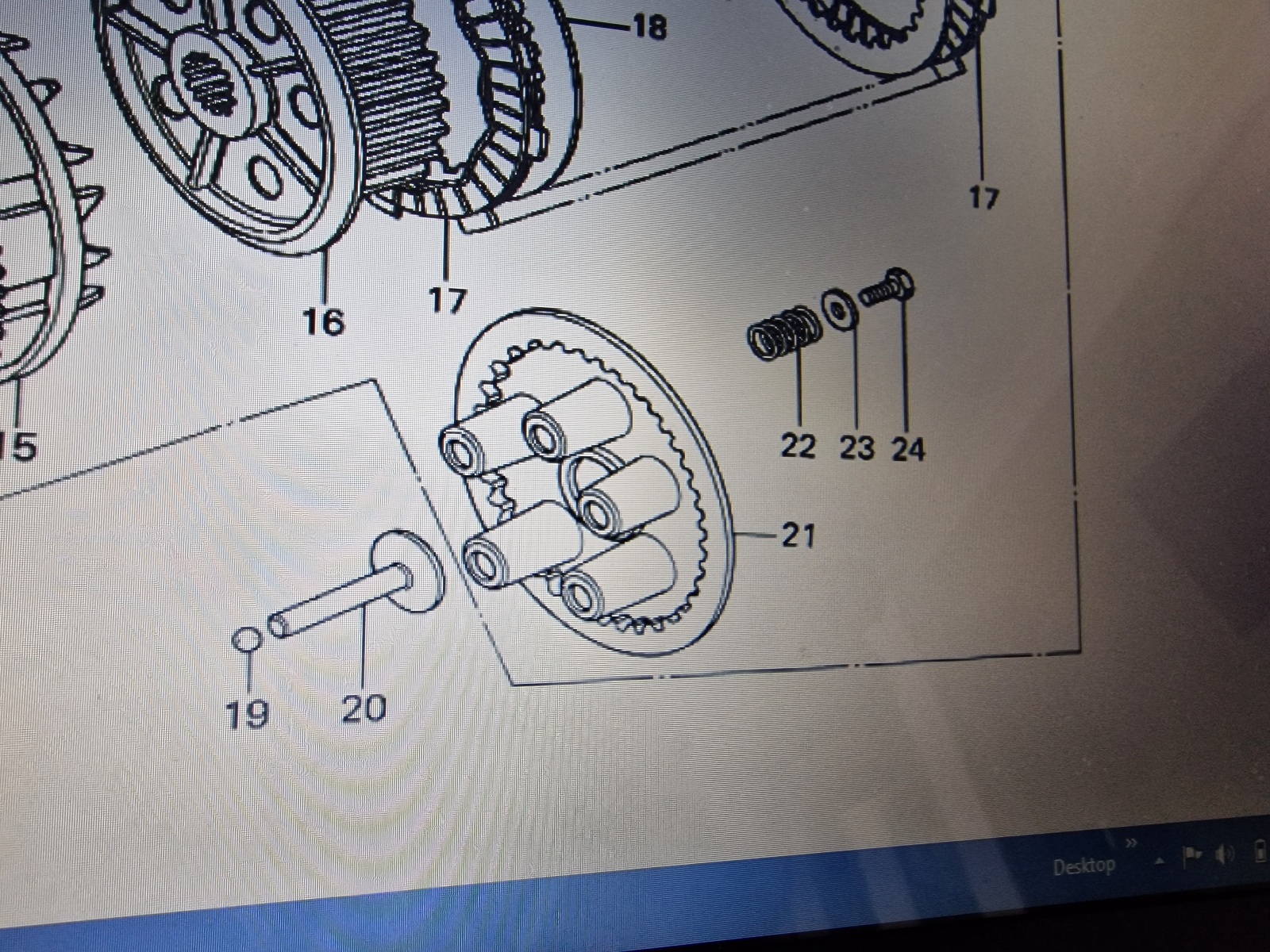

Afternoon Guys, more fun and games came to torque up clutch bolts on Z900 A4 before closing cover, found 1 loose, removed inner clutch turns out im glad i did, it had been bodged with a bolt as 1 of the 5 alloy posts snapped off. Argh!
anyone happen to be selling or have a spare its part no. 16 on diagram listed as 13087-031 PM

Got one now from Forum member, many thanks
