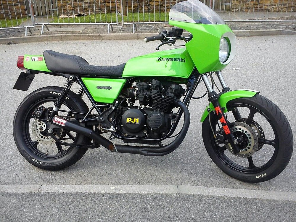

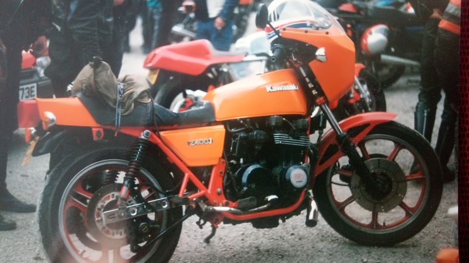

It might fit, maybe with mods. Might be the only way. looks like wheelbase would be extended a few cm. They have been done - here's a underbraced z550 one (maybe based on the zepher) and a z400 turbo

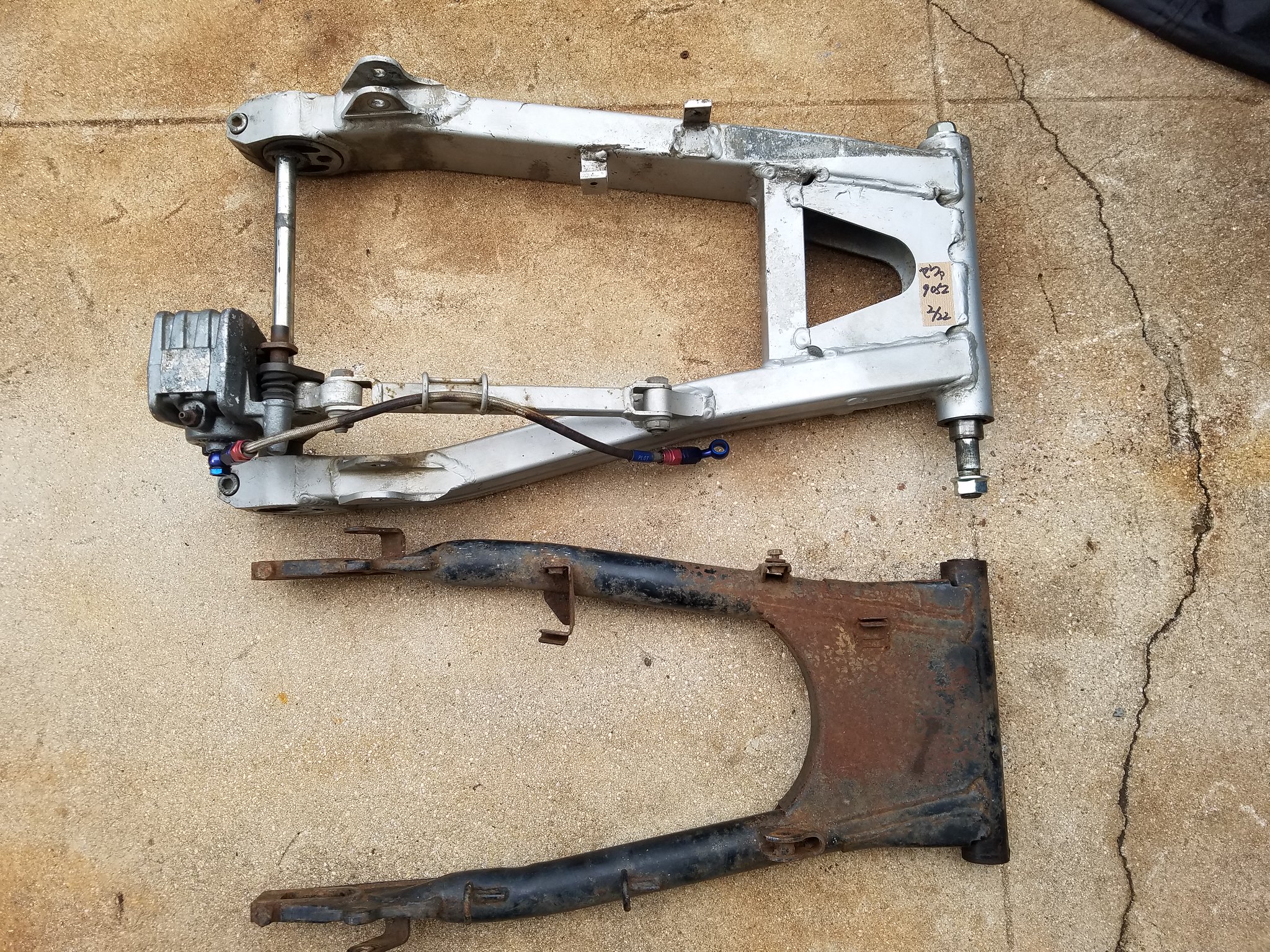

#9 PostAuthor: Z1streetfighter71 » Tue Nov 28, 2023 12:28 pm
I have one handy if you want to measure what you have vs the the the Zephyr width. Plus i know a lad that has a JMC braced swing arm for a Z650.

yes I presume that old swinging arm is a z500/550? so could measure each width and length. I could check against mine too?
Posts: 1034
Re: z500 Swinging arm
#11 PostAuthor: Z1streetfighter71 » Tue Nov 28, 2023 2:30 pm
olnmfc wrote:yes I presume that old swinging arm is a z500/550? so could measure each width and length. I could check against mine too?
Yea mate, measure what you have in width of axle pivot including any spacers. Length from both the wheel axle and the width between the swingarm arms and ill do the same for you if you want.

#13 PostAuthor: olnmfc » Wed Nov 29, 2023 2:59 pm
seems approx 23cm wide and 46 cm long to mid chain adjuster slot. Seen online that bigger Z Zepher swing arm swaps need bushes made to accommodate smaller spindle

olnmfc wrote:seems approx 23cm wide and 46 cm long to mid chain adjuster slot. Seen online that bigger Z Zepher swing arm swaps need bushes made to accommodate smaller spindle
Bushings are easy enough to have made up by someone local or even someone on here, the width of the swingarm is more important so it fits the frame with enough room for spacers. Ill throw a measurement on it tomorrow to be certain of numbers. If its alloy and light and not braced then the Gs1100E is a go to for a lot of lads but hard to find and a wee bit pricey these days.
