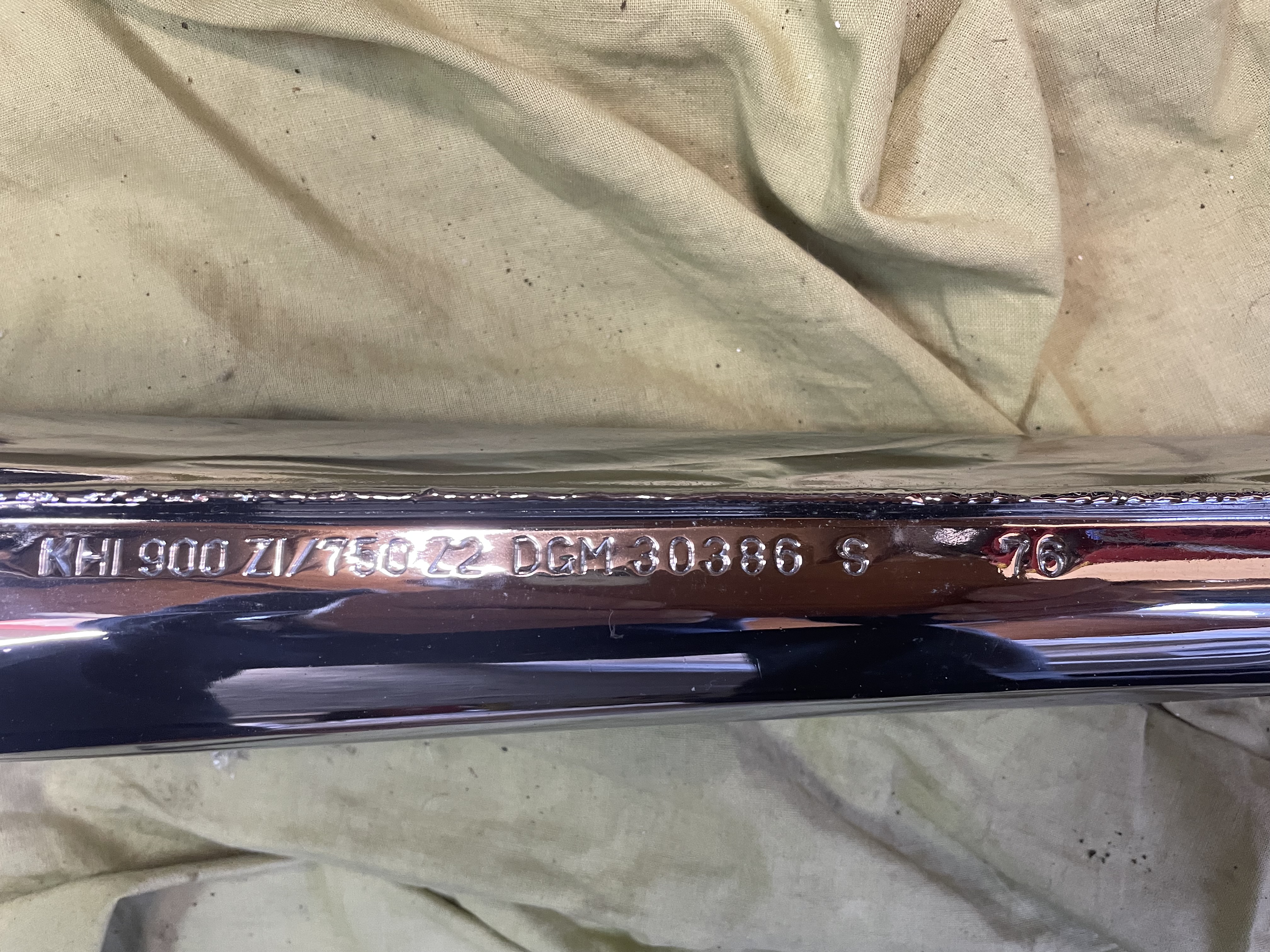

Markings on my pipes[attachment=0]IMG_0503.jpeg[/attachment]

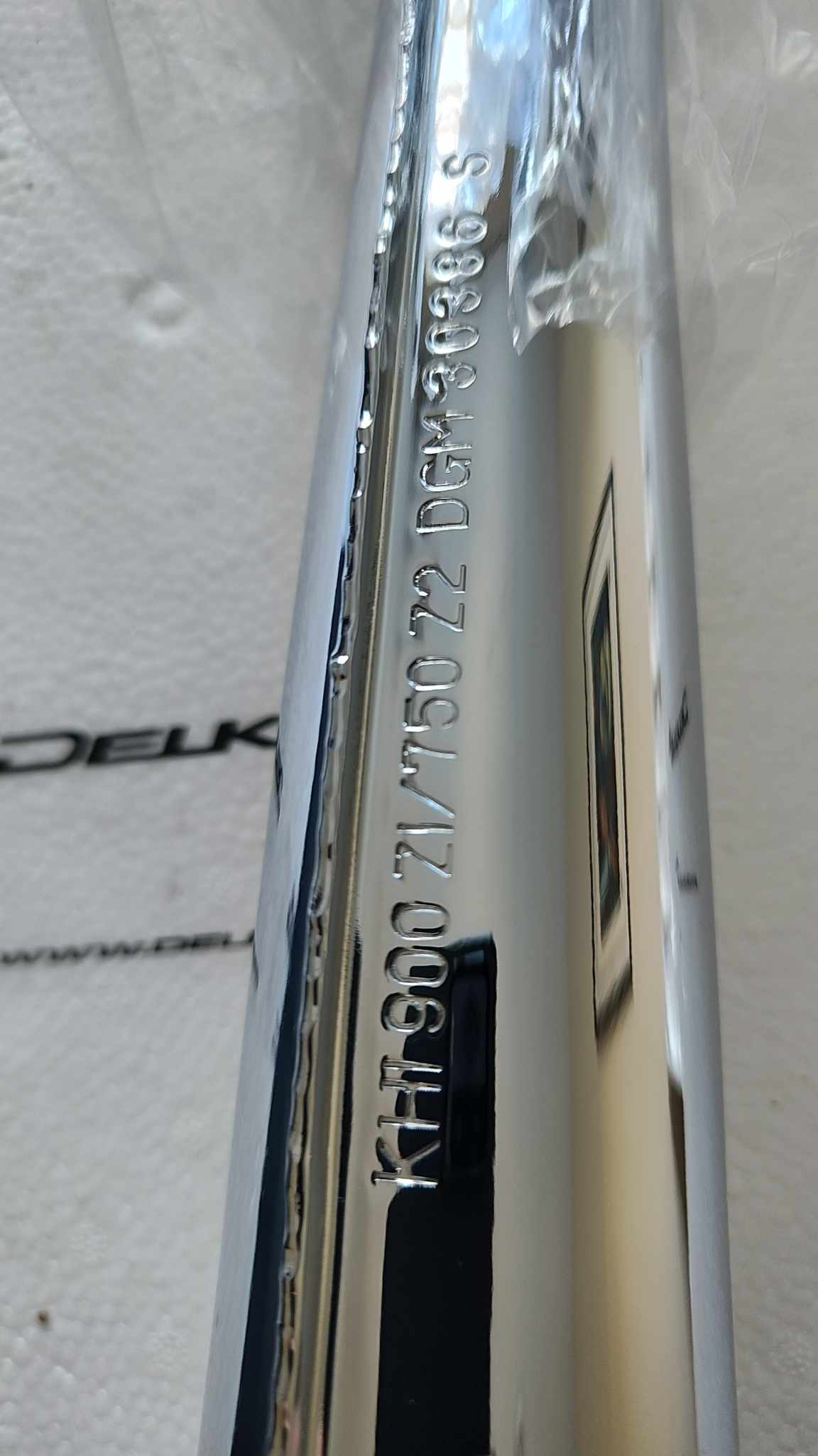

I've owned, bought and sold many sets of NOS OEM 4/4s and sadly, looking at your photo, I'd say your pipes are Delkevic repros not OEM:
The stampings on OEM are more defined, in a slimmer font and not as deep. Delkevic stampings a deeper, thicker and look a bit clumsy.
Also, the chrome lusture is deeper and smoother on the Delkevic pipes.

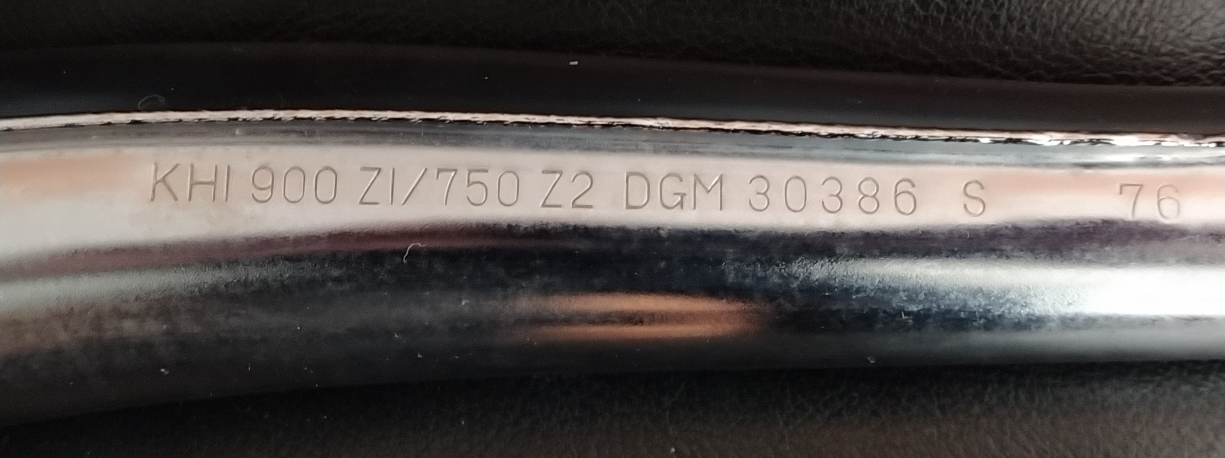

Delkevic repros.
Yours
OEM
