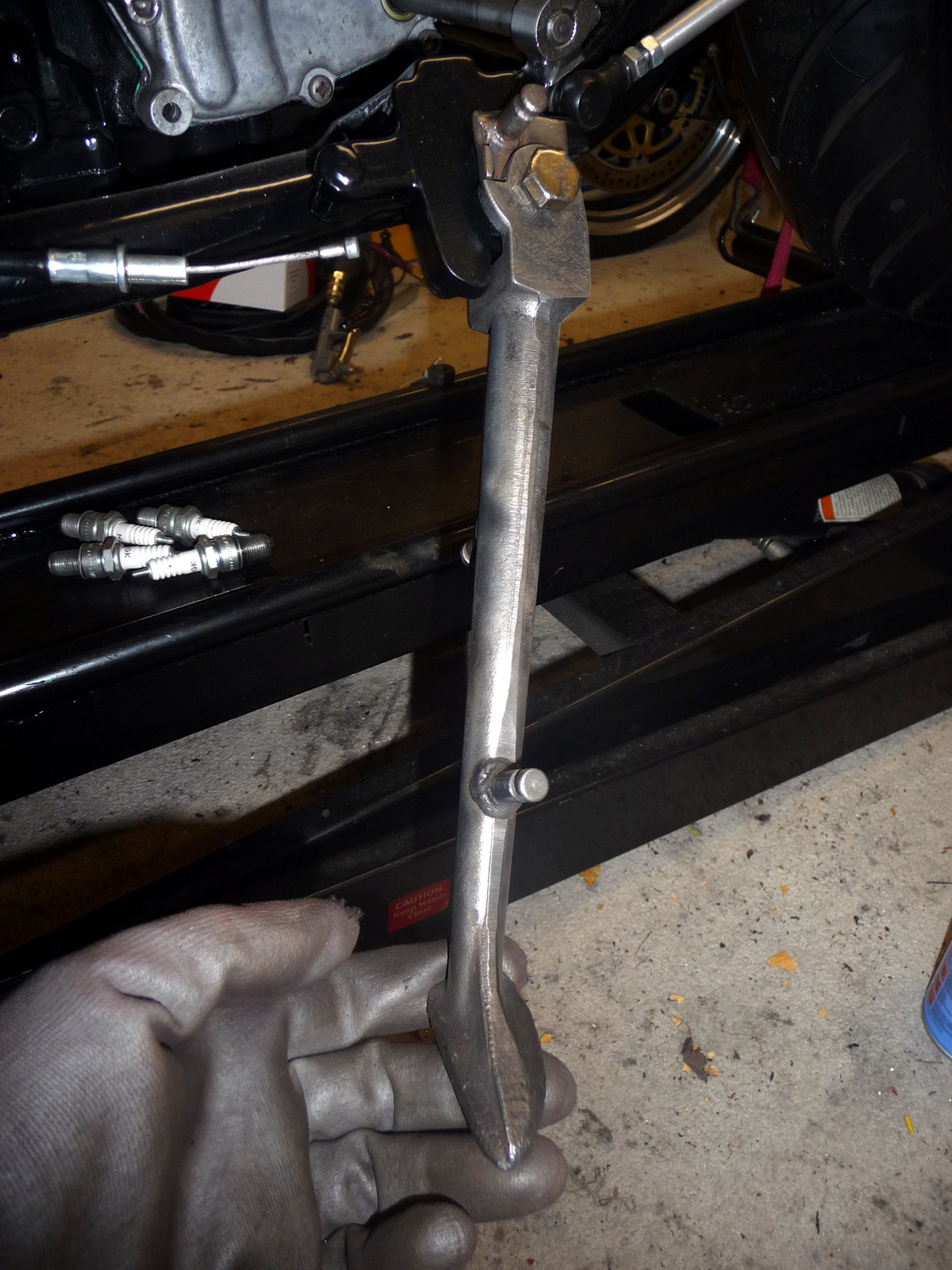

Glav send me a picture of your side stand - mine doesn’t have that part at all.

On mine the top spring attachment is welded to the frame

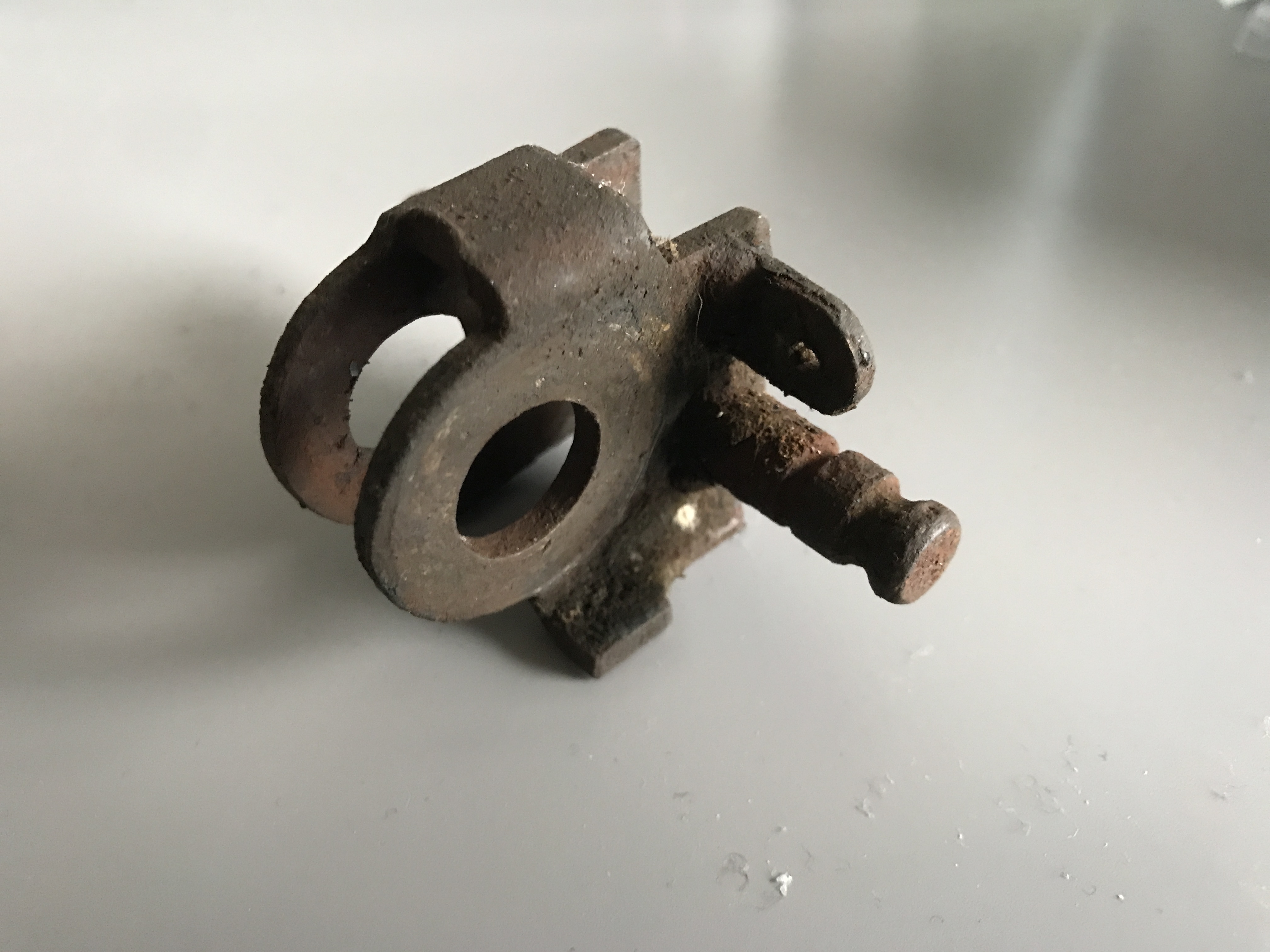

I've a used one from a Z400J, it has a different part number, although the part numbers sometimes change.
Anyway, if you want to try to see if it fits, get in touch, we're both in Belfast

Mine looks like this spring actor is welded to frame. It’s an R2 as well so there must be two types as Will says

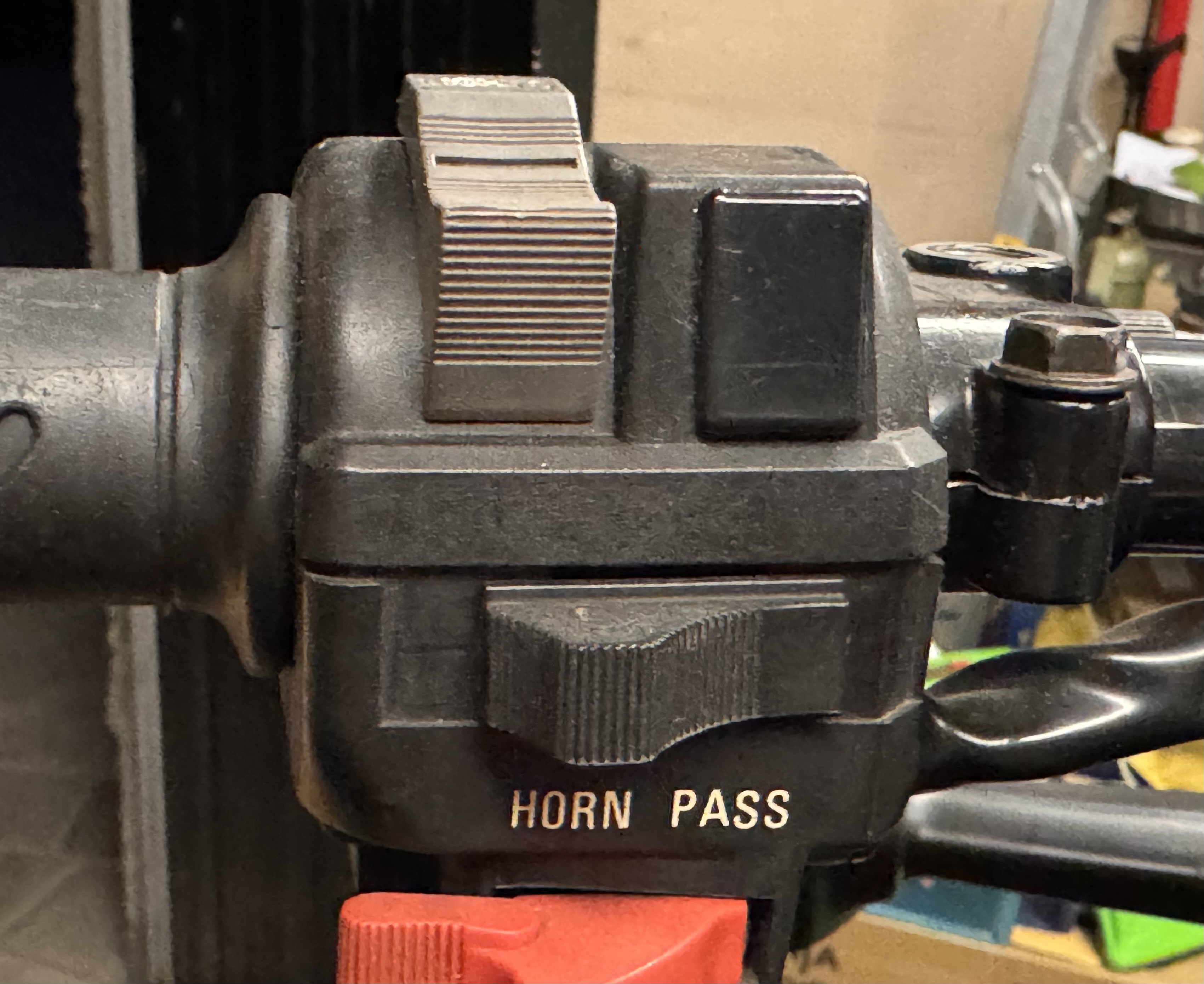

Have you guys got this side stand override kill switch on your bikes? Red one next to the hi lo

Just a plastic plug...

And just to throw a curve ball, this is a mates R1 that I did the paint for but zoomed in on the LH switchgear and his does have the over ride switch.

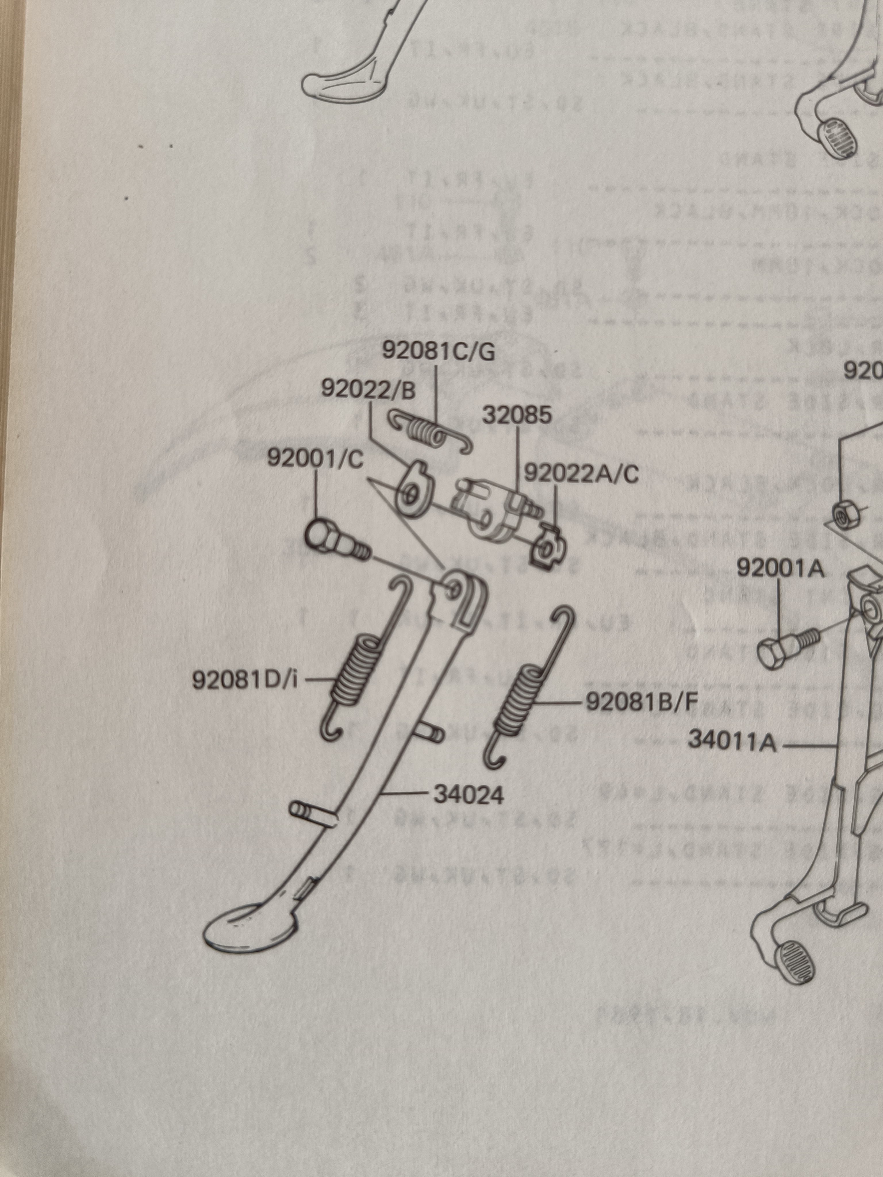

My B2 has the same set up with the overide switch and stopper. In addition there's a bolt locking washer under the stand bolt head. This is an original item ( 92022A/C ) shown incorrectly in the parts manual as being behind the stand.

Kwackman, I'll DM you. That looks like the part I need. I think I sourced one on Ebay of a shaft drive. We4'll see when it gets here.

The technology is strange - if the bike is not on the stand, the engine should be turned off. That was very disruptive. You can also see it if you look at the left handlebar switch. There is a small red button that should bypass the kill switch. But that rarely worked even in the 80s. This side stand also has two springs, while the other versions always only have one spring.
