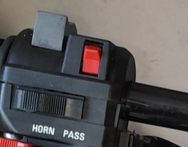

Have you guys got this side stand override kill switch on your bikes? Red one next to the hi lo
Re: Z1000R2 side stand stopper
Posted: Mon Apr 01, 2024 7:57 pm
Author: chrisNI
Just a plastic plug...
Posted: Mon Apr 01, 2024 9:11 pm
Author: warren3200gt
Ah OK, my J2 side stand uses the same mount bracket along with a seperate sprung loaded plate to operate the stand kill switch.
It's quite a clever set up.
The bike will start on side stand but unless the override switch is depressed as you lift the bike upright the stand will spring back about 15 deg and kill the ignition. The stand needs to be fully up before you can restart it. Two springs on the stand itself. A further small spring that fits onto a seperate plate which is fixed by the stand bolt with the other end of the spring connected to a multi position brake light style switch.
And just to throw a curve ball, this is a mates R1 that I did the paint for but zoomed in on the LH switchgear and his does have the over ride switch.

Author: paul doran
My 1100R has the blank of plate on the switch but My 1000R has the litte switch and its a UK bike
