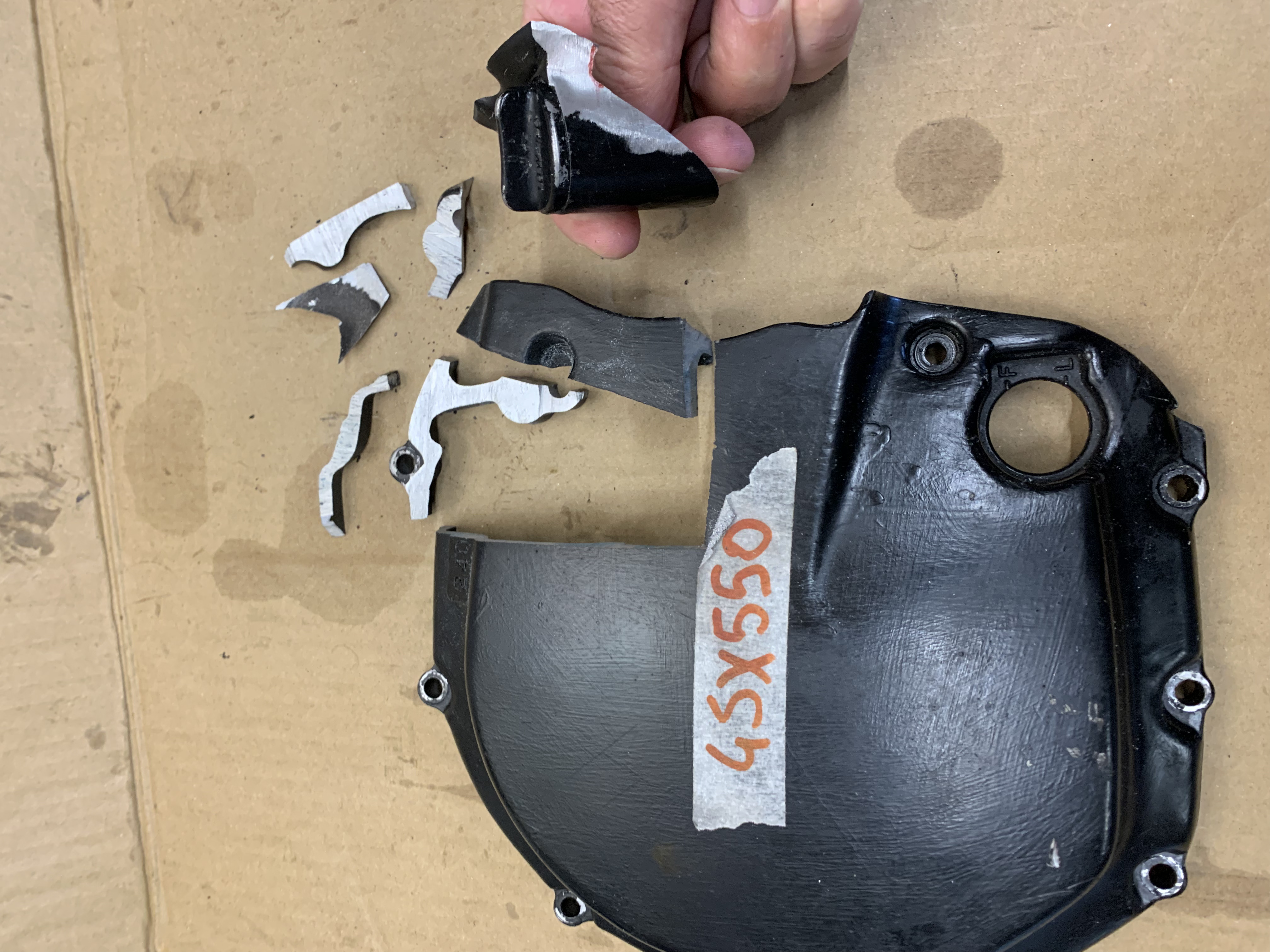

I knew I needed one too for my special project I'm working on so I looked on ebay for other clutch covers with a filler neck that sticks out a bit. GSX550 seemed to fit the bill so I bought it complete with cap ( cheap as it was scuffed and cracked at 1 bolt hole) and I hacksawed out the filler neck and I know a someone who does quality aluminium welding so they can then stick it where I want it . Cost was about £15 for the cover and cap.

see photo
