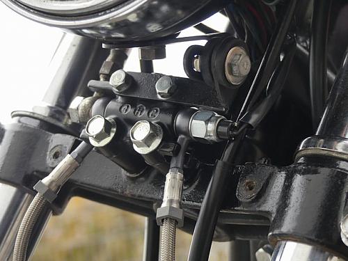

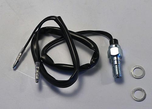

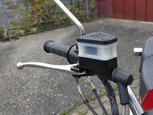

I have three Z1000ST. The grey one is of 1981.
Front master clyinders are like hen teeth. I found no new ones over the past 10 year.
As a substitue on the read one I bought a replica one with the plastic reservoir of a Z1000A2.
Since this one has no brake light switch I got a hydraulic switch fitted in a brake line screw.
This was fitted underneath the "Kawasaki" cover under the head light.
It works well and looks some kind of old school.
