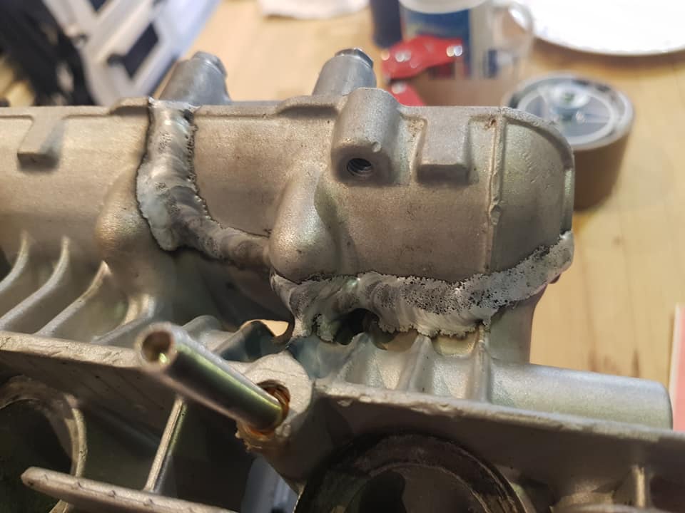

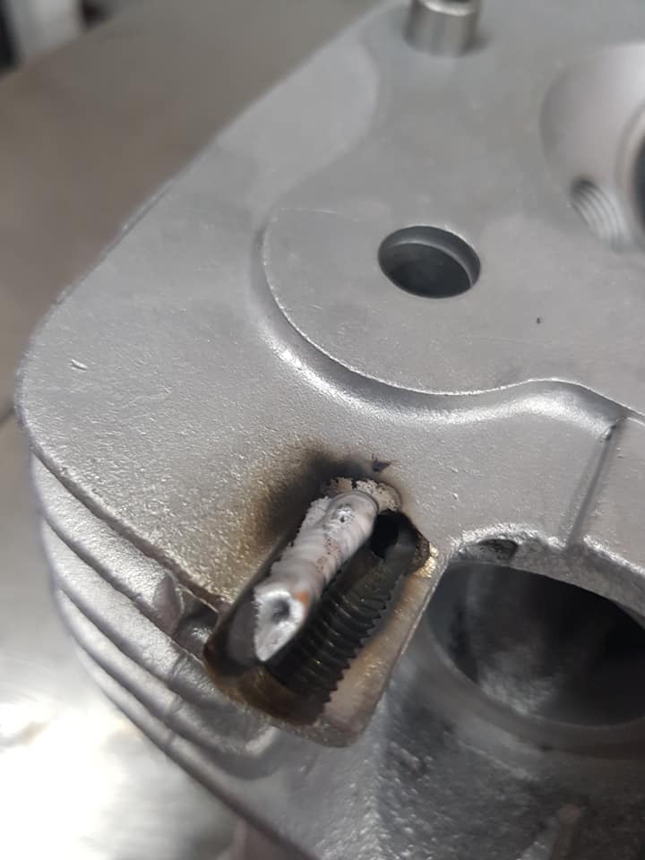

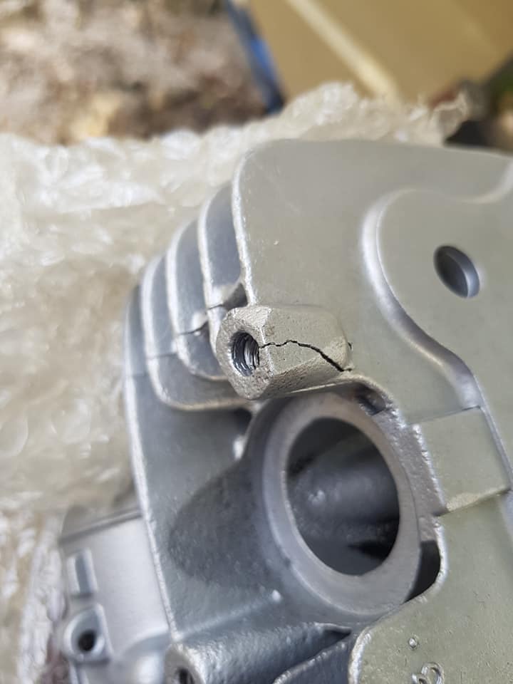

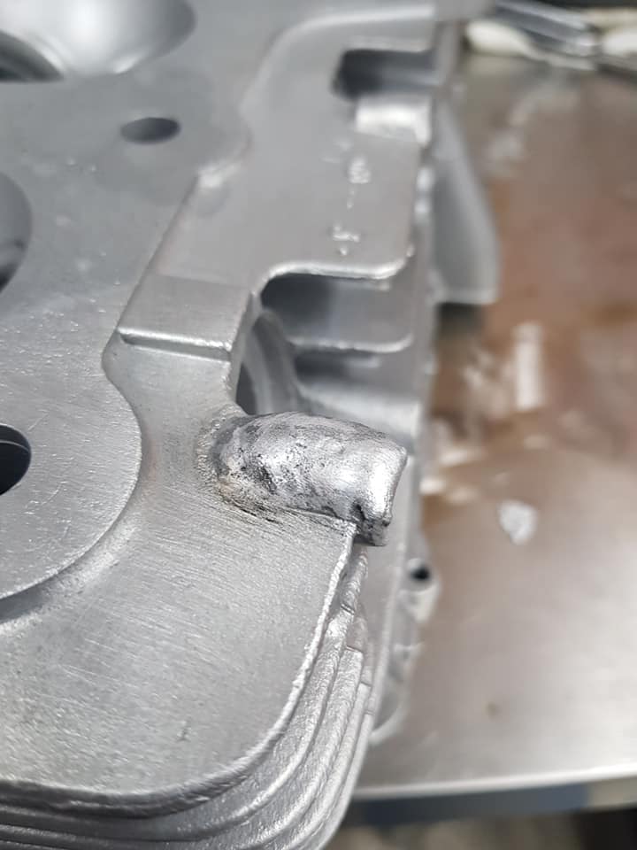

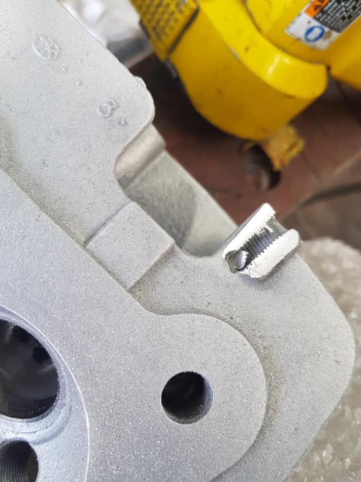

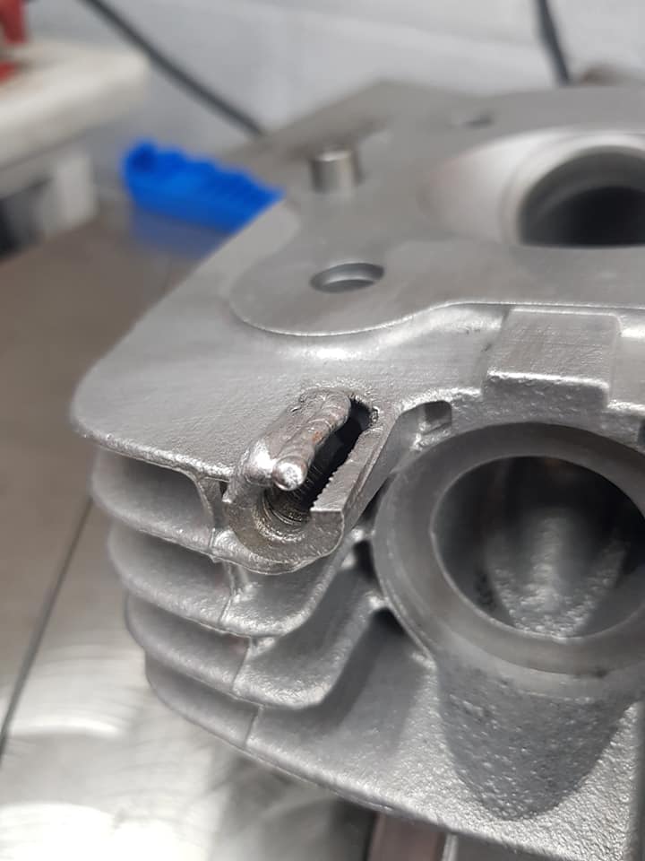

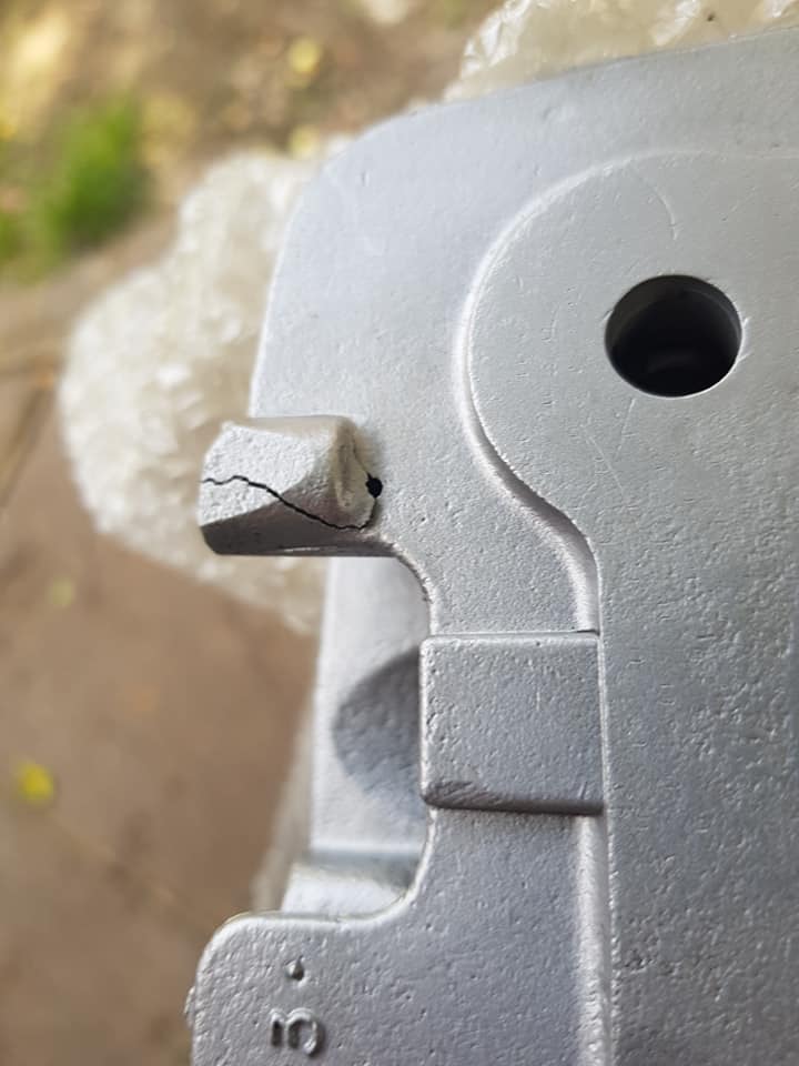

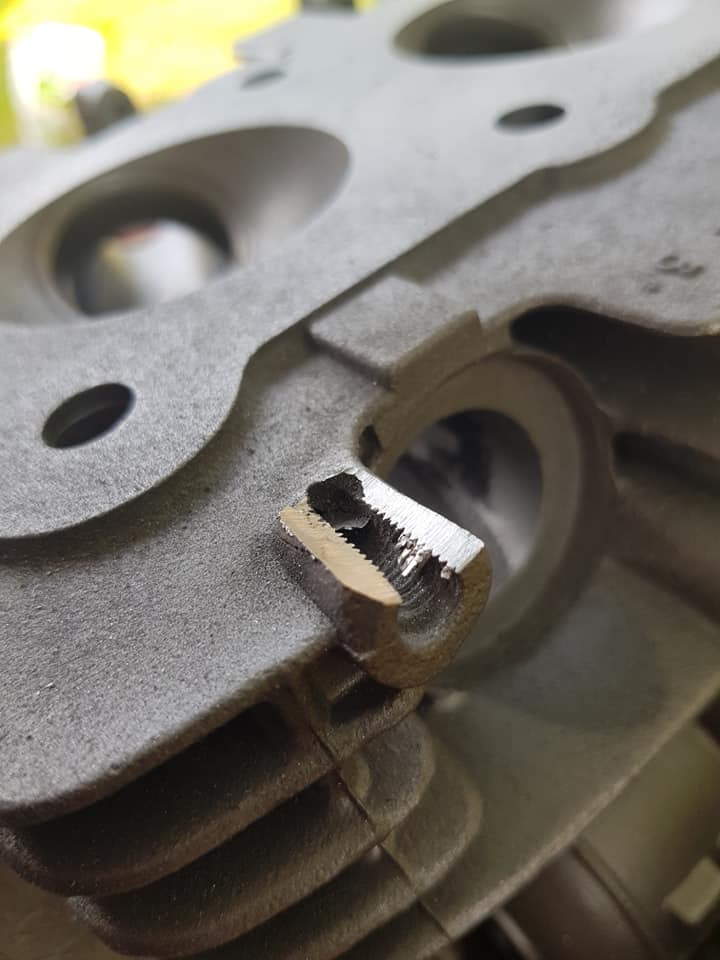

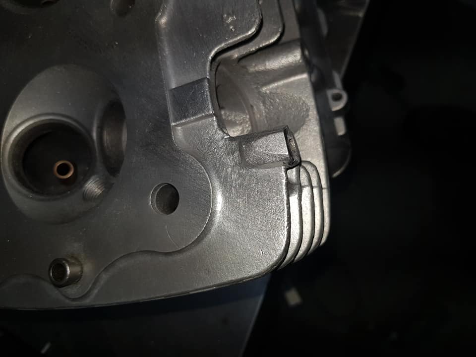

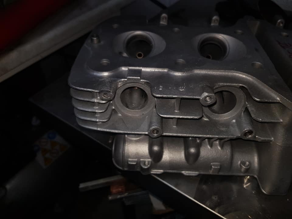

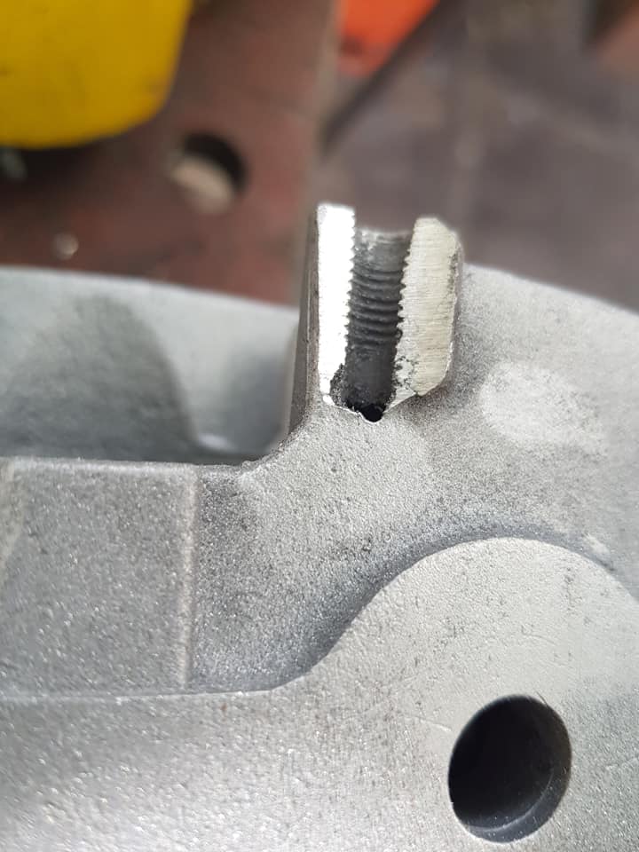

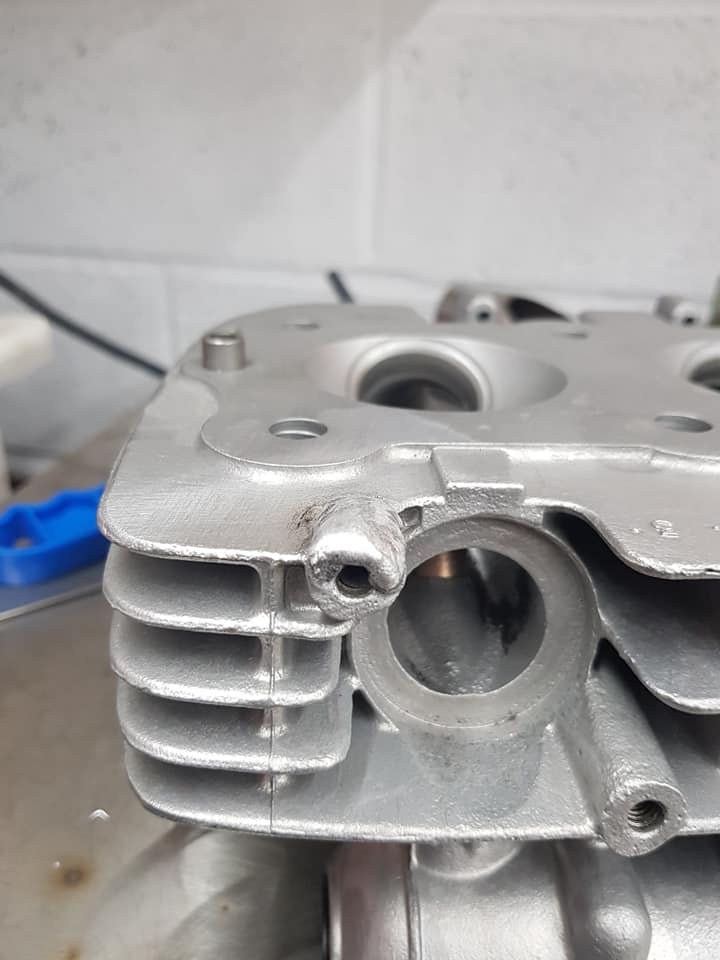

chrisNI wrote:I’m not sure there is much magnesium in the R2 wheels any more than any other alloy wheel :shock: a picture of the chunk out might help if it’s not too bad a good alloy welder should be able to tackle it
No more than in a cylinder head...
head weld2.jpg (41.22 KiB) Viewed 4652 times
head weld3.jpg (50.13 KiB) Viewed 4652 times
head weld4.jpg (75.33 KiB) Viewed 4652 times
head weld5.jpg (49.46 KiB) Viewed 4652 times
head weld6.jpg (63.42 KiB) Viewed 4652 times
head weld7.jpg (42.9 KiB) Viewed 4652 times
head weld8.jpg (44.11 KiB) Viewed 4652 times
head weld9.jpg (44.92 KiB) Viewed 4652 times
head weld10.jpg (46.42 KiB) Viewed 4652 times
Cheers,
Mark.

cont...
head weld11.jpg (34.53 KiB) Viewed 4654 times
head weld12.jpg (38.9 KiB) Viewed 4654 times
Different one -
head weld.jpg (53.87 KiB) Viewed 4654 times

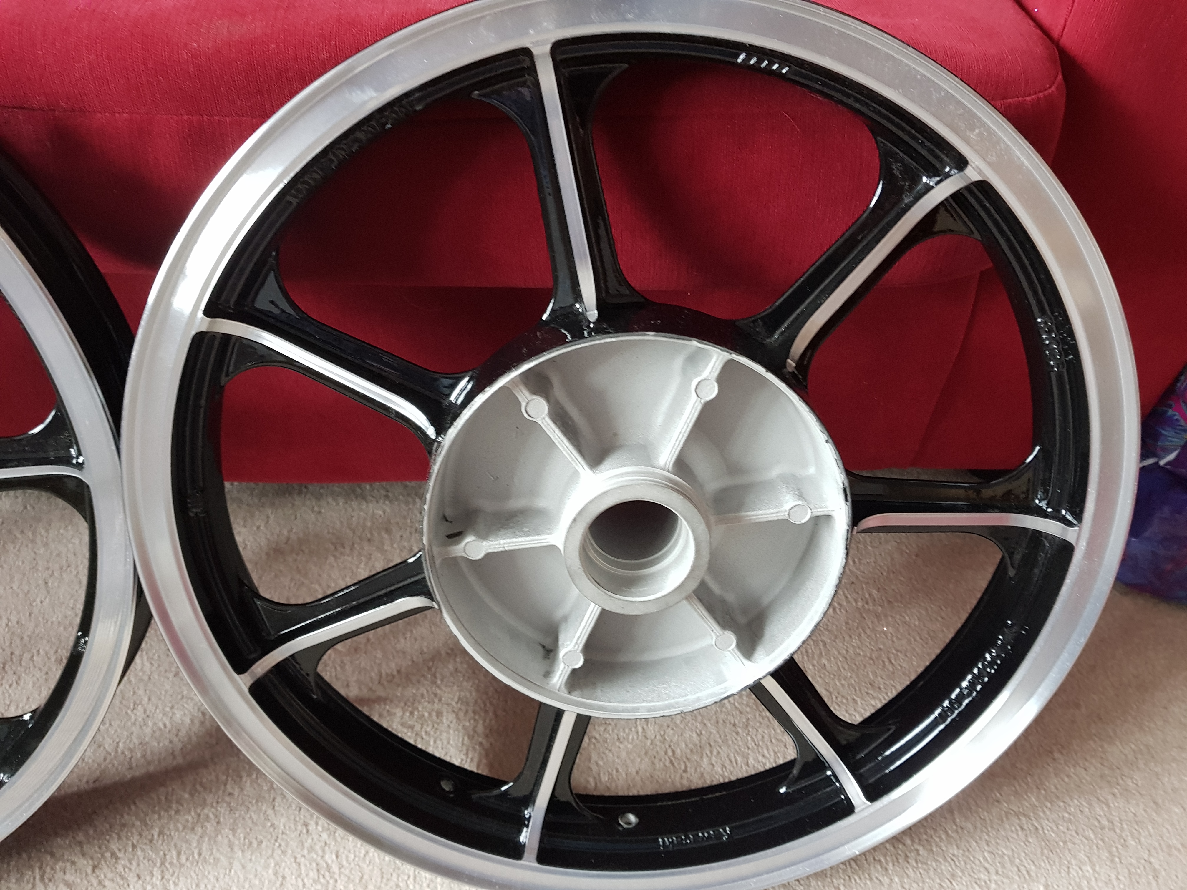

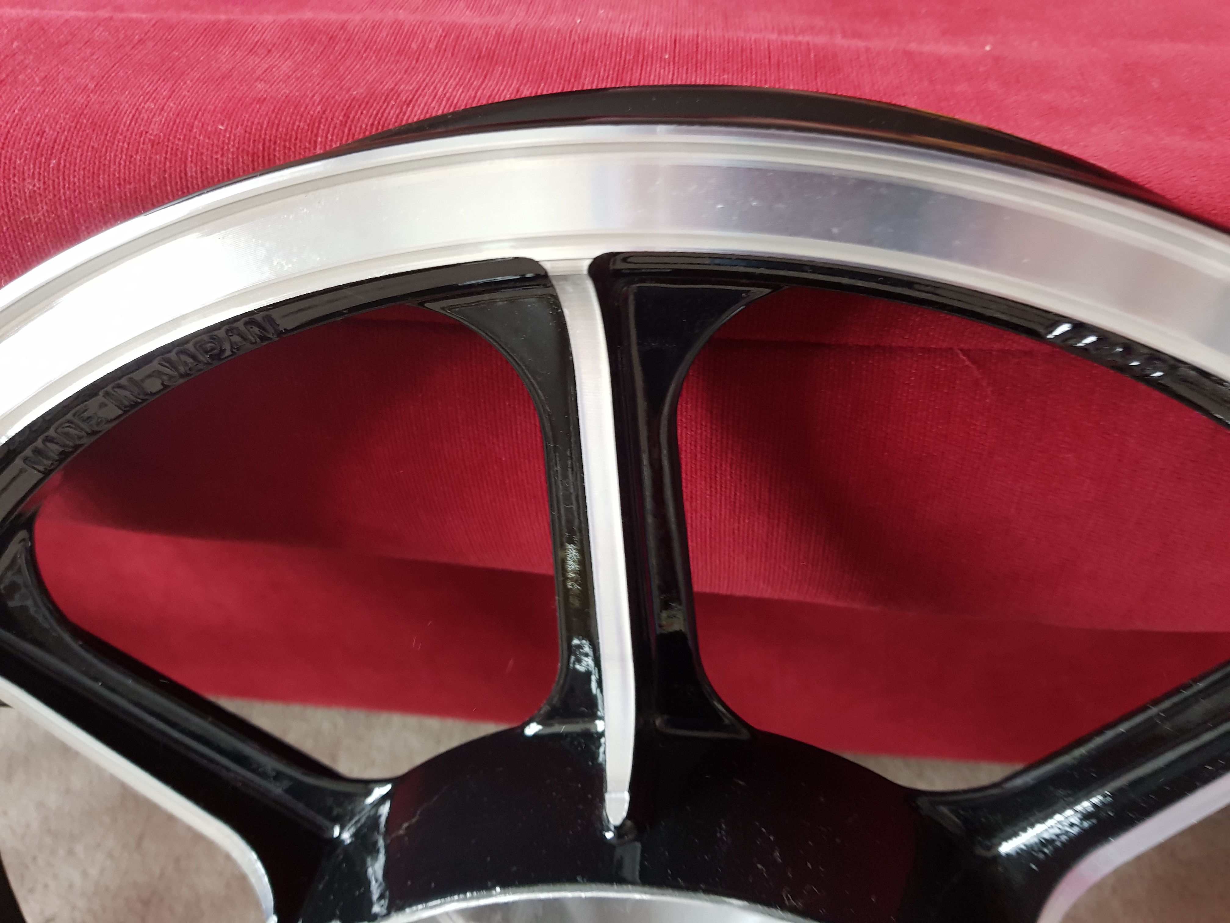

#6 PostAuthor: needaz1100r » Sun Nov 01, 2020 8:38 pm

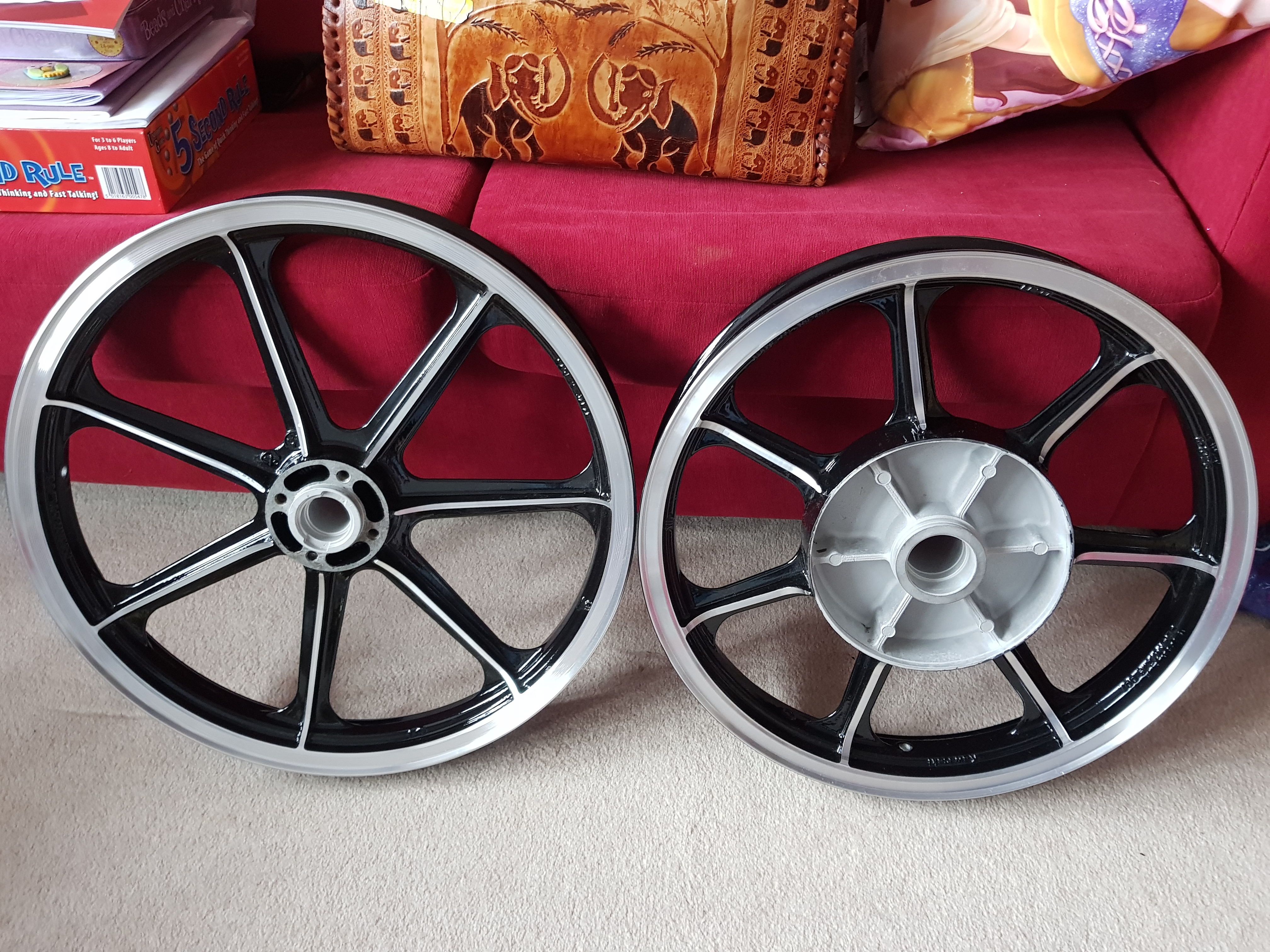

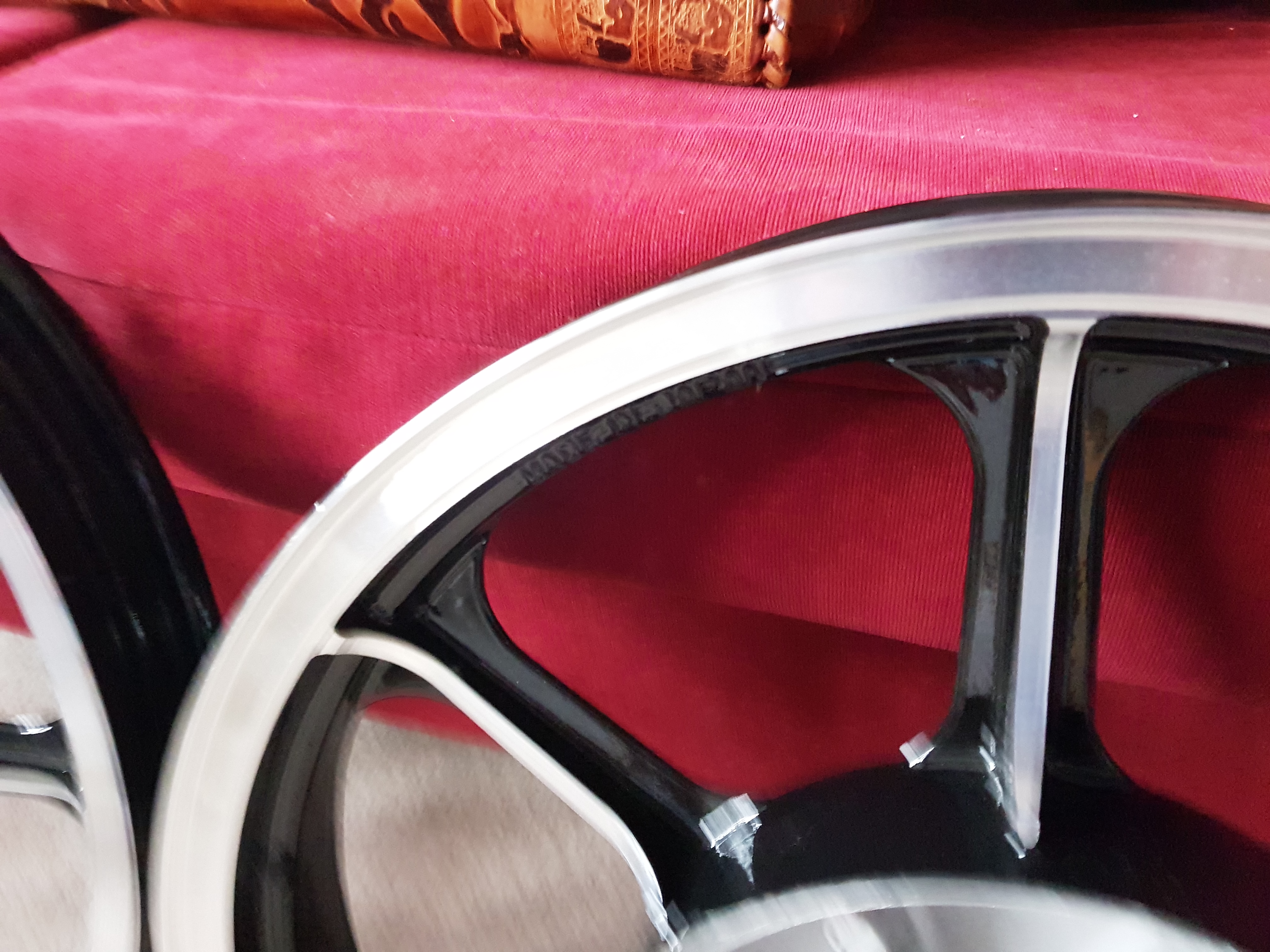

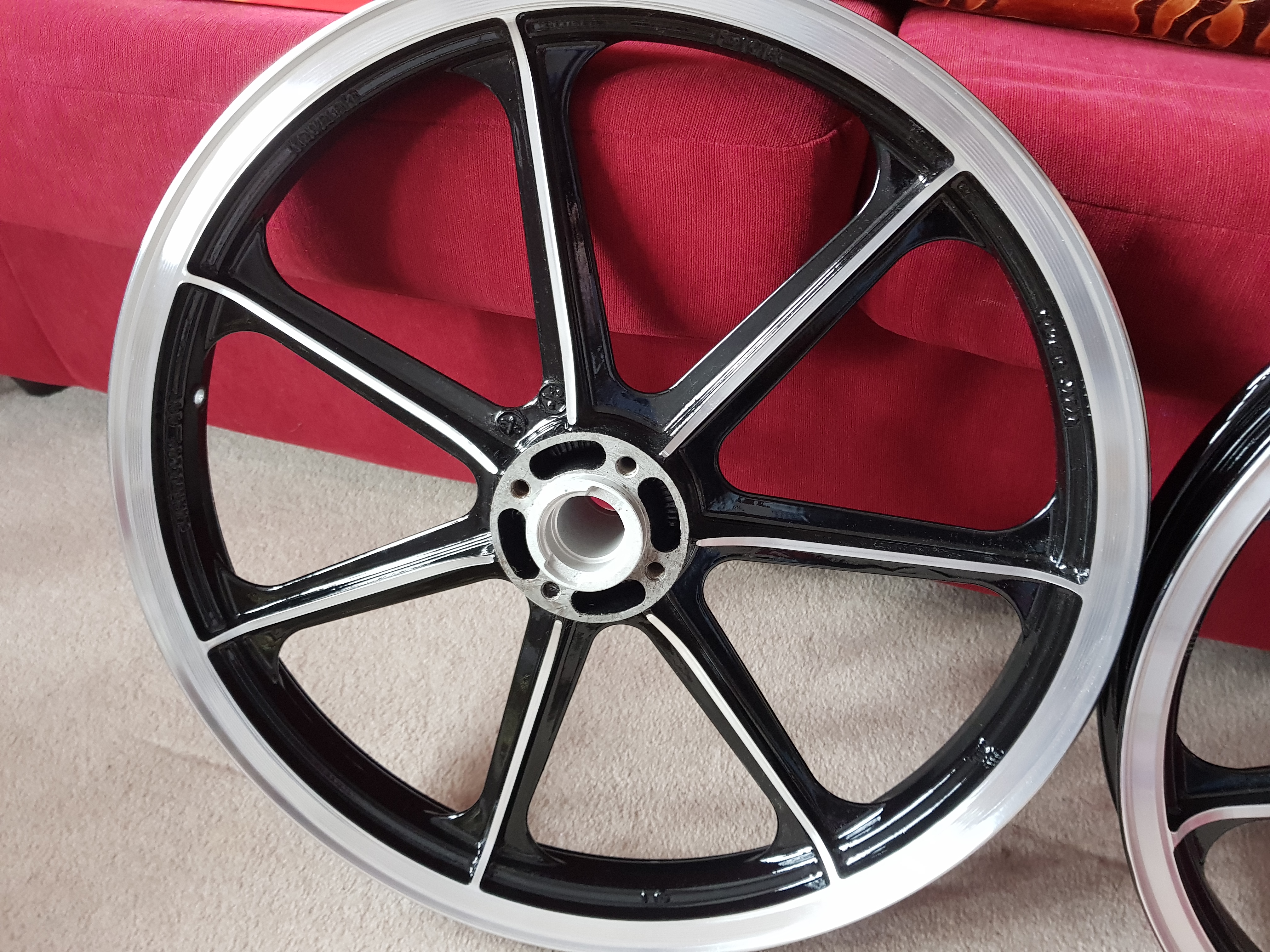

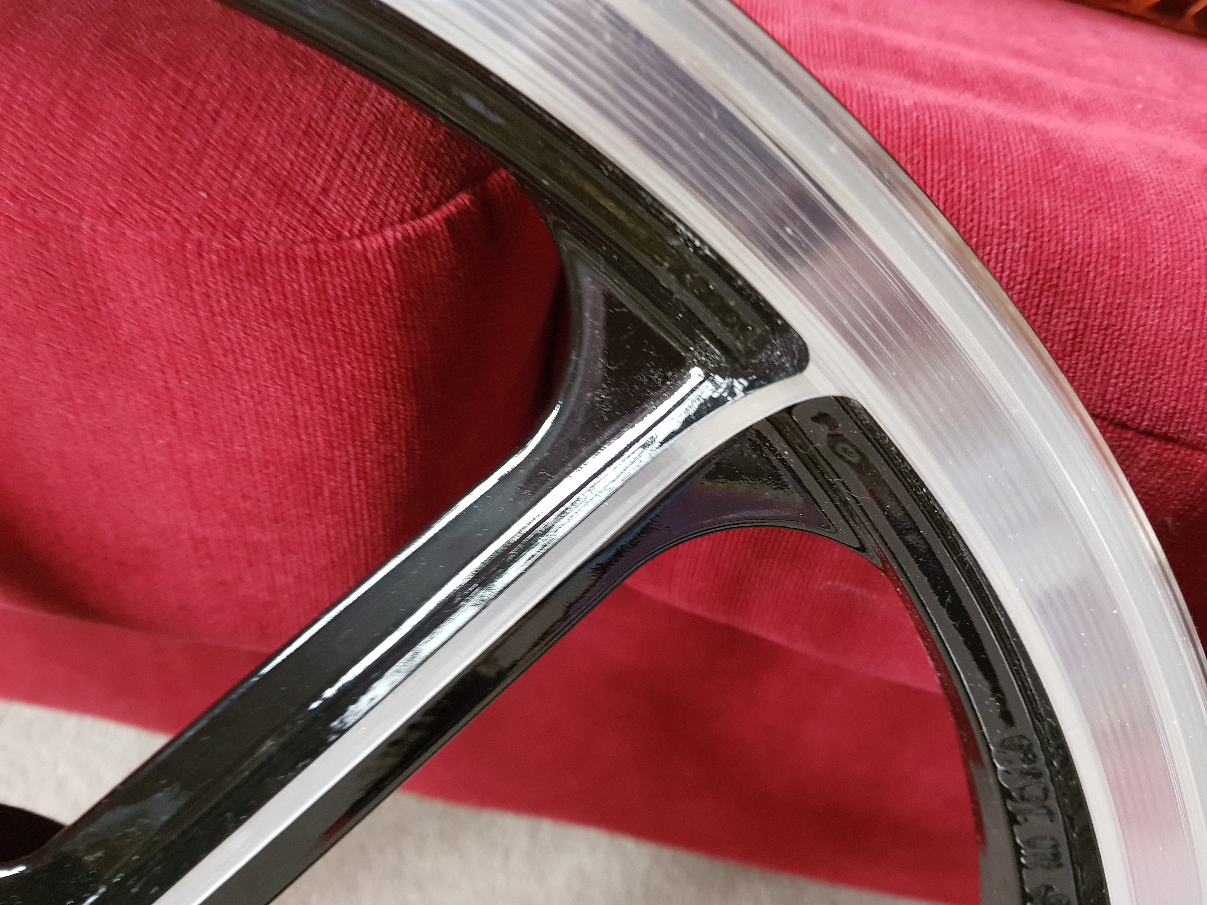

Powder coating and diamond cutting...

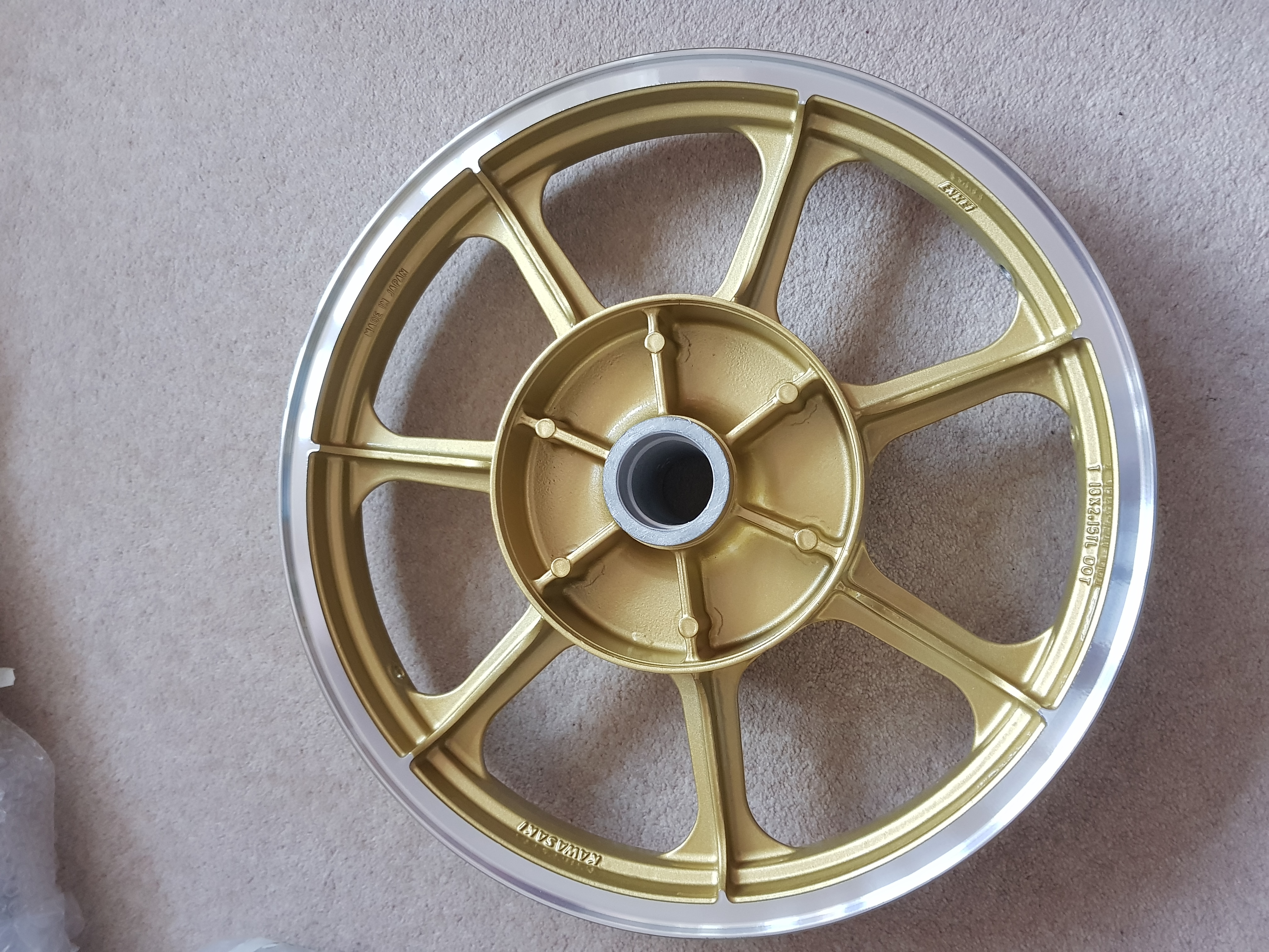

I don't think the original wheels were anodised, I think they were painted then diamond cut, this is as close as I could get to Z1100R wheels gold...

Skid Mark
Posts: 471
Joined: 23rd Oct 2020
Location: Kilkenny, Ireland
Re: Alloy wheel refurb
#7 PostAuthor: Skid Mark » Sun Nov 01, 2020 9:18 pm
Thanks for the advice and link Al and Chris, I will post pics when I get back with camera, posting picture from my phone is painful.
Mark, if I could get the wheels looking like that I would be ecstatic! :D

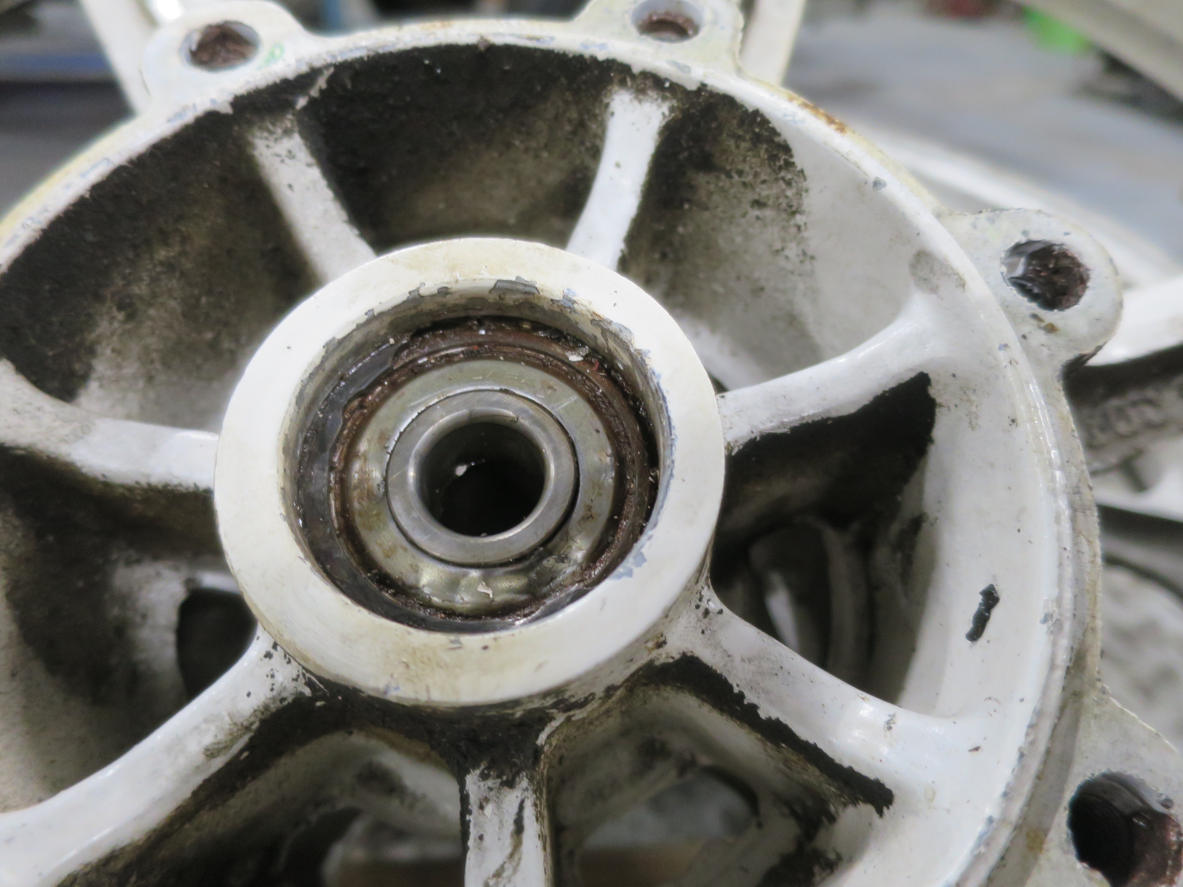

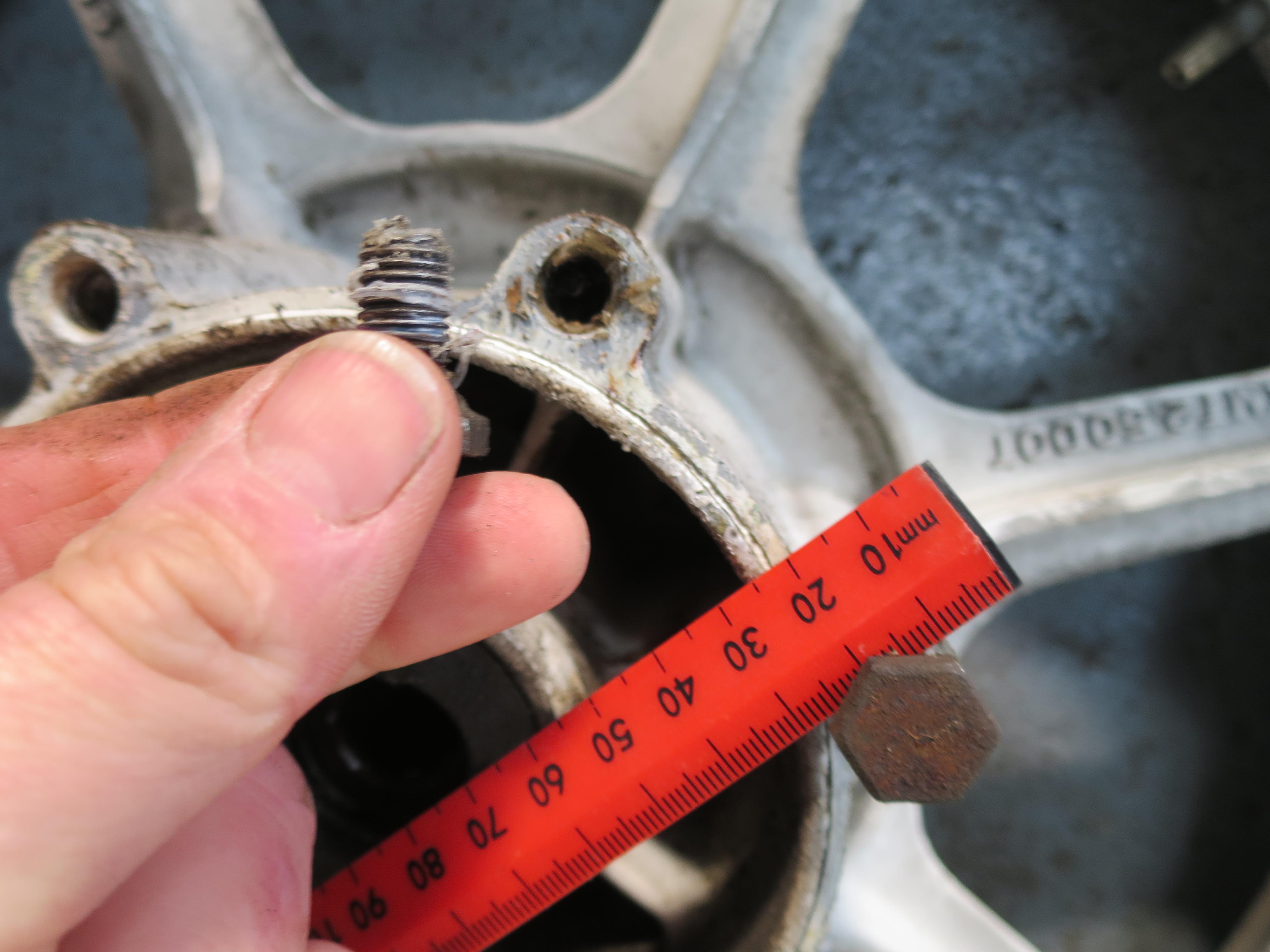

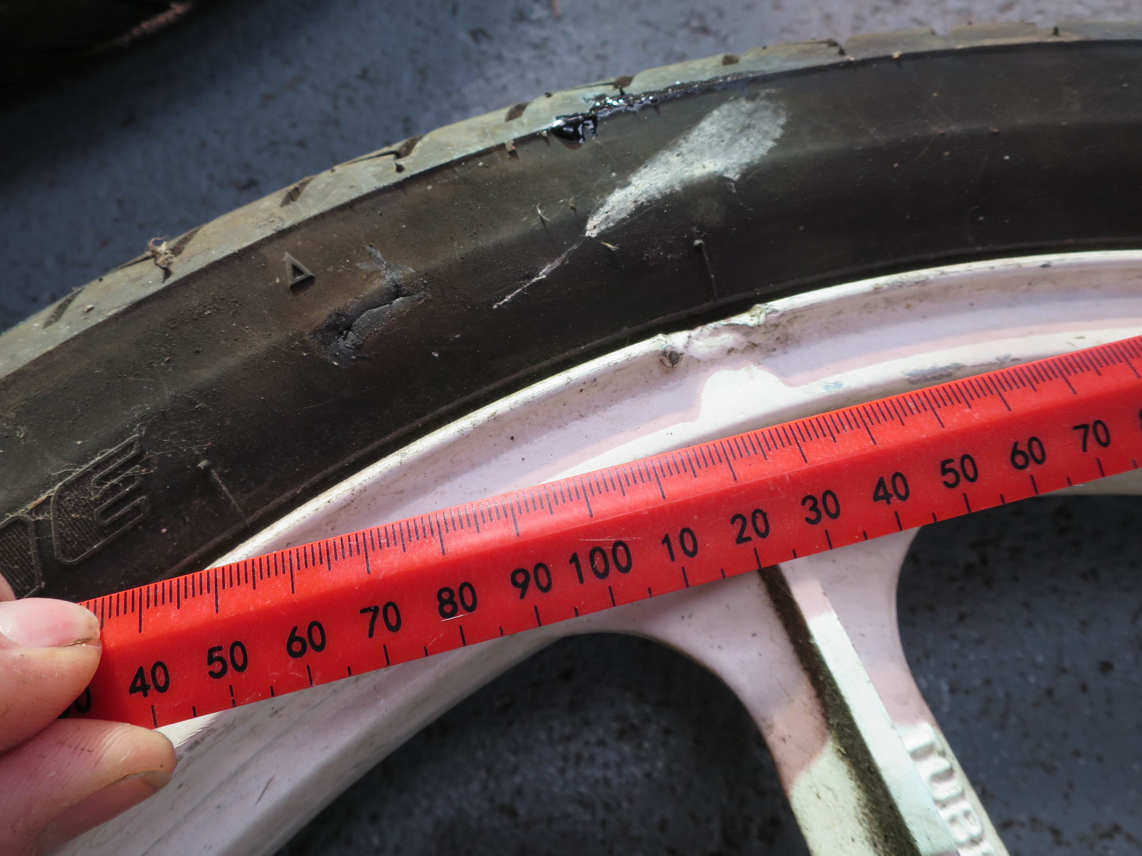

#9 PostAuthor: Skid Mark » Wed Nov 04, 2020 8:05 pm
Hi again lads,
Some pictures of the wheels. I have a broken circlip to remove and a botched retap to repair, then when the piggy bang allows I'll be sending the rims to Mark.
In the mean time any suggestions for stripping paint?
Mechanical or chemical?
I'm sure Mark can strip them, but I am itching to see what they are like underneath.
P
Posts: 3834
#10 PostAuthor: chrisNI » Wed Nov 04, 2020 11:02 pm
That chunk looks fixable. Blasting is probably easiest way to get paint off, soda if you want to get the edges polished.
#11 PostAuthor: Philippe » Thu Nov 05, 2020 4:08 am
Hi Skid Mark
I fear that the front wheel hit something and isn't straight anymore. Or did the chunk broke off when changing the tyre?
Wouldn't it be easier and cheaper to replace it with another wheel? They're not that hard to find after all. Or am I wrong?
You want to repaint them and the paint has to come off. Removing white paint or black paint is the same work...

Philippe wrote:Hi Skid Mark
I too wouldnt want that fixed. It needs to be x rayed to ensure there are no unseen cracks from the impact. Much cheaper and simpler to source another un damaged one to re finish.
zapo
Posts: 443
Joined: 28th Oct 2007
Location: near Derby
#14 PostAuthor: zapo » Thu Nov 05, 2020 9:46 am
+1 ...... that tyre damage to to left of the wheel damage suggests that the tyre has been "pinched" with the tyre then turning on the rim. That would be quite some force.
