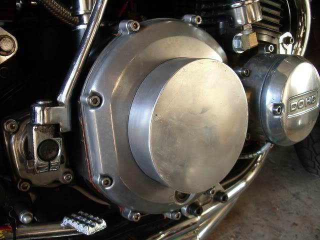

#10 PostAuthor: Pigford » Sun Feb 28, 2010 12:13 pm
There was a thread last year (or so) about oil pressure gauges (by Hillbilly or Fluff I think) - the ones that fit in the take-off on the r/h side about the clutch cover.
You can just see it on me Black Z1000, in the top right hand corner of this photo.....
Mines a 0 - 15 psi and on start up (cold oil - 20/50) it goes off the clock when revving it a bit :| But after a few miles it settle to read about 3 or 4 psi steady cruising. When hot and idling 1100 rpm it hardly don't move unless the throttles blipped, but these things ain't prescision bits of kit, and not calibrated, so only use it as a rough guide.... :wink:

Pigford,
What is the extra cover on the clutch cover???
Jimmock.
Jimmock. :wnkr
I hate people I don't like !
#14 PostAuthor: Pigford » Mon Mar 01, 2010 6:38 pm
Jimmock - thats for my lock-up clutch :wink:
