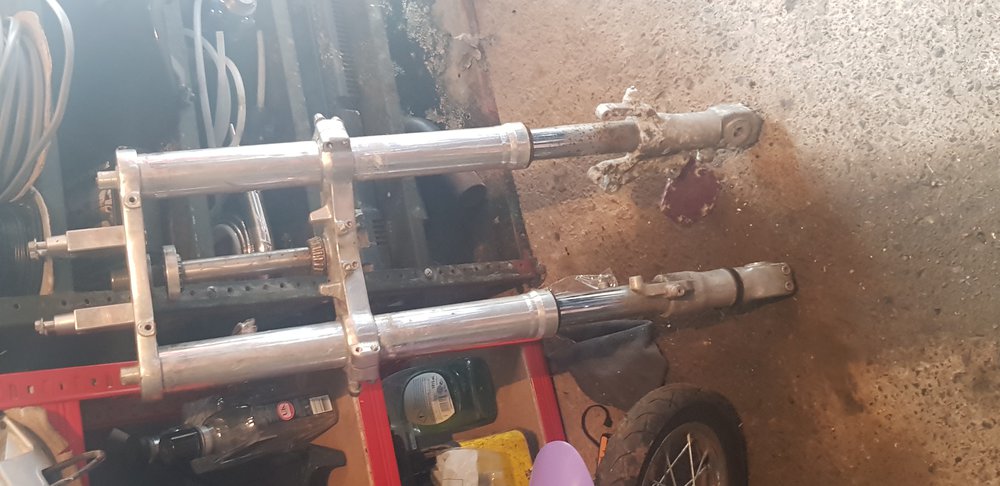

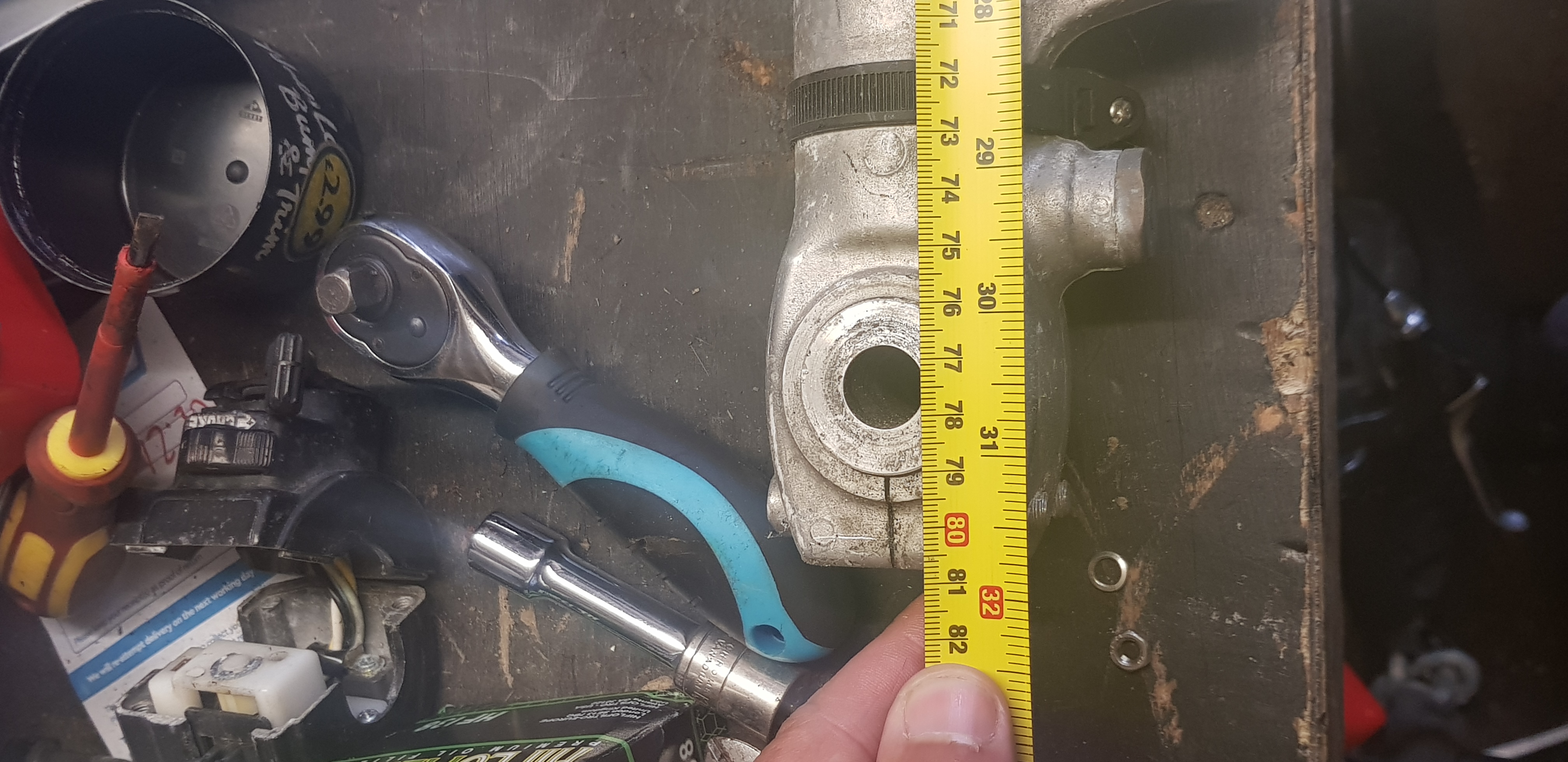

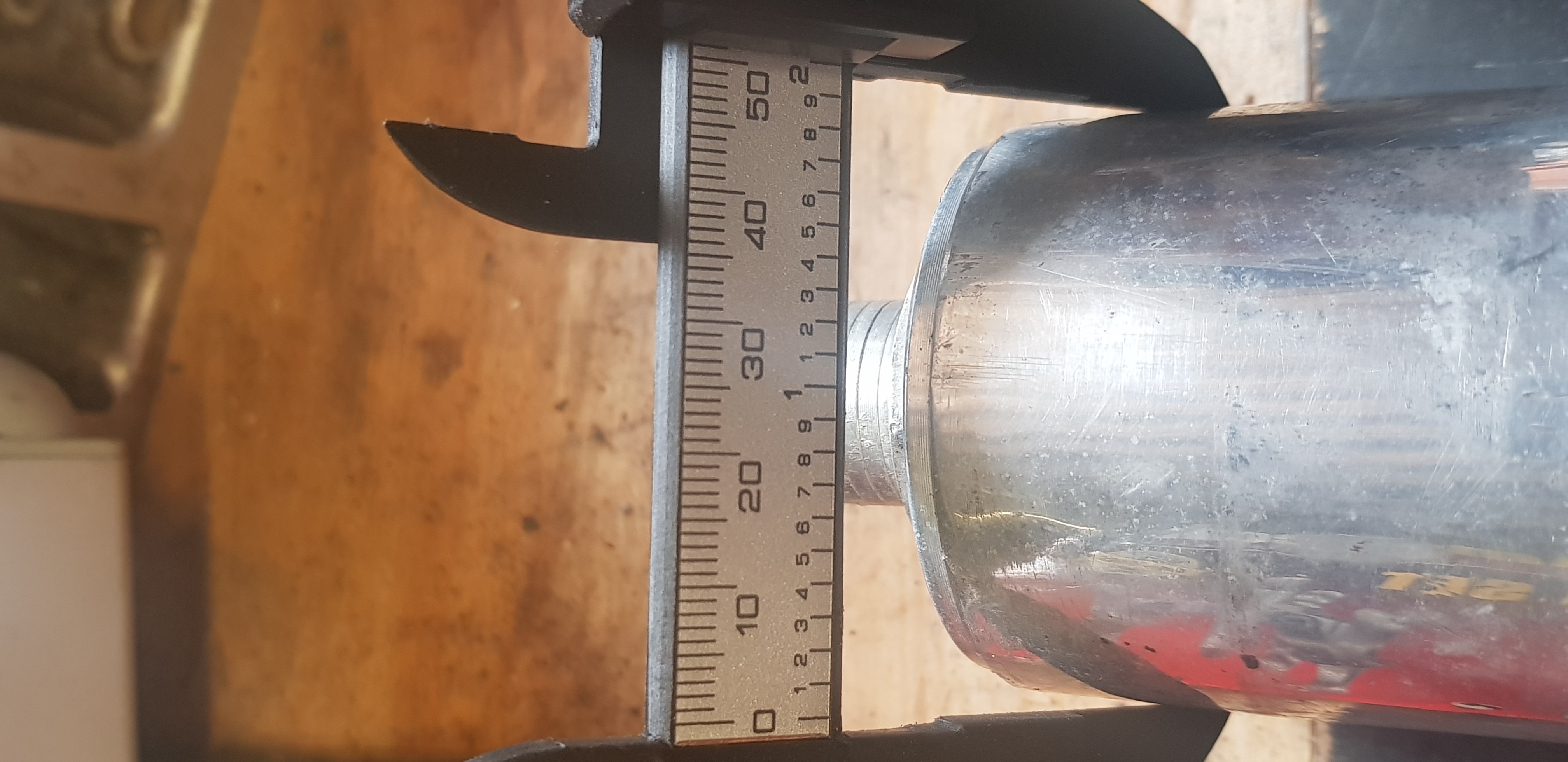

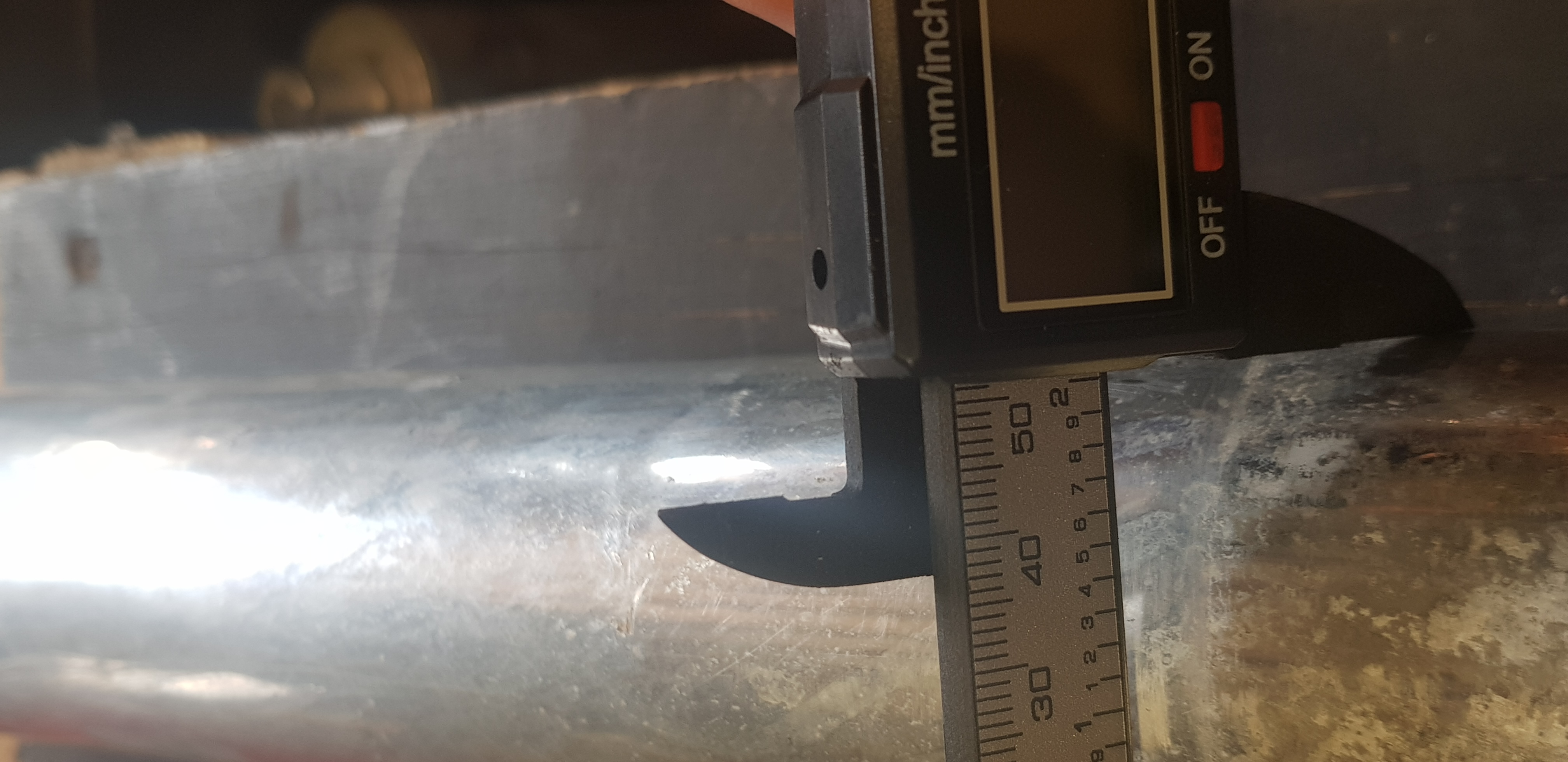

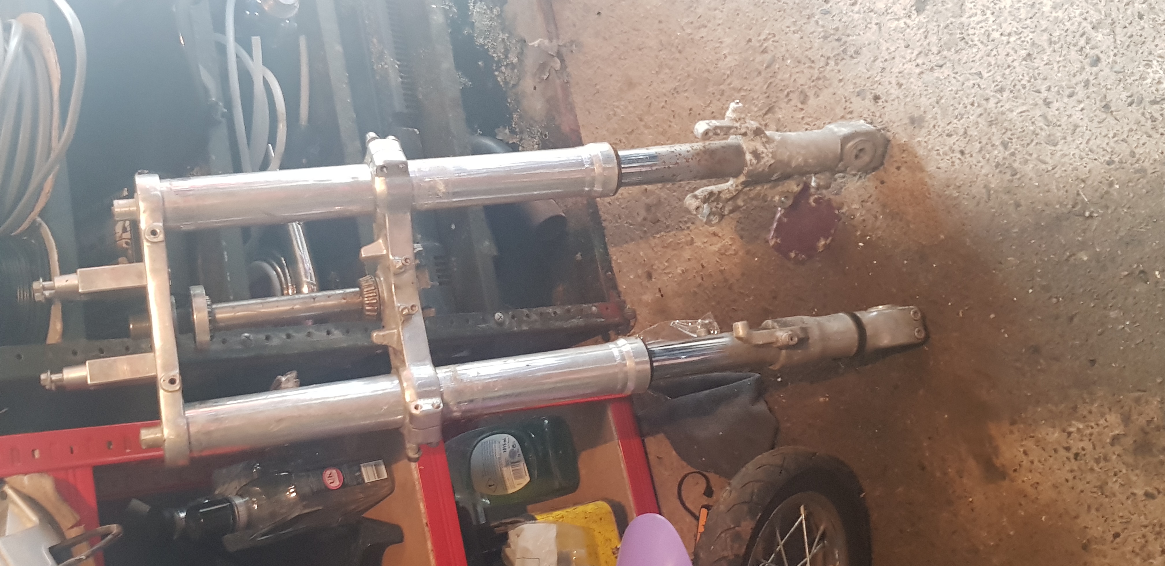

#12 PostAuthor: Swirl » Mon Jun 03, 2019 7:01 pm
Interesting old thread, I think the forks I have are Zx9r B, they are going on the Z1R project, good news if they are
