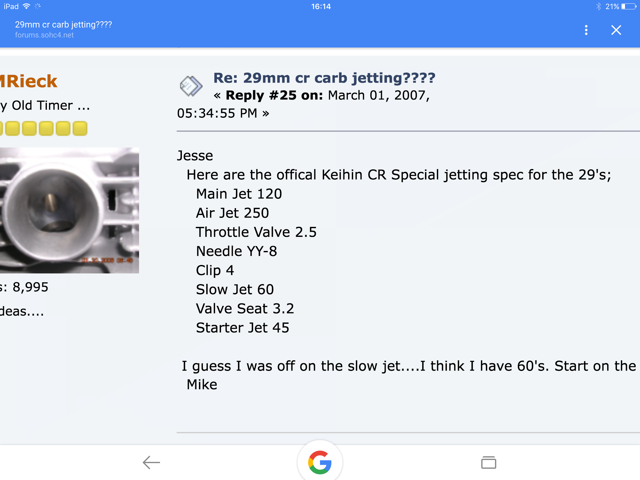

Just fit a set of Keihin CR29mm on my 900, straight out of the box, 120 mains, 17.5 pilot, 240 main air jet. Harris pipe starts fine but doesnt want to rev any advice for a good starting point for set up?

Thanks for the info had a look today the needles were set at 2 instead of 4, the pilots are 65 instead of 60 so will change these and put back on and she how she runs.
