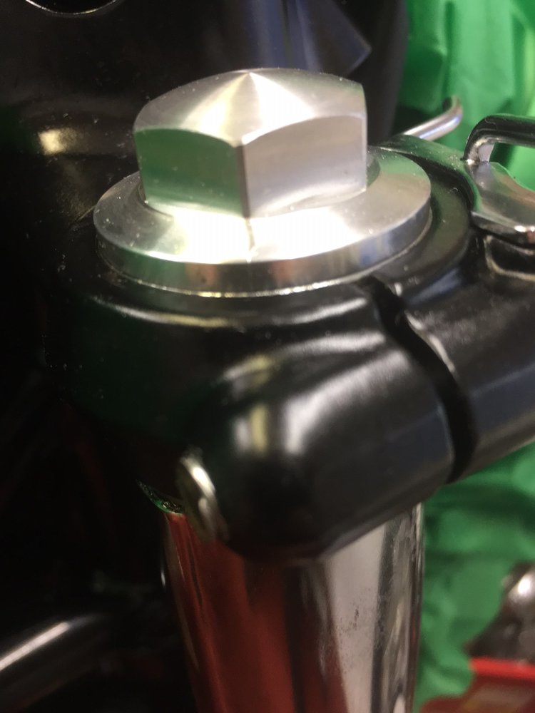

I have set my forks and Cap nuts (see picture attached) as per most pictures on the net,with the stanchions level with the top of the yoke.
But looking at the Haynes manual tonight it says to set the cap flange level with the top of the yoke so that some of the cap fits into the yoke :??
Is there a correct way :?:
Does it really matter :?:
Opinions appreciated please.

they should be flush with the top yoke . i would suggest investing in a genuine manual

#7 PostAuthor: z1bman » Mon Sep 11, 2017 9:23 pm
the outer edge of the top nut should be flush with the yoke . the top yoke pinch bolts are in inch pounds & the lower are in foot lbs

#8 PostAuthor: BigZCas » Mon Sep 11, 2017 9:26 pm
Load and clear :oops:
Thanks all for your help
