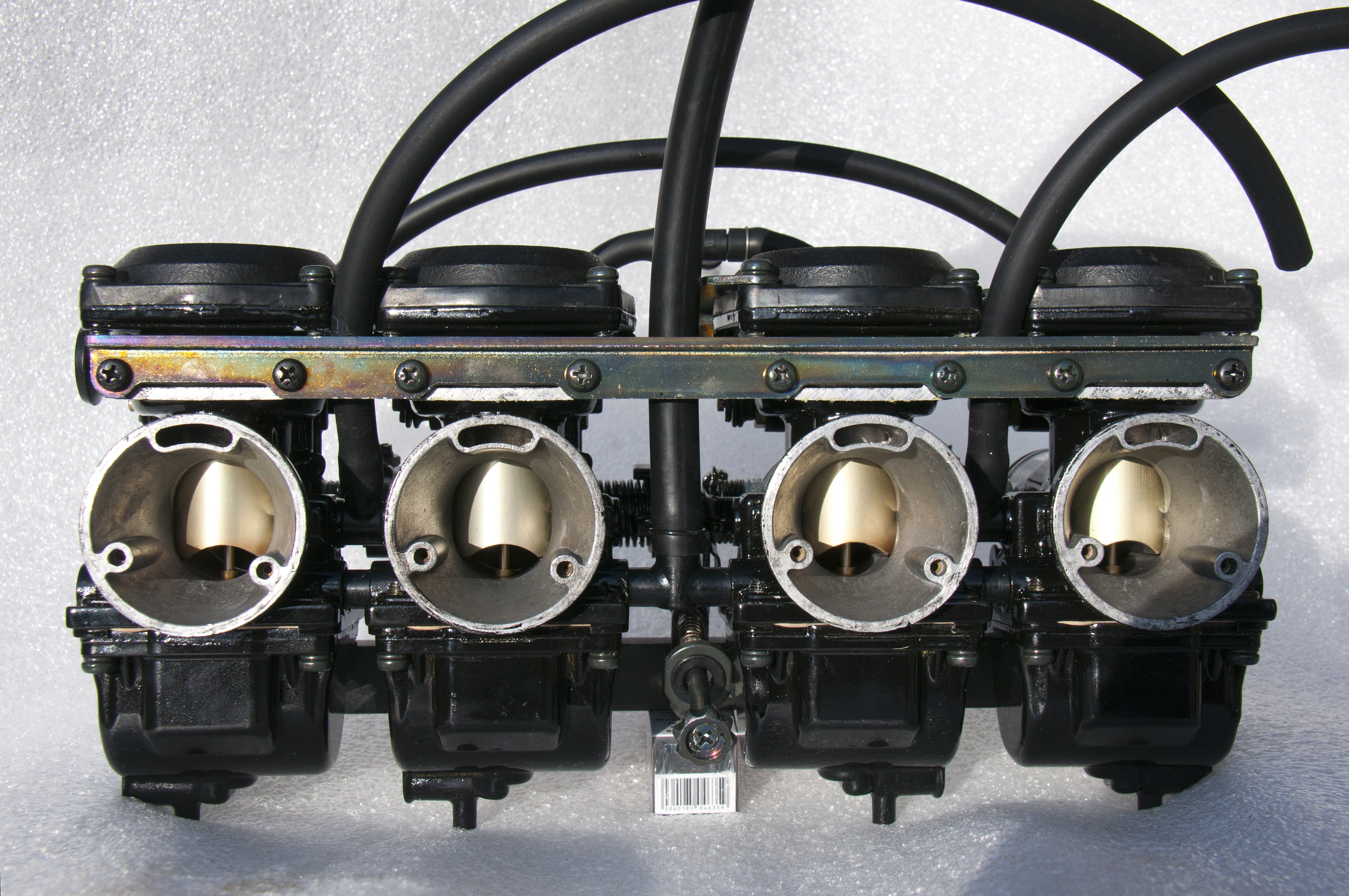

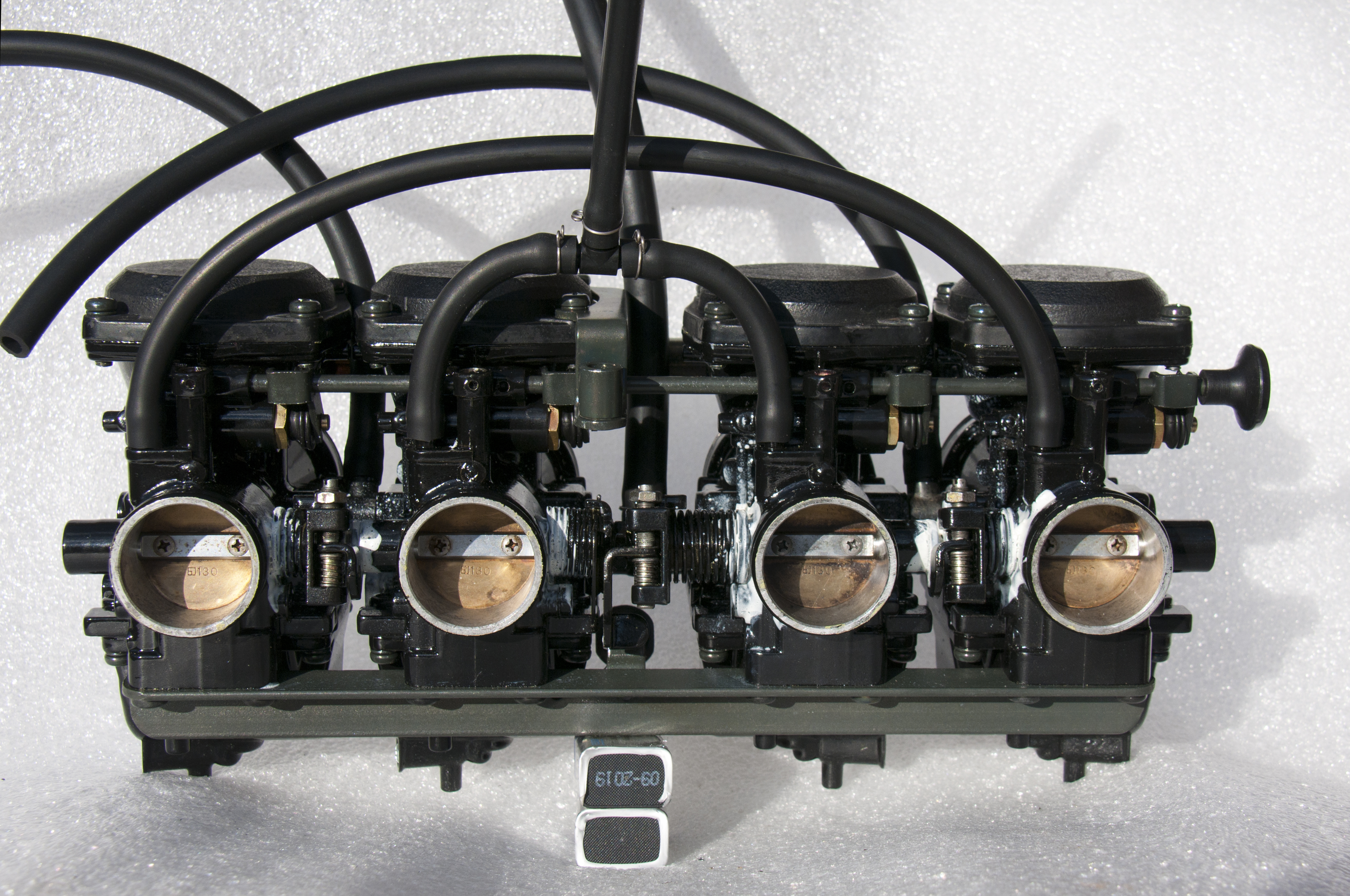

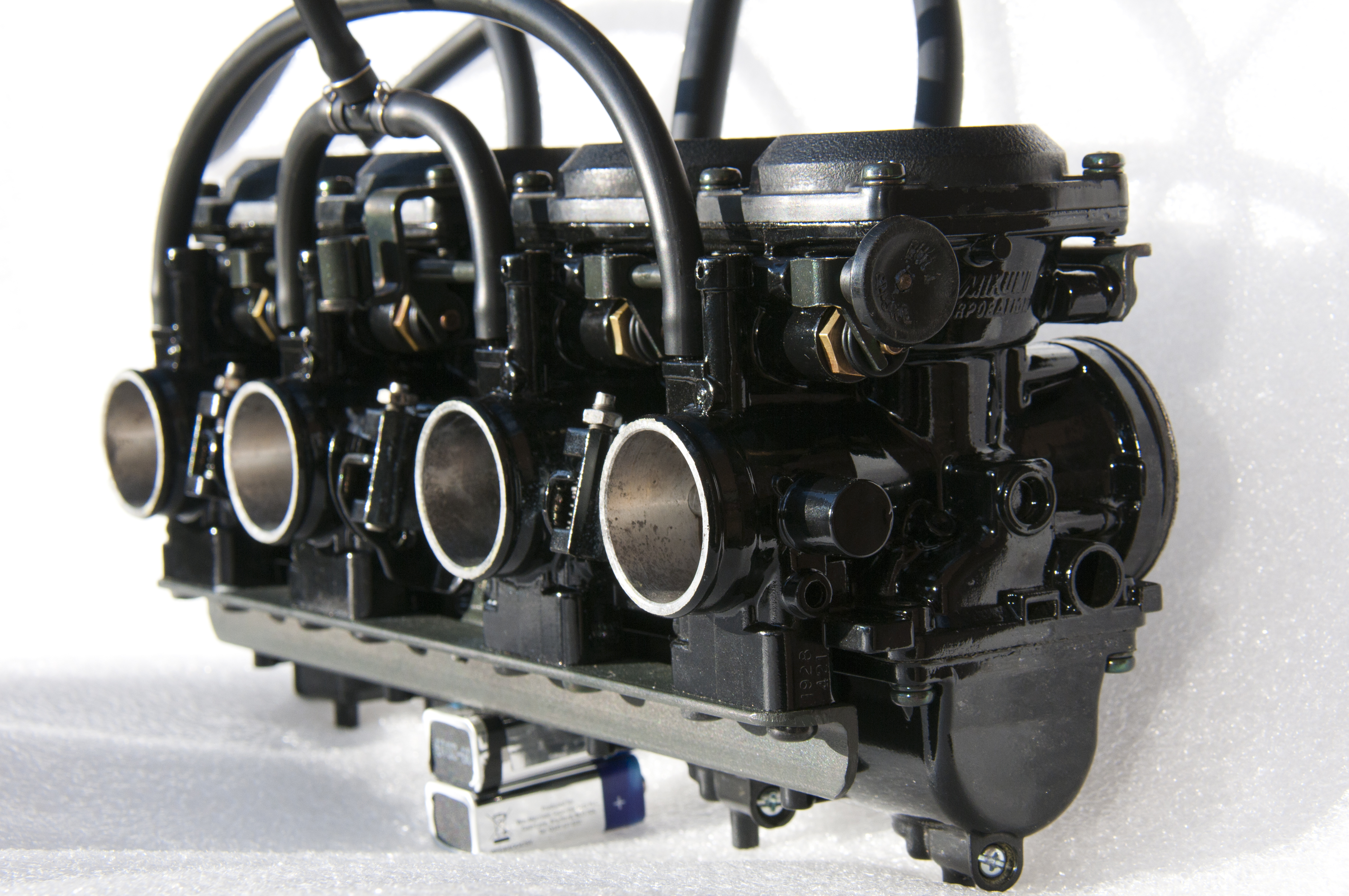

#4 PostAuthor: cruzi » Tue Mar 13, 2018 11:41 pm
Hi Swampy, I managed to get Carbs restored using some original and Pattern parts. Zed Parts did a good job in doing the resto and also working with me to get them looking original as we could.

#5 PostAuthor: swampy » Mon Apr 02, 2018 6:20 am
they came out looking very nice.
